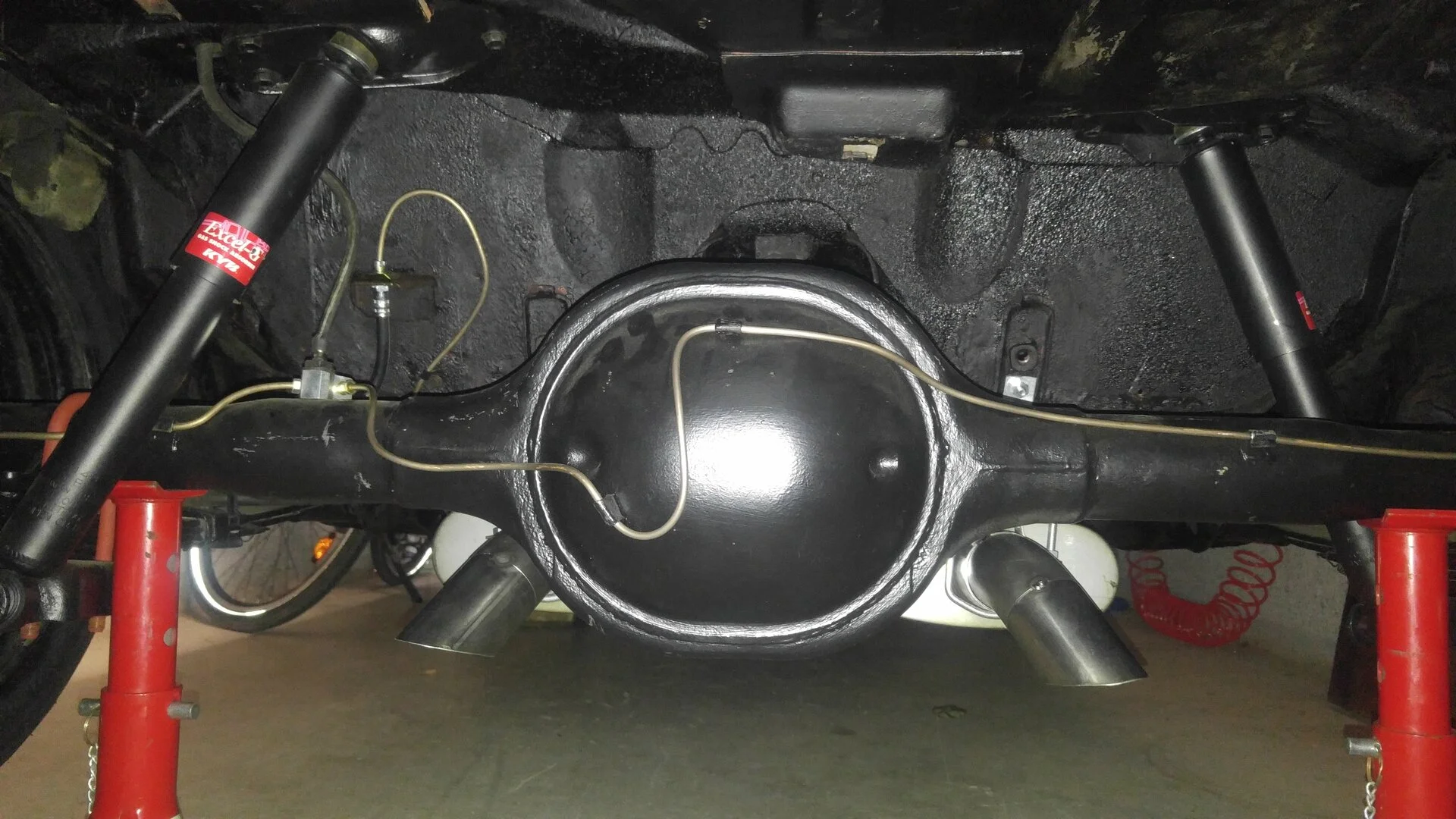

Never thought of that. The wood box is the old standard for carrying wine bottles... It will hold up nothing. I used it to mock up the exhaust.
The jack stands are 1 tonne and have an approval. But perhaps you are right and I should rethink this. When I started working on cars I didn't had trust in any jack stand or in my experience placing them right. I'm always shacking the car to check if it has a good stand.
I have also a set of ramps, which is my preferred method of getting the car up.

extra_stout said:
exhaust building on jackstands sucks.
At least you dont have the factory rear sway bay running under the axle, so you have a spot to put them.
If I am under a car even with 3 ton jacks I always slide a tire or a milk crate or something underneath or wood blocks under the tires that gives me an escape if the jack fails or falls. Those cheap tubular stands are only useful at their lowest setting. raising them high makes them much more risky. Your life is worth more than that. Those tube ones are made in China and the rating is dubious at best, Mine are also made in china but being rated for 6000 lbs, I can safely assume they will handle 1000. Always put something else under there to take the weight and clearance of the vehicle so you can get out.. even a log is good, or spare tire and some blocks.

2Blue2 said:
That exhaust manifold is so tight, wow. Those are the 66 style right?
Yes, this are the 289 exhaust manifold from a 66 mustang.
Because the downpipe is bigger in diameter it is harder to get a nut or a wrench onto the bolts (obvious). That is the only downside of this solution IMO. Because everything else is 2.5'' diameter I don't think that I will have to much back pressure / performance loss using the manifolds instead of headers. Headers will have some extra TQ/HP in there sweet spot, but this is not that much that I care about.
If you have a good flowing exhaust (mandrel bent and 2.5'') and flow trough mufflers, there is not much back pressure. With the exhaust manifold and no exhaust crossover the sound should be how I want it. I also think it will be not to loud with this tiny explorer cam.
Because the exhaust gas gets cooler when traveling down the exhaust, I think there will be no performance loss if some 2'' mandrel bend pipes would be used to build an over axle pipe.

General thinking on exhaust is bigger towards the exit usually.(think stepped headers).Not smaller after larger. True the exhaust likes to see some expansion until cooling of gasses (header collectors length).
Simplest way I would try to use the MII manifolds for clearance reasons and hook that to 2 1/2 pipe front to back if you want bigger pipe and have room.
Or, You could use 3" pipe about 18" long. as far forward as you can place them ( like emptied out glass pack mufflers) as expansion chambers, then the 2 1/2 to the rear with mufflers or (2" if you must.)
2" pipe (true duals) is completely adequate for 302 cubic inches, and you won't see any noticeable gain or loss in power between 2" and 2 1/2" on any dual exhaust with manifolds on a 302 between those two sizes unless spending all your time at 6 k rpm and up on a fairly modified engine (heads, cam, compression, intake etc.).
I would use what fits best and easiest in this case.

They were able to get 2 1/4" over the rear axle on my exhaust. It is not mandrel bent though. I have headers to 2 1/2 then changes to 2 1/4 over the axle into the dual in/out muffler.
