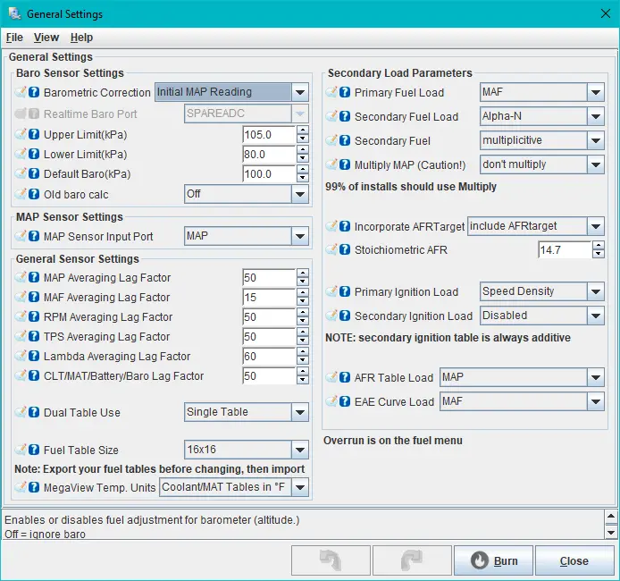

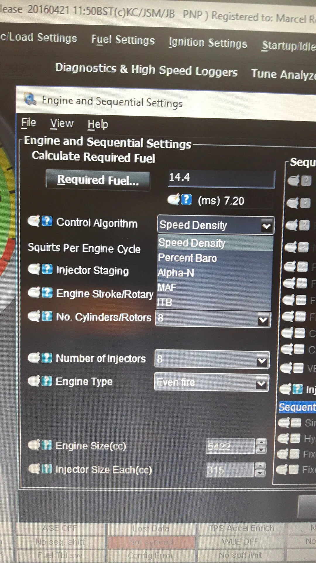

MS also allows use of SD or MAF or both. I use both, basically, MAF for fuel & MAP (SD) for spark.
Why did I do this?
Why delete a new MAF housing with calibration tube when it can be put to good use?
Turns out, it actually works better with forced induction for street driveability.
