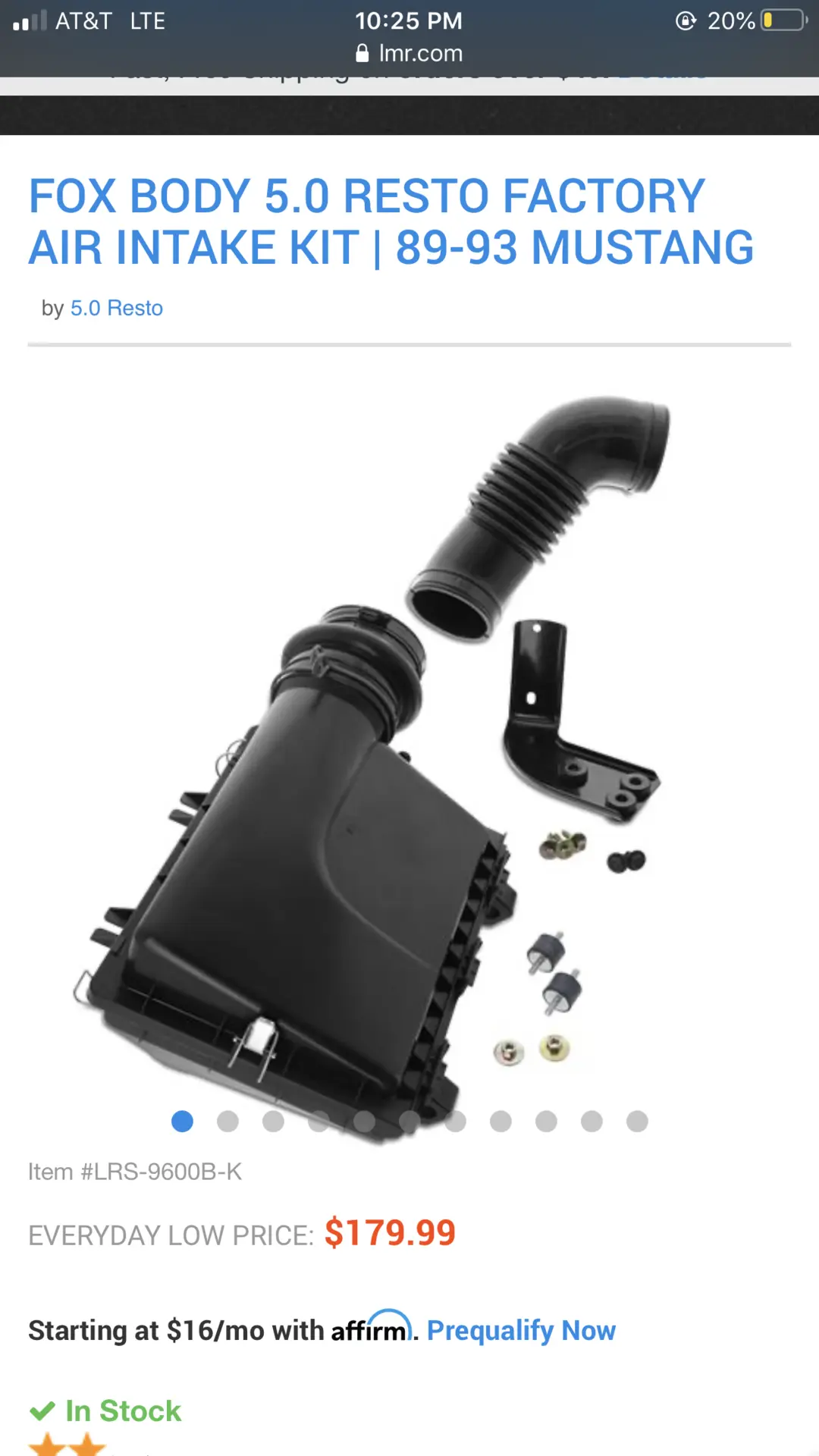

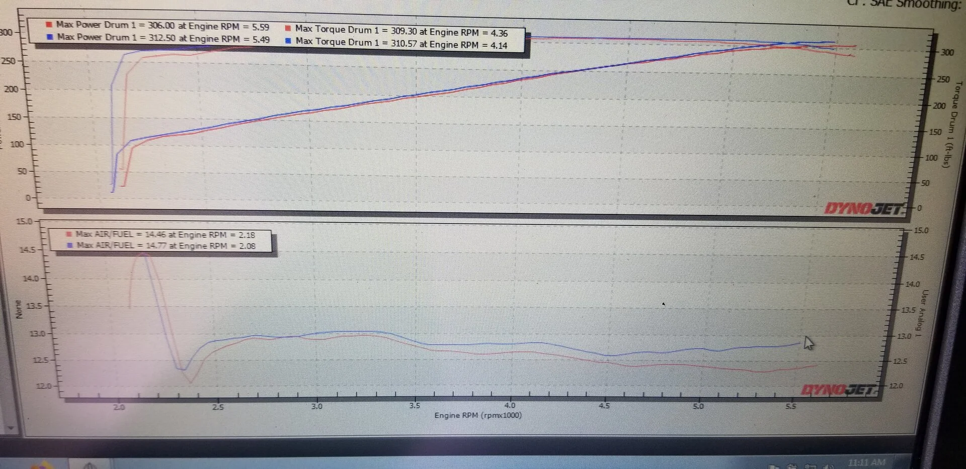

Recently installed a stock style intake which LMR just released. Car immediately began surging at idle. Brought it to a local tuner today and the new intake had caused the car to run rich at idle. Tuner did his thing and pulled fuel all along the rpm range. Car added 12 hp and 10 tq. Yes, tuning works.

What else was changed when you had it tuned last? Of the two runs, the fueling for the richer pull didn’t seem rich to the point where it would rob much hp. Unless that didn’t show the worst pull.

Exactly. I have an aftermarket BBK MAF. The car had been tuned with a 3" ID intake tube and open element air filter. If you look at photos of my car you'll see that. I swapped over to a stock style intake box and the outlet of the box is a smaller ID than the inlet side of the MAF. Apparently that caused some kind of velocity issue for the MAF and the car was highly rich.
I'll ad that the car dyno'd at 299/301 with that setup. Since then I had a valve job done and installed the new LMR stock intake box, but the idle surging didnt occur until I installed the intake box. Now, it's possible that the compression was raised slightly as a result of the valve job head milling, but I do believe the intake is good for a few hp. I was not told that my heads were milled at all. Overall I was surprised I gained 12/10.

Car ran great idled perfectly prior to the new air box. Surged after. How come? A/F showed pig rich. Tuned to pull A/F back down. Problem solved. What logical and reasonable alternative was there?
