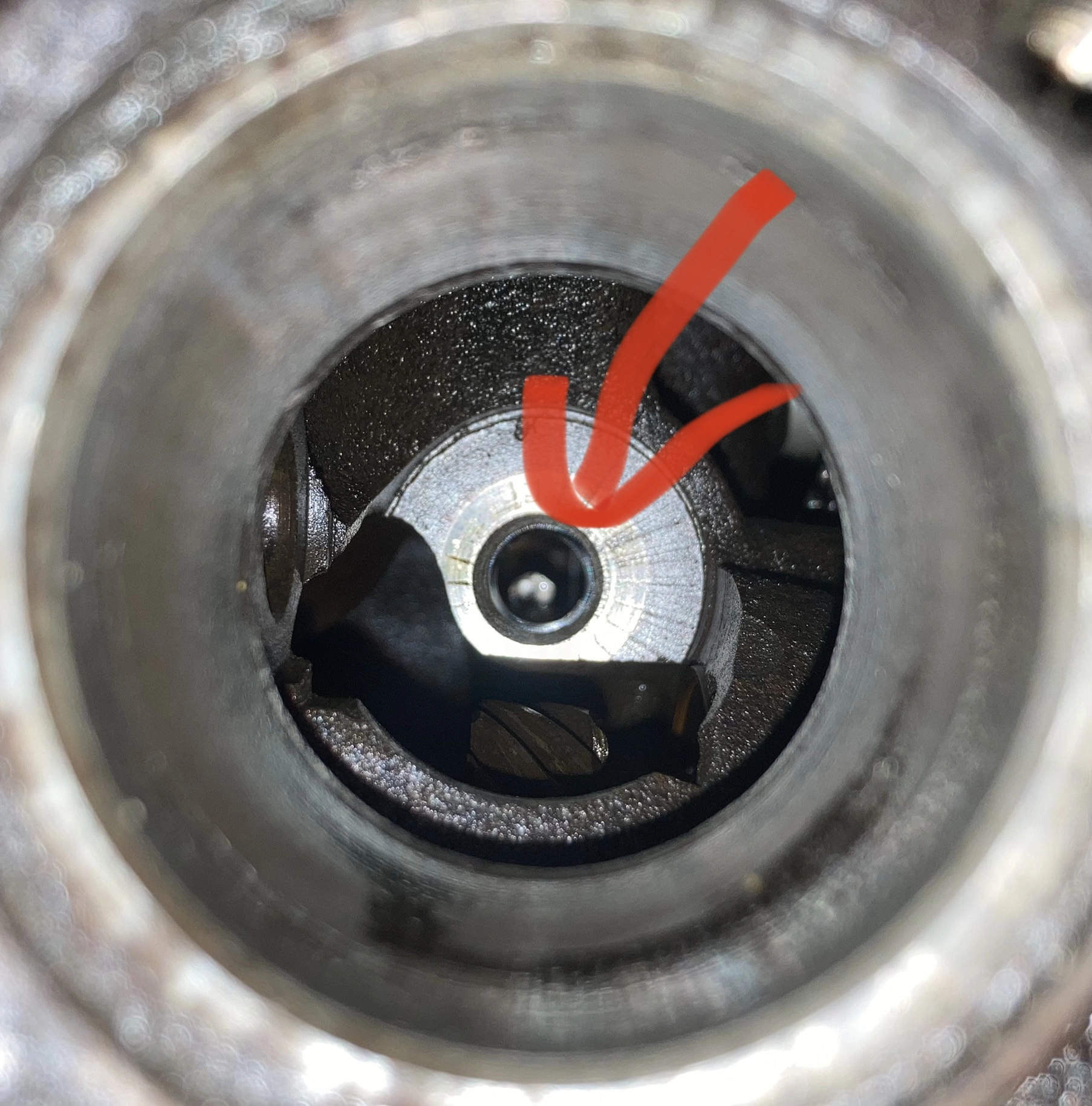

Yes it looks like its in the oil pump could it have fallen in the right place? Is the shaft tip supposed to be that high where the hole is next the camCan you see the rod with a light?
Uh oh. That's the oil pump drive. The camshaft turns the distributor, the distributor turns that shaft, and that shaft turns your oil pump.
You need to shine a light down there and see if you can still see it. If you can't you might have to drop the oil pan.
I see it,I'm trying to send a picture but my internet is badIf you can't see it , you WILL be pulling the pan.
There is a split spring washer that keeps the drive shaft from coming out of the pump. When you lifted the distributor out it pulled the shaft up, take your socket/extension and put it on the shaft and you can tell if it's still connected to the pump.Yes it looks like its in the oil pump could it have fallen in the right place? Is the shaft tip supposed to be that high where the hole is next the cam
Tape it together good, and go slow. You don't want to pull the pan. Pulling the pan is not something you want to do
