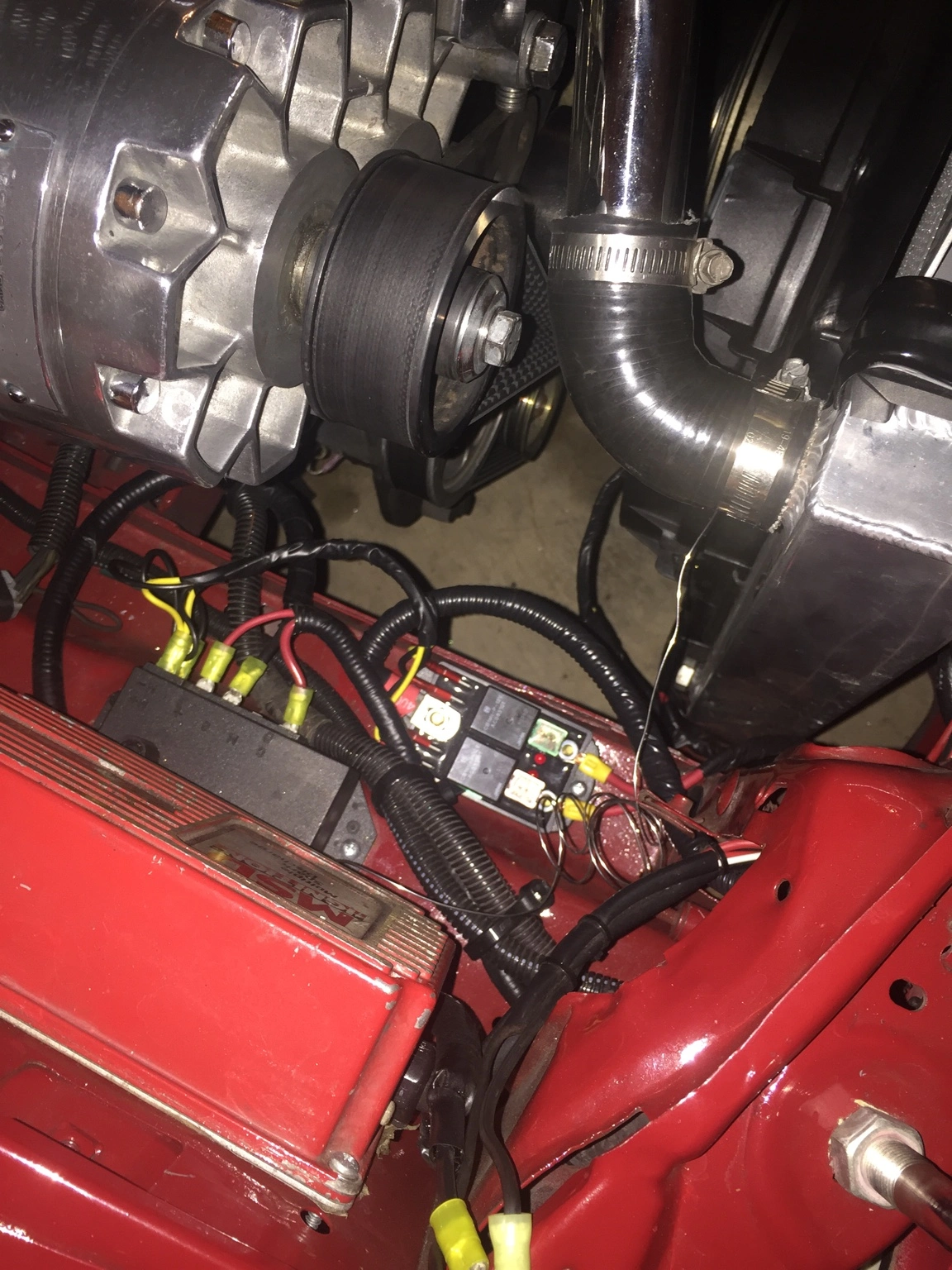

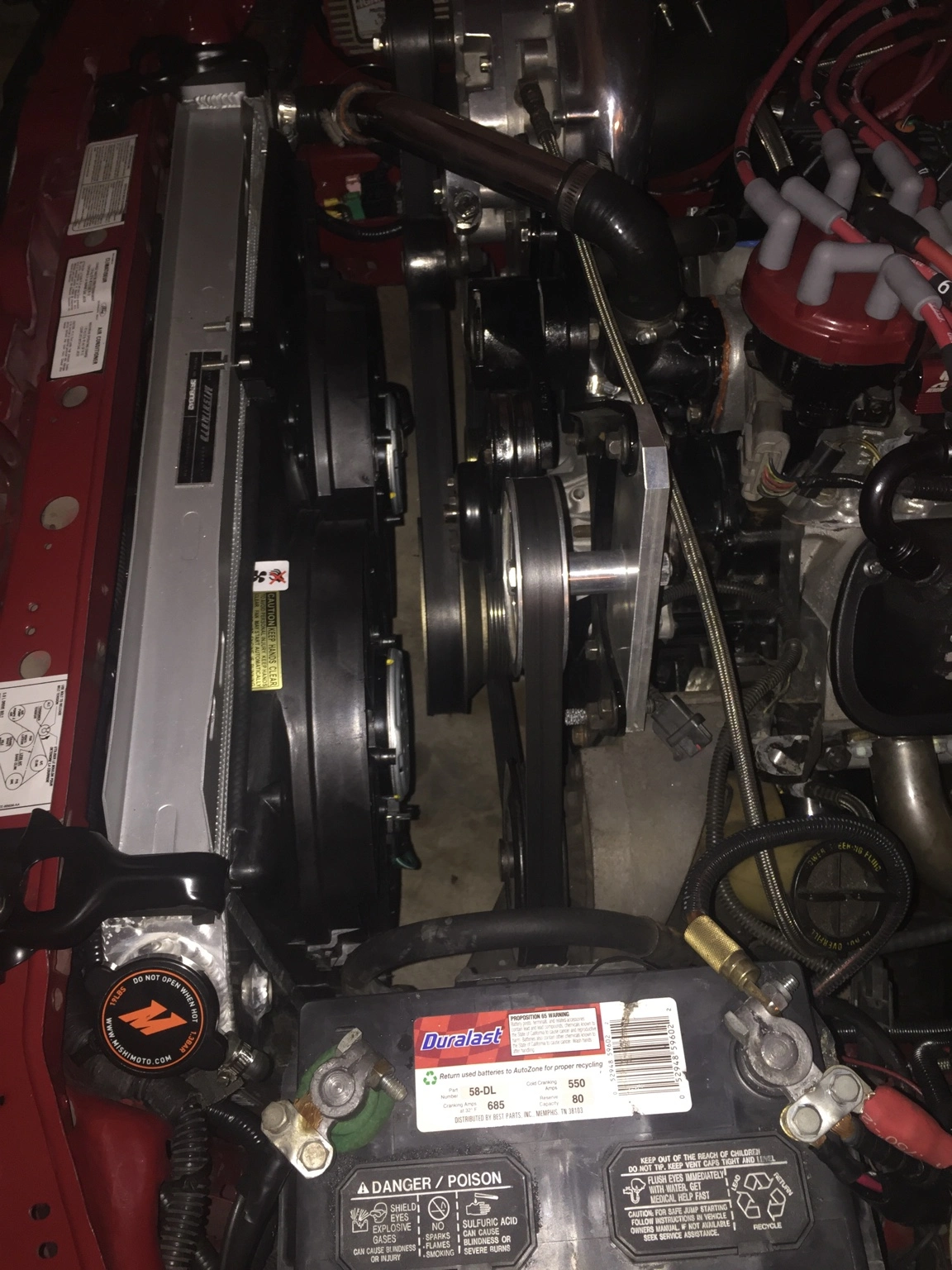

Contour fans in . Little quieter then I expected but they were cycling on and off car running 170 degrees in the driveway before.still have to mount the over flow in .
Used my black magic extreme fan controller basically as a switch to trigger a Leash 75 amp relay . Powered the relay with 4 ga wire and 100 amp breaker for protection . All seems well .

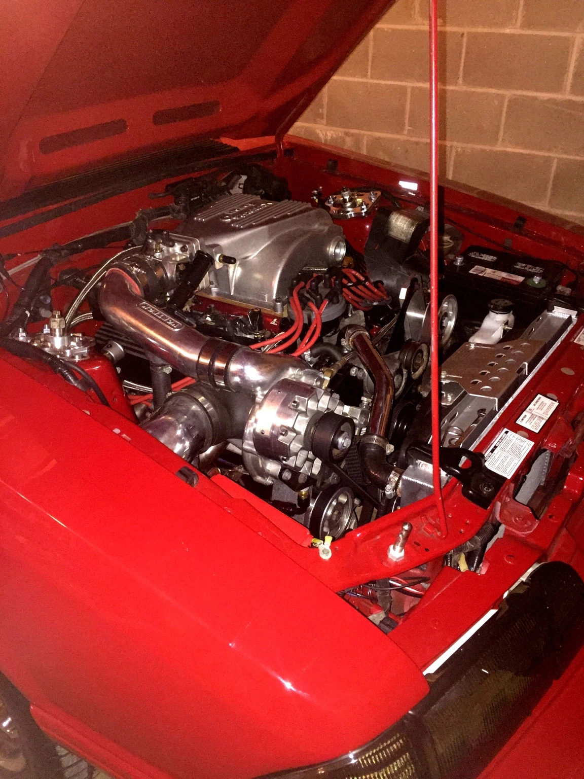

Not as nice as the shaved bays but I try bro . Thanks a lot ! Here's a better shot
Man that sure is pretty
Alright man, here's the deal. Your engine bay looked so nice that I didn't even notice wether it had been smoothed or not! Your doing a really fine job with your car brother.

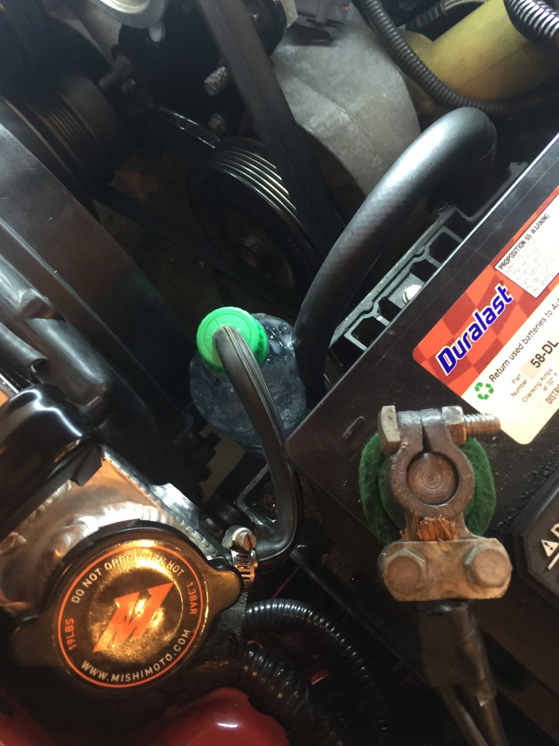

@mikestang63 @hoopty5.0 14-15 minutes sitting completely still at idle in a parking lot and it was 180 degrees up until the last 3 mins and it went to 184 and just hung out there . Just shut it to let it heat soak some and start it to see how it recovers
I should add it's 78-80 degrees not super humid today but warm ish out
IMade a temp degas bottle. Lol

I don't feel so bad . This is temp but I actually like it it's kind of funny it worked out better then I thought it would
