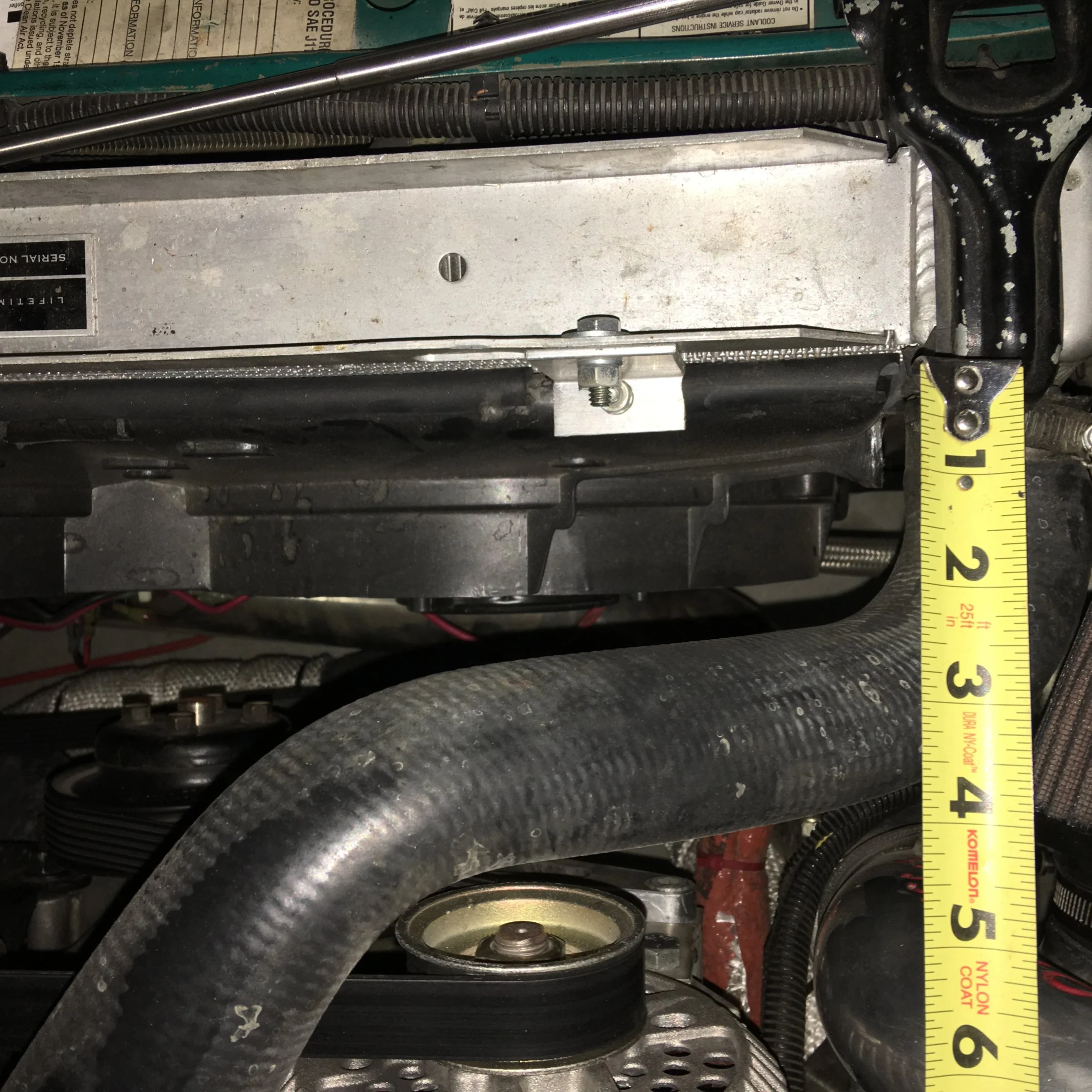

It looks like the depth is smaller so you gain some wiggle room.

I don't recall I think you said you have a blower again ? I have an 8 rib setup and I think it would clear a 10 rib no issue

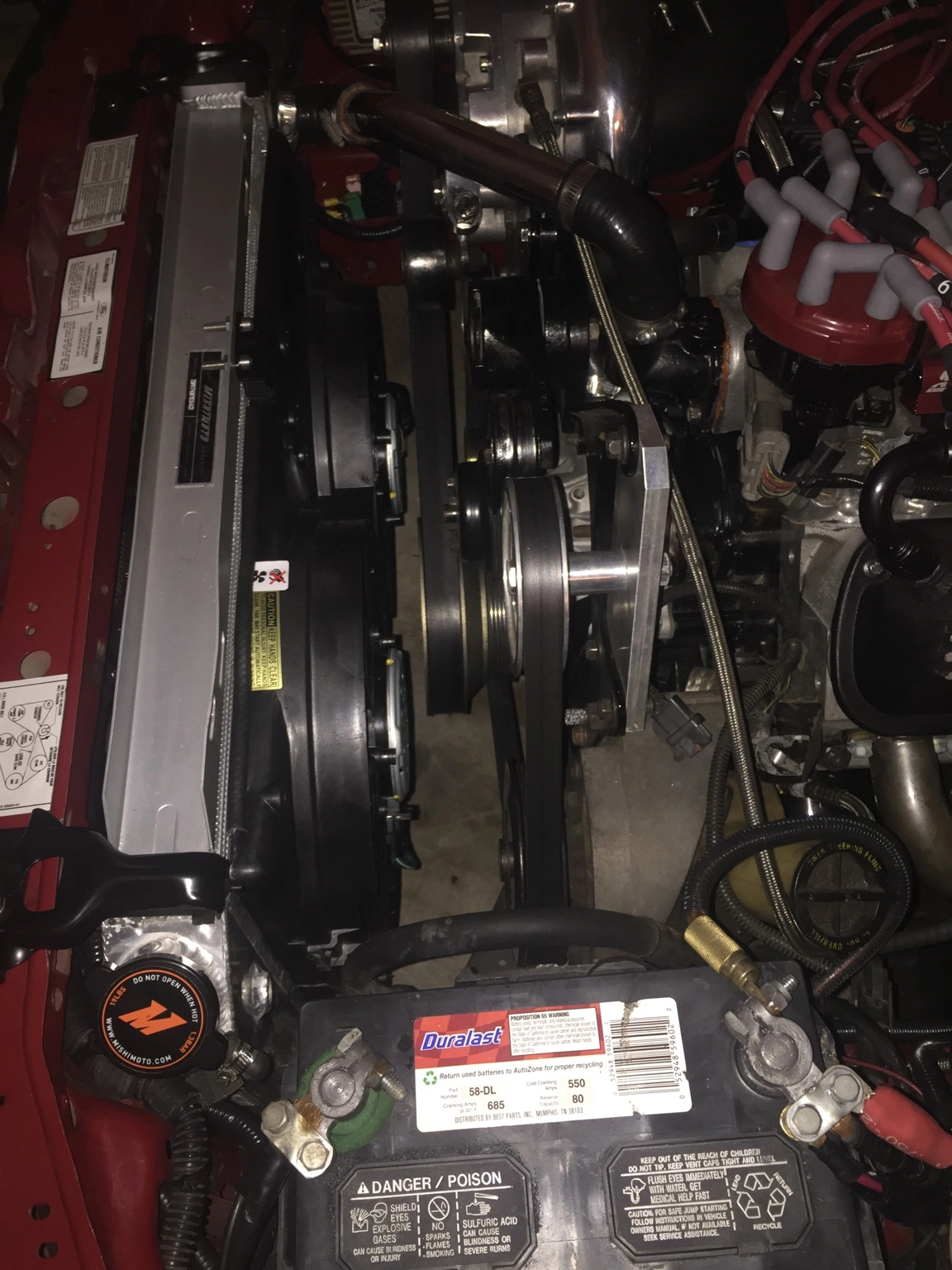

Jeez man, keep posting pictures of your engine bay!:drool:

Dual fans covering the complete core of the rad staggered so top and bottom are getting flow . Seem to keep the temp more constant in my opinion . My BM would creep to 200 after about 15 mins of not moving at all on a 85 degree night . These didn't creep letting the car idle all day . I think they are more efficient . The derale didn't fit the way I wanted so I sold them .

Good info man, I had to test it out tonight. I drove my car all over for a couple hours tonight. I don't think I payed enough attention after heat soak. It hung out at 190 some of the time but when I let it sit and idle it would eventually drop down to 180 again. Dam, something else to upgrade in the future probably...
