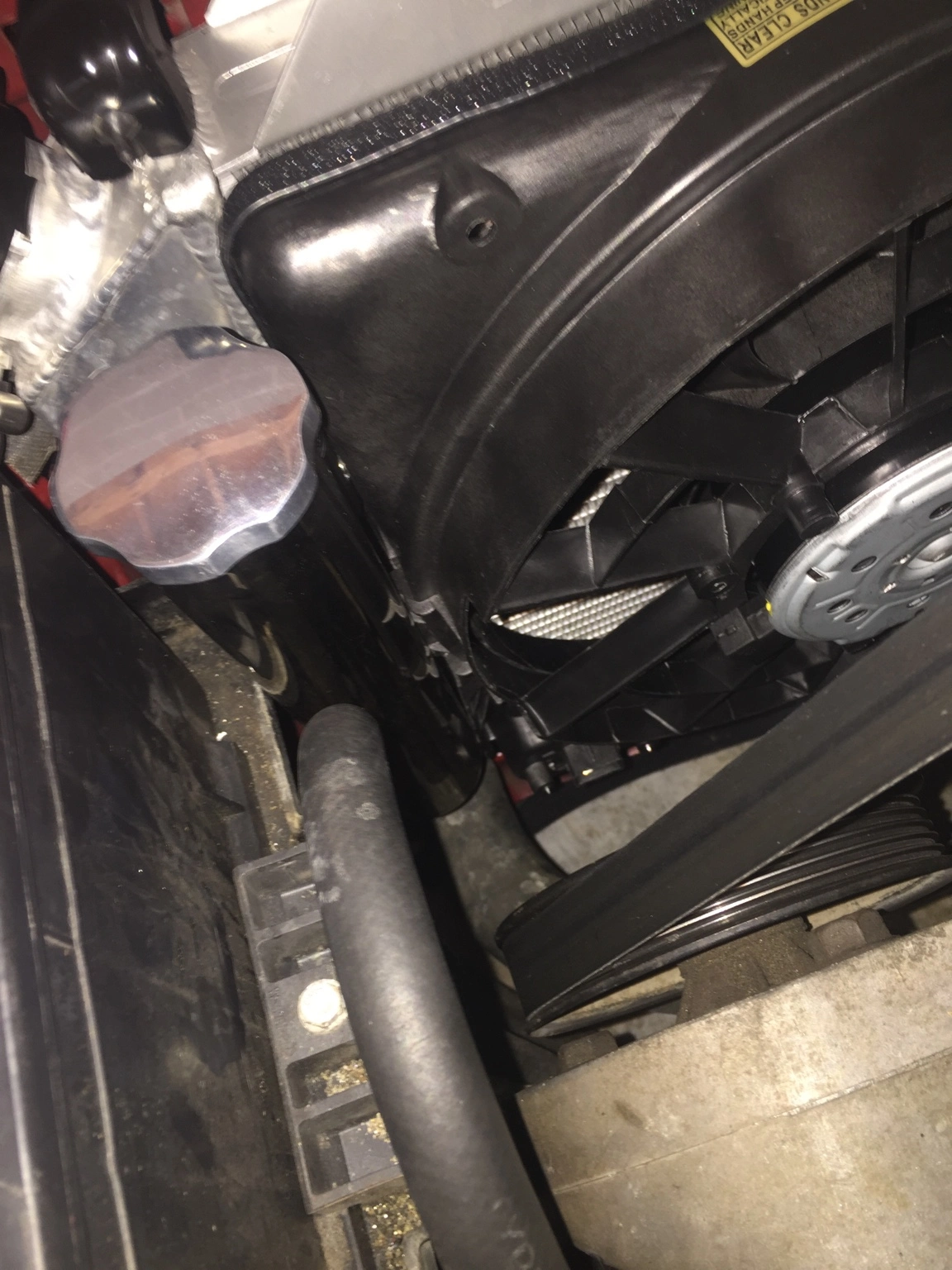

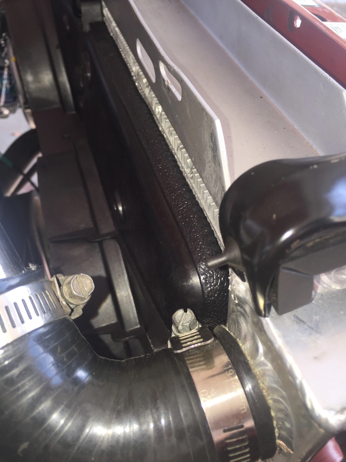

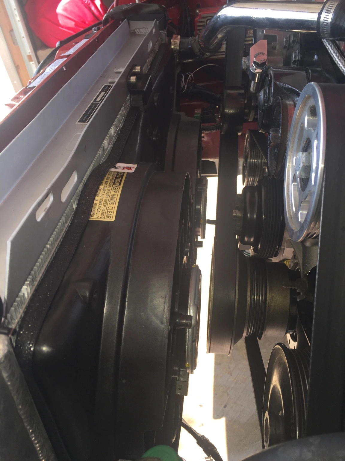

Changed the seal around the fans today . Looks factory now . Mid to high 80s here . Driving hasn't gone over 184 . Idle 186 . Heat soaked it too 206 and turned the fans back on . Pulled down to 200 and just maintained it . This made me happy . My black magic would always just slowly creep and never maintain after heat soak . As soon as I started moving it started to come down a bit .
So far I'm super happy with the fans . Next thing is too dilute the coolant a bit . Gonna change the mix to 70:30 maybe even 80:20 .

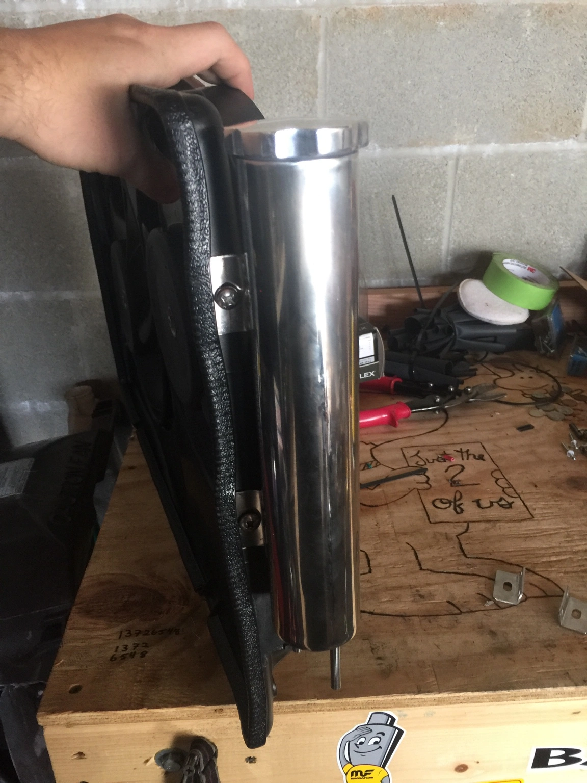

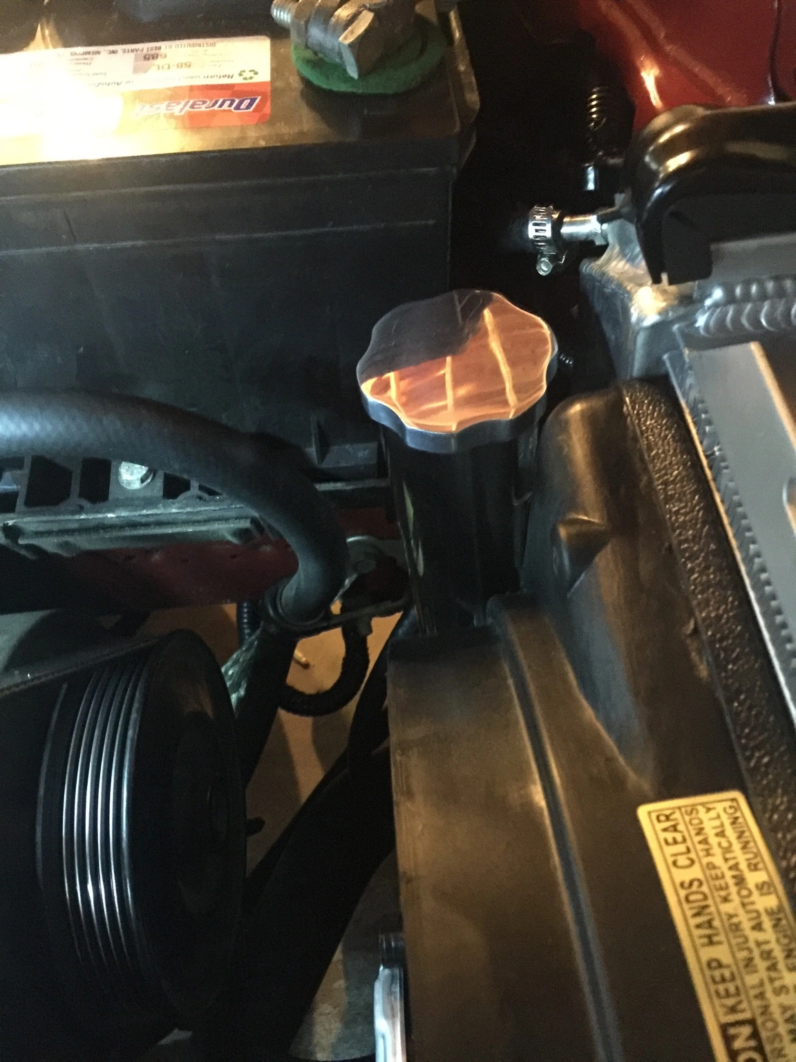

Man I love that overflow. I thought about getting that but you lose your sensor. What are your thoughts on the sensor? I guess you have a water temp reading and you would just want to check your fluid levels manually... Looks vs electronics.... :shrug:
My car never had tthe sensor option lol . If the rad is full and there's a dribble in the over flow I'm content . Lol
