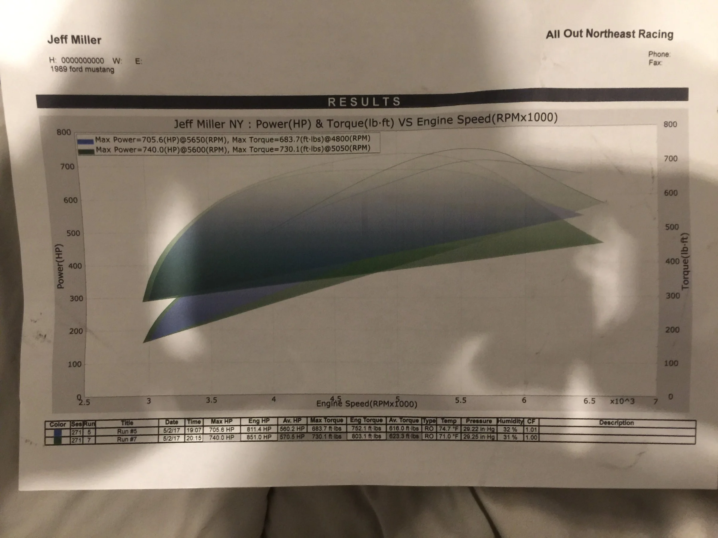

For anyone who wanted to see . Here's the sheet

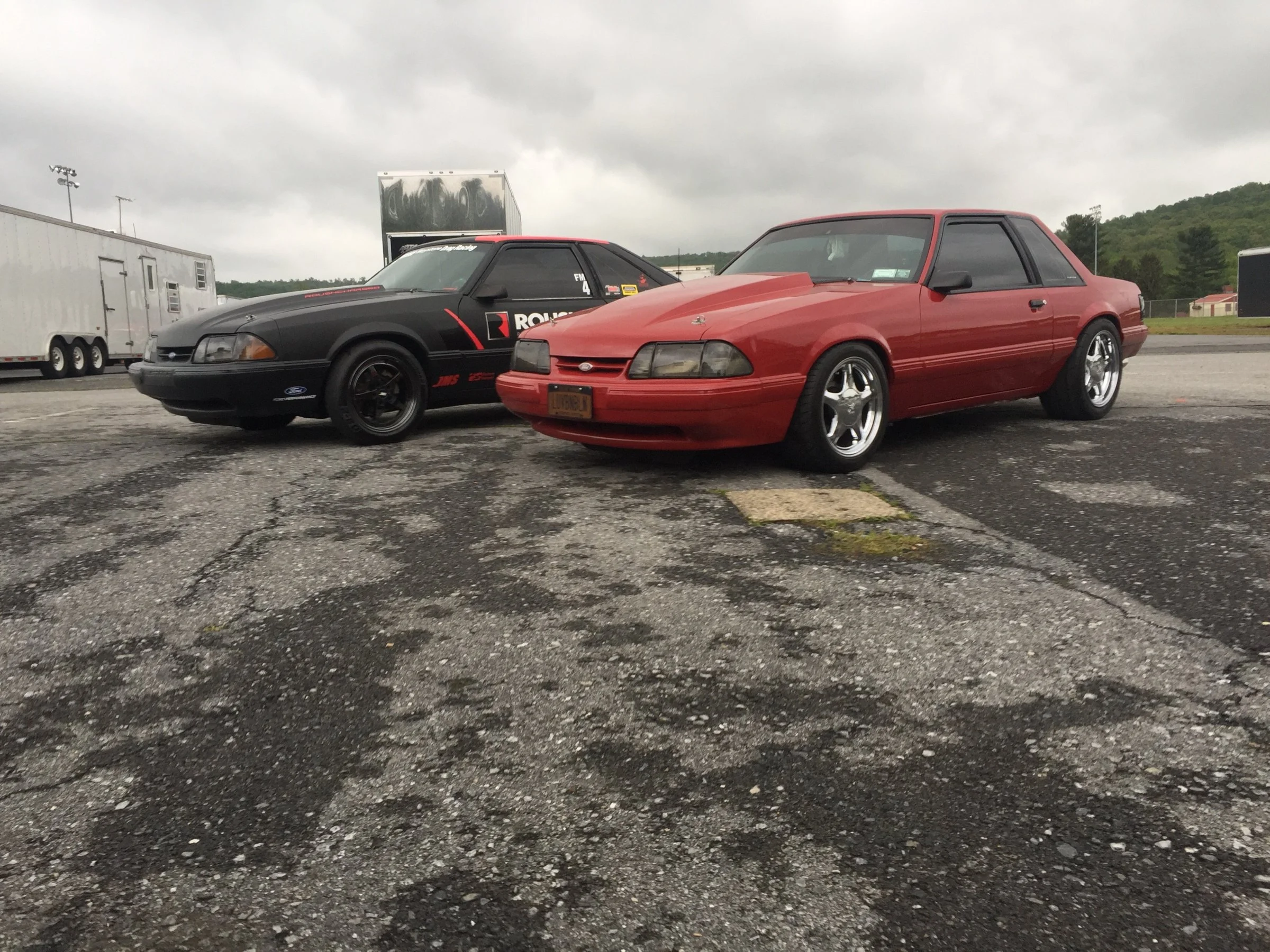

Well what a weekend . Didn't go as planned but I tried like hell .
NMRA was cool as hell . They tried so hard to get that track ready but the rain just wouldn't quit .
Showed up on Friday ready to run . Got the car off the trailer around 6 . Took some shots with my buddies sisters car. Went to dinner and hit the bar . Saturday morning we teched the car in and swapped my buddies pro stars on with the et street r radials on it . Called to the lanes the rain wouldn't quit started as we got there .
Finally get called back and get 1 test hit out of the 3 we were supposed to . The car hooked and bogged . I was trying to leave soft . Then it picked the tire up in second I'm told . I knew the run was junk . Let out right before the 1/8 and coasted to a 12.2x at 110 . Lmao

i gotta say... your car is one bad ass street car man!
Thanks brother I'm glad you finally got to see it in person . Too bad it wasn't in action. Always a blast catching up and hanging out . Thank you for offering to bring me the starter as well . I truly appreciate that !!
