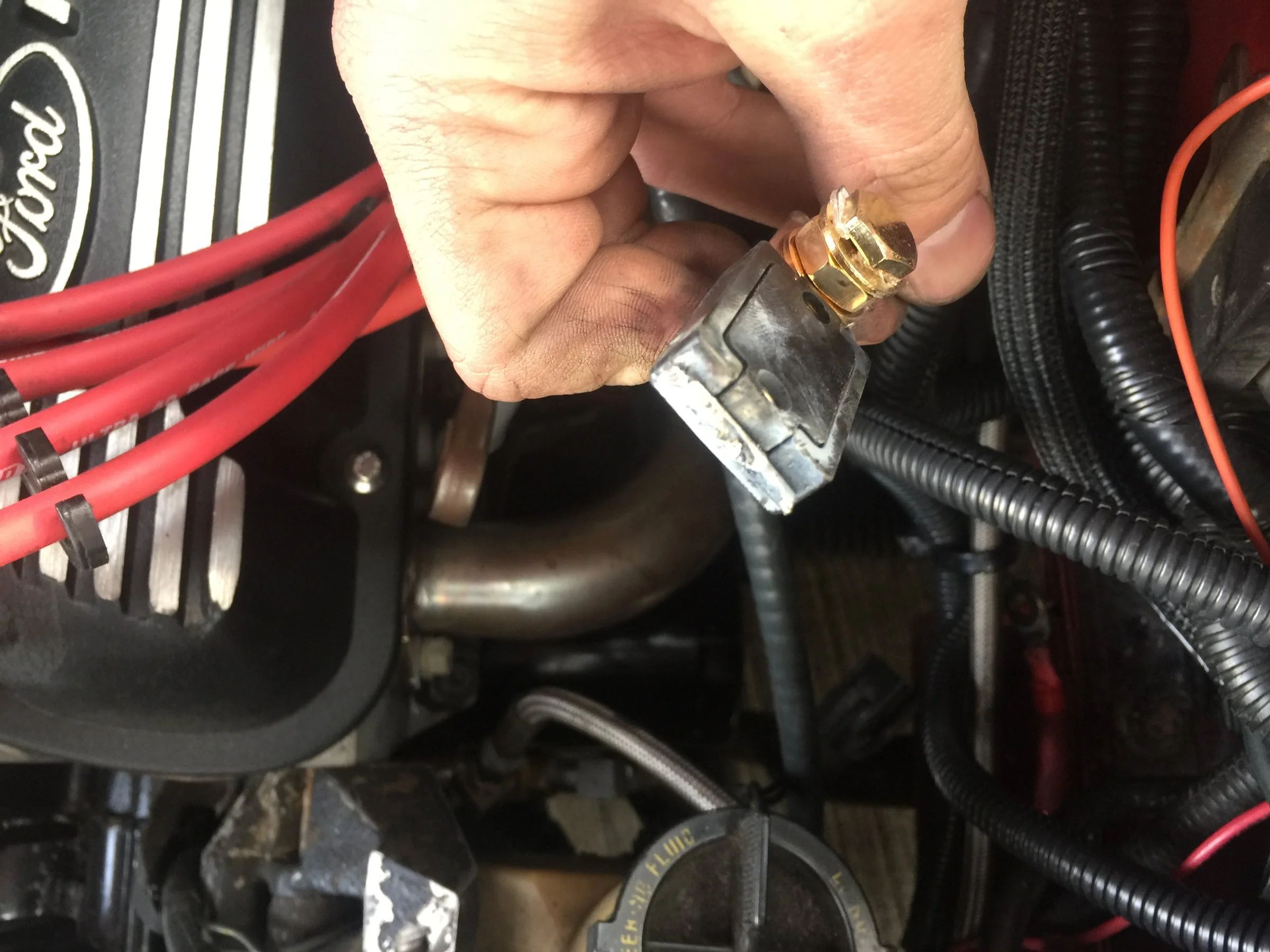

well that could have been bad...
Almost back together . 150 breaker is done . New alt in . Car runs mint charges 14.2 -14.5
I am just swapping the oil pressure gauge line cause when that fuse came apart is blew a hole in the line when t hit and arced off of it
