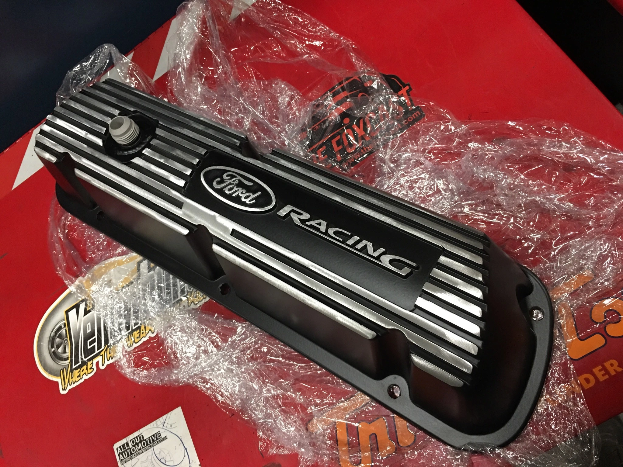

Got all the parts back. Did lower intake , valve covers , power steering pulley all the same satin as my upper intake to match .
Did the batt box , rad hold downs , timing cover / pointer , power steering pump bracket , relocation brackets for p/s and coolant pipes all In gloss black .
Spoke to Tom moss . Lower intake is going out to be ported by him this week to 1262 gasket for the new heads I plan on getting .
Haven’t called engine builder although I should .
Reactions: A5literMan

Reactions: stangboy, Noobz347, Cobra231 and 4 others

TOOLOW91 said:
Wow Jeff, that's just beautiful.

Thanks bud . Pics do it no justice compared to the way they come from frpp . I’m finally happy it will all be matching . There is not a thing on the engine that isn’t coated , polished , or aluminum at this point . It should be very easy to maintain as far as keeping it clean too .
