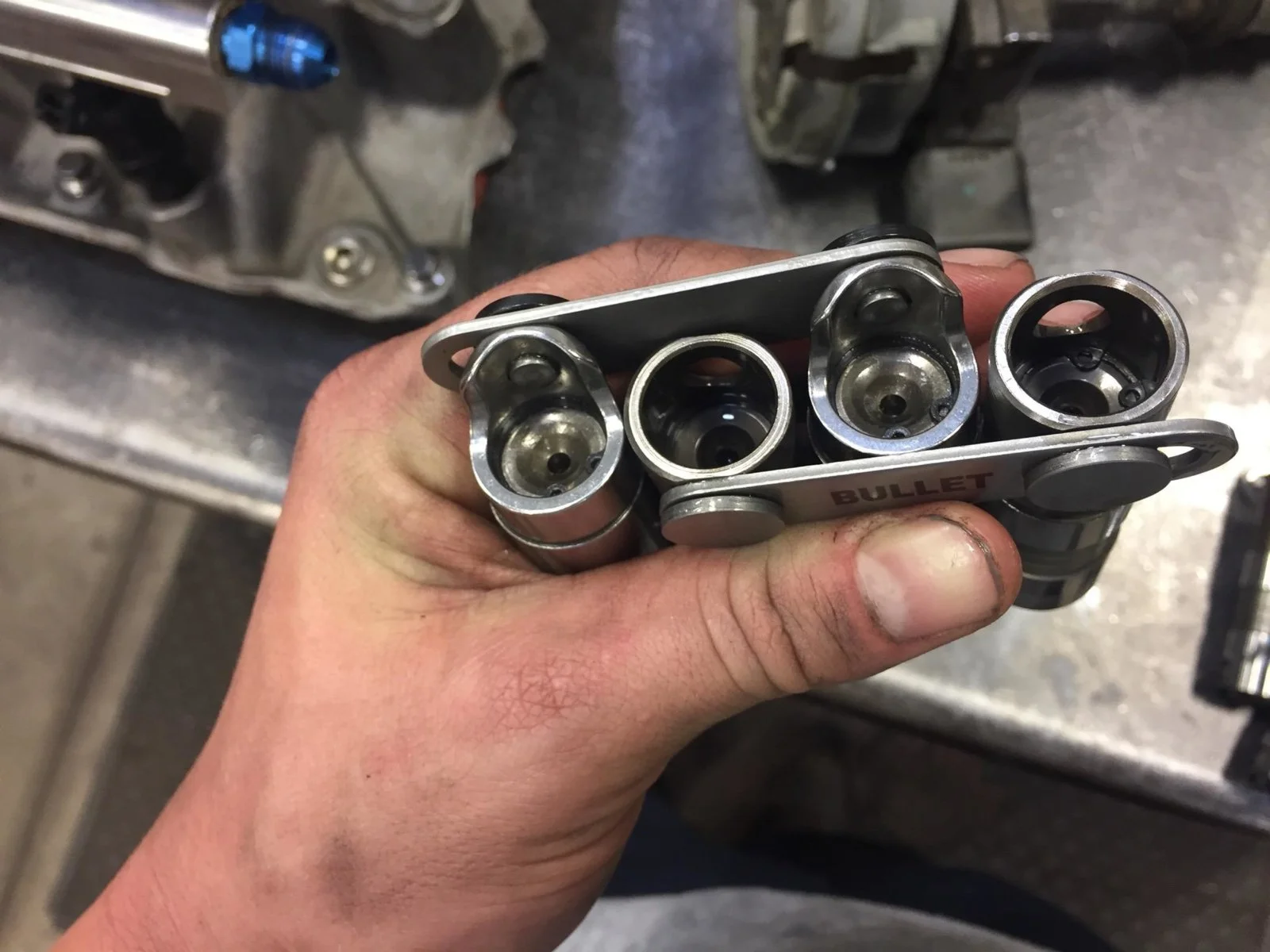

Lifters should be in next week . Few weeks out on castings of course for heads cuz that’s my luck . No big deal . We changed the spring and stuff so they have to come and then be assy at tea

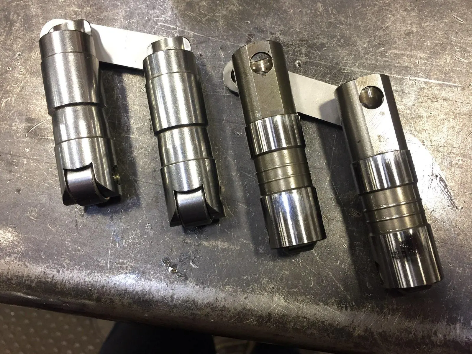

Reactions: tannerc91gt and General karthief

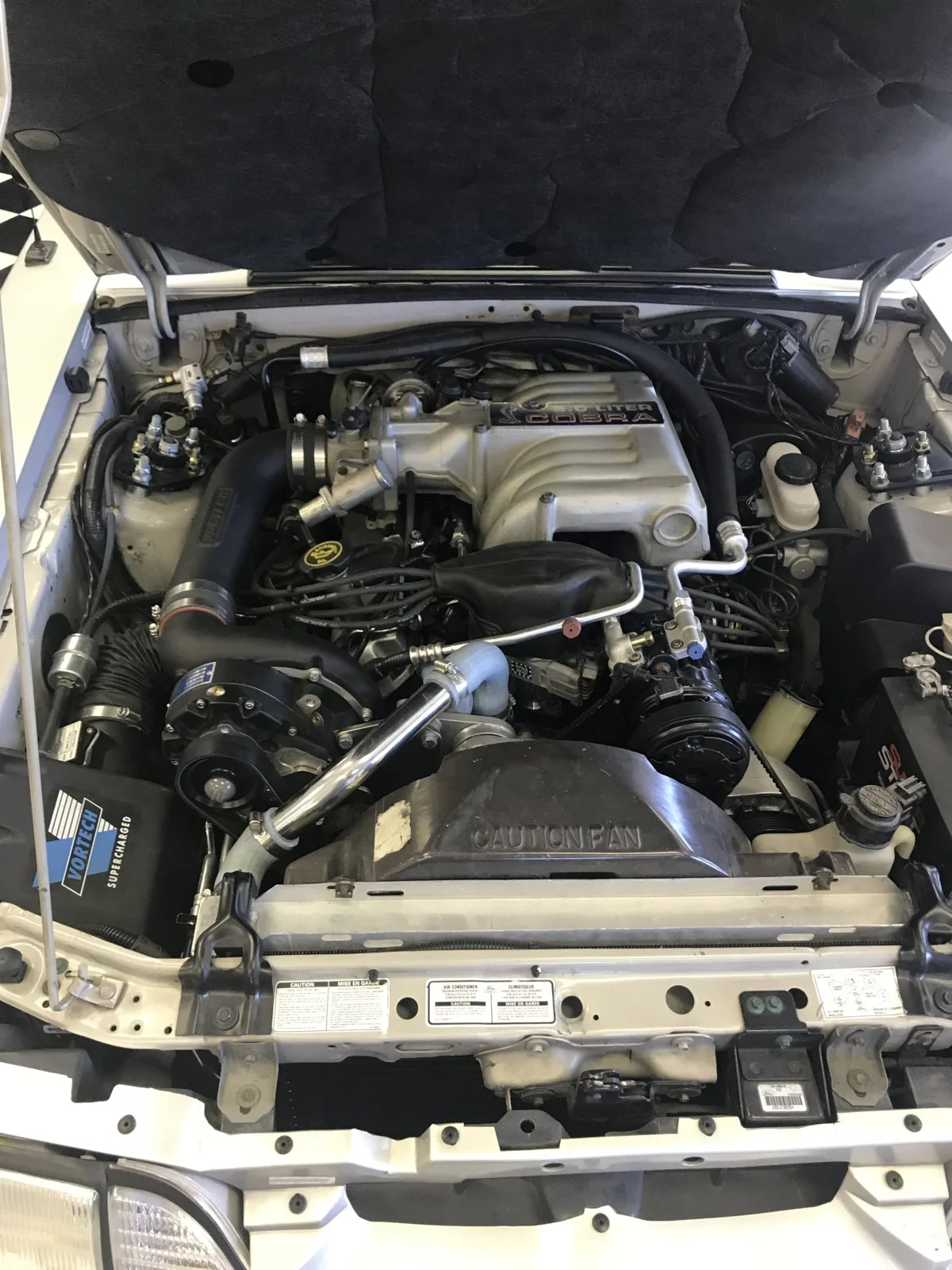

What is the difference in Pistons say dish, flat top etc? If one is going to run 11r 190s is their a certain type of piston I would need if I ever decided to stroke the car? Also I if I am going to run the V3 does that mean my alternator would be moved to a different position than stock? I was planning on the 3g black since I’m going that theme but when I checked out the hatch at lmr I couldn’t find the alternator anywhere but it’s obviously there but I’m guessing moved down. I’m just asking bc well I don’t know, plus I could save some cash from buying the blk alt and get the silver 3g instead for cheaper if I’m going to have to relocate it anyways. Thanks

The alternator is moved to the air pump location to make room for the supercharger.
If you build a stoker from a 302 ....you'll need new pistons.
The alternator gets moved down below the air pump actually . You either keep the air pump or run a delete pulley . I have a delete pulley . You need it as far as keeping the belt tension and not rubbing the brackets . As far as pistons . You need a twisted wedge specific piston in A stroker kit . The reason is the valves are not at the standard degree angle of a typical sbf head . So the valves will crash into the pistons if this isn’t done . As far as the dome . That all depends on your combustion chamber size . Some heads have such a large chamber which brings the compression down to a point that you could use a flat top . The way my heads are sold with the 66cc combustion chamber and the size bore I needed - we opted to use a reverse dome and then customize the actual cc of the dish to get compression where it needed to be. This is all something I’d discuss with your engine builder when explaining your goals . I hope this helped a bit ! Any other questions feel free to pm me . Here’s a pic back when i had the standard brackets as it was going together . You can see where the alt and smog pulley sit .

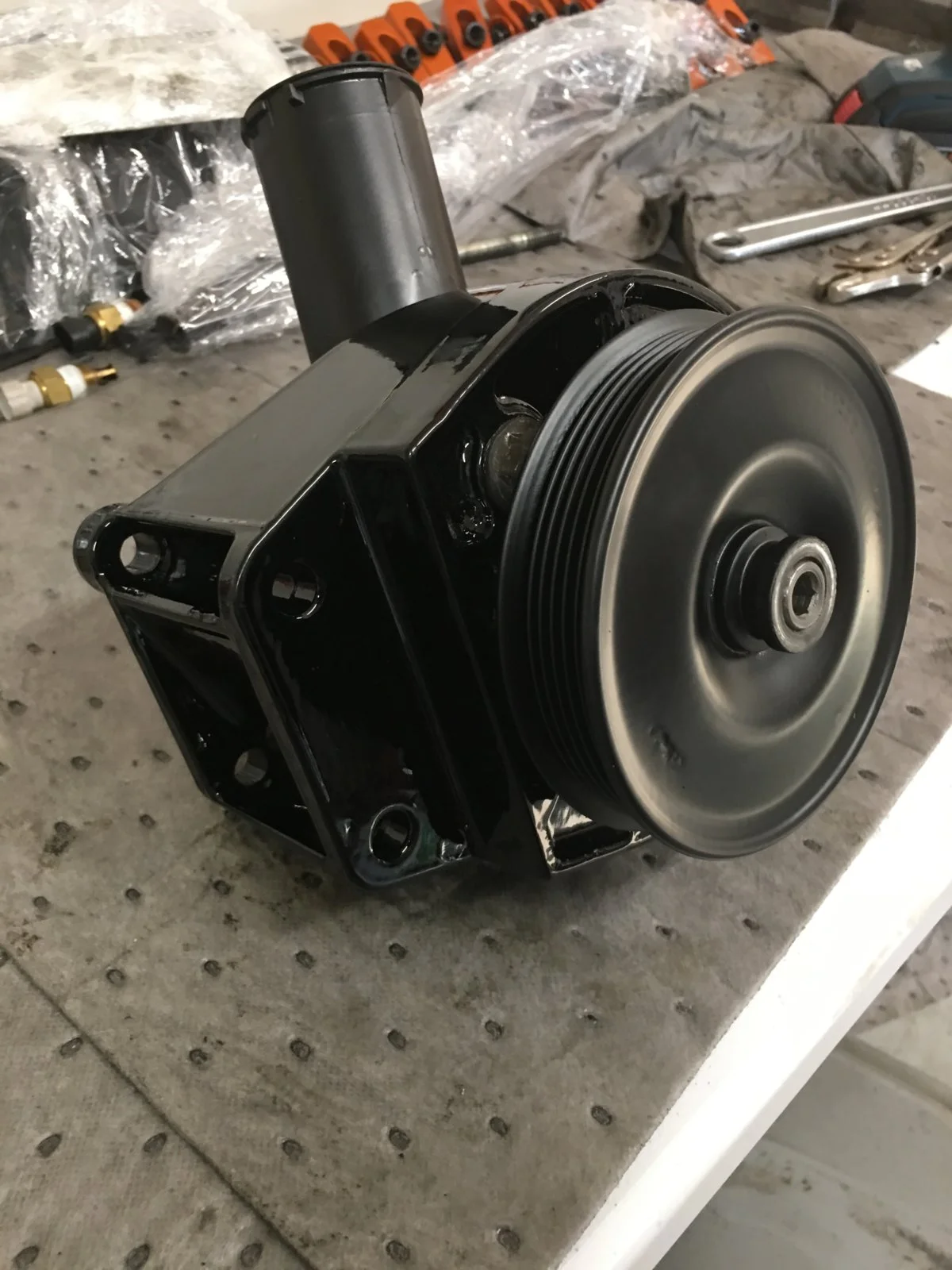

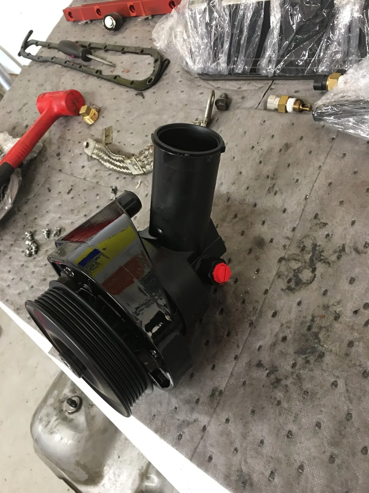

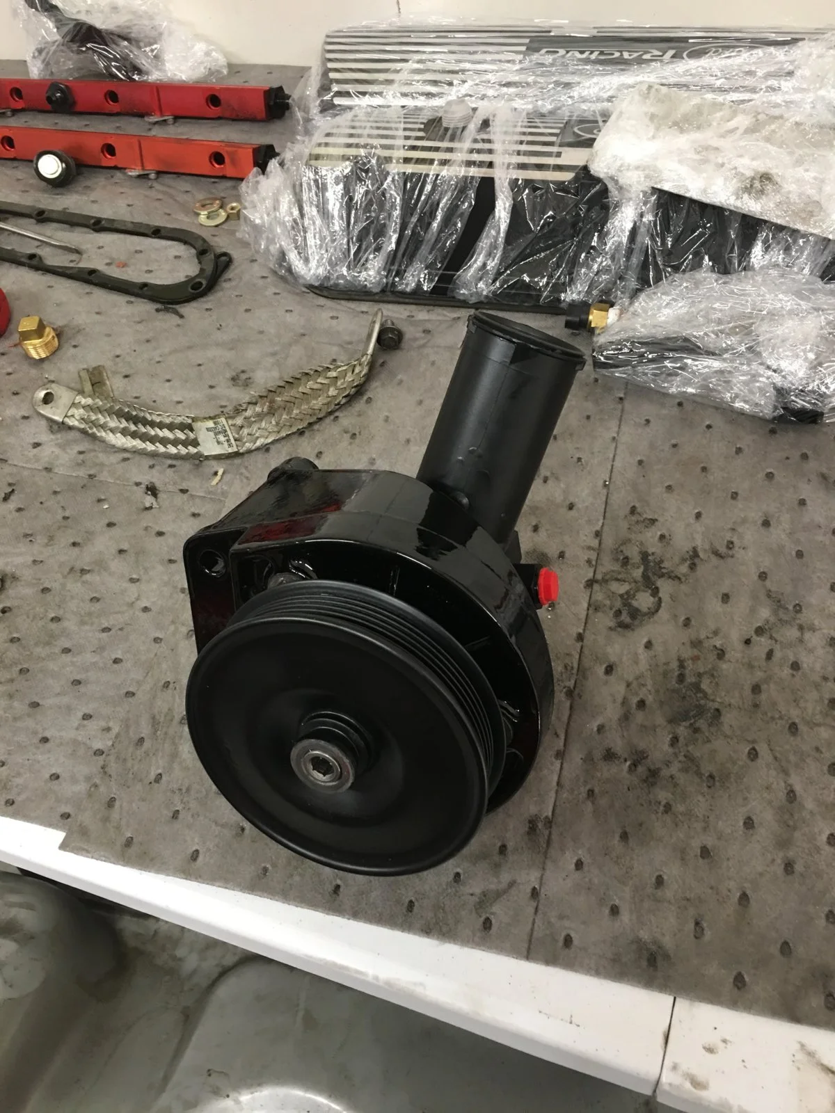

Got a little bit done today. Mounted batt box again . Assembled new ps pump with all the fresh powder coated brackets and pulley .
Think it’s gonna really look clean this time around.

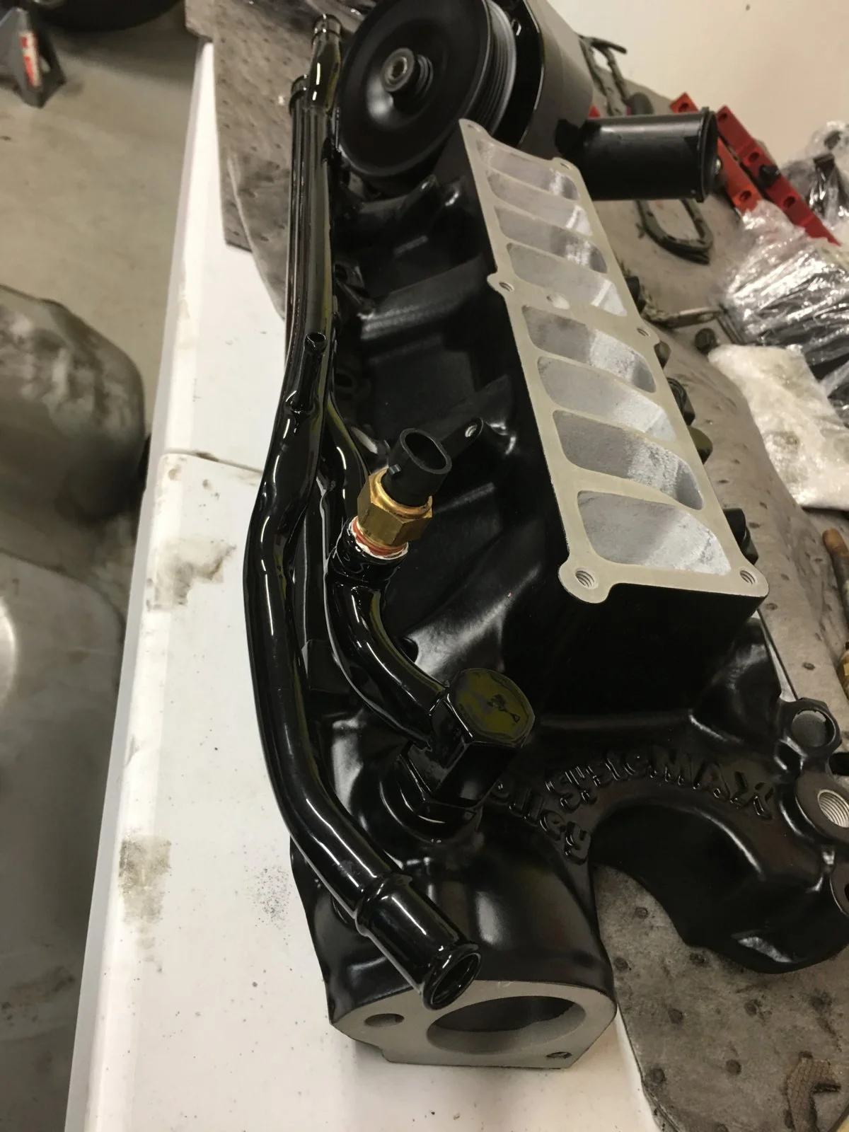

Intake coolant pipe In gloss vs matte has a nice finish
Man that’s nice! Thank you for explaining a little I appreciate that. I still have my smog pump but have been considering deleting and getting that delete pulley. Just ordered my alternator but for the moment I’ll just run it in the normal location, gonna install that and my mini starter.
Well you’d have to run it in stock location . It only moves when you use the Vortech bracket or a low mount aftermarket bracket .
