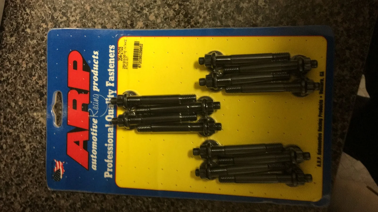

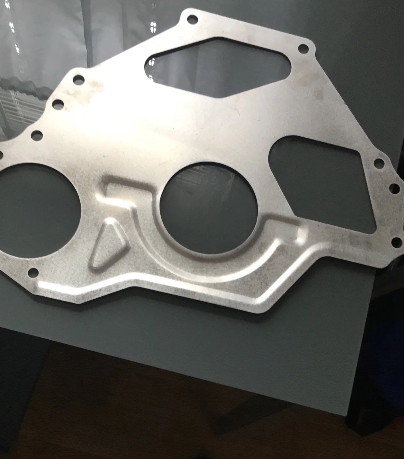

Ordered the block plate that goes between the bell and the aod , also ordered the fancy arp intake stud kit . Incase I ever have to do intake gaskets again makes life like 8000 times easier .

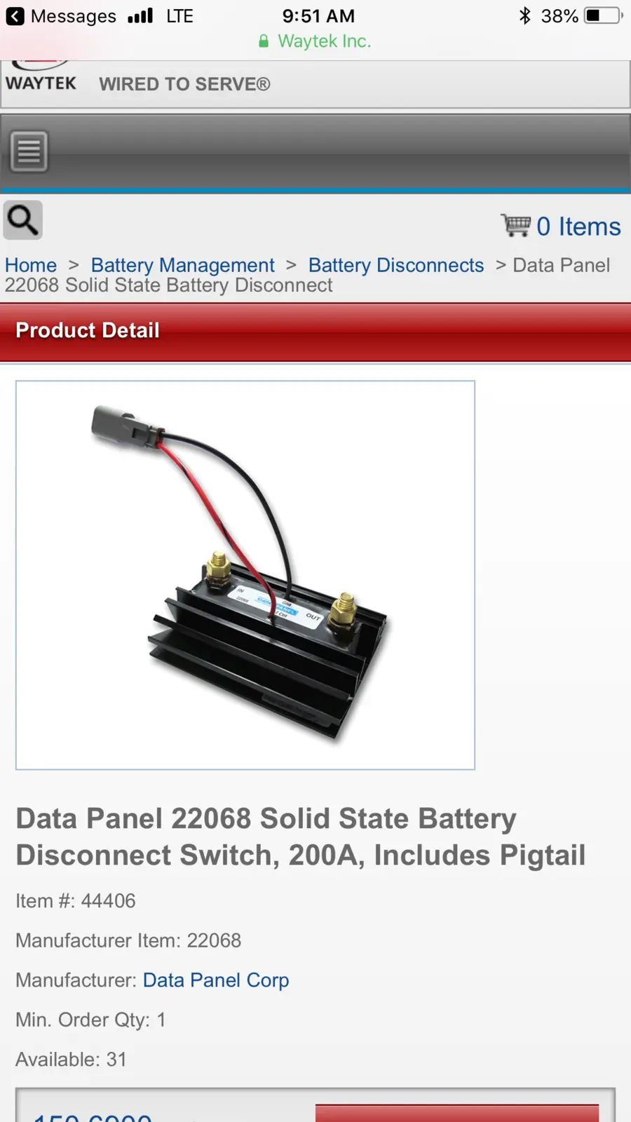

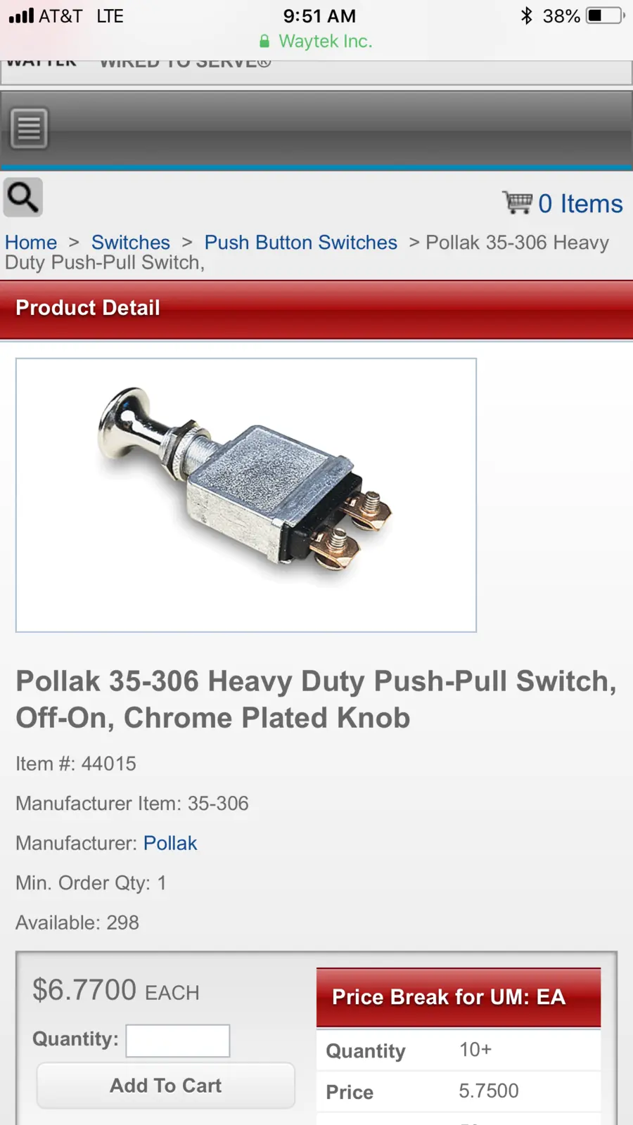

Battery cut off ordered .

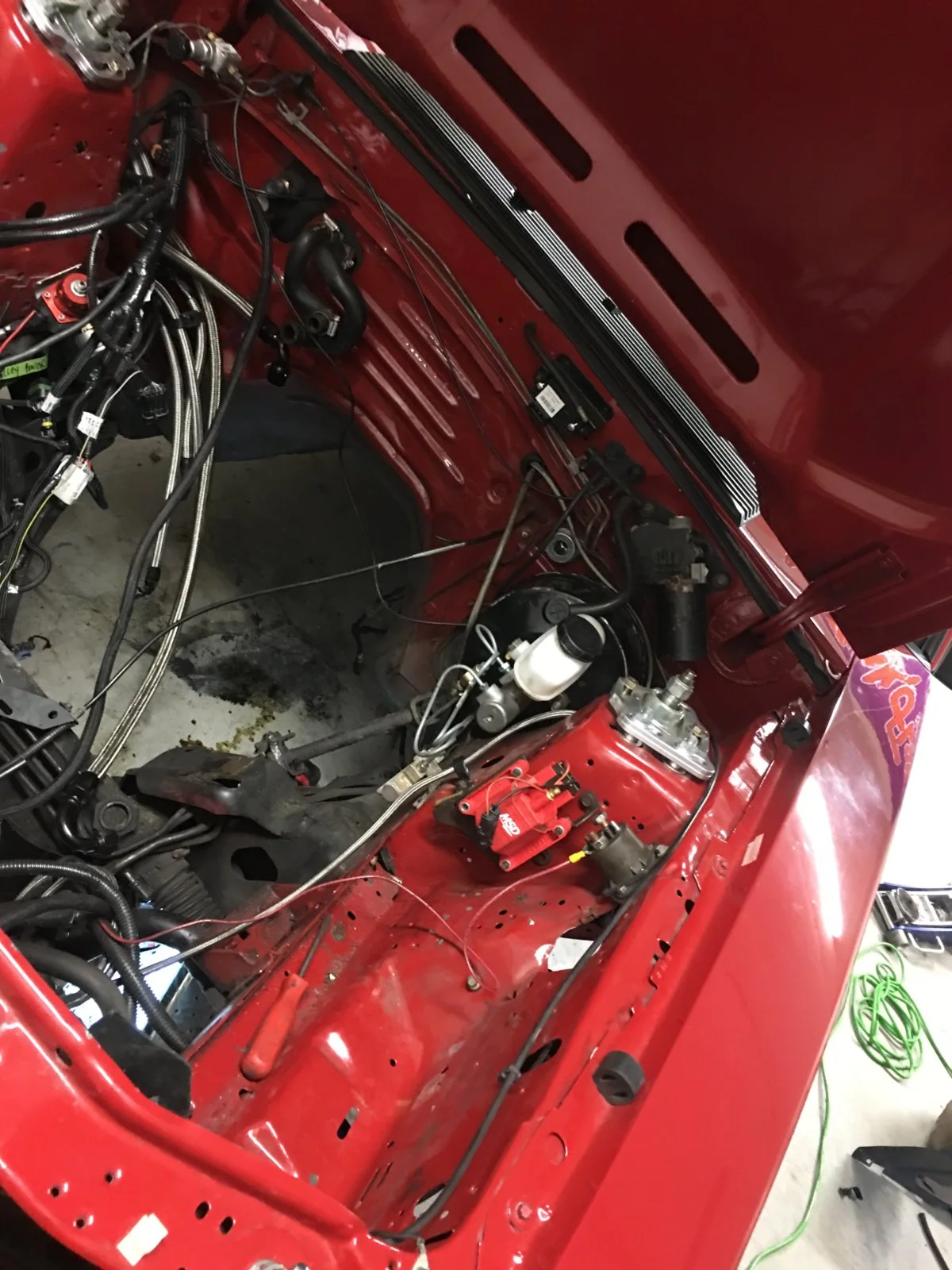

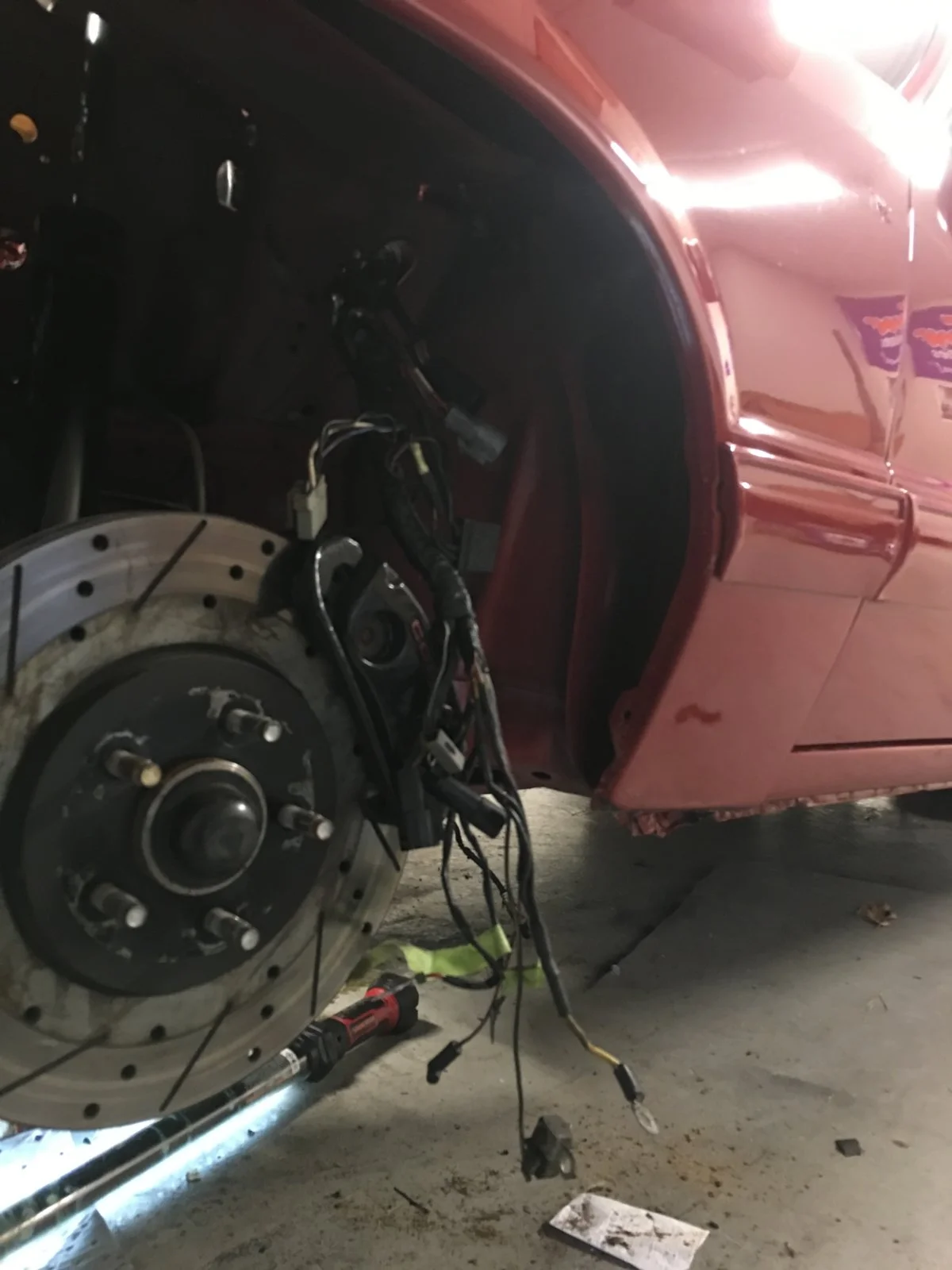

Starting tucking some of the harness tonight and got the battery cut off switch mounted
