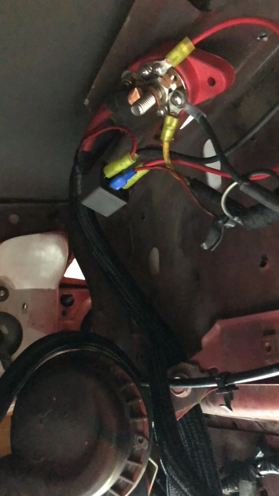

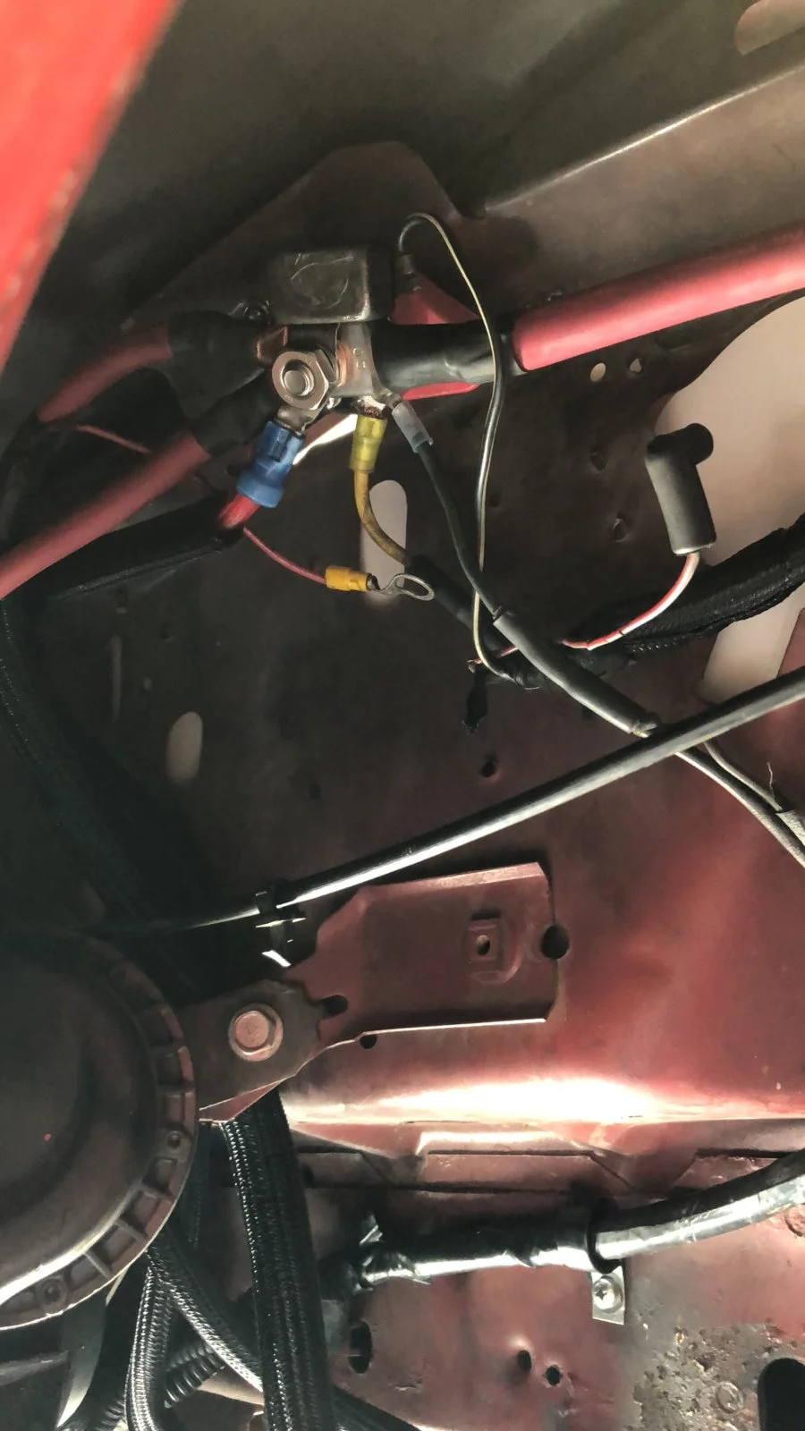

Yeah this is all up in the top of the fender . 30 amp relay just just taking the place of the oem solinoid to trigger the sol on the mini starter now .

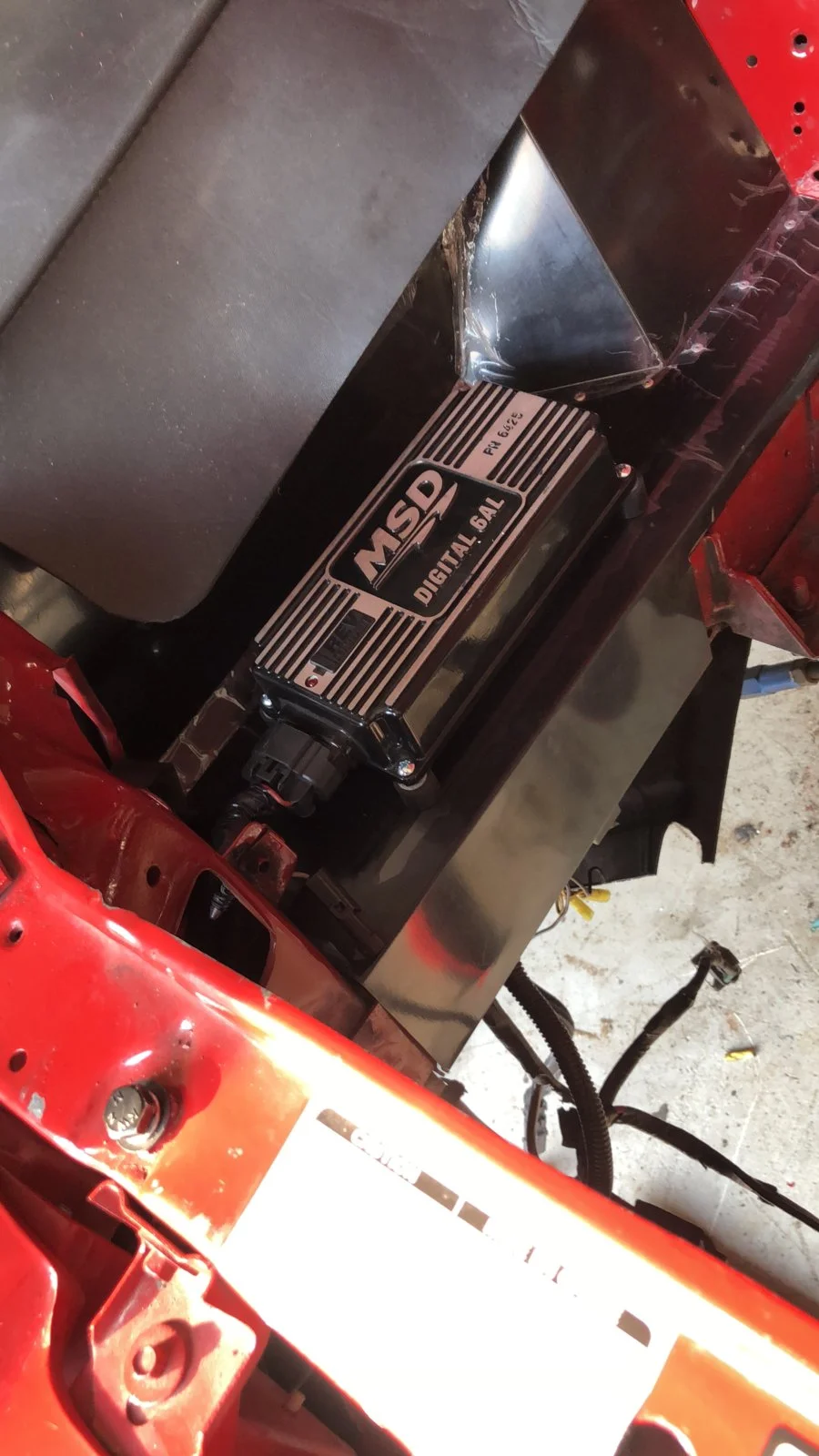

Going to a dual sync now . I had the tfi on it with the ability to bypass the msd if needed .

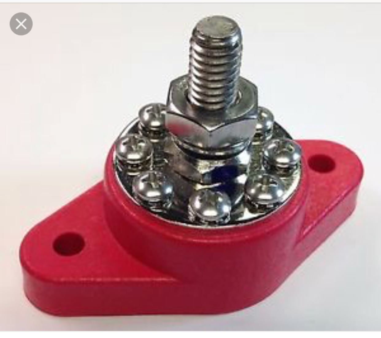

Pick up a couple of these as you have the time and think of it:
It's just a distribution bus. They come in Red or Black (of course) and you don't have to rewire the car or tear it apart to add them. Some dielectric grease and *poof*.
I must confess I have a problem with these things. I put them on everything. LoL

Needs a driver side tie rod anyway. So I ordered a new 2.5 turn rack for it . After getting frustrated with the wiring in the fender I finally decided to ditch the stupid ford relay and just put a junction there . Use a 30 amp relay to trigger the sol on the starter and be done with it . Got the msd box mounted to the Scott rod panel as well
Still have to zip tie all the wiring neat and arrange it all . It’s just kind of up there to make sure it all fits . Test fitted the fender liner too and were all good there. The 2/0 wire I used should handle whatever I throw in the car . I have it fed through the fire wall where the cruise crontrol stuff used to come through the grommet . I like the idea of the power cable in the car rather then under it .
Spoke to my engine builder Tuesday . Heads are on and he was checking pushrods and it turns out I needed .200 longer pushrods . No big deal . So we should be on for Saturday to pick it up .
Totally doing this to my car. I don't know why I didn't think about ditching the starter solenoid for a simple 30amp relay. I have plenty of those laying around thats for sure. I was already looking for at getting a junction block, since the stud on the solenoid isn't very long anyways by the time you have the battery, starter, and alternator cables attached.

I like these . Work just as well

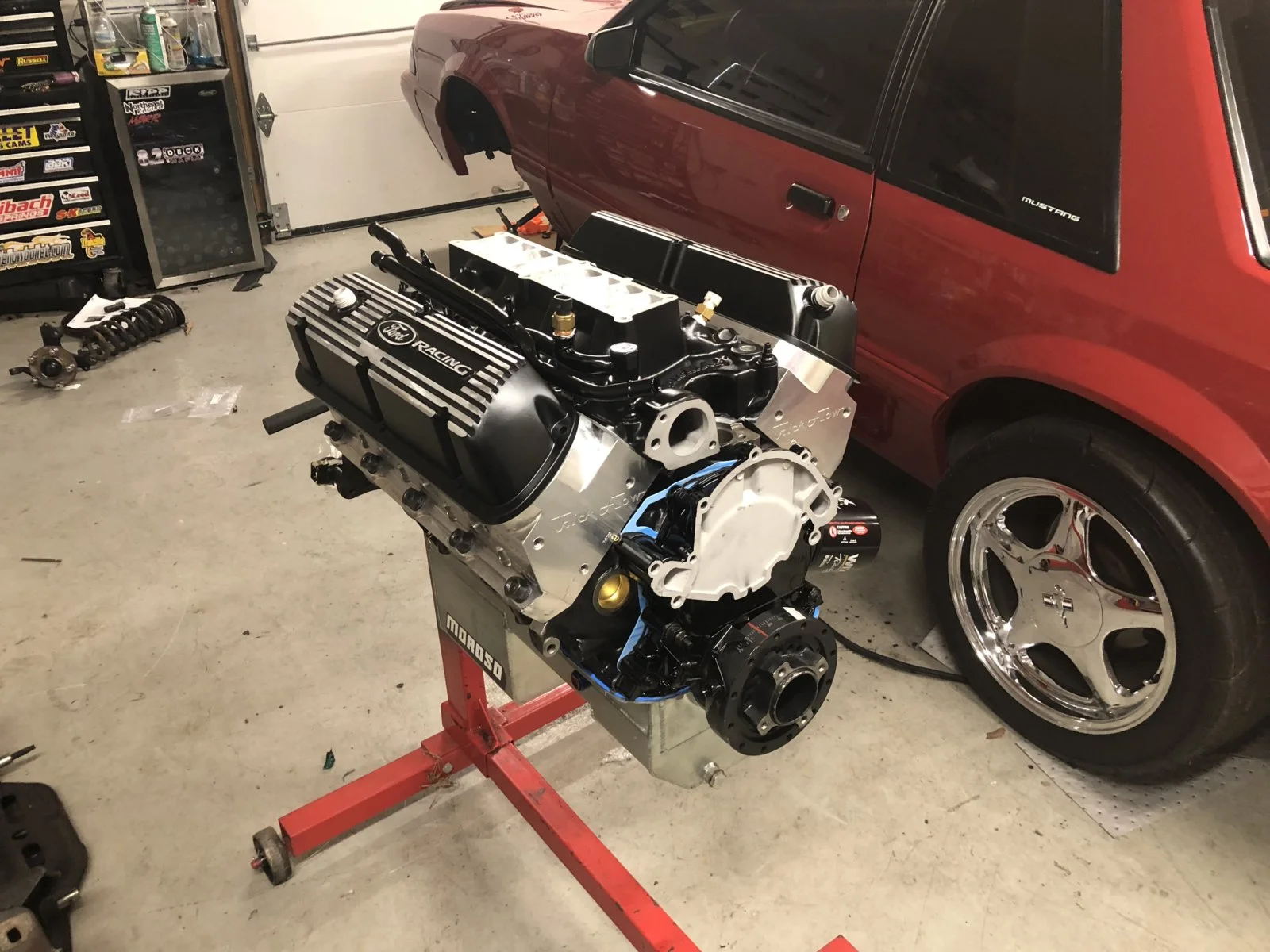

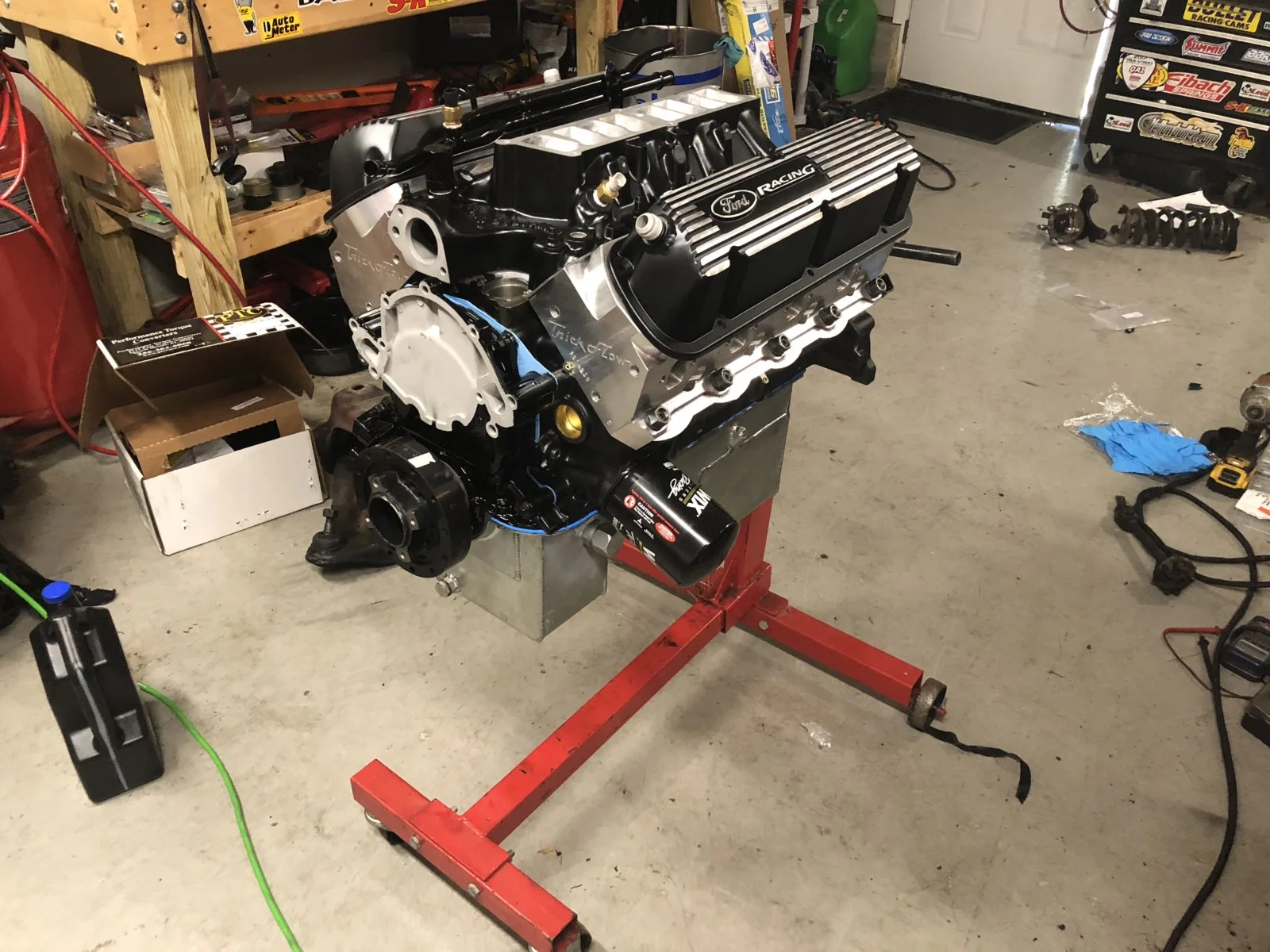

Oh
my
glob
Is that one of those boring ole Windsors?

Just a boring 8.2 deck
