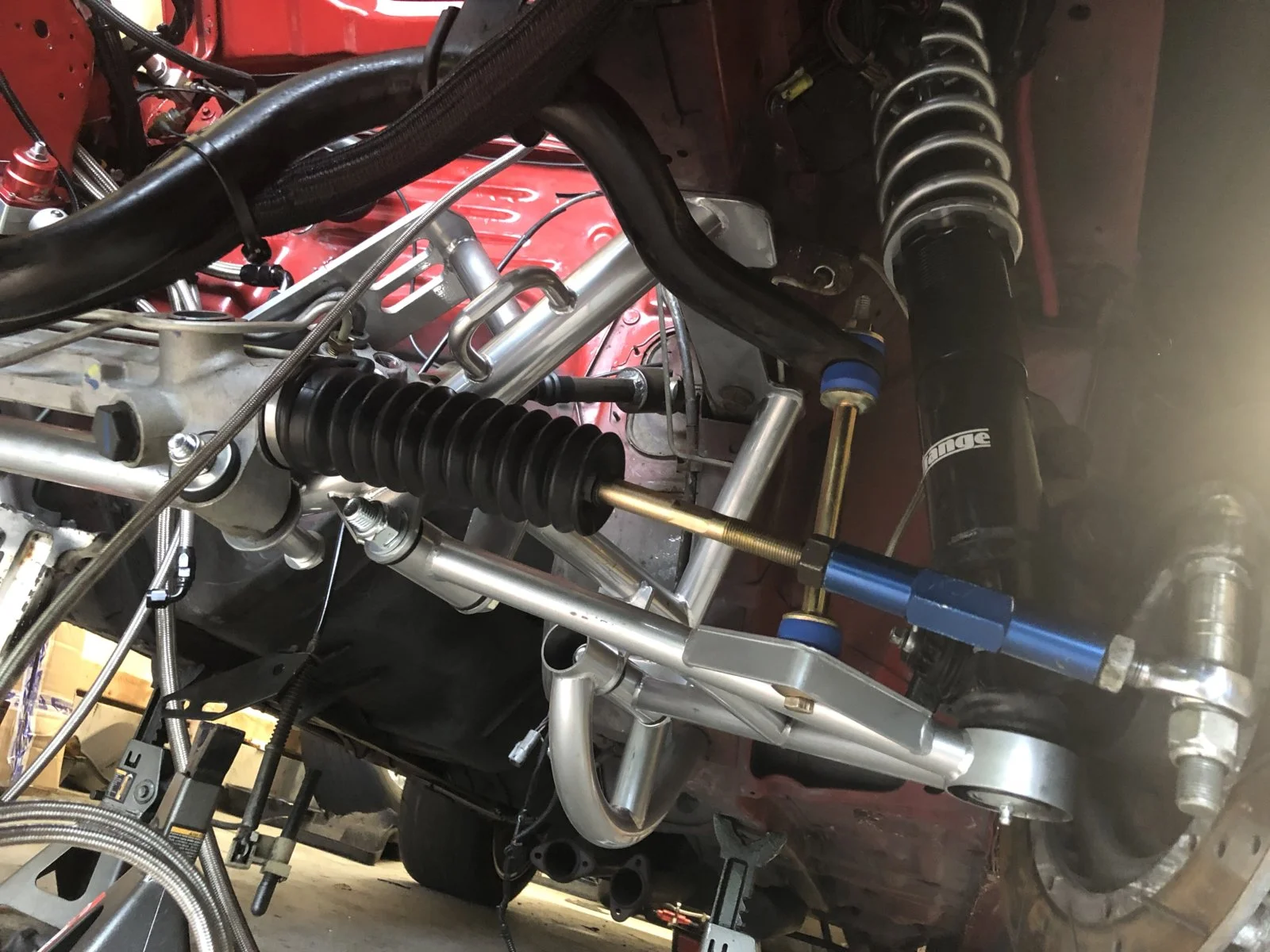

Will you be using D/A struts/shocks and A.R.B. ?

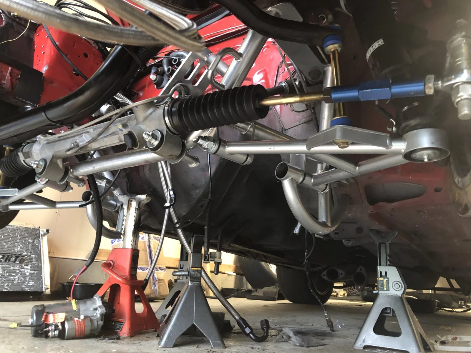

Strange 10 ways front and rear , UPR complete front and rear suspension minus the team z drag spring .
Eventually the rear sway bar will be replaced with UPRS bolt in ARB

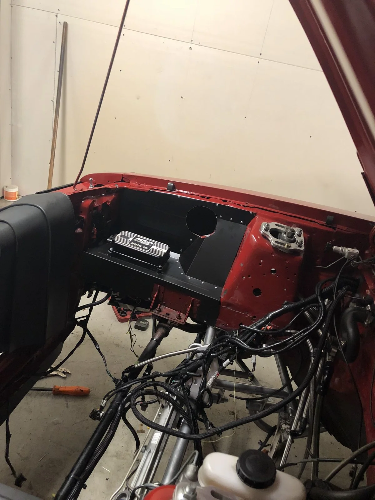

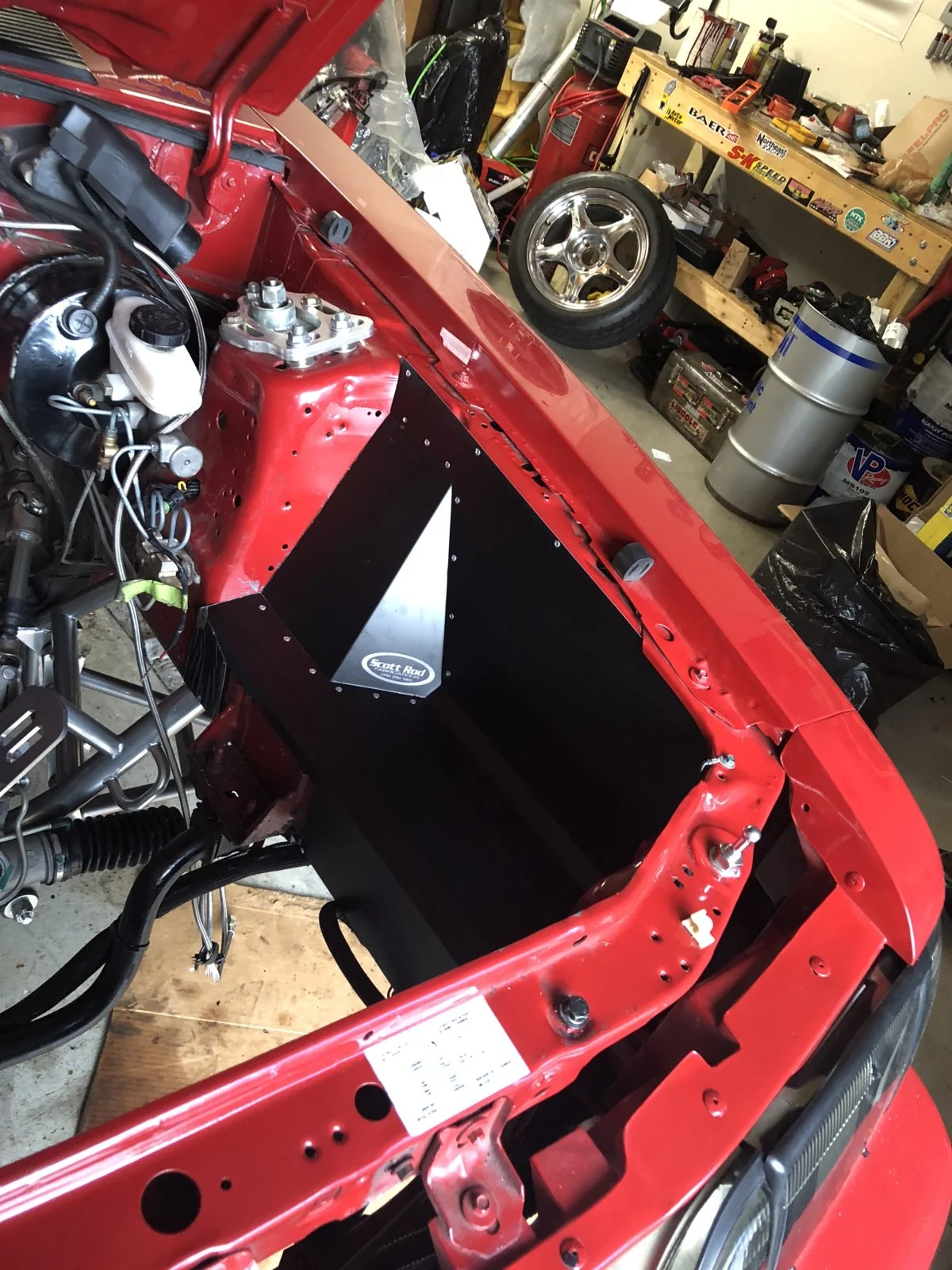

Got the new panels riveted in finally . Pass side will get a rubber strip for the hole where the pipe passes through . The pipe covers up the little bit of red you’d see from behind .
Have a few things to check with k member alignment then I am almost postiive I can drop the motor in the car .

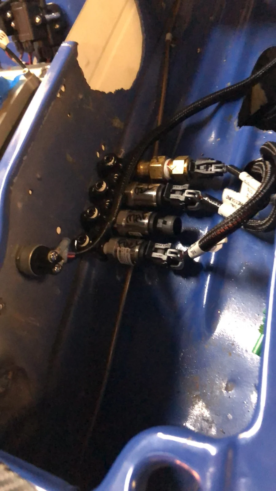

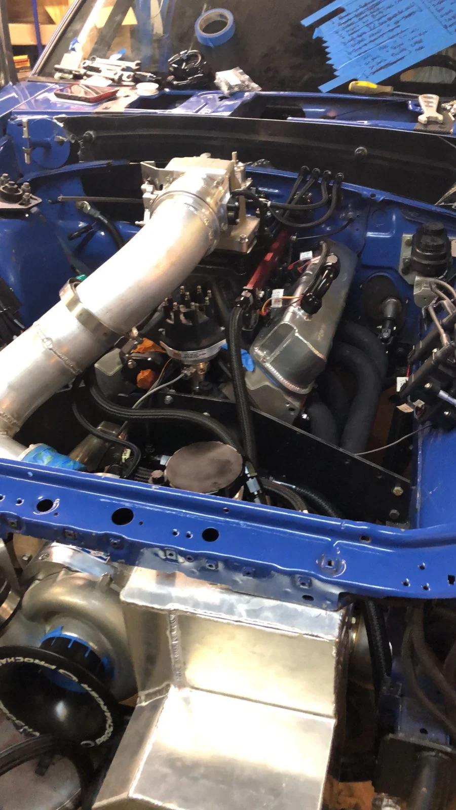

Got this running Monday . So I’m just about done and if it cools down I can dedicate time back to my car again . Full chassis wiring , including lights , double trans brake button , line lock , full Holley EFI that I cut the harness in half and did a firewall plug . Re routed al sensors into the wiper cowl on a log and also Plummed entire fuel system . With a host of other stuff .
500lb injector stuck open on us so they had to go back to billet atomizer .

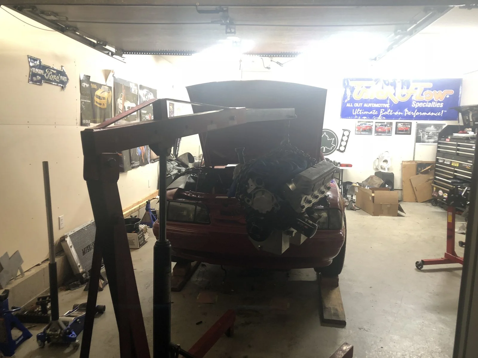

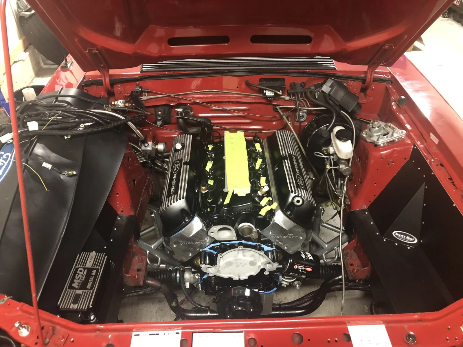

Had my buddy come over last night and we plotted the car out , turns out front to back on both sides I got the k member completely even . Going across in an x the k member is less then a 1/16th off . I’d say it’s pretty damn square . Motor can go in now . I do have an issue with the wheel being forward . I’m gonna talk to Collin cuz he had similar issue . If his stock arms fixed it that’s the route I’ll go .
