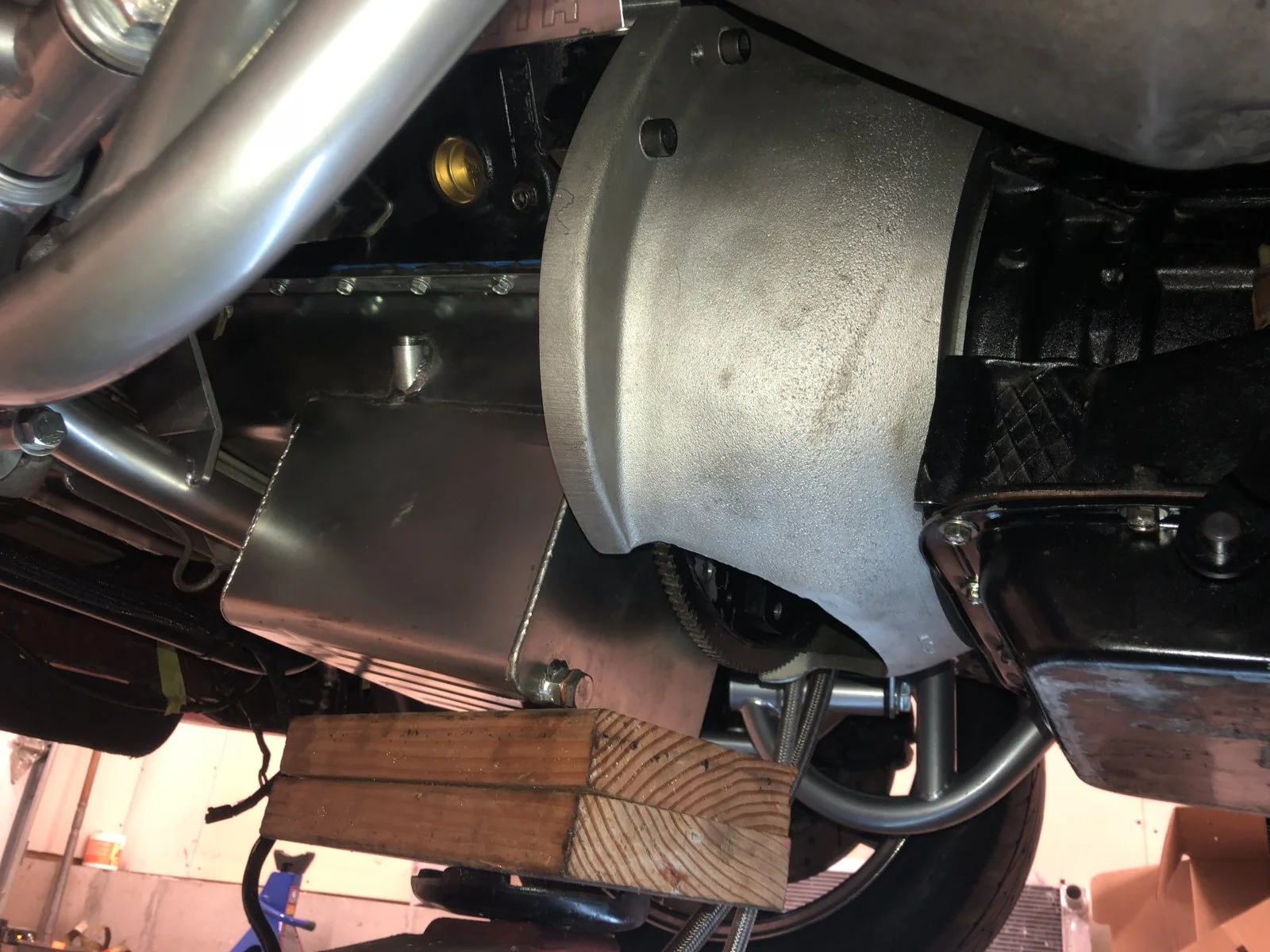

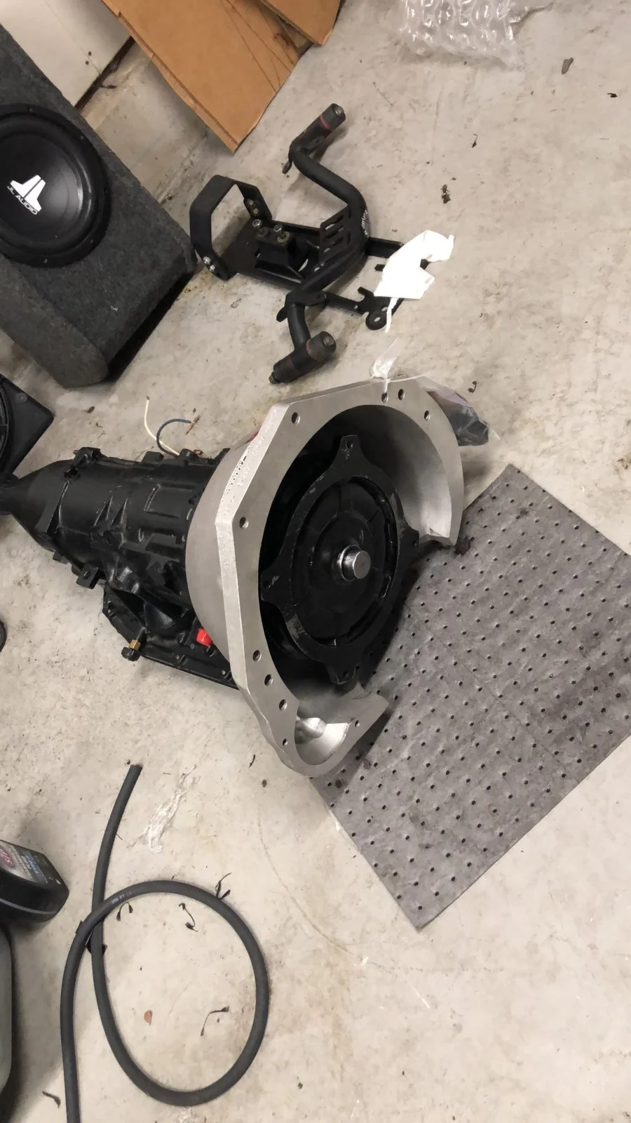

We’ll , checked the converter snout out tonight made sure it slides in and out of the crank with no issues . Mocked it up to the flex plate . Installed the flex plate and block plate
Opened up the trans pan to remove the stick shift lever and replace it with the aftermarket one that lets you run what ever shifter .
So trans is about ready to go in .

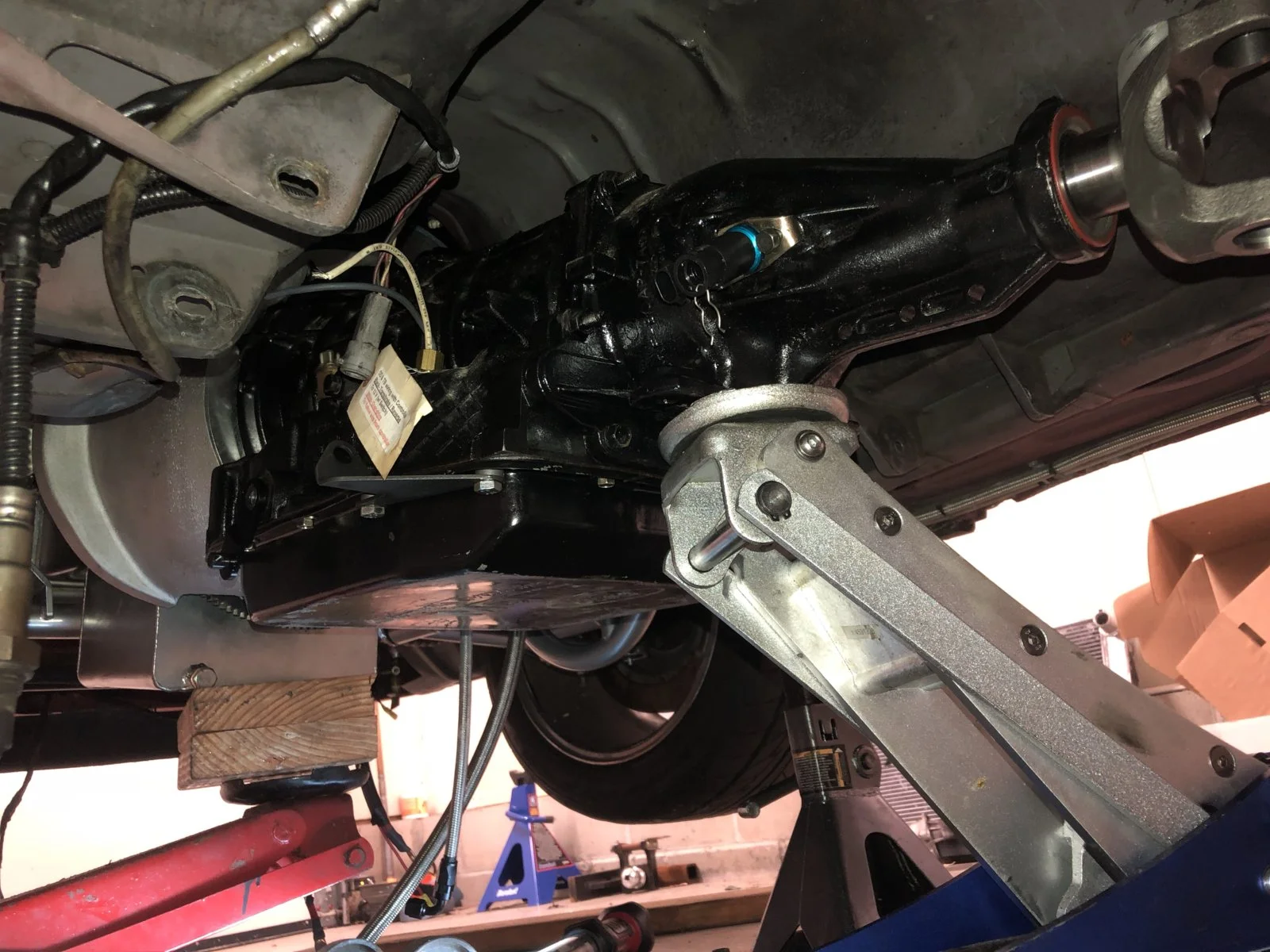

10 steps forward 9 back .
Converter seated in the trans and we have a 1/2in of space between the converter pad and the flexplate . Why ? I have no idea . Brought converter forward it slides into the crank no issue spins free. Seat it back on the pump . Same thing spins free but seems excessive . Spoke to Brian Freezy . He’s gona call dusty at ptc and see what he says . Converter may have to go back and get modified to get us to that 1/8-3/16th pullout . Normally I’d say yeah well shim it and be good but this seems excessive

Wonder if it's an issue more with the sfi bell than the converter itself since the whole front of the case gets sawed off (and some of the "machinists" you run into these days shouldn't be anywhere near a hand drill let alone a mill).

I mean it looks like it was done very well . Freddy brown is the one who did it so but we kind of thought the same thing more along the lines of just the bell playing a part in it . Dusty from PTC advised me to pull the converter 3/16th forward. Measure and make sure from pad to flex plate that it came forward from my original half inch I had . Check and make sure the snout is slightly engaged in the crank and then shim it to be there and call it a day . If it isn’t engaged then it has to go back to them

Correct . So the pull out is correct and it doesn’t jam the converter into the back of the crank and wipe the thrust out

When I did mine, I took a straight edge across the bell and measured to a conveter bolt pad with the converter all the way on the input snout. On the flex side I used a dial caliper thru a bolt hole to the seperator plate. Subtract a from from b, and voila. Too much pull out and the converter snout lugs won't engage the pump gears, and, well, bad news bears. Too little and you wipe a thrust bearing and, again, no bueno.
What flex are you running btw? Some are just not right because "aftermarket". I'm using a tci one (with a stock v6 trans and converter to get it running) and it was right in range. There also wasn't much excess thread on the converter studs so don't know how well too big of a spacer would work.

PA performance SFi flexplate , the converter is threaded itself and has bolts or studs . All the room with the JW bell it isn’t a pain in the ass use the bolts . With the washers seems it will still have plenty of engagement in the threads . I think you hit the nail on the head where this is one of those things lots of aftermarket parts trying to jive together .

So I guess when i checked the flexplate and matched it to the converter bolt holes on the bench . They were off a hair so you’d get one in and the rest were off enough to not catch any threads in the converter .
You guessed it . I pulled the trans . Pulled the flex plate . Opened up the holes ever so slightly to make sure the bolt holes on the converter were now centered . Put the trans back in . Shimmed converter and that’s done . Tried to fit the headers and that’s a whole other story . Tomorrow is a new day . I’m burned out

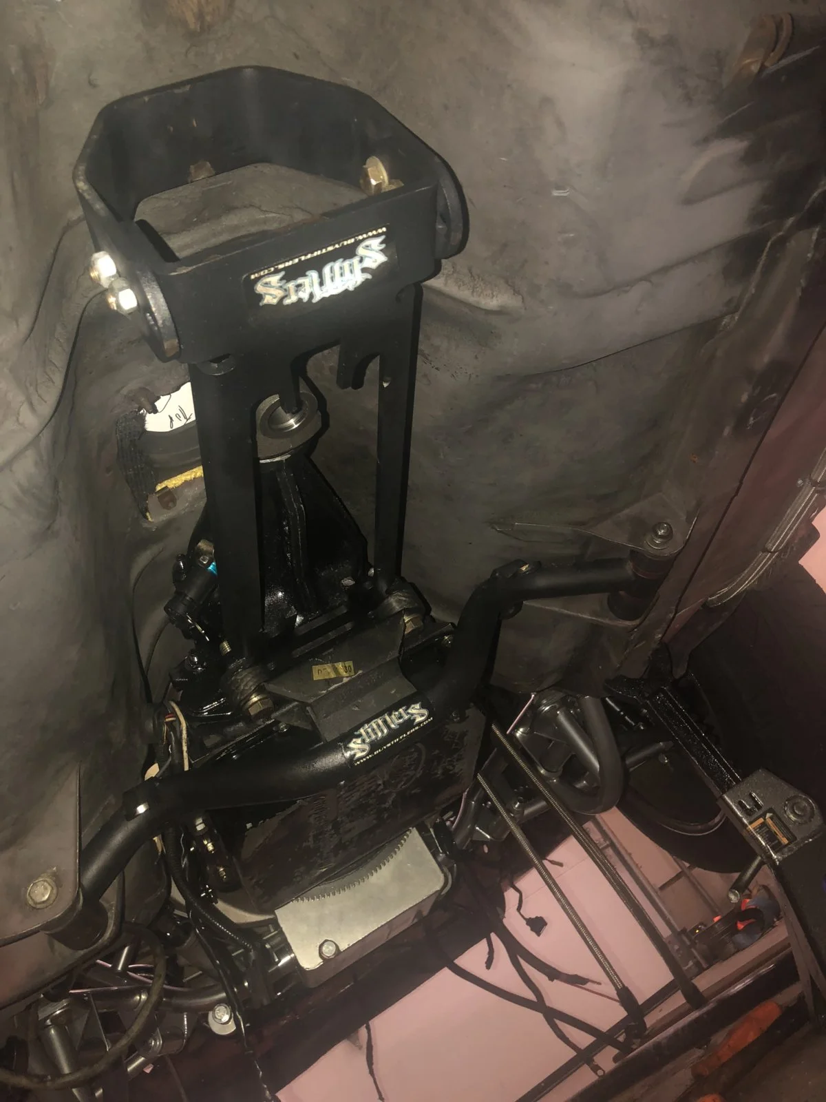

Here’s a pic for a laugh.
