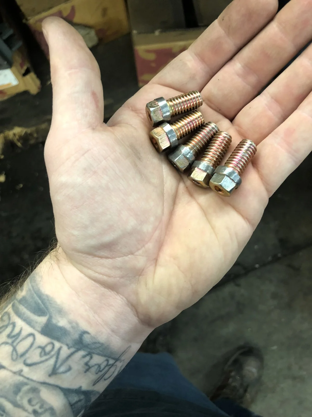

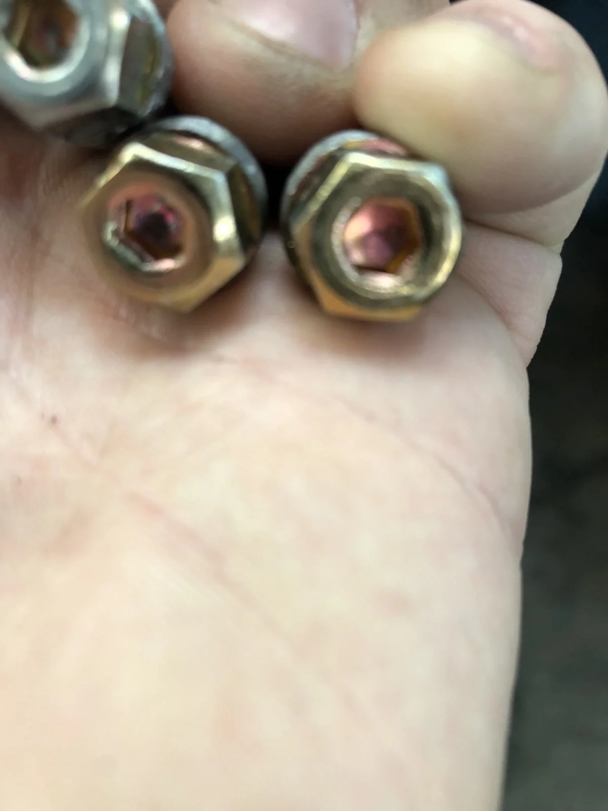

Apologies, they were kooks... the description for these is either wrong or they sent me the wrong parts.... there were actually 2 different bolt types in the bag one set had an allen head and was tapered. I will post the part number from my summit order but when i get home if i still have the bag i will post the number from it if its different.
KOK-SB-B60027

Don’t think they’ll fit , you have a link to the 5/16th bolts you mentioned ? I’m back from Florida from visiting family so time to get cracking
5/16 thread, just so we're on the same page (highports are weird, the normal sbf stuff is 3/8 thread), theres not a "kit" for them I just got like 4 packs of five 5/16-18 by 3/4" long bolts from arp (through summit). Still use a 3/8 hex head iirc.

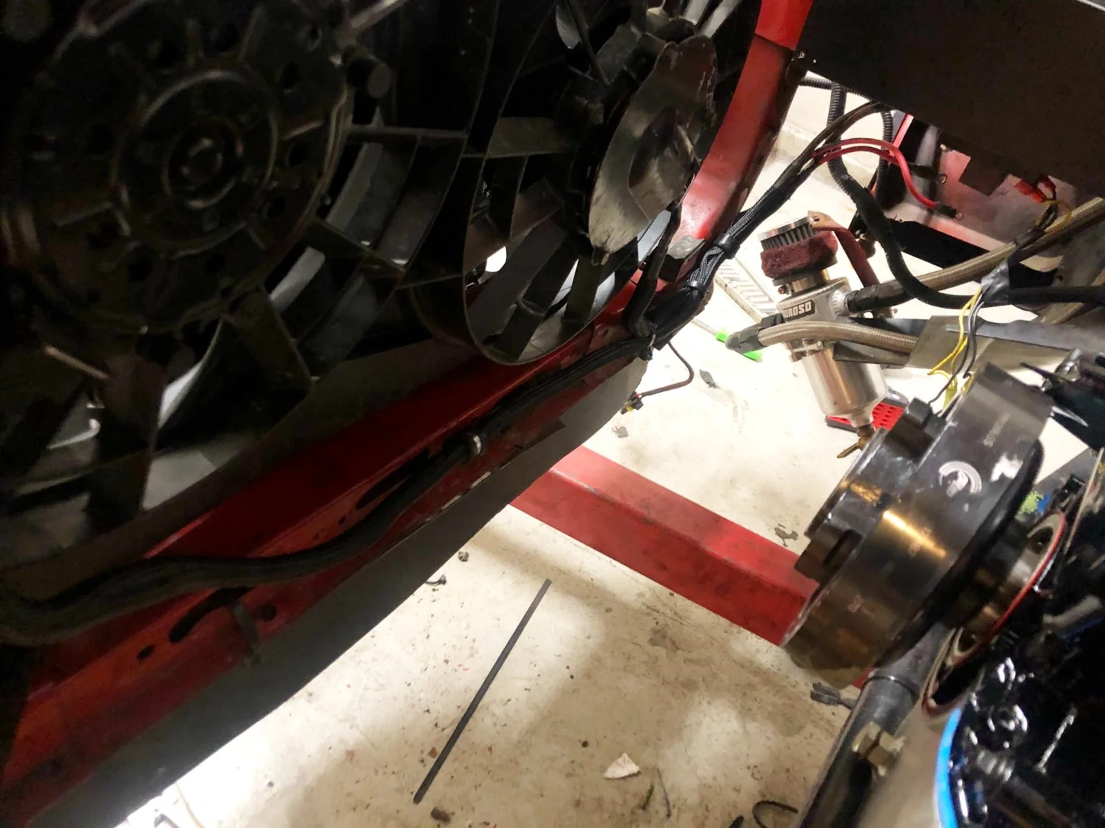

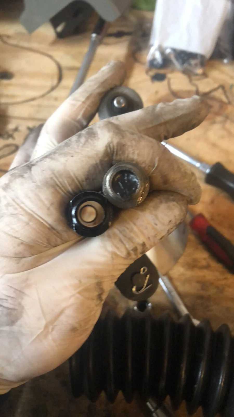

Update - headers are officially in and in place . Oil pan hits the rack so I ordered offset rack bushings . Pulled the rack out and knocked the bushings out Friday . Just waiting on the new ones . Then I took the advice of a friend and looked into my shift lever . Apparently Freddy brown silicones the end shut . His valve body must expose the lever to fluid where it normally wouldn’t be or something . So I pulled my new one out of the transmission . Sure enough it was open . So I right stuffed both sides and let it cure all weekend . Reinstalled it last night .

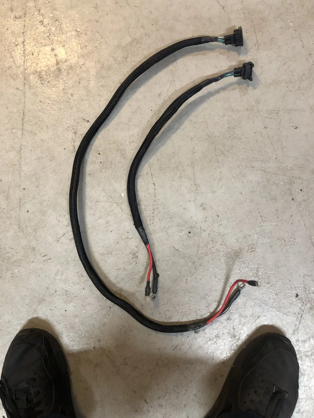

Last night I made a list of what needs to be done about a mile long . Started knocking away at it . Re did the wiring harness for my fans . Made the wiring harness for the trans cooler fan which will be piggy backed off the main fan relay . Each relay can handle a 70 amp load so no issue there and the trans fan has its own inline temp switch. Got the leash relay setup so now all I have to do is tie in the ground to the Holley and the ecu has control of the fans . Went through the msd wiring and got that all re sorted out .

I like that black loom on the wires. Where do you get it?
Amazon . Mesh split loom it was listed as like data cable loom . It’s what they use on my Holley harness so I wanted it all to match
