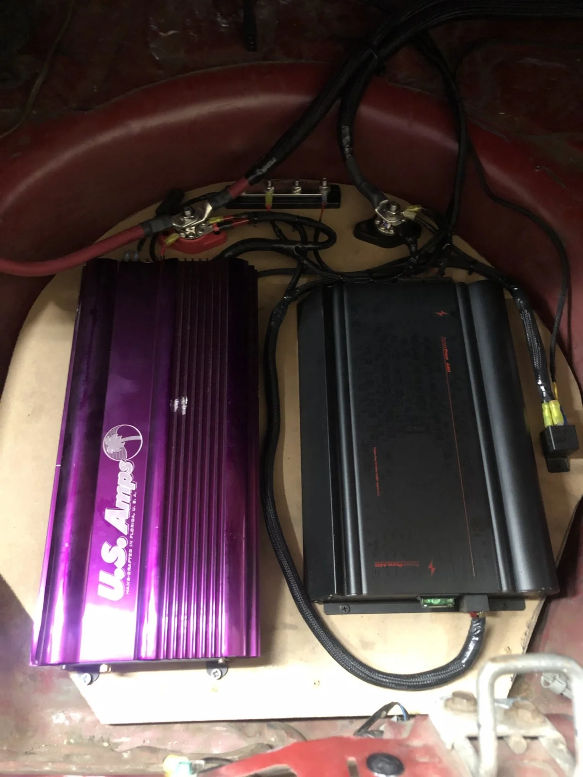

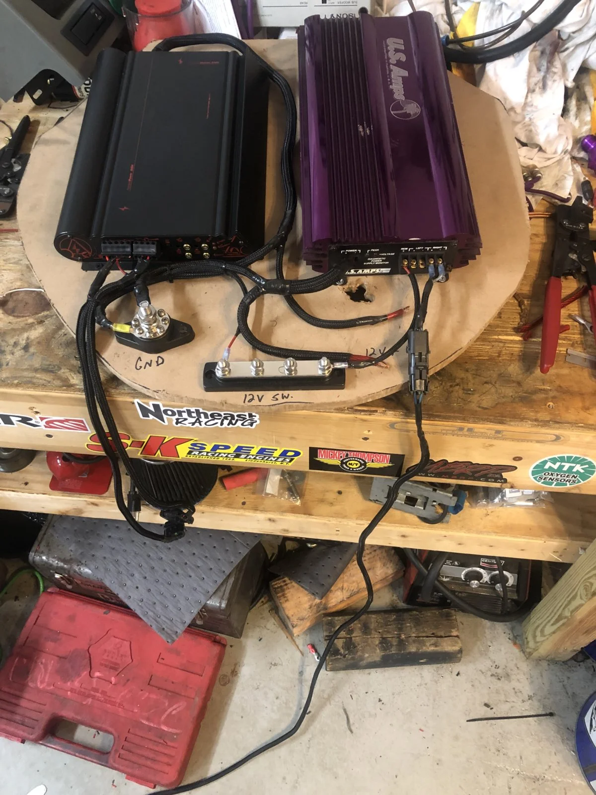

Did some more wiring on the board last night . Got 99 percent of the stereo wiring end done . Waiting for a new positive stud to come because i used the one I had up front . This will also get the relay for the fuel pump and meth stuff on it along with the pig tails .
Also re made a new rear speaker harness along with a weather pack end on that to make an amp change or removal easy . Hid my passive crossovers for the fronts under the rear seat and did the same with the harness with the weather pack plug .
