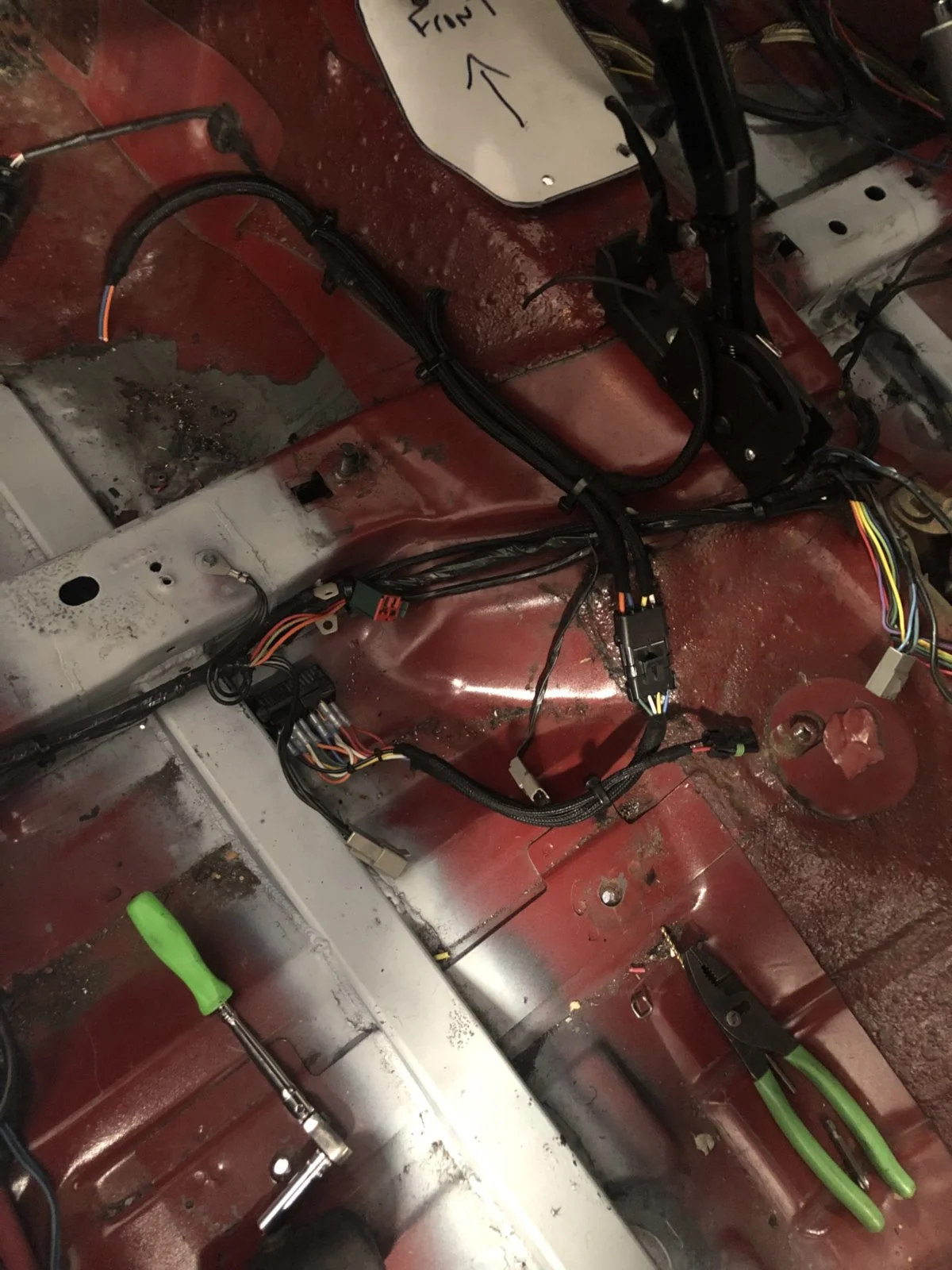

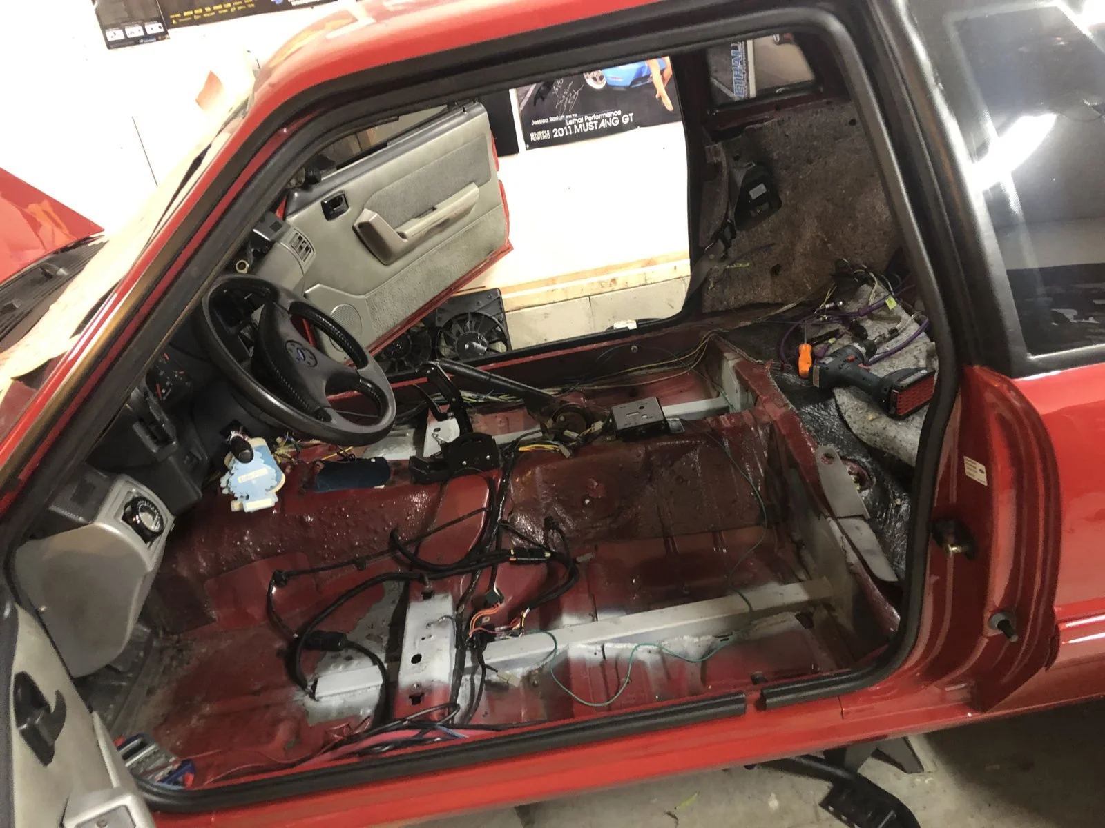

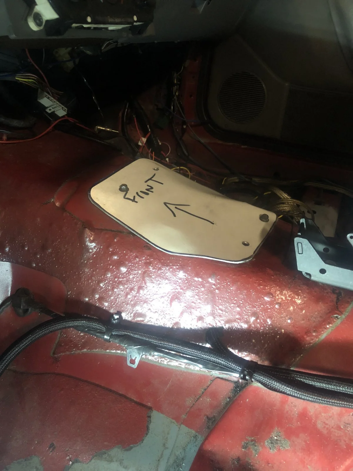

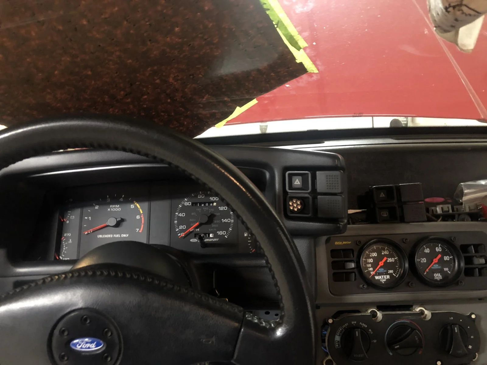

So the last 2-3 nights I have been working on this thing . I have some misc pictures . Basically I started wiring the trans for the over drive reset relay pack and the trans brake which turned into me ripping the interior out and re wiring any wires I’ve ever added to the car their . Nothing was unsafe or anything like that just was a lot of stuff that 21-26 year old me may have been ok with but now esp after wiring a full car I like things a certain way .

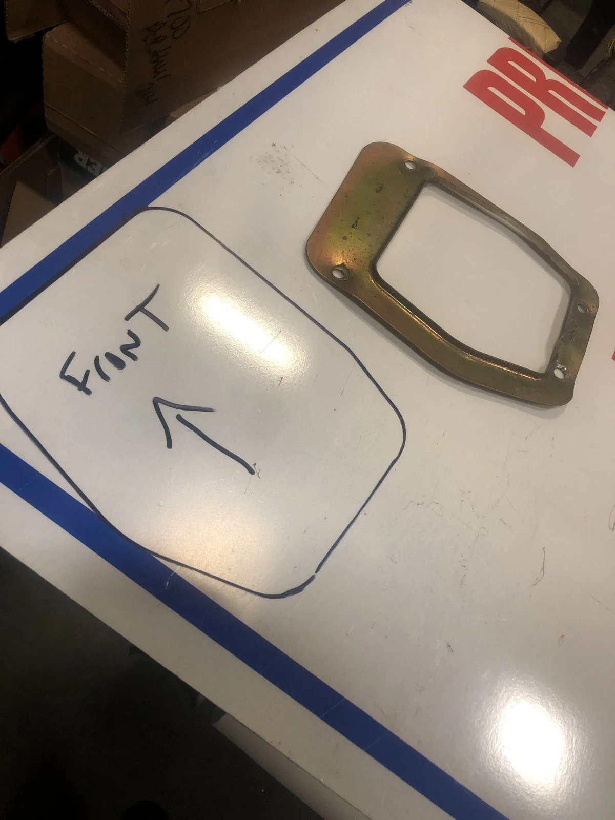

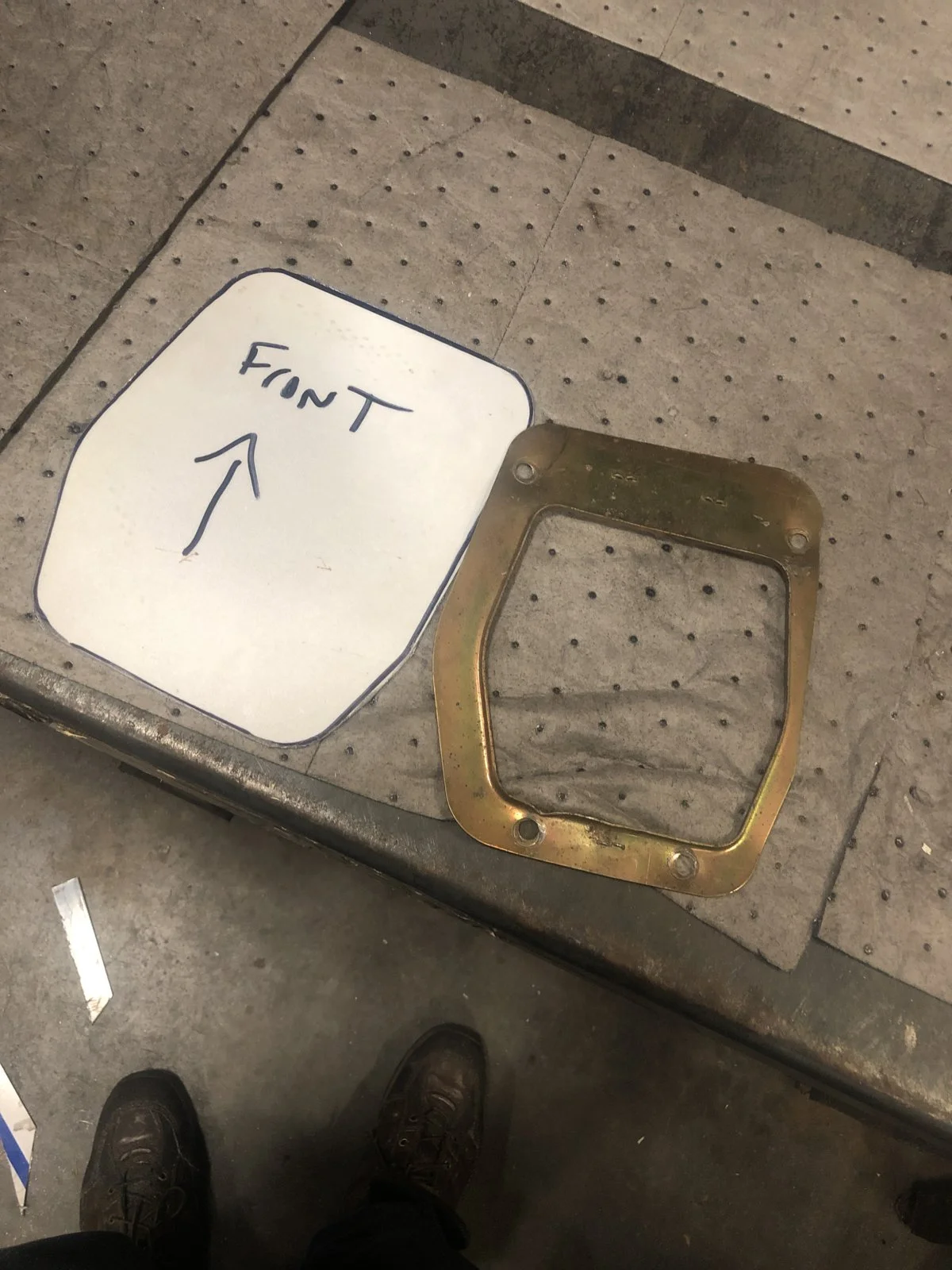

Finally mounted my ecu , made a trans cover plate using the factory bolts so If I ever put a 5 speed back in it isn’t a hassle .

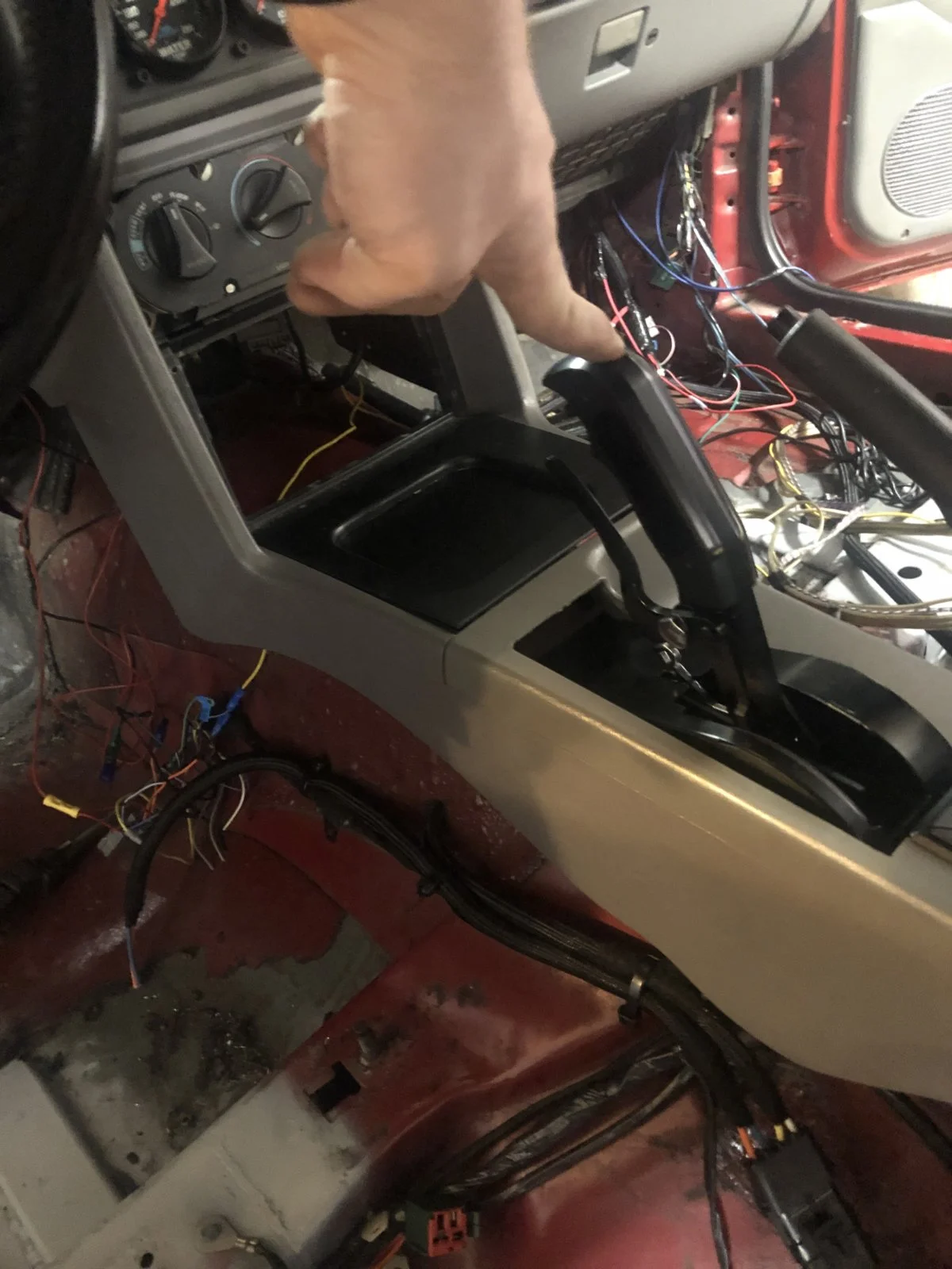

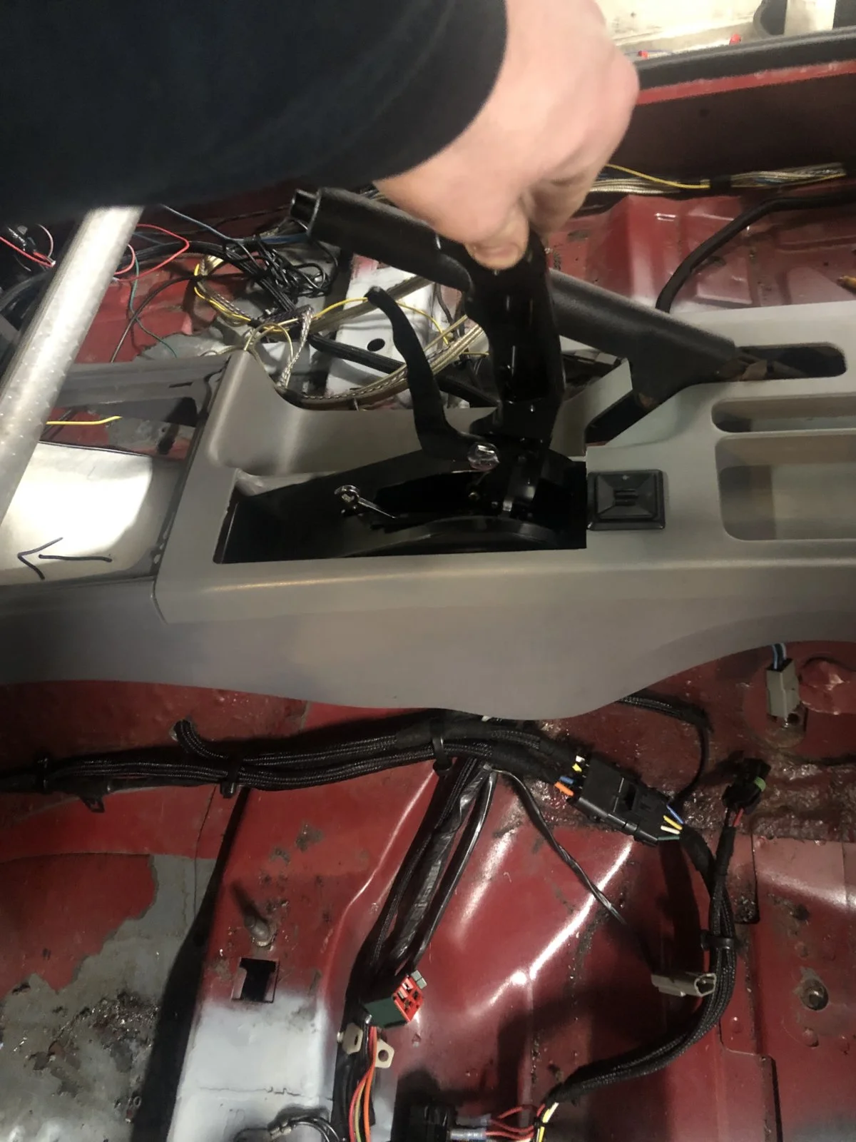

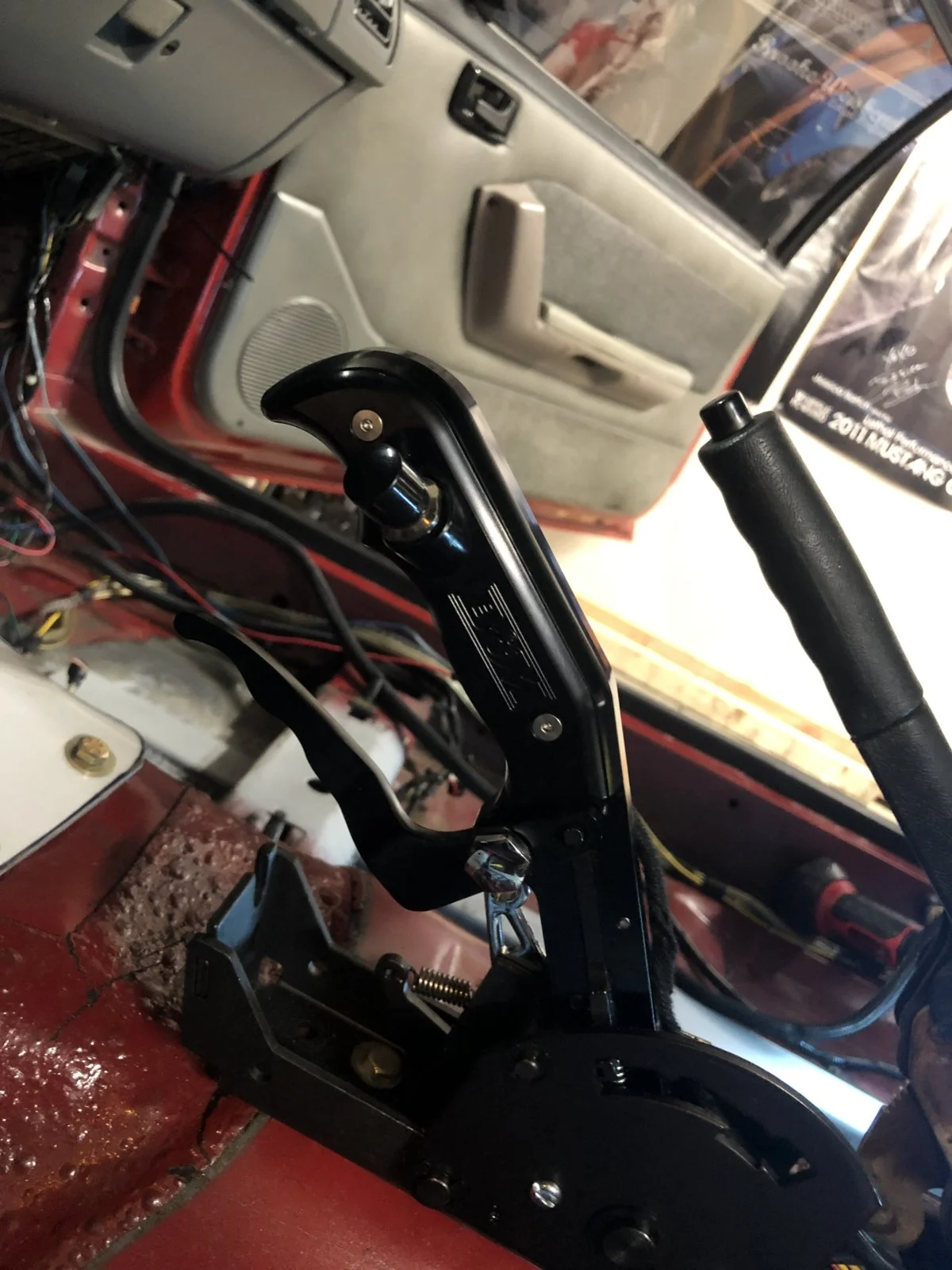

Moved the new shifter back so I can actually get the cover on it under the console .

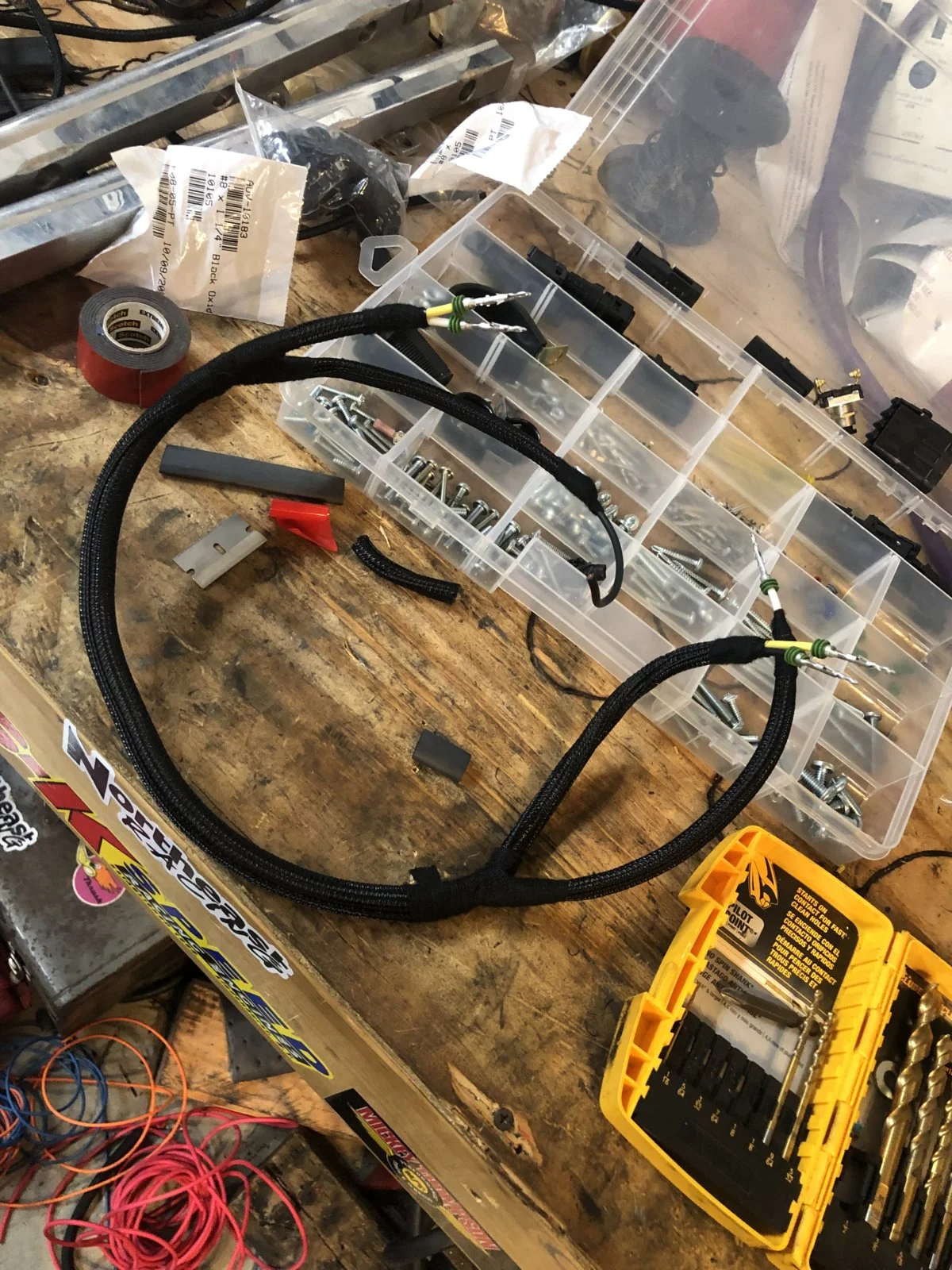

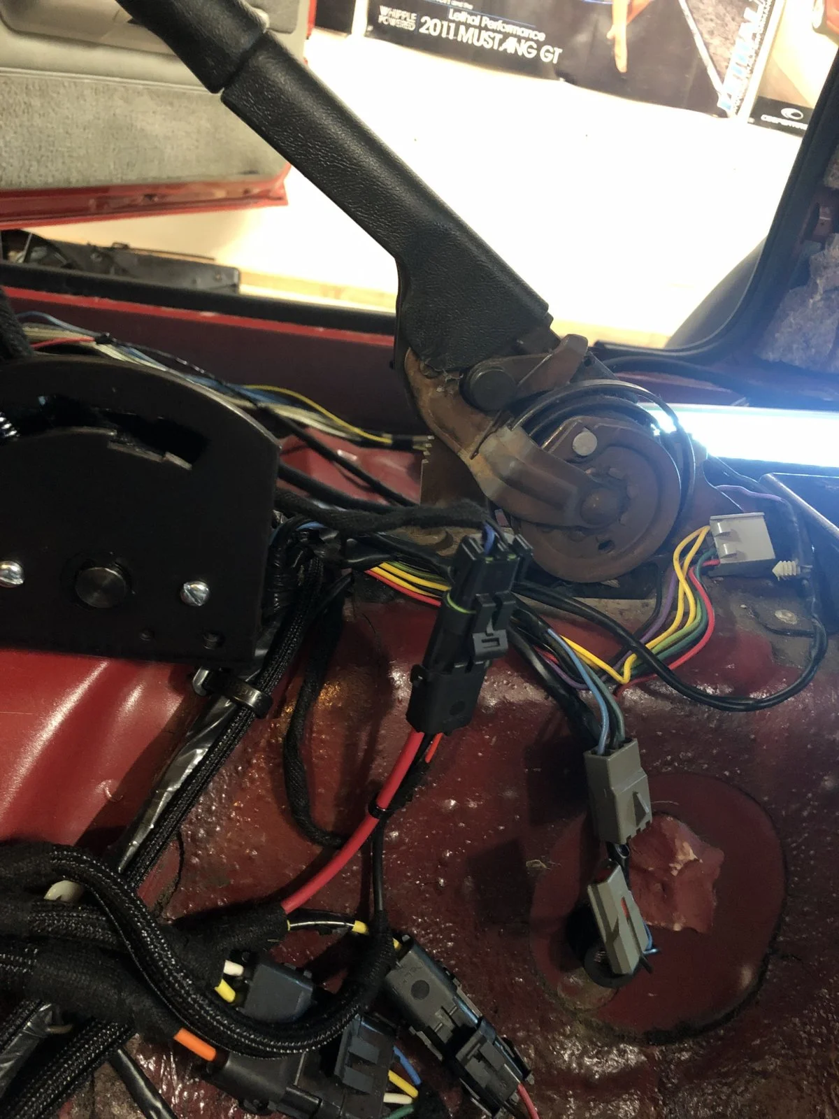

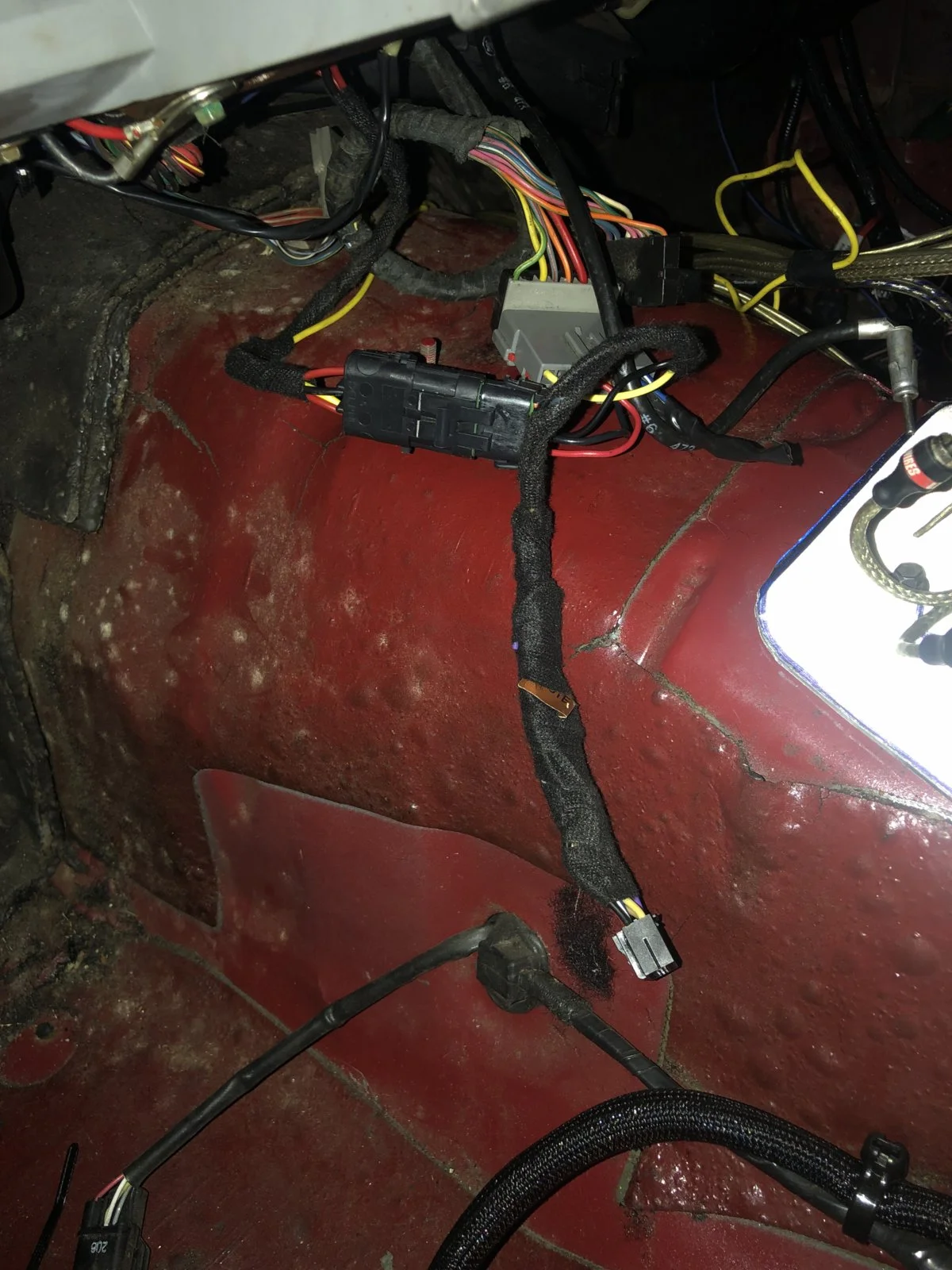

I took the input / output out harness for the Holley out . Stripped all the loom . Re loomed it with mesh . Labeled all the wires for what I want to control . Pulled it back through the fire wall . ran wire and made plug to turn on fans . Re loomed the rpm signal wire to the tach and sent that back through . Re wired the mess of wires from the radio to the factory harness adapter
Also started re tying up harness in engine bay.
So now I’m up too I have to make the rest of the input wires .
So that will be trans temp , make a connector for drive shaft speed for whenever I add it and trans brake input . Then meth stuff . Then fuel pump then carpet and interior back in after I swap the quarter glass and re spray the grey in the quarter plastics .

Got more done last night .

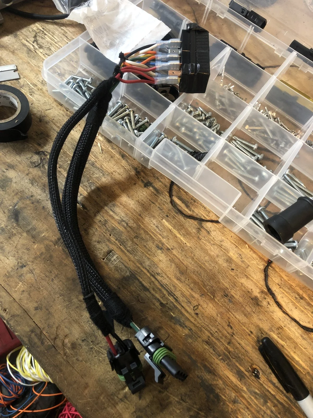

Holley power harness ran to battery in the trunk . Injector power harness ran to dist block in trunk . Mounted and made the connection for the actual button on the shifter for the trans brake .
Made the trans temp sensor harness. Mapped out the setup for the pins for the trans temp and the drive shaft sensor just need to get some Holley pins from my friends shop. Also waiting on 1/4 and 1/8 loom cuz I ran out . All that’s left is the meth controller , fuel pump relay wiring and the usb plug for the console to be able to charge my phone . Then the interior can go back in .
Then I just have some misc stuff in the trunk to finish then that carpet can go back in. Extend some sensor wires in the engine bay and all the wiring should be complete .

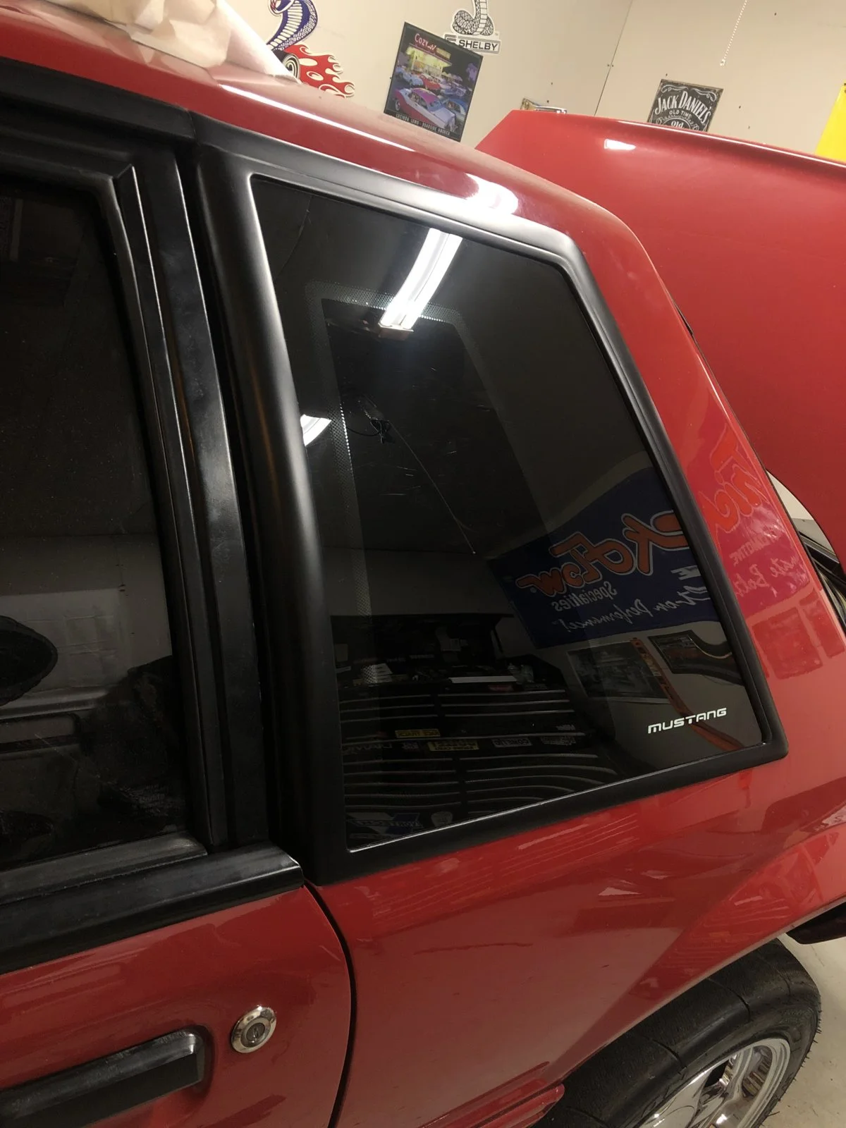

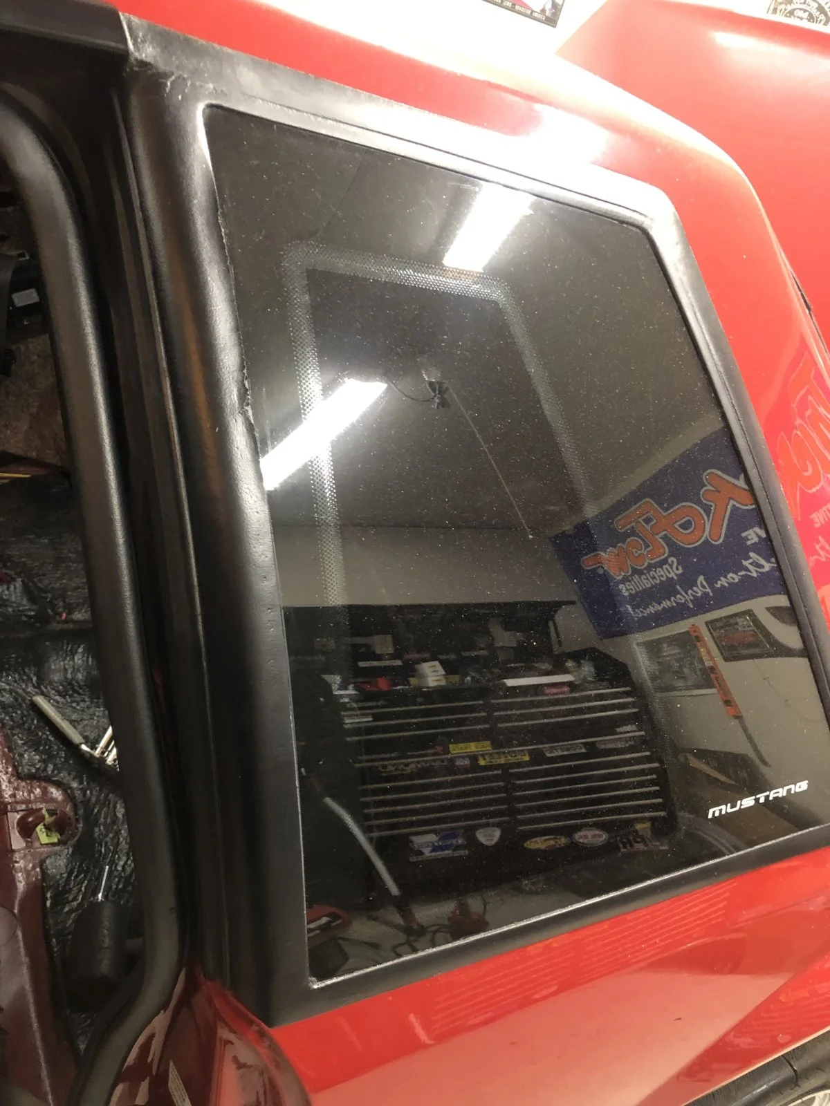

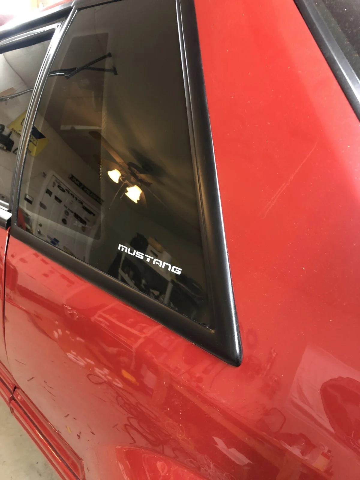

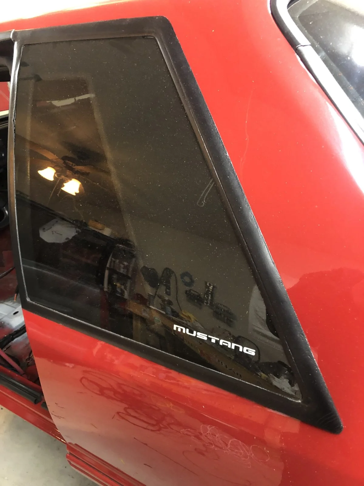

Thanks guys ! I’m trying been trying to get a minimum of 1 thing done a day . Yesterday was just windows. Took a break from the hours of cleaning up and making harnesses . Once this wiring crap is done that will be a BIG hurdle
