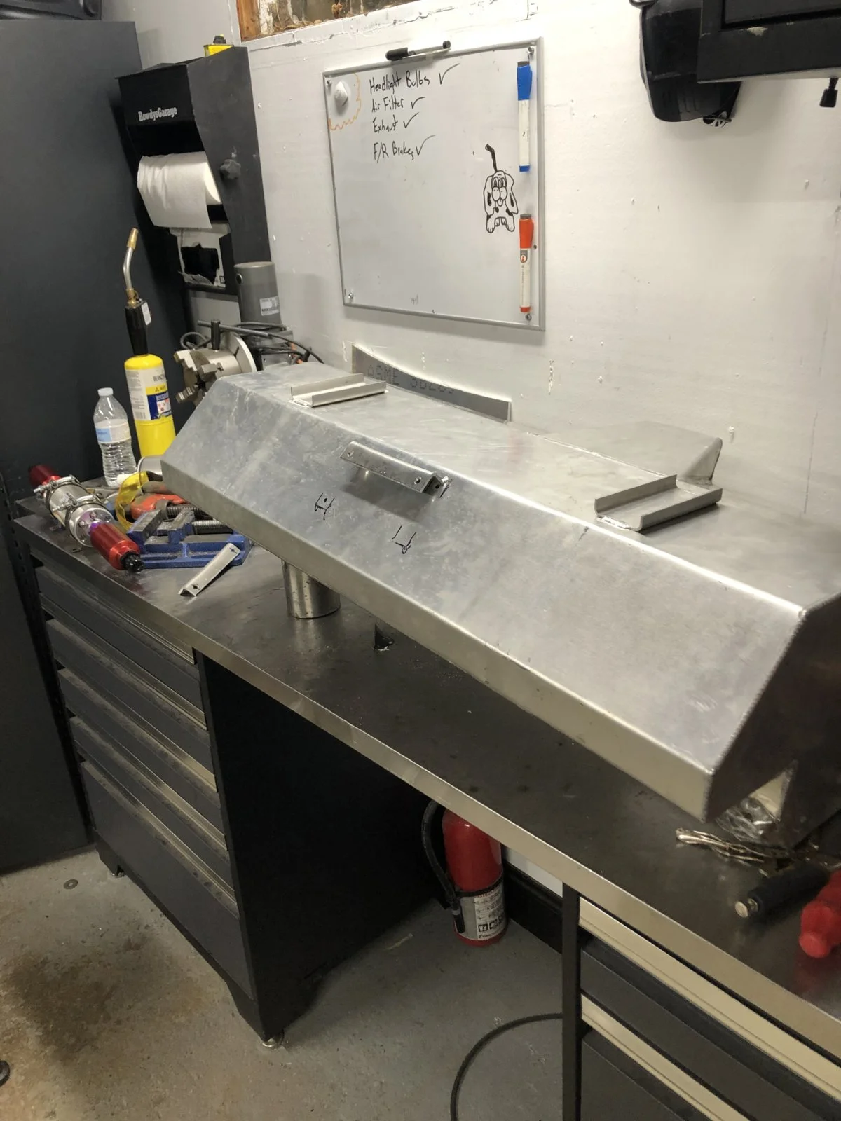

We have a mount ! My buddy Cody took care of it for me .

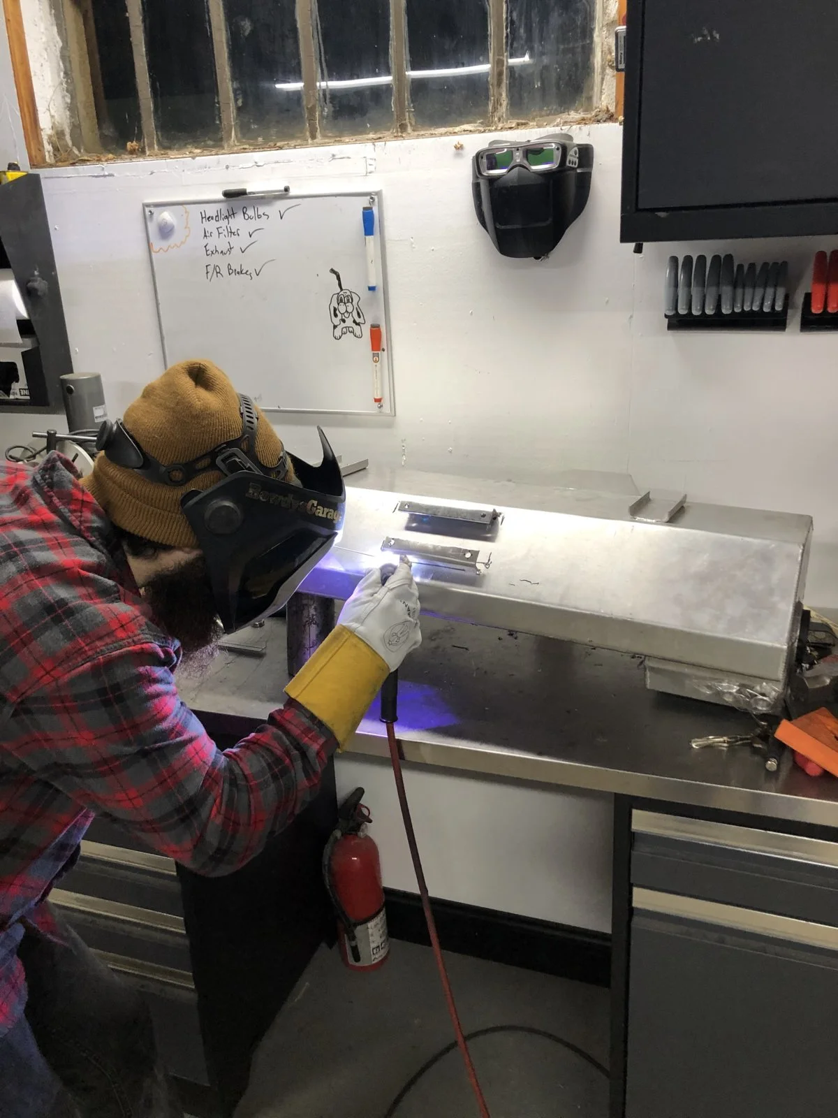

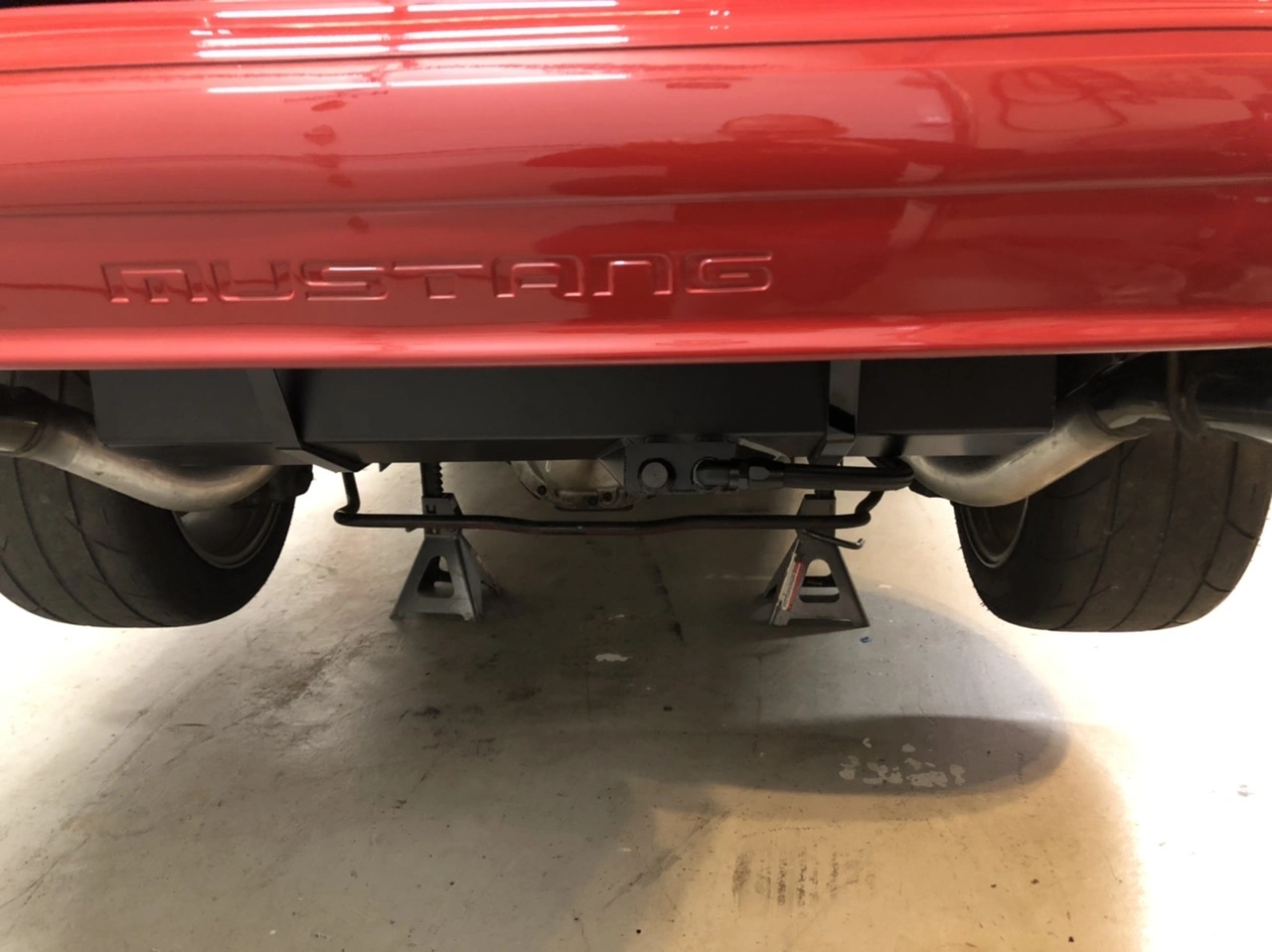

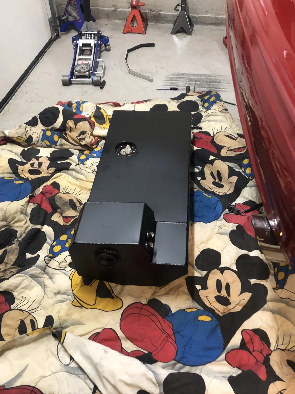

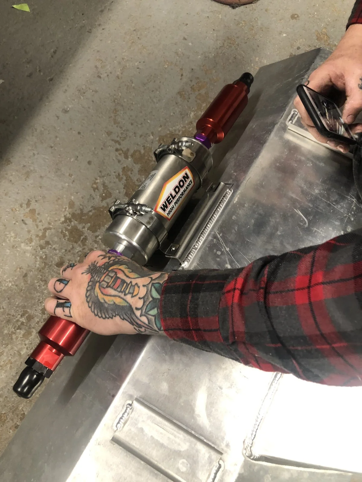

Straps came . Bent them up . Drilled the holes wrong the first time . Re drilled . Marked where the bracket plate needs to be welded on for pump and filters .
Fittings needed are all ordered .
Once the plate gets welded then it’s off to powder-coat then I can install it .

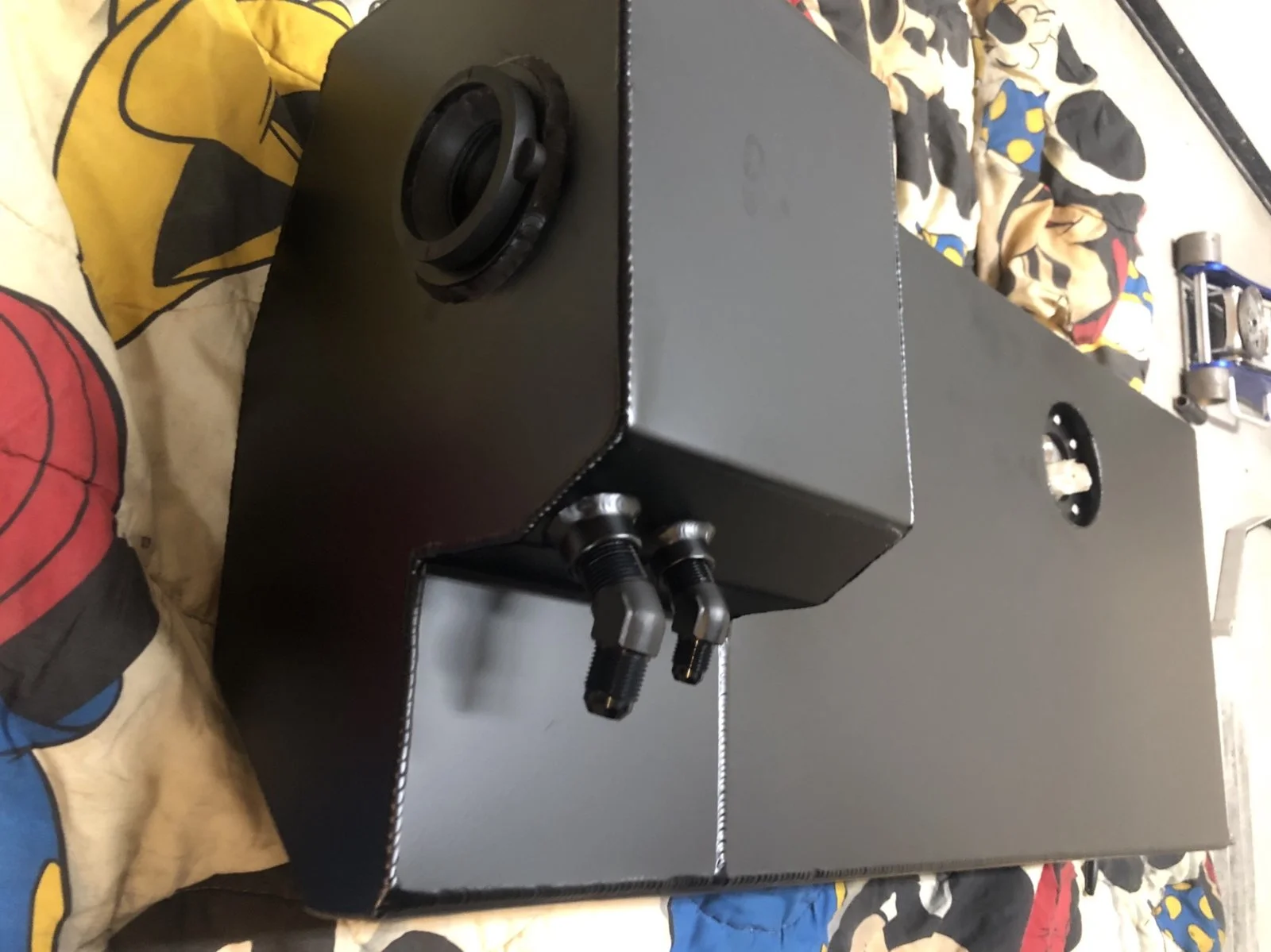

The tank will be Satin black , straps gloss black for some contrast .

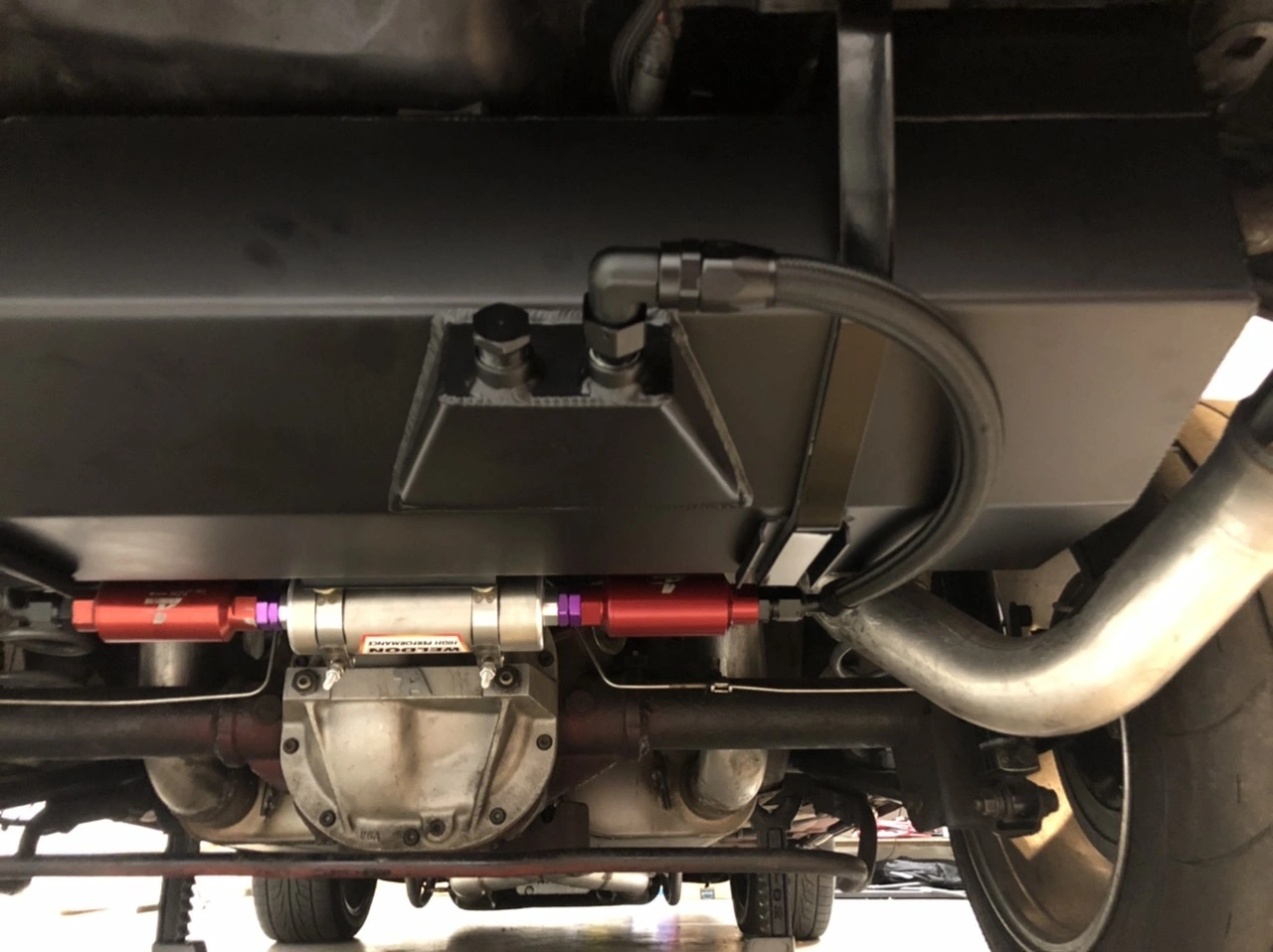

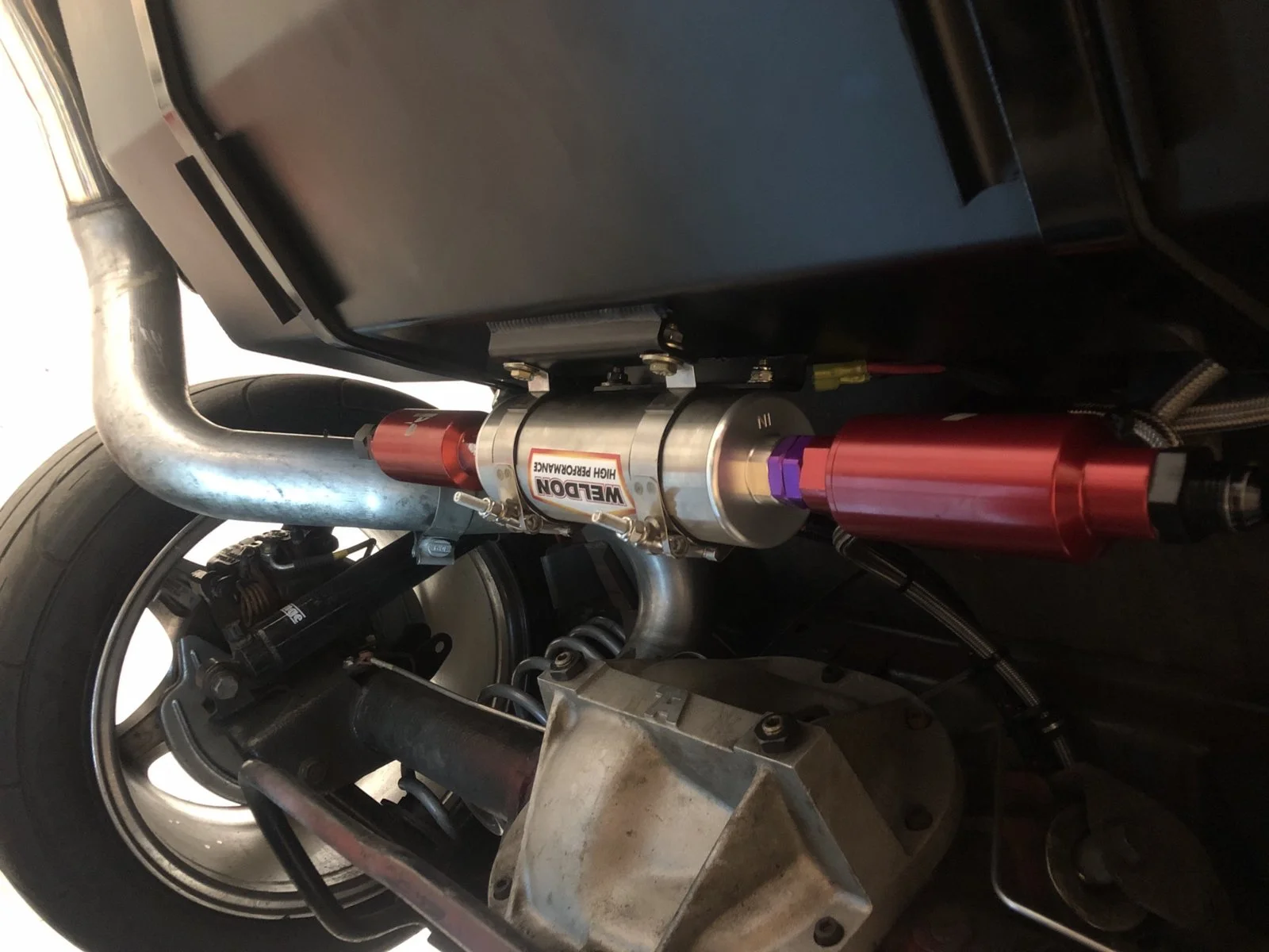

Where do the bolts go on the bracket that holds the fuel pump/filters. That clamp looks like your hand, but I’m saying to myself “ Wait,..that can’t be his hand...if he’s back there holding that sht up,..hows he gonna drive this thing?
  • Haha
Reactions: TOOLOW91
Those brackets are raised enough to take a nut on the back side of it . Bolt the clamps for the pump to it and good to go .
