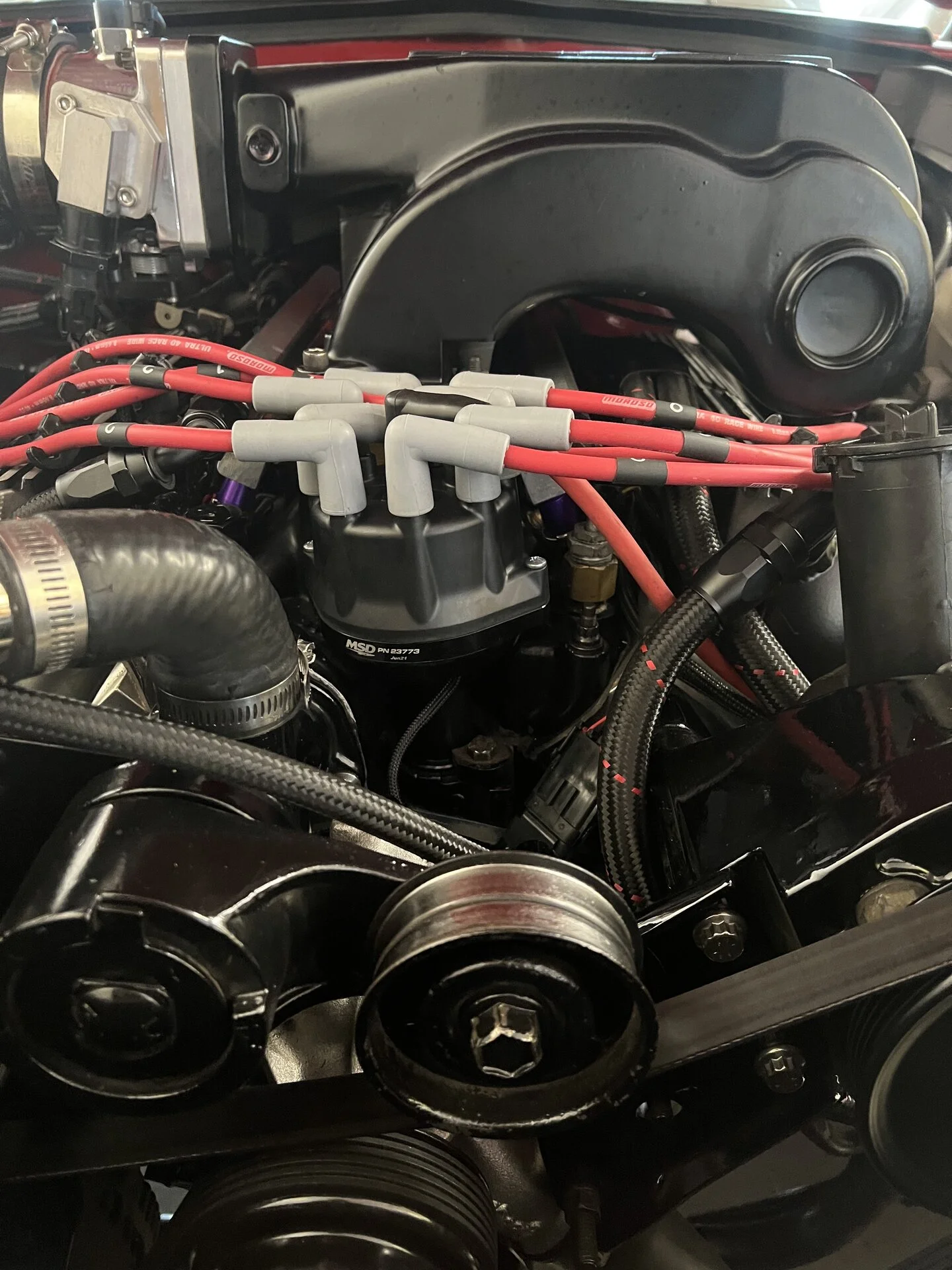

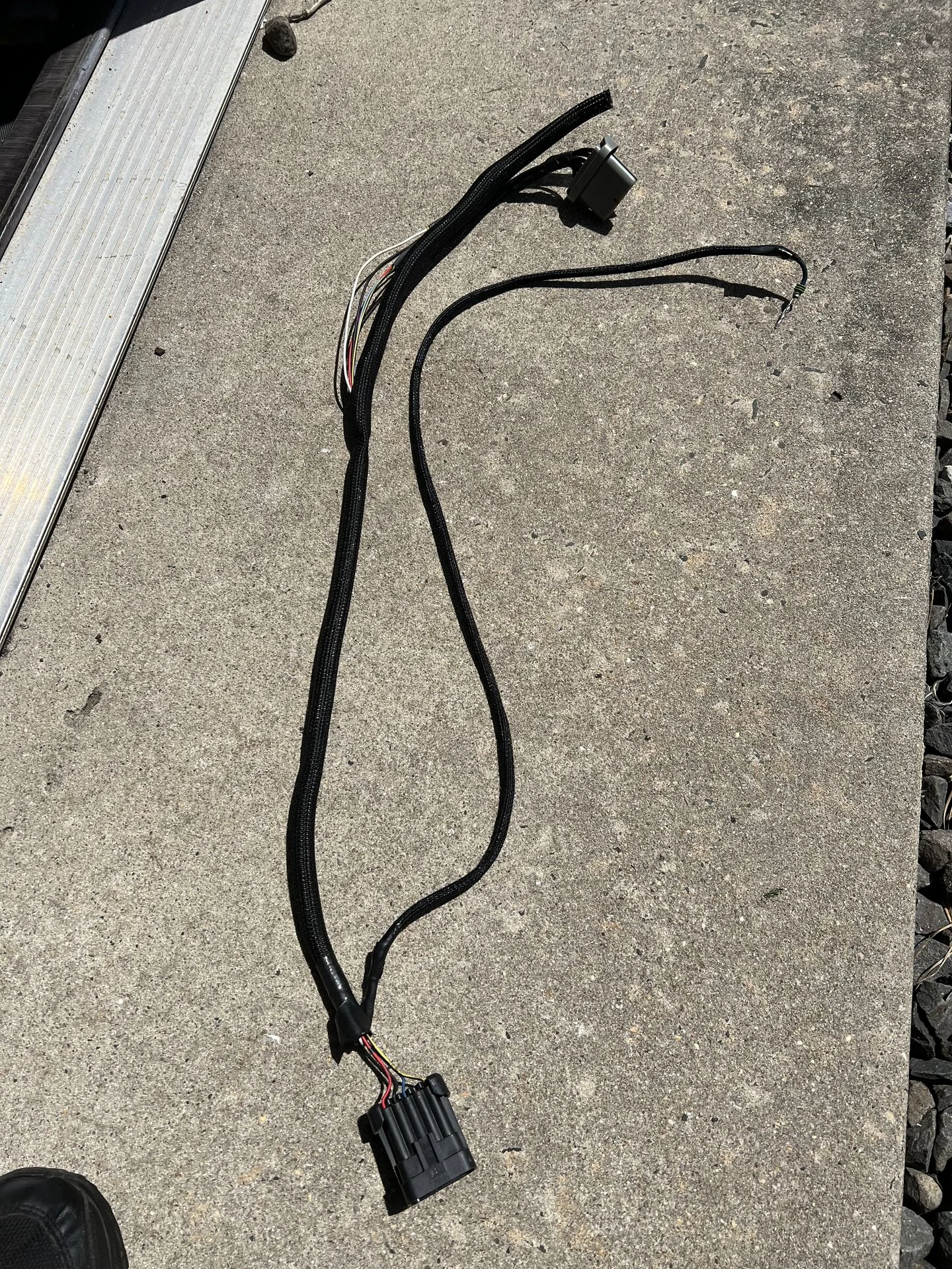

The harness out of the dist doesn’t reach the harness at the back for the ignition . They don’t make an extension. I took my Holley tfi harness . Re pinned the harness end to match the new dist . Cut the ends off the dist and the tfi plug - weather packed them . Have to just heat shrink but power line was down due to a truck .

#TOOLOW91, do you really need weatherpak pliers to do those connectors? These are new to me,and my fuel system upgrade calls for them.
Yes . They fold the crimp over into a tight “ m “ is the best way to describe it

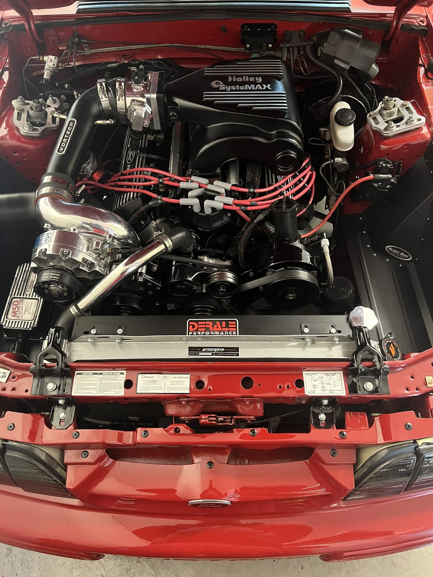

All done and running . The car has never started better with the Holley . It’s night and day . No drama fires right off now . Got the timing synced . Seems much more crisp when you hit the throttle
Also looks way better too.

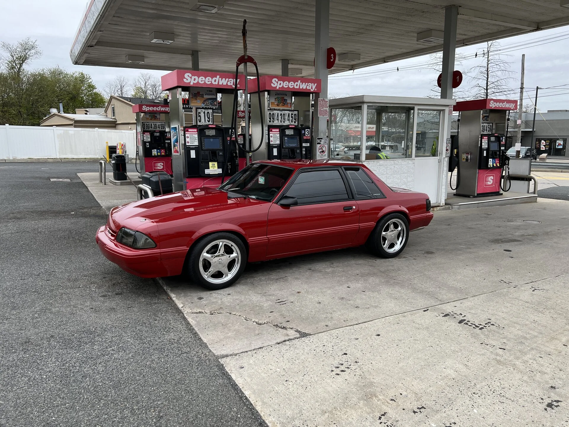

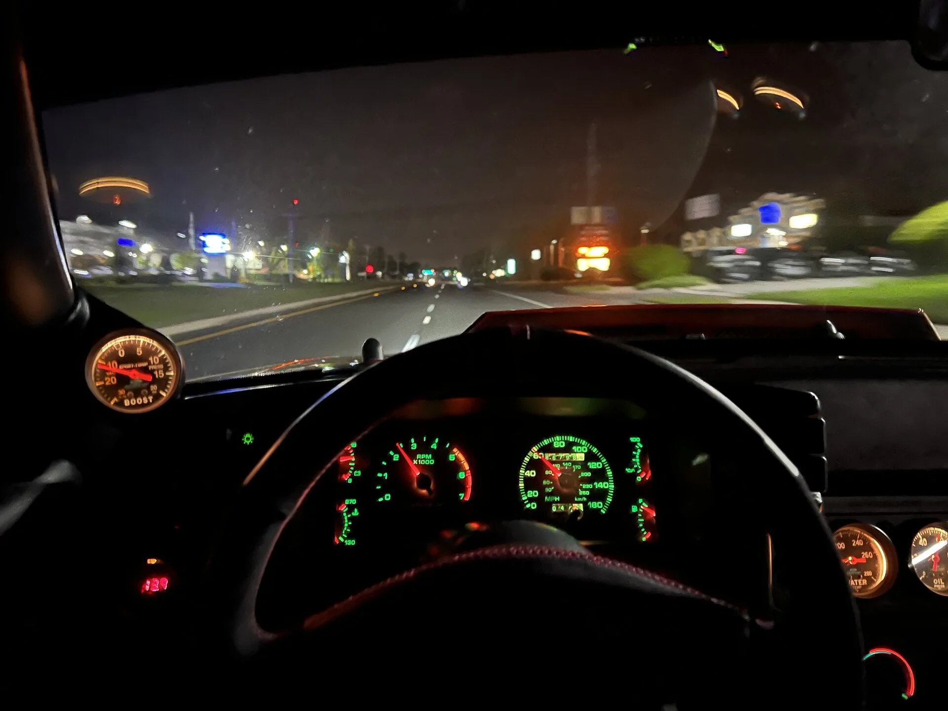

Still one of my fav night time views

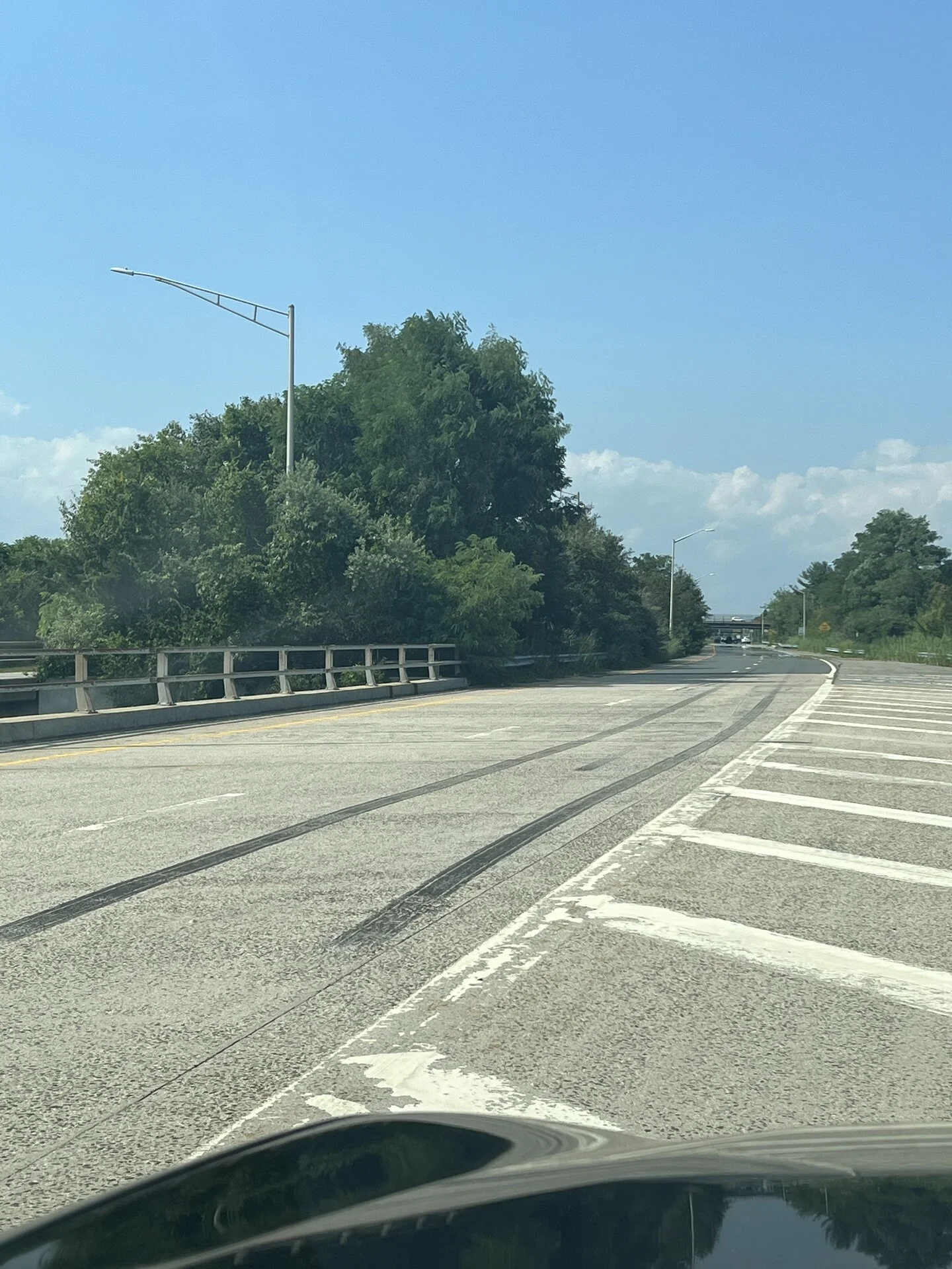

Long time no talk in here ? Yeah so I caused myself some headache with the ID 1300s . Long story short when t moss hogged the Intake out he machined the injector seat out of the intake so the stop for the injector was gone . This was never an issue with my old big body injectors as they bottomed out on my intake . We’ll one night I start smelling fuel with the ids . Back leak at cyl 2.
Limp it home . Got it apart took all kinds of measurements found they fall 80 thou lower then the old ones allowing the upper o ring to pop out . Go back thorough my emails find a pdf moss sent me to double o ring the injector so the body had an o ring to stop it from falling like it wants to . So I ordered all new o rings for the top and bottom and I used the old ones as the upper o ring on the body . Problem solved .
Made a light test hit under full power from a dig last night off concrete for the first time in probably 3 years . It hazed to high gear but was very soft in power so it just went . Only made 14 psi( big pulley , belt isn’t super tight ) - 16 deg of timing on 93 pump / meth . Lifted at 6410rpm . My calculator says that’s somewhere around 142 mph if the converter was doing it’s thing which it felt like it was . If one made a test hit it may look like this ….

Nice painting!

Dang that car is sweeeet, inside and out and the hundred yard burn out is just plain good ole fun!
Doing a good job of keeping up the Faith my Mustang Brother!!
