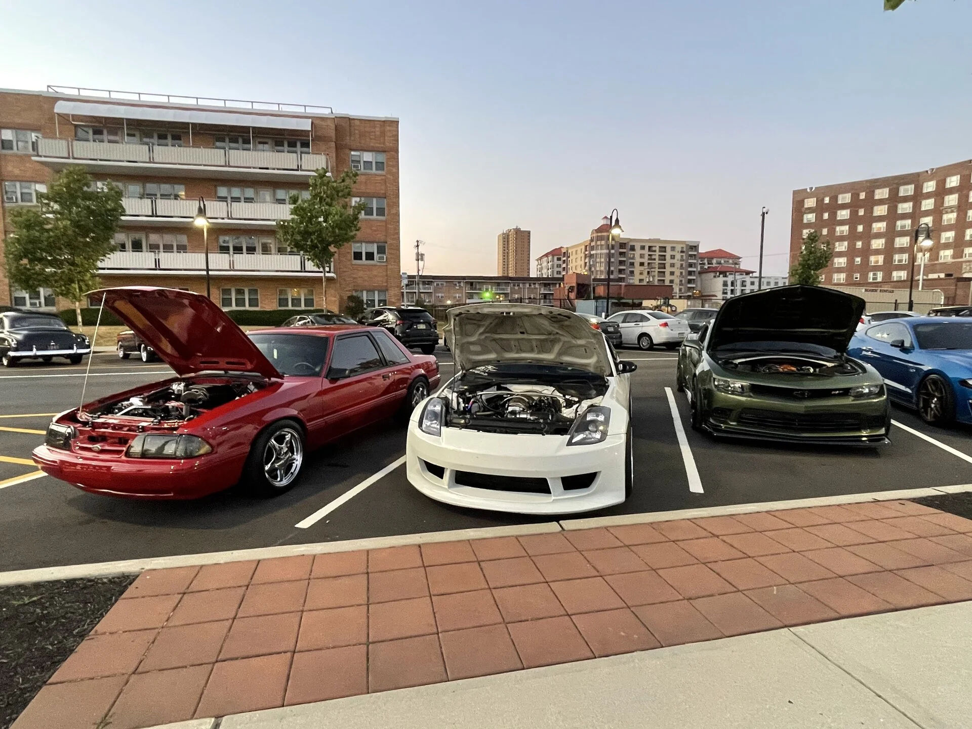

Cool little cruise night - too hot so cars were limited but I’m told it gets really good

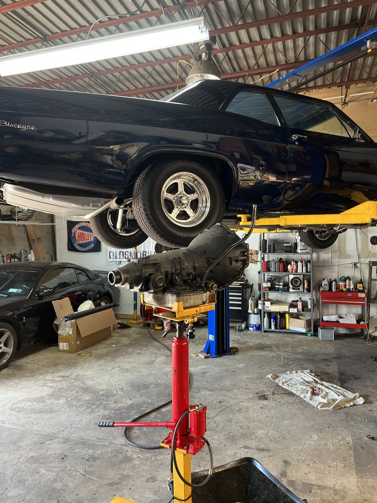

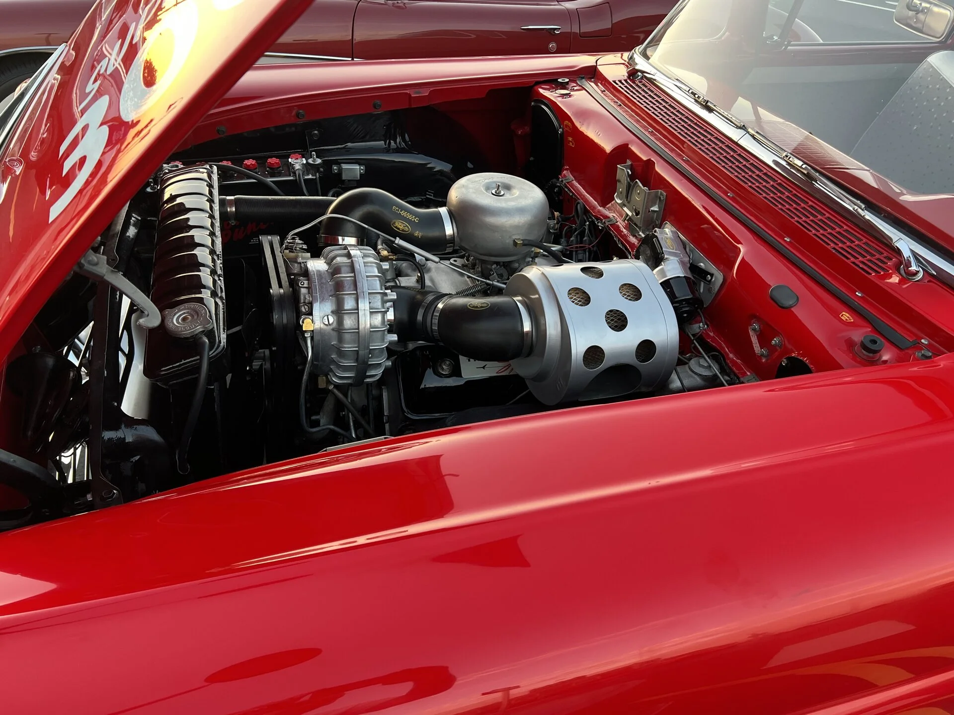

Quick update on my dads car for anyone who cares lol -
I have had it to the track . It went 13.53 at 103 in the heat with the 400 flaring high gear terribly and a stock converter the size of a spare tire .
I have since swapped a friends built spare 400 in it - another buddies 2800 converter took slightly more jet out . In nice air the thing will bark every gear wide open in drive . It runs like a diff car hoping to go low 13s maybe touch a 12

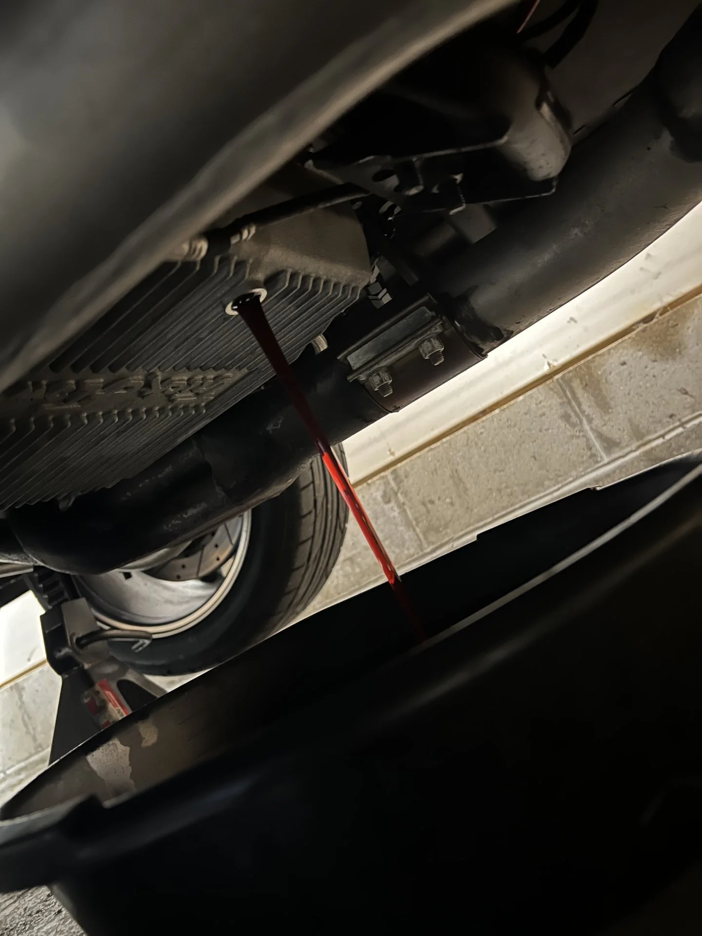

So for the summer I have legit just driven my mustang that’s it . Some hard boost pulls , some rides to work . Still loving it .
Right now I am working on getting it ready for track rental on 30th . My trans has the same fluid for over 2 years since the trans went in . It’s very loosen. It acts like 3500 ish on the street driving and will flash to 5200 . The line temp has seen 228
Totally expected the fluid come brown ish with some scent . NOPE . Derale twin plate with fan doing it’s job

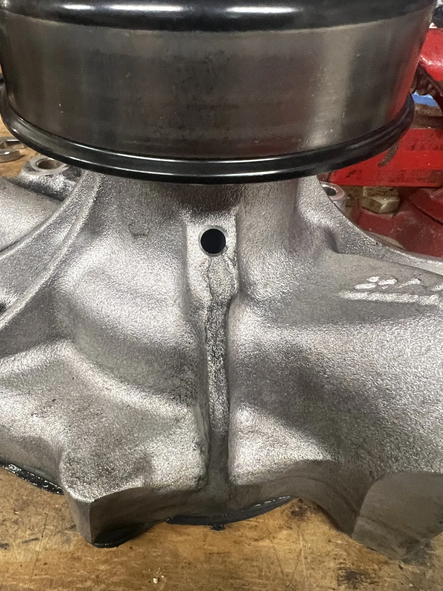

Probably 1500 miles on this pump . Pissing out the weap hole like it was meant too . For the money I’m not a happy camper .
Cars already back together with a car quest one .
  • Sad
  • Dislike
Reactions: 1 users
TOOLOW91
8,034
8,047
S.I.NY
Edelbrock pump? Those aren’t cheap to begin with.
Plus I have one :(
I was doing my fuel filters the other day I fired it and I’m looking at my fittings. I happened to glance up and I see a steady drip stream . Sure enough .
It’s been leaking a little bit too cuz only a gallon of water came out of the car . I am pissed about it

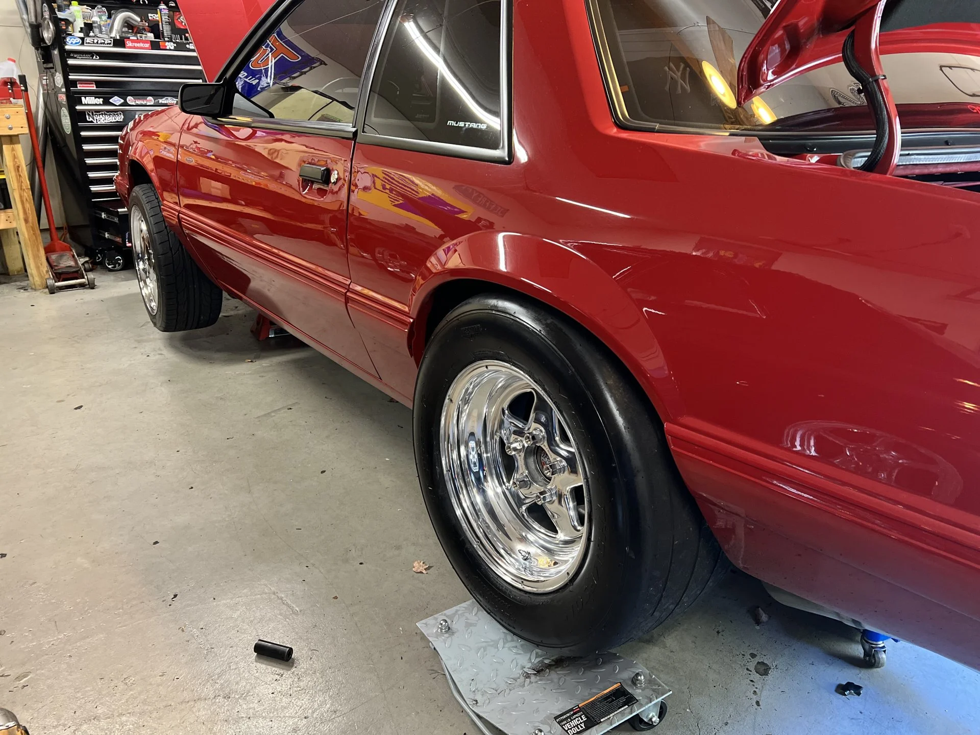

Didn’t touch the tune . Put plugs in it . Tightened the blower belt .
Rear diff is going away it unlocks under any real power so I couldn’t leave off the brake . Buuuuuttttt - here we are in the same trim I took it to cruise night in aka a wheel swap . Foot brake at 2k and leave . I went 9s 2 more times within 1.8 mph later in the day of the first pass
