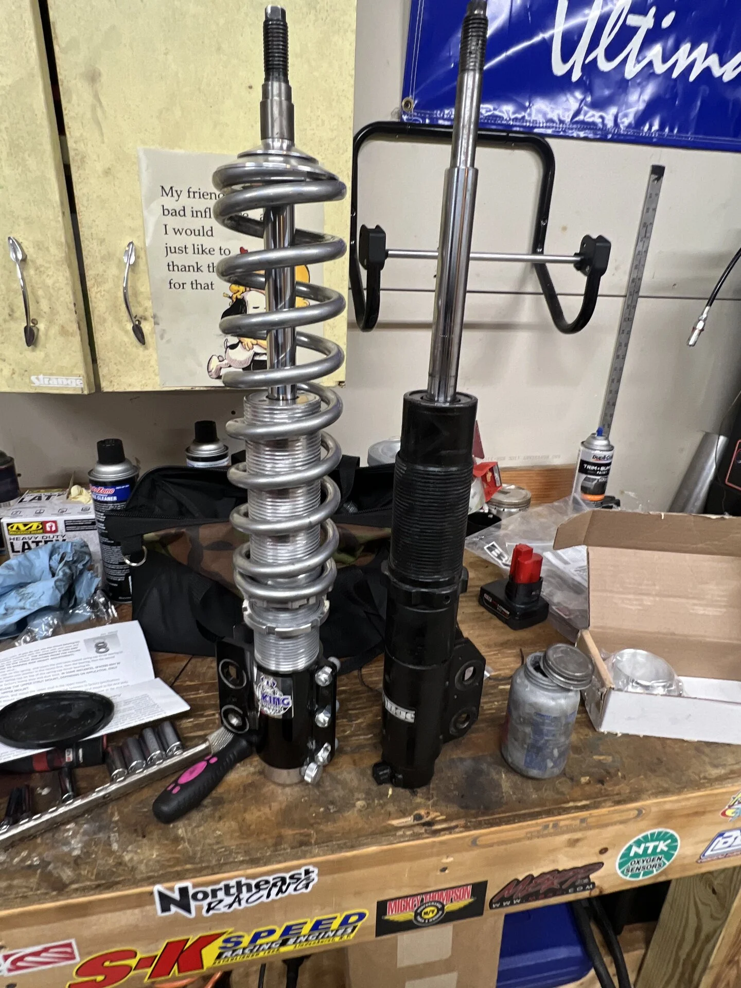

Finally got off my ass today , got the Vikings swapped in over my blown out strange struts .
I have rear poly isolators to replace my rear spring iso which only has one rubber on each side . Reason is I want the rear up a tad because I want to try and stuff a 30/45/17 nitto g2 drag radial on my 17s because they last a bit longer and the 28s should make it look tough .

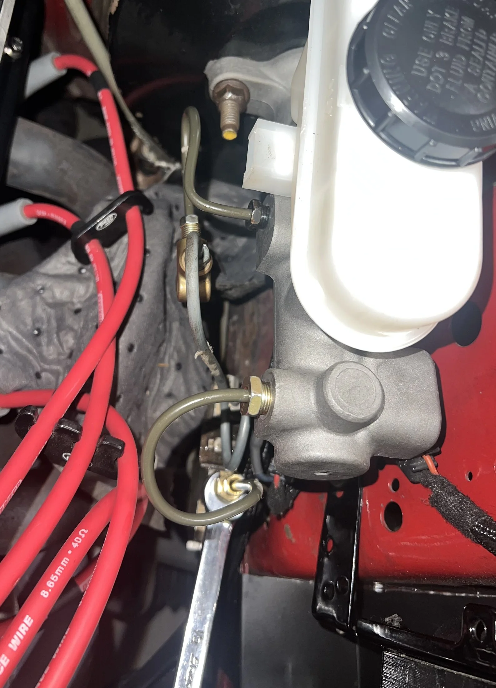

Got around to messing with the car today. Bench bled the 93 cobra 1 inch bore MC. It’s been so long that when I went to install it I forgot that the 93 vs the 94-95 have the fitting sizes backward . The front takes the M12 and the rear takes m10 where as it’s opposite with what I had .
I wasn’t going to spend 42 bucks on two small lines . With an adapter I already have .
So I did some research . Ran to the parts store got two short adapter lines . Got an adapter because one line had the wrong flare the other line I cut down and Re flared . I bent up the lines myself and we are in business . Just have to bleed the whole system .

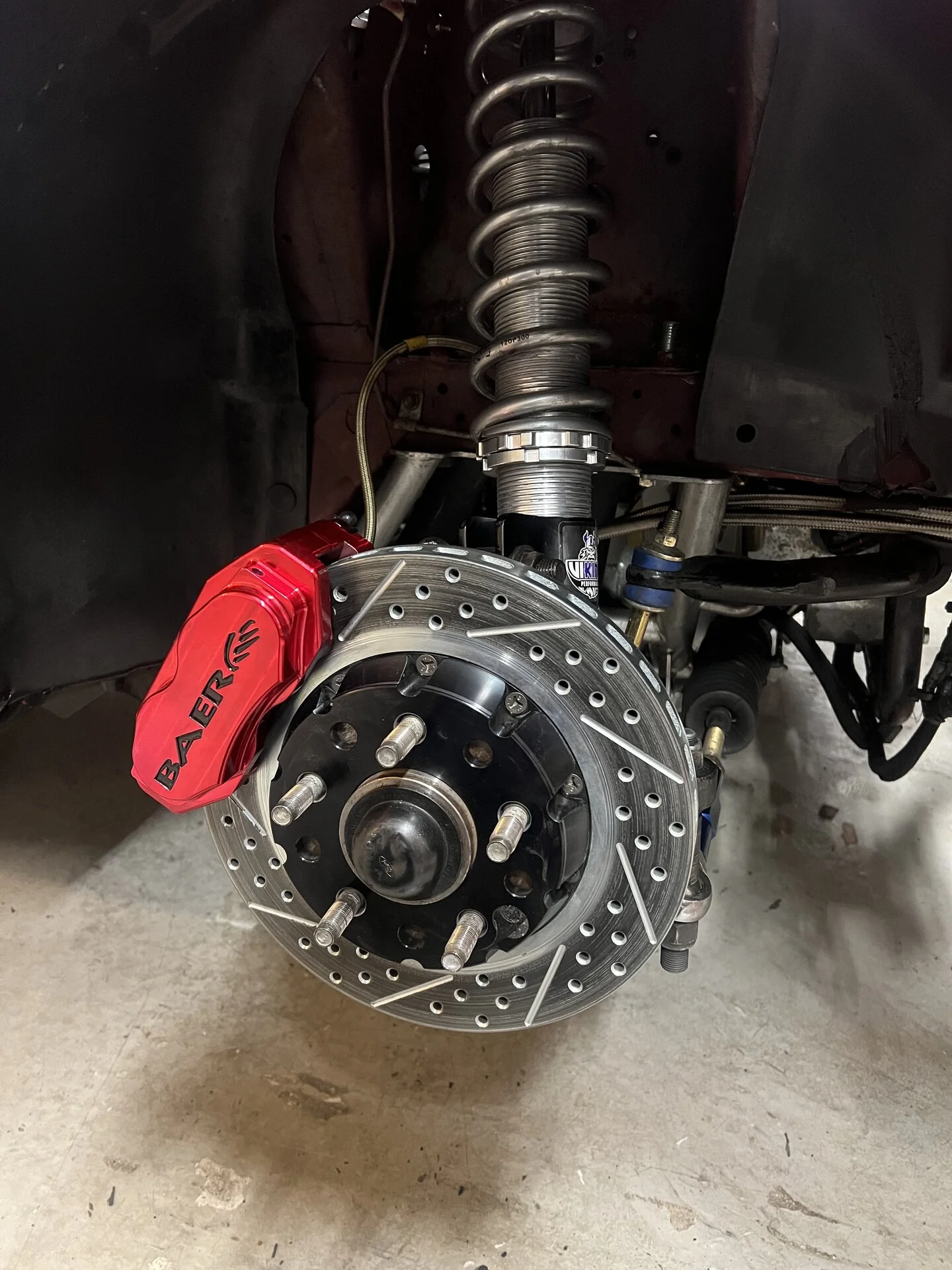

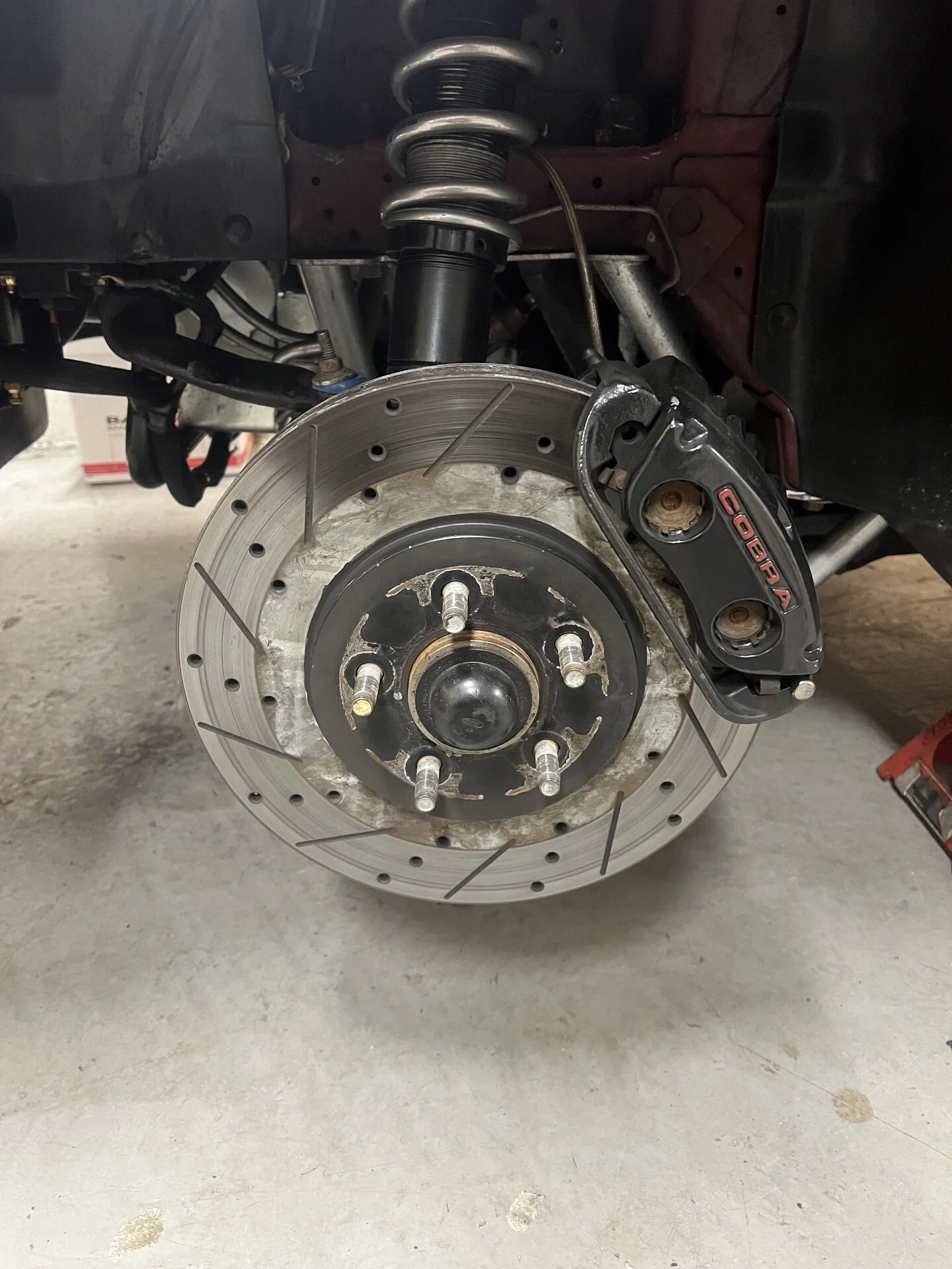

I do plan on the Baer master but j want to have the rear calipers and spec and buy once at the price it costs

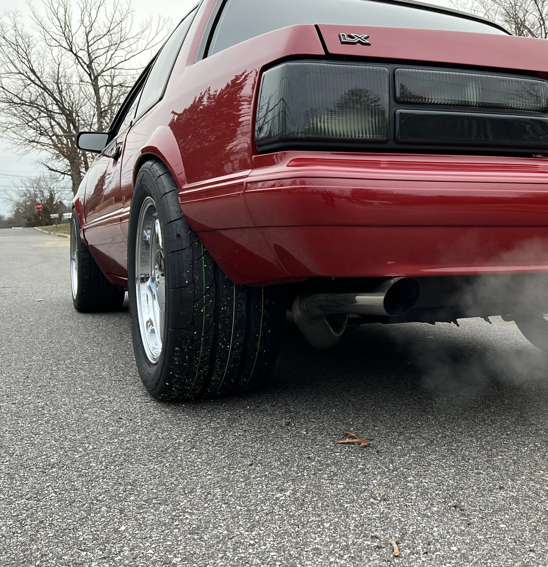

I wish I could keep them on . I raised the rear up and they just barley scrub on a hard turn or dips still . I’d have to raise it more and make the suspension super stiff and I’m not looking to do that . These are 305/45/17s
I know guys do it but I don’t know how . Not on these roads . I do love the look though

BFH and massage the heck out of the inner fender wells. Helped a buddy do it and I was almost sick when it was done. He ended up using some stuff a body shop buddy gave him to seal up all the small tears in the wheel well metal. This was a drag car so he really didn’t care.
I would just mini tube a Fox Mustang wider than 275 was necessary. Called a guy that mini tubes Foxes and he said $1,100 labor plus the mini tubes and coil over bracket materials. He also said there would be additional labor to remove the interior of that had not been done and to remove anything under the car. He said it’s difficult to be specific there as some people bring him a street car and want turn key where others strip it all out and the car is on a body dolly so it goes right up on the lift and under the knife.

Exactly ! I’m not looking to get that crazy . Believe it or not - the inside is very close to being fine . It doesn’t touch until the read flexs going down the road and it’s almost not at all. It’s the lips and the way I rolled them .
I left too much at the bottom because from a side profile I wanted you to still see it from the side and not see it missing and look hacked . So it catches the transition on bumps and stuff . One day maybe I’ll minitub it myself but for now back to 275s
