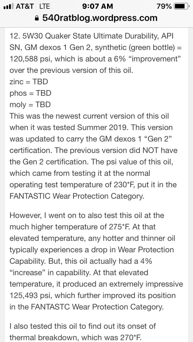

Just read some of that awesome oil test. What I took away from it is the newest 0w-40 Mobil1 is pretty badass without any additives. Cool! That's my favorite stuff since I came across it back in Germany.

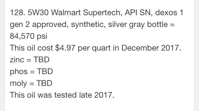

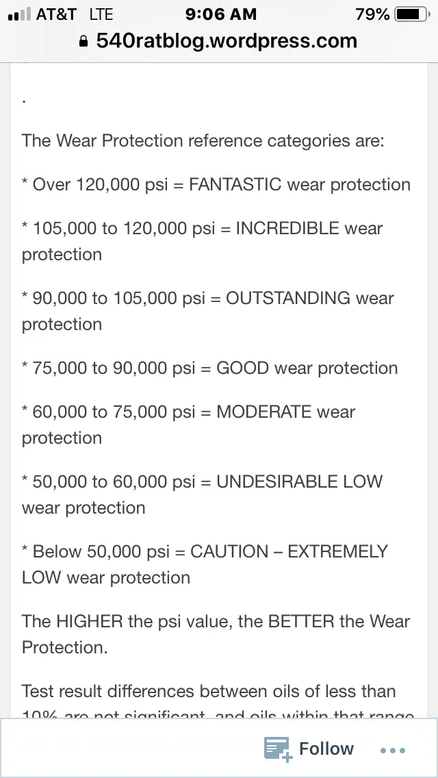

The oil test takes guess work out of equation - quakerstate full synthetic tested awesome and they use a good amount of zinc in there formula ( zinc content was lowered because of emissions over the years , but many builders recommend zinc - especially during breakin period - more so for flat tappet lifter builds )

Sure , Walmart oil may be fine, But , According to the guys data on oils each type tested did exhibit different amounts of wear protection in his laboratory testing comparison . Does it matter though in a car that has 100k miles and had all the wear it would get by now , probably not . I am just providing data - also , I don’t know enough about zinc to say it is not needed on roller cams , but if it not needed why are oil engineers putting it in - certainly zinc must aid other wear parts other than lifters ?
