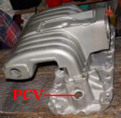

Drained a quart and changed the pvc and crank screen filter ( the screen filter was totally clogged so it a noticeable change , seems to idle smoother )
Did you take the upper intake off? If not, how did you get to the PCV and screen?? I've wanted to do this, but I don't want the hassle of taking the upper intake off.
You need to be a little bit of an acrobat, but you can get to it without taking anything off.

Wayne Waldrep
Before I post a pic, do you have one of yours?

That pic makes it look much easier to get to than it is on mine.....
I'm gigantic and I can get to it just by leaning over the fender and reaching back there so a normal size dude should have no problem. You asked did the intake have to come off. Never heard anybody do that just for a PCV valve change. Follow the vacuum line with your hand to the valve and remove it. Pull the grommet out and the screen is right under it. Maximum 5-10 minutes.
