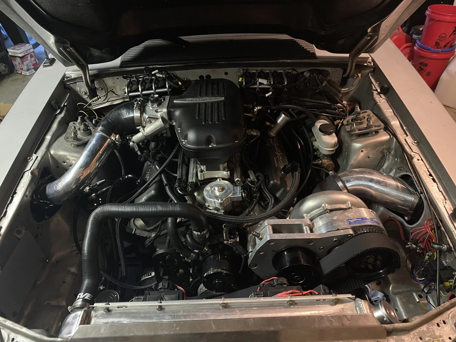

Drove the car on its first long drive today, went about 75 miles total. Did great, ran cool, and pulled hard. I’m happy with it.

Reactions: Monkeybutt2000 and a91what

Looking clean

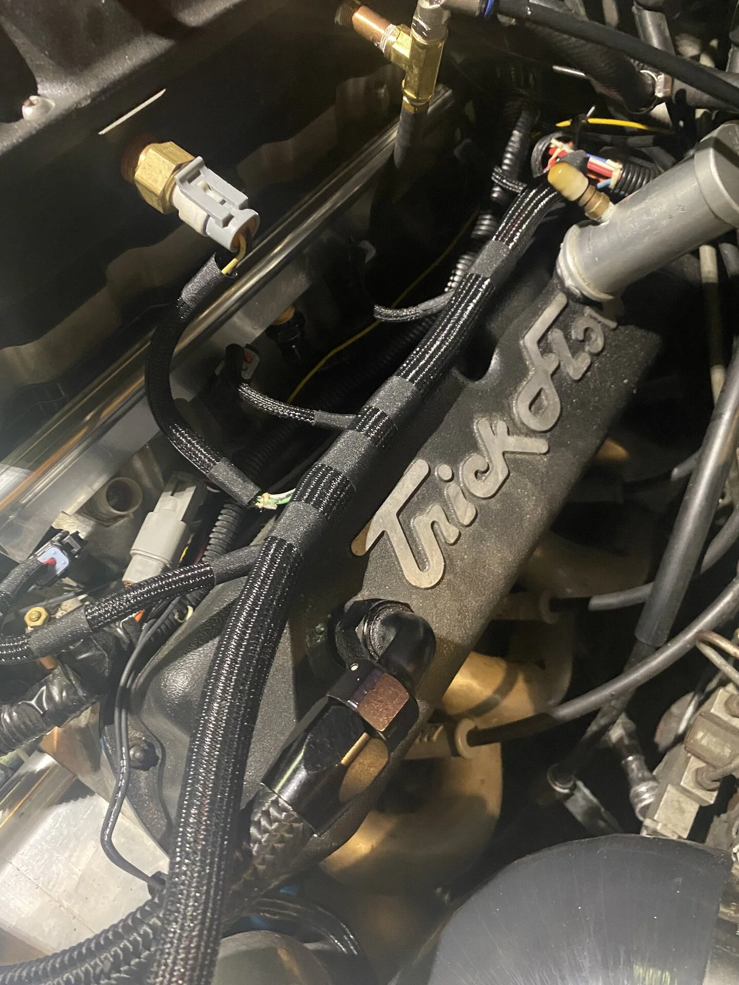

Thanks man. I’m spending some time getting rid of the plastic cable tube for some split loom. Wish I had used this stuff from the start

That's what I use, love it. My only coming is having to use cloth tape when I cover after putting on the connectors... I like to heat shrink the ends and splits but it don't always work out.
You used the tesa brand tape? That’s the brand we use in my hangar and it’s awesome. It’s tough to run heat shrink when the harness is already all routed.

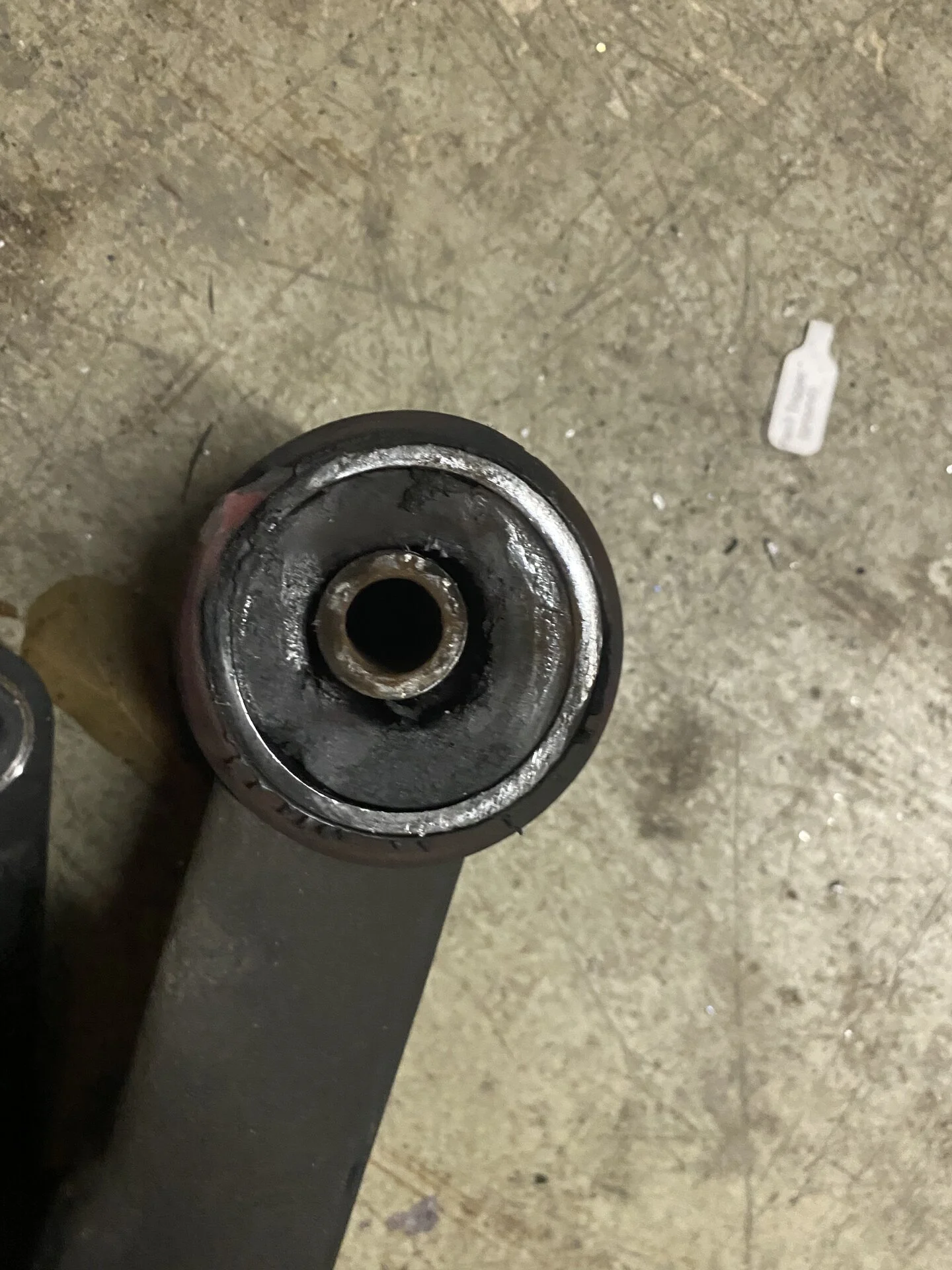

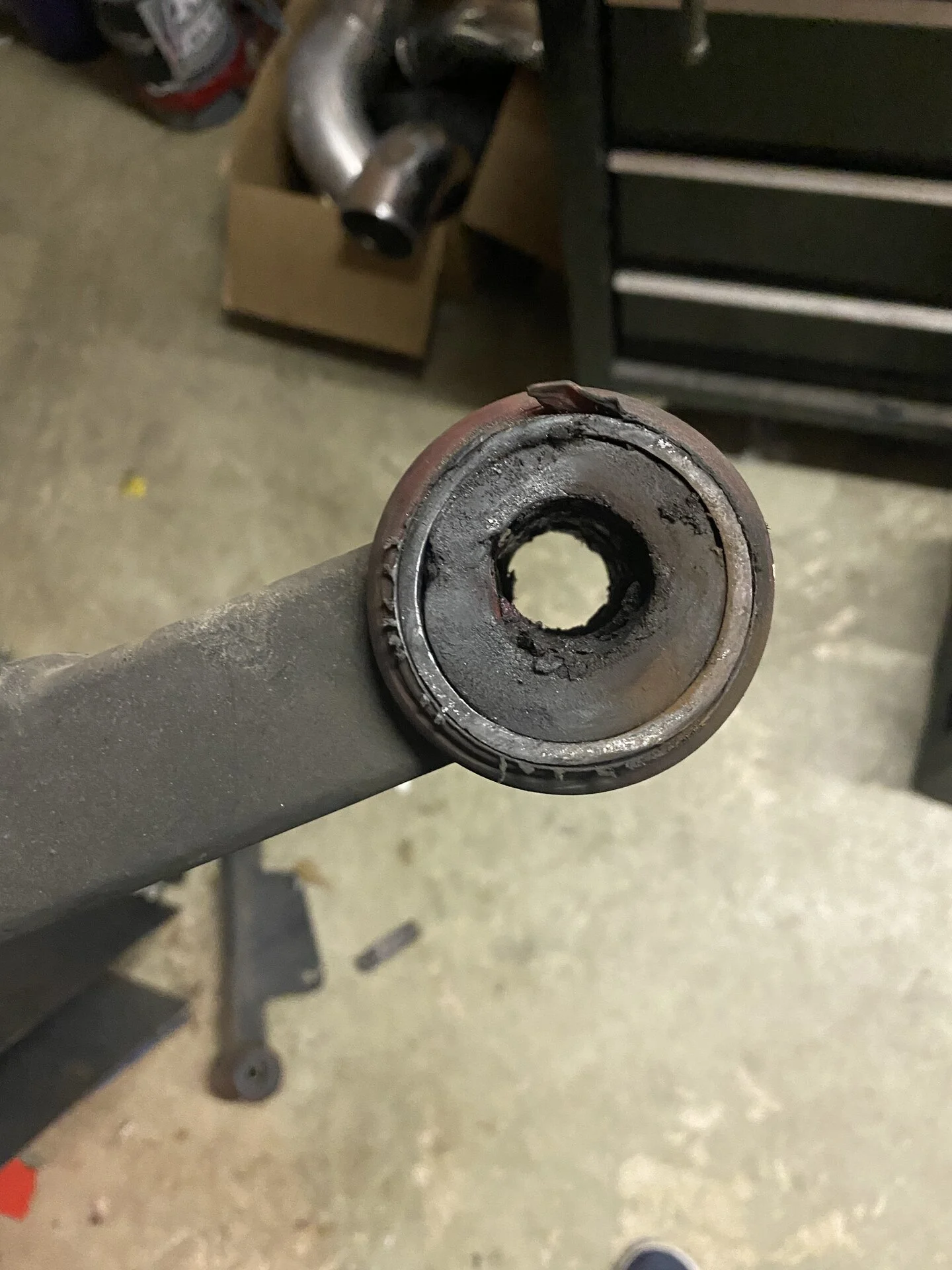

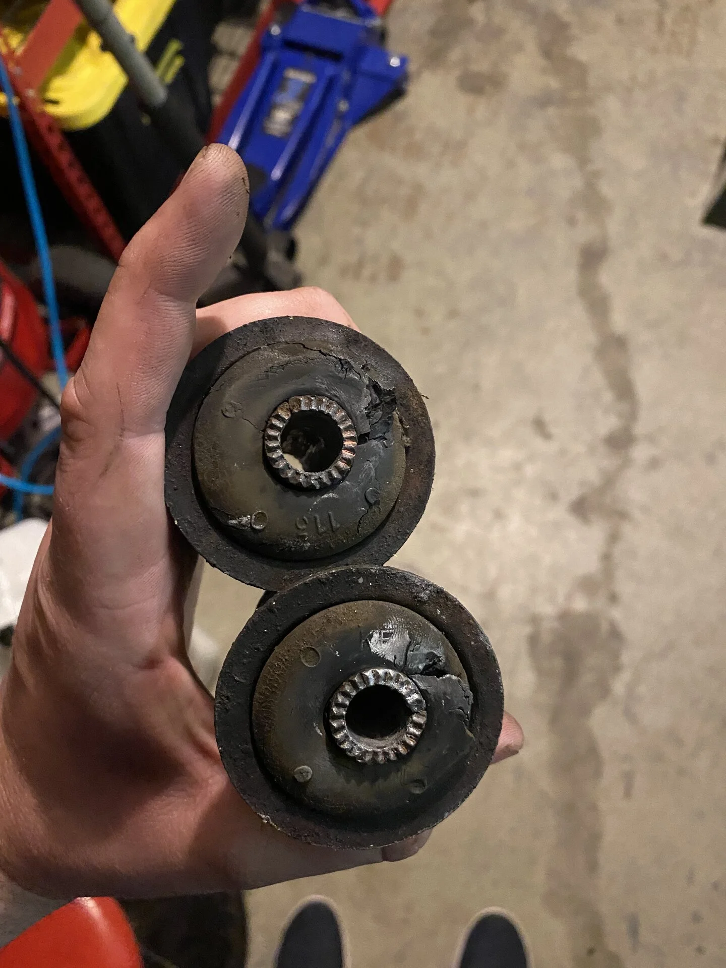

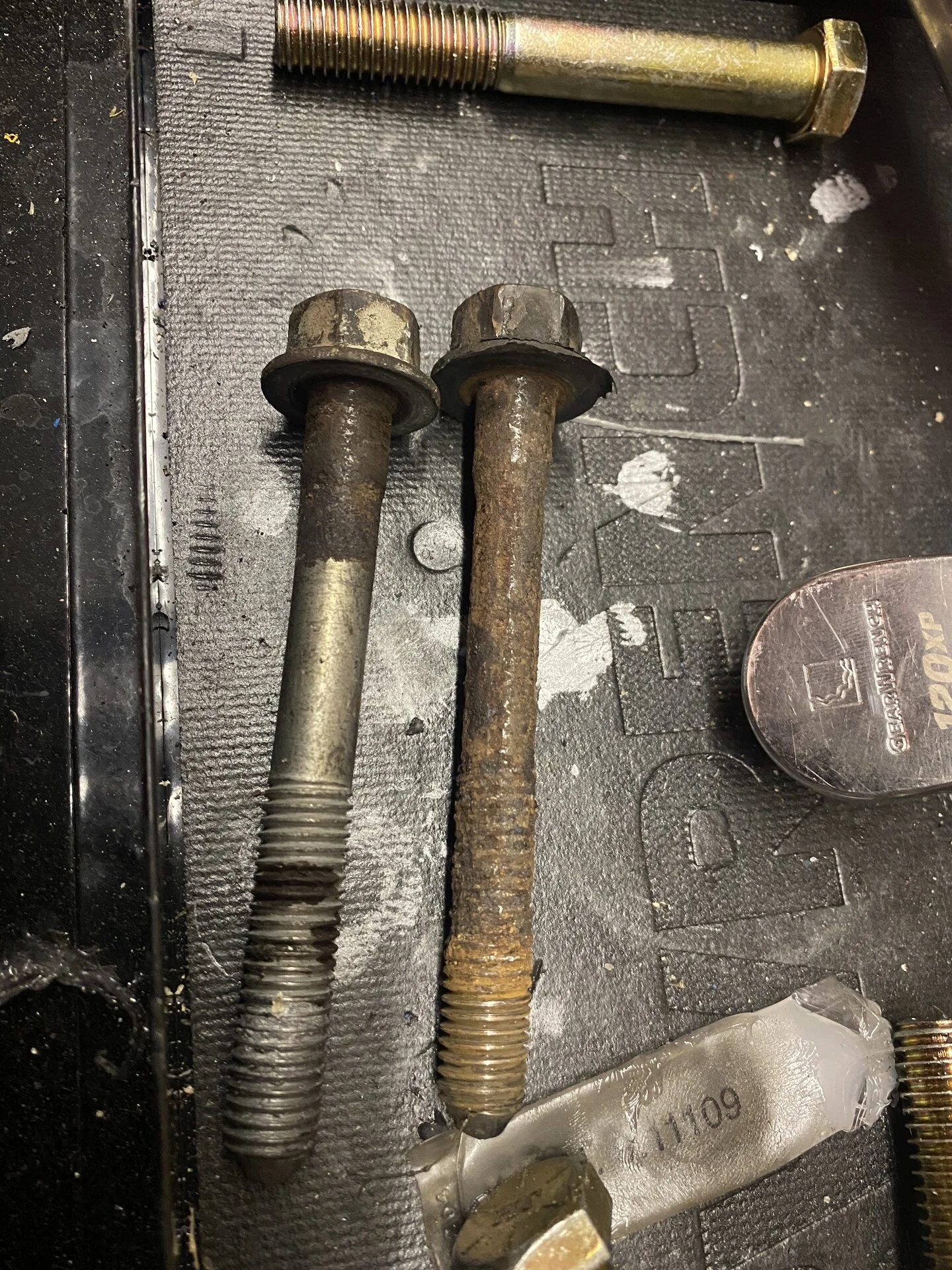

Got the uppers and lowers put in, as well as some solid upper bushings. Today was hot as hell so I got started at around 7:30am. Still miserable though. One thing I didn’t realize was the upr control arms have 1/2in hardware, so it made it a little trickier getting everything in, but it worked out with some persuading.
Old bushings were in terrible shape, like hot dog down a hallway bad.
Some of the bolts weren’t in great shape either.
Upper housing bushings weren’t as bad, but still not good by any stretch.
I set the pinion angle at 1.2* down, so I’ll see tomorrow how it does.

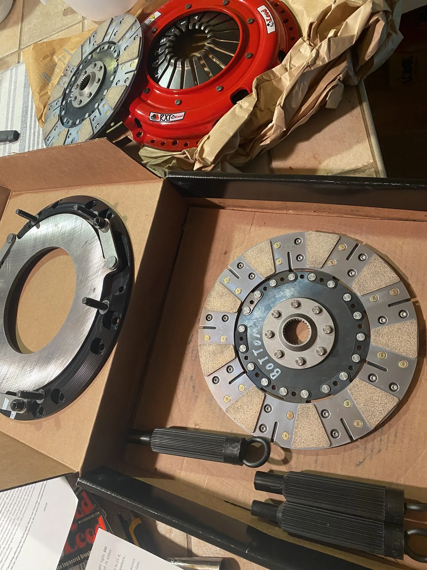

Been enjoying how the car has been with the new control arms and bushings. Was hoping to put the slicks in and go make a hit, but the clutch started to give in the top of 3rd and 4th gear.
The new McLeod rxt came in yesterday. It’s definitely the nicest clutch the car has ever had.

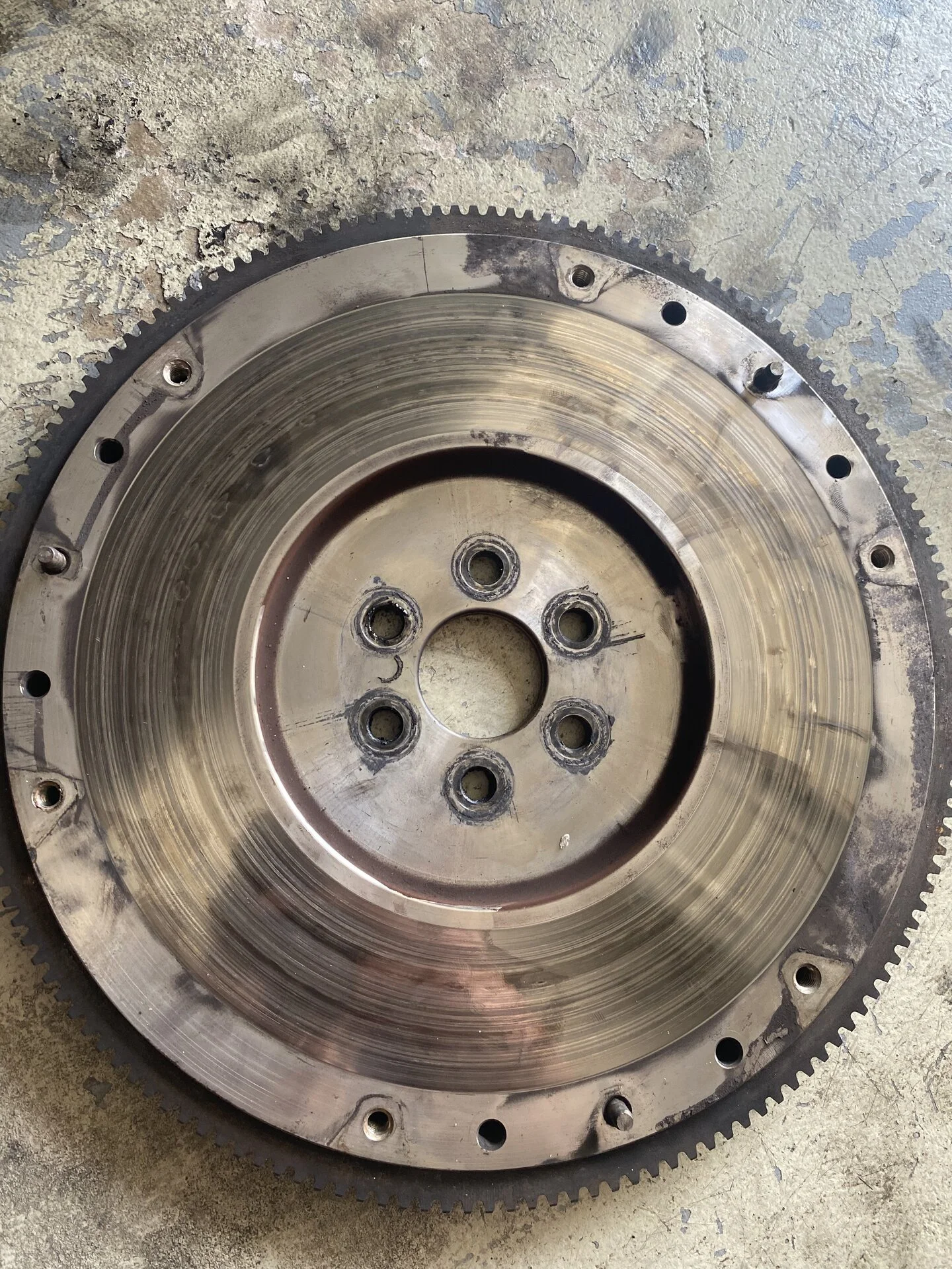

Well, the clutch and flywheel have seen better days. I ordered another flywheel, I don’t think this one is worth saving.
