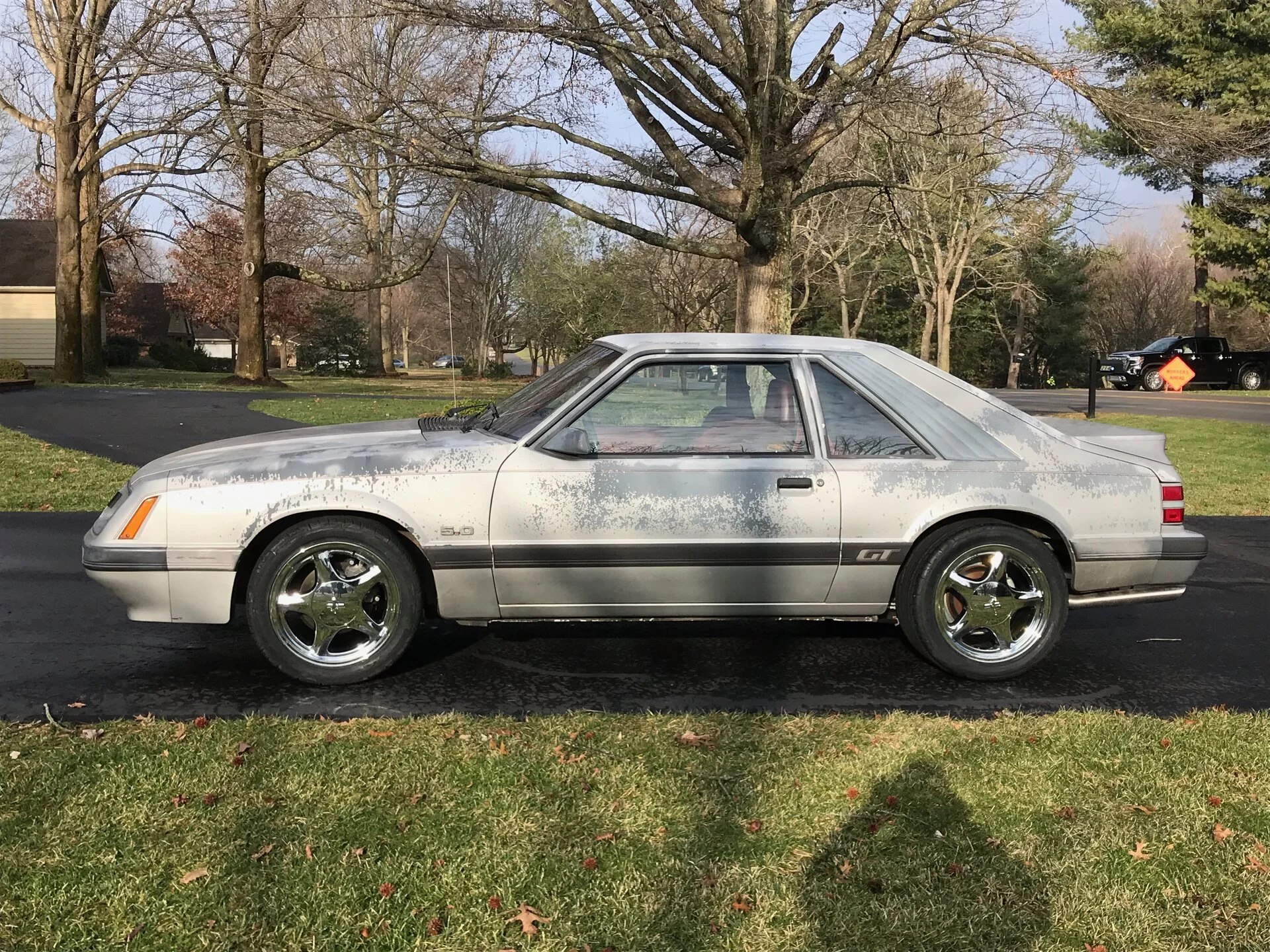

I'm feeling so blessed after looking at all the rust you had to deal with, here in the Nevada desert it's hot as Hell but dry.

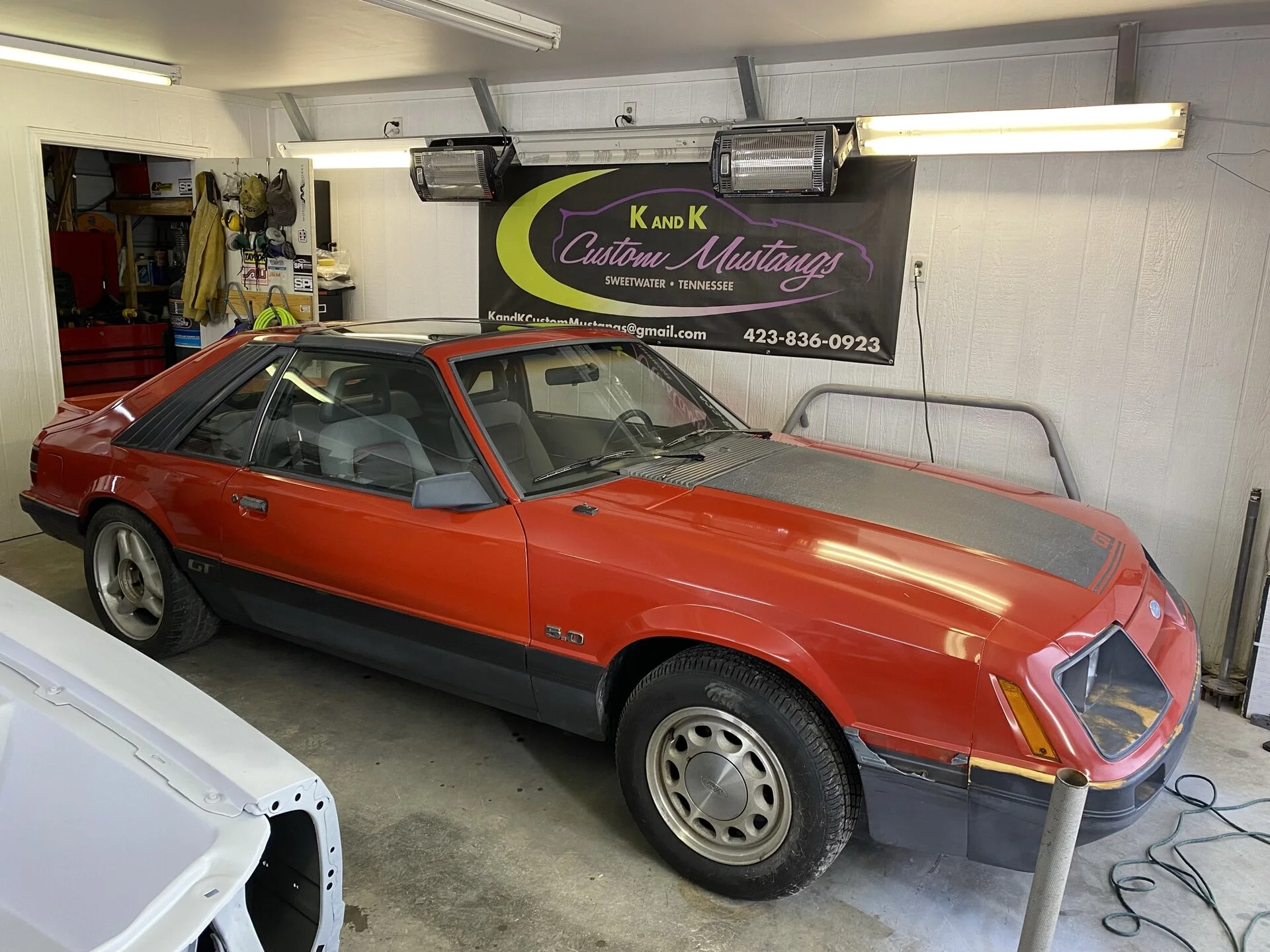

Yea. I knew it going in. OH car but was an orginial owner so It should go to someone who can save it. My 98 Saleen came from Vegas. I flew out and drove it back. No rust just a crap
Load of dust and dirt

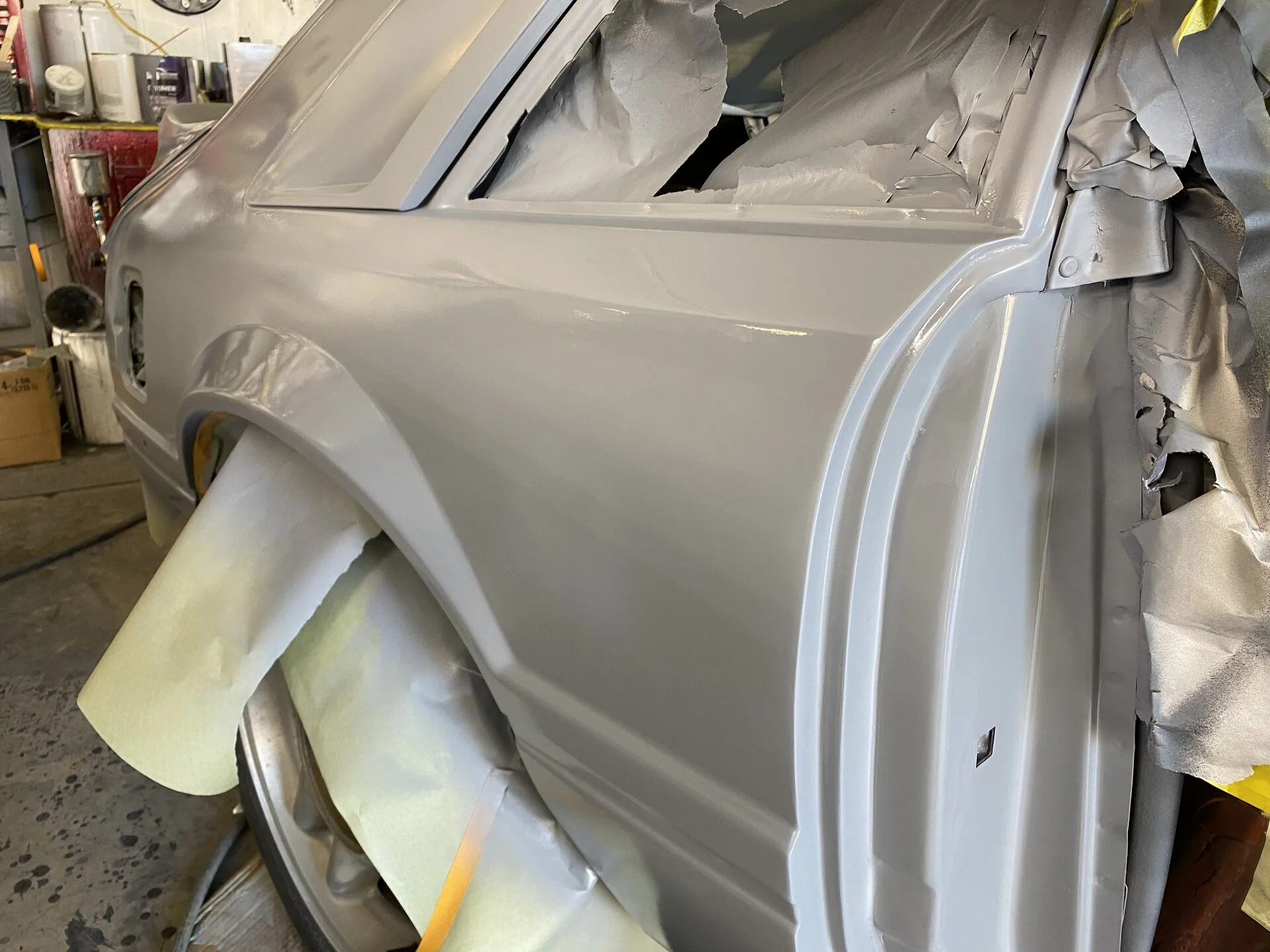

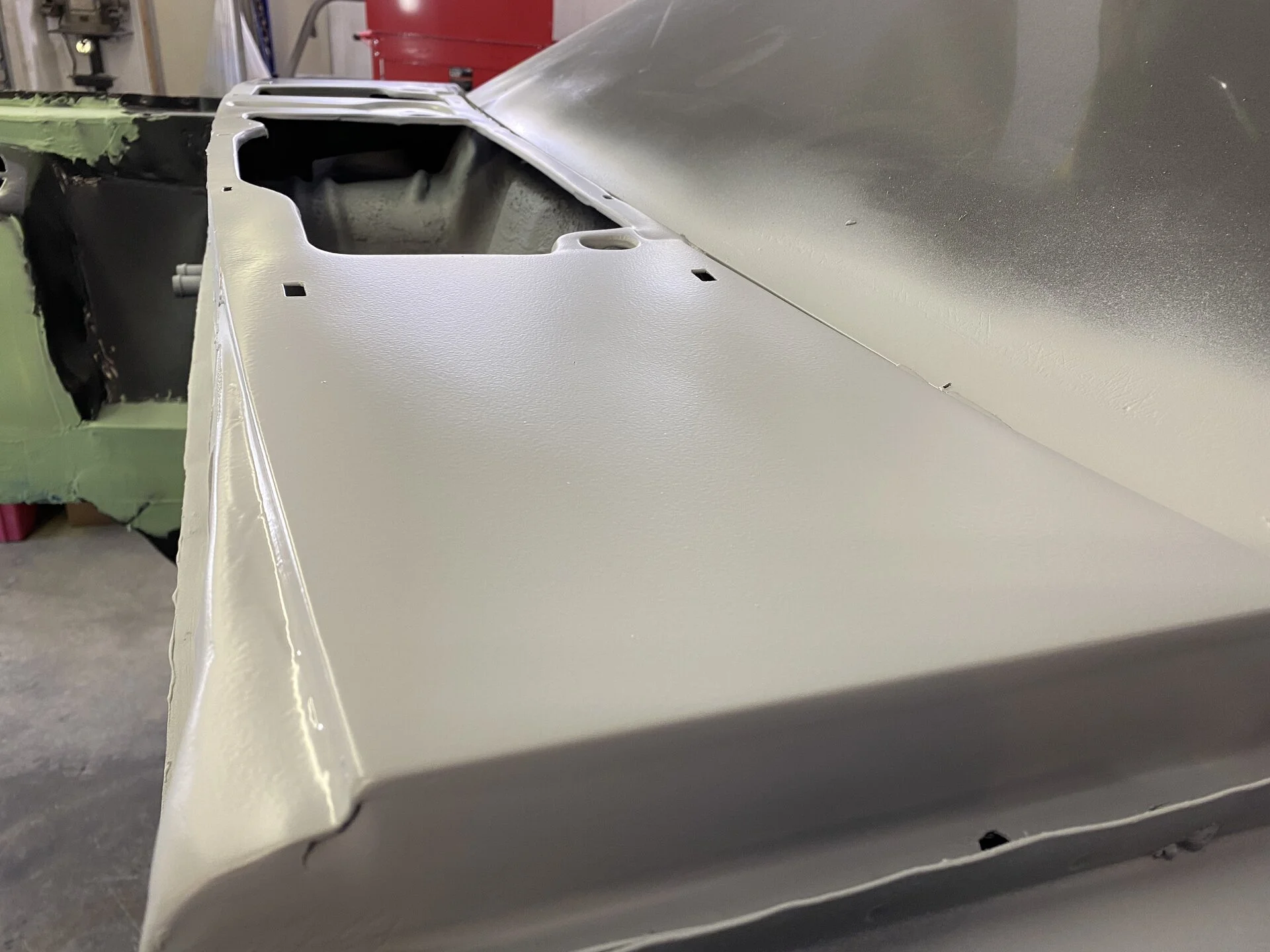

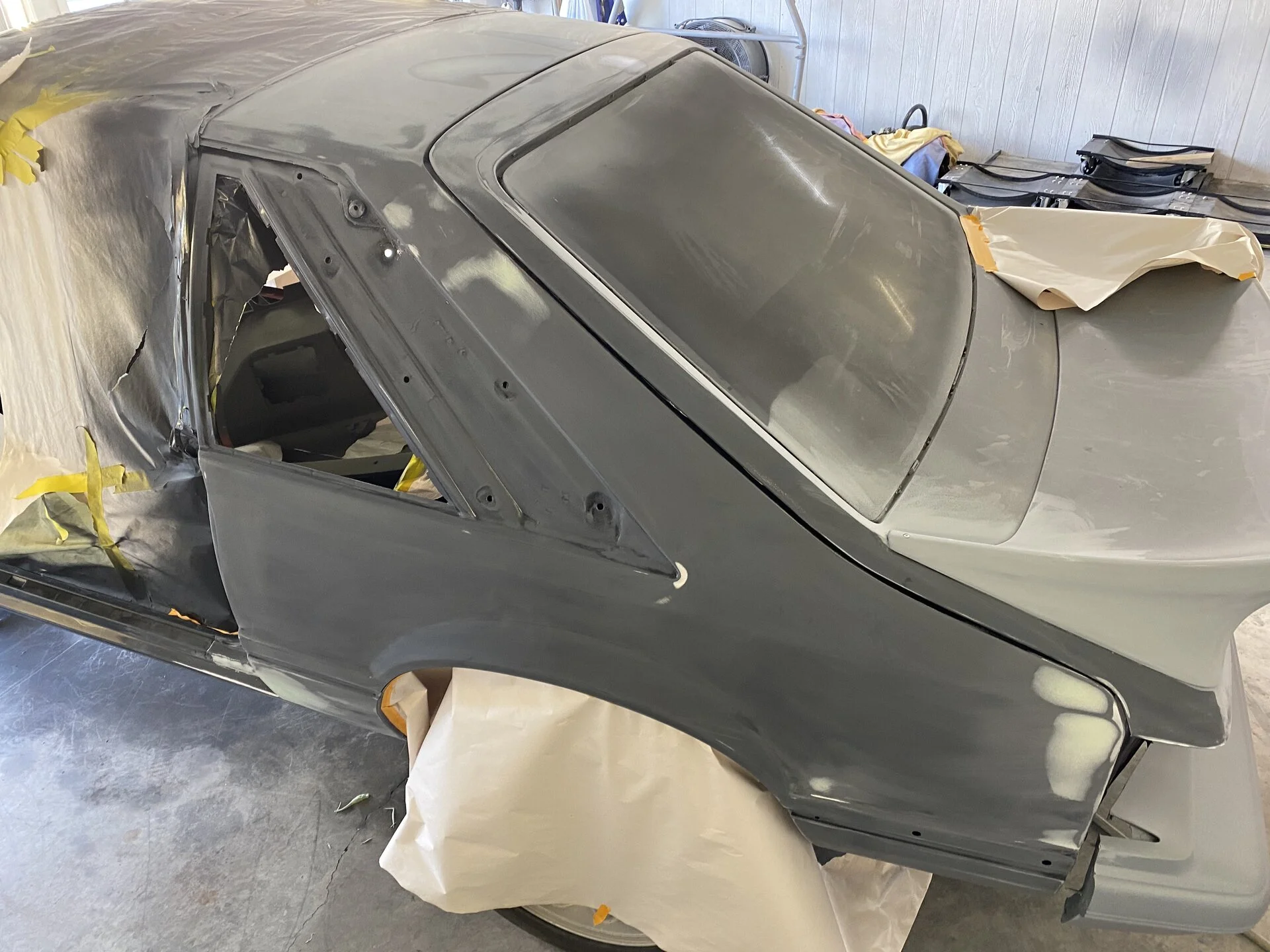

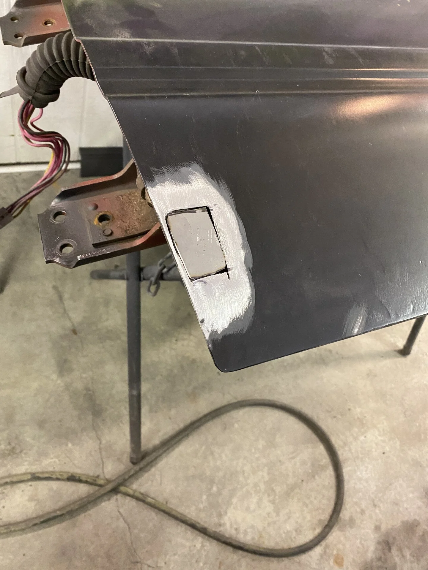

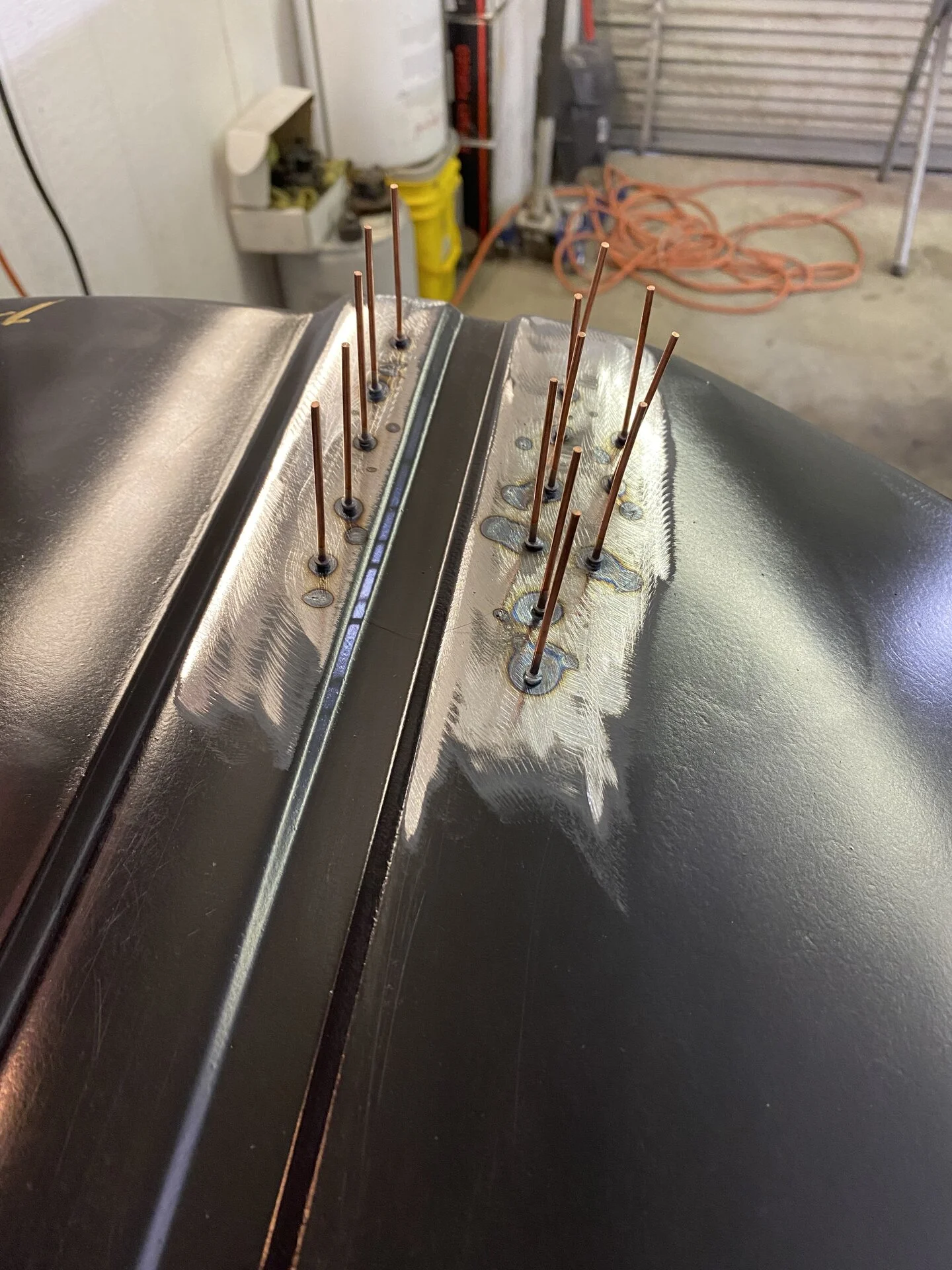

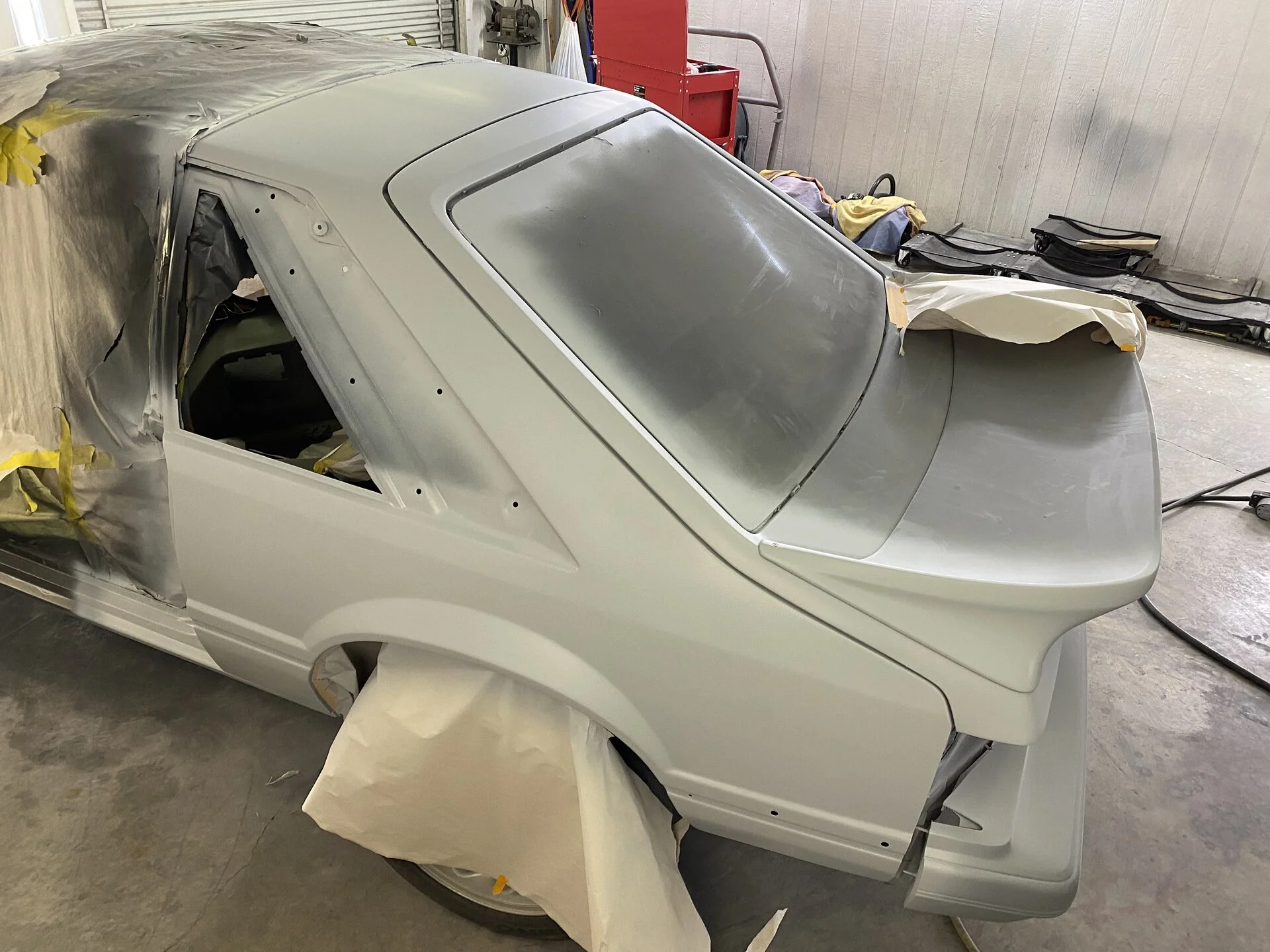

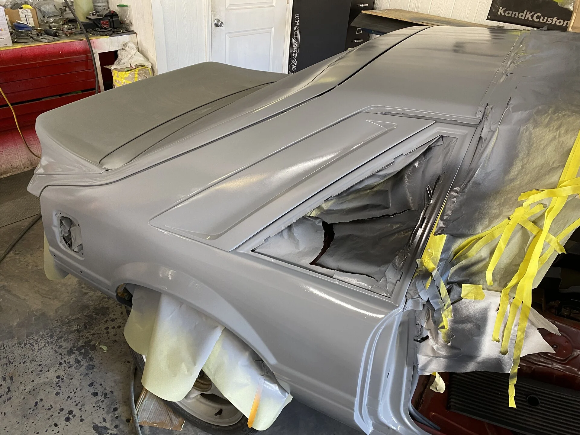

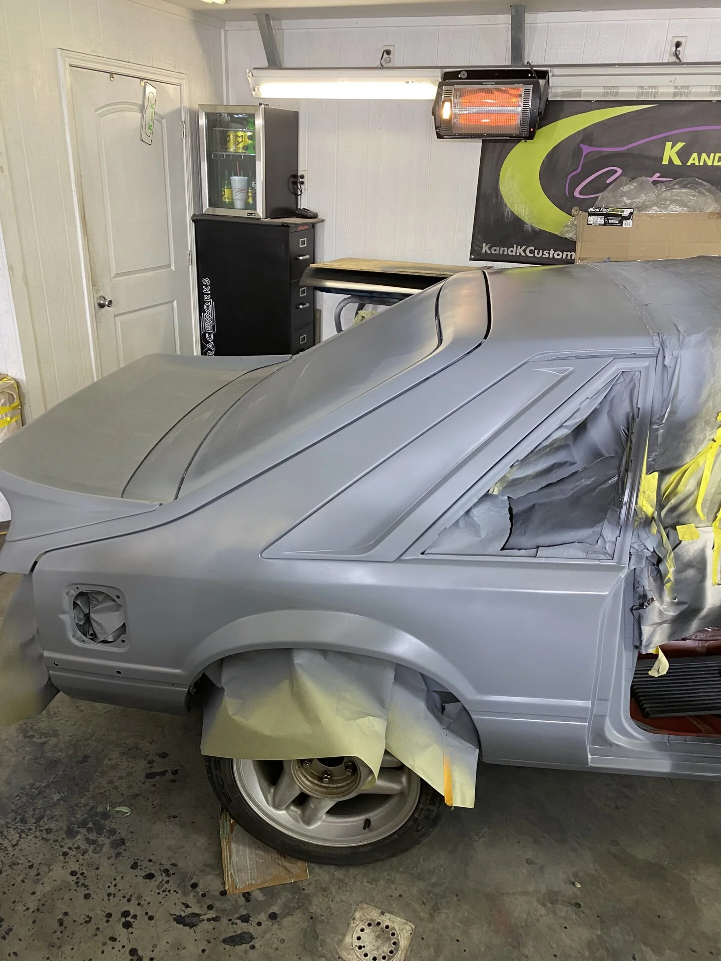

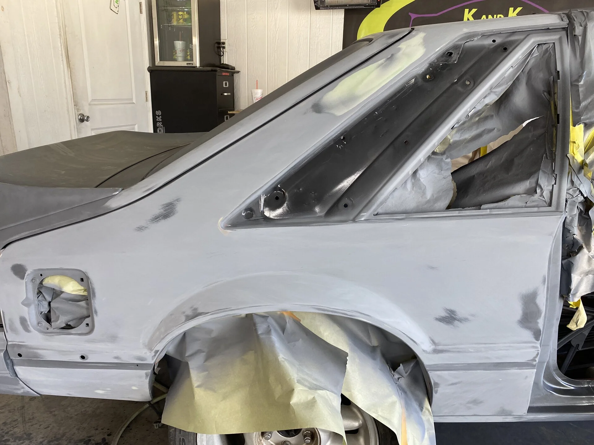

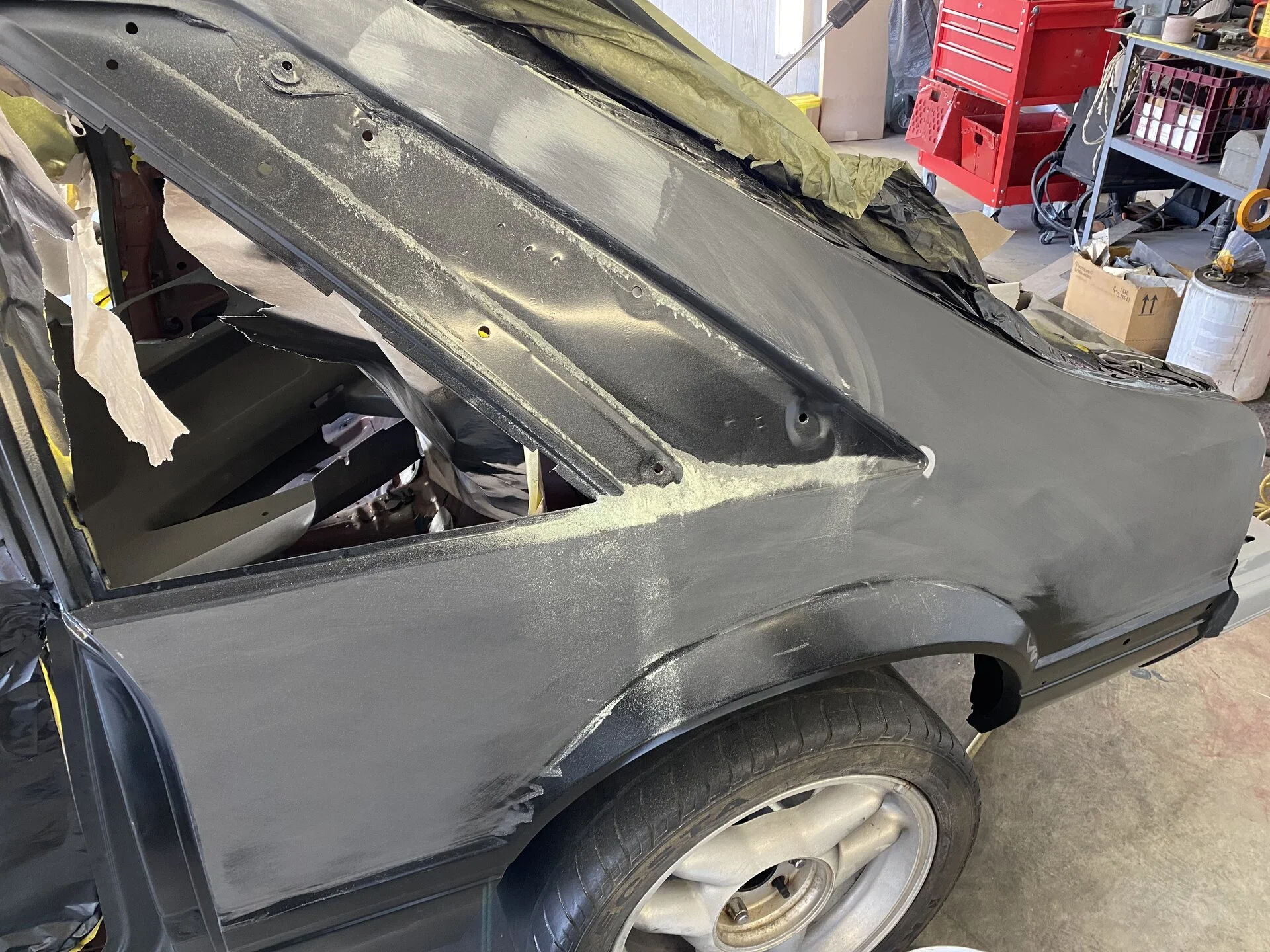

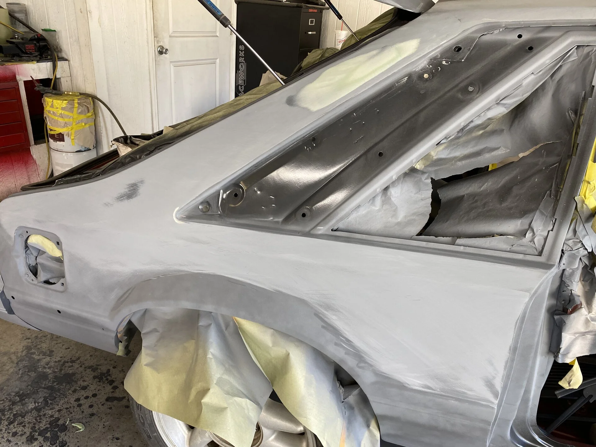

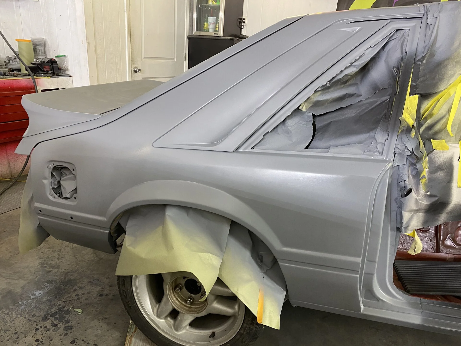

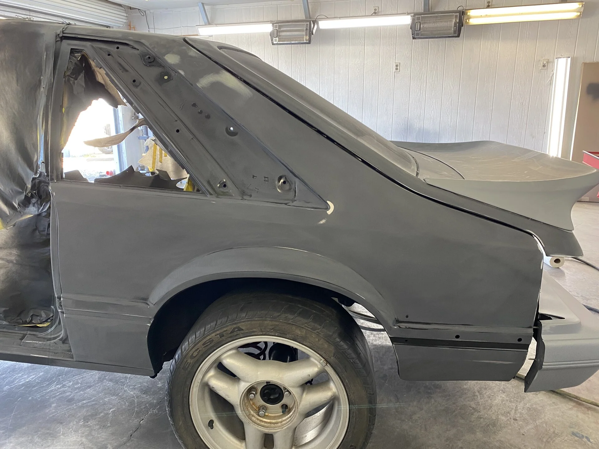

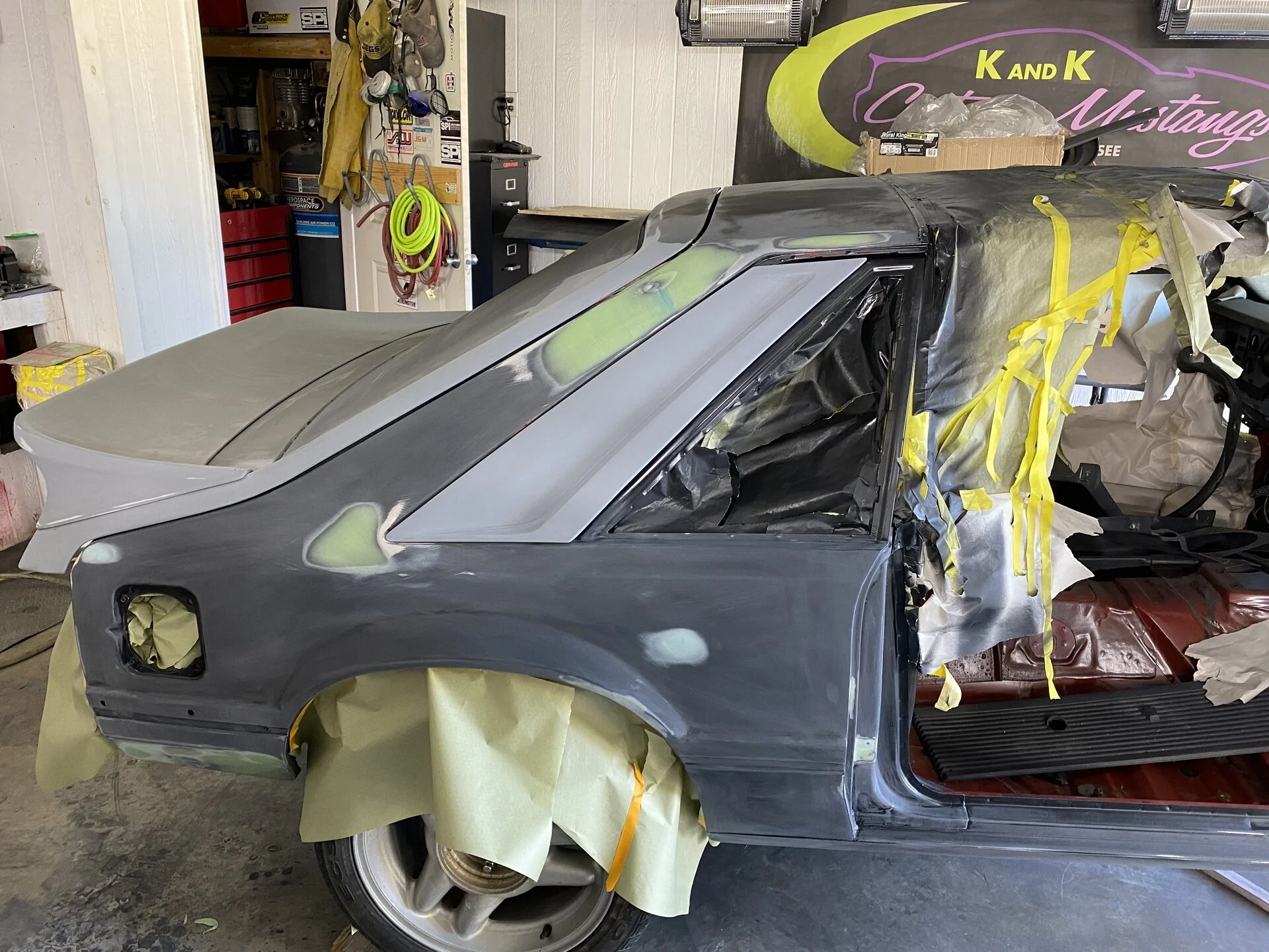

Body work done on pass quarter. This panel
Only had 1 ding. Everything else was correcting factory ripples and stamping problems

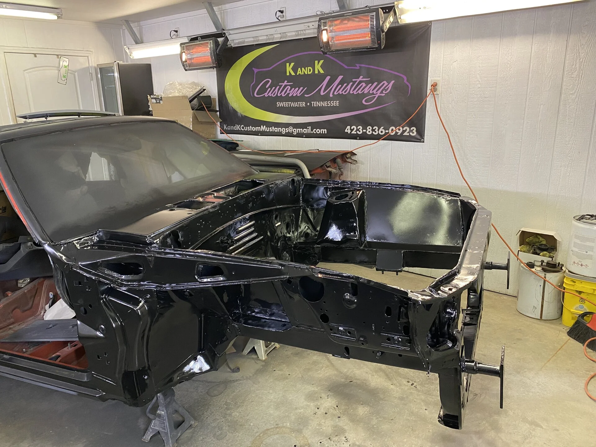

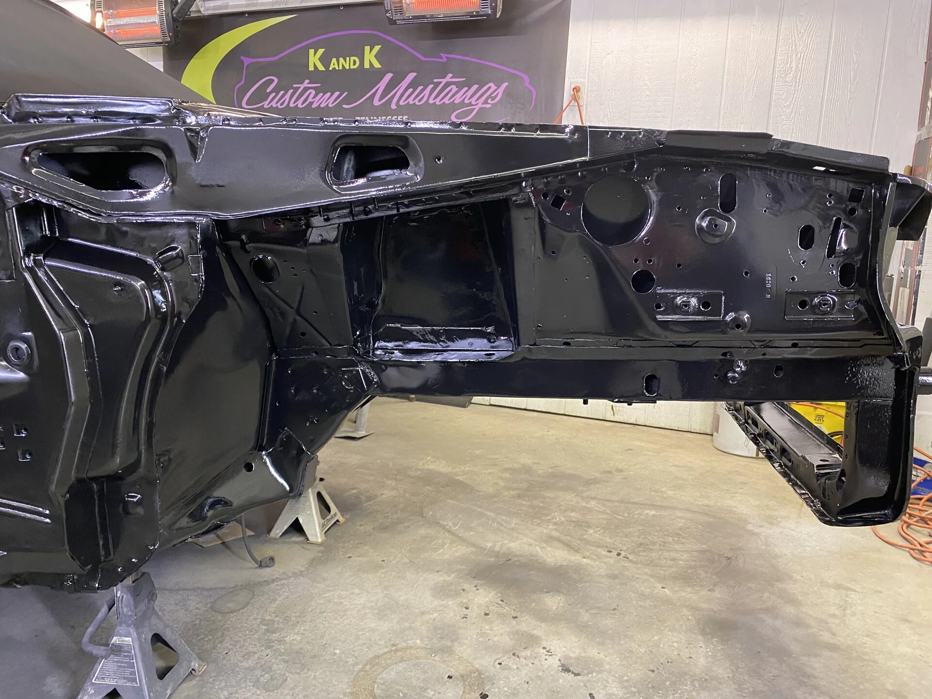

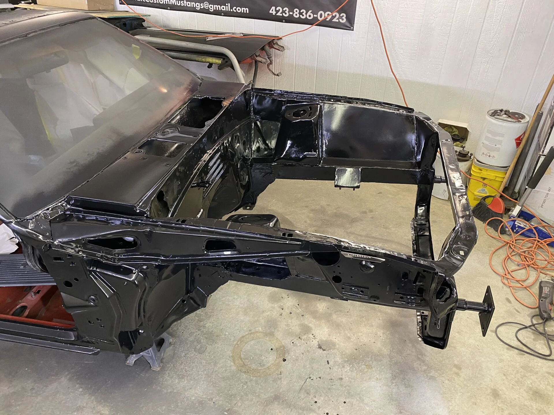

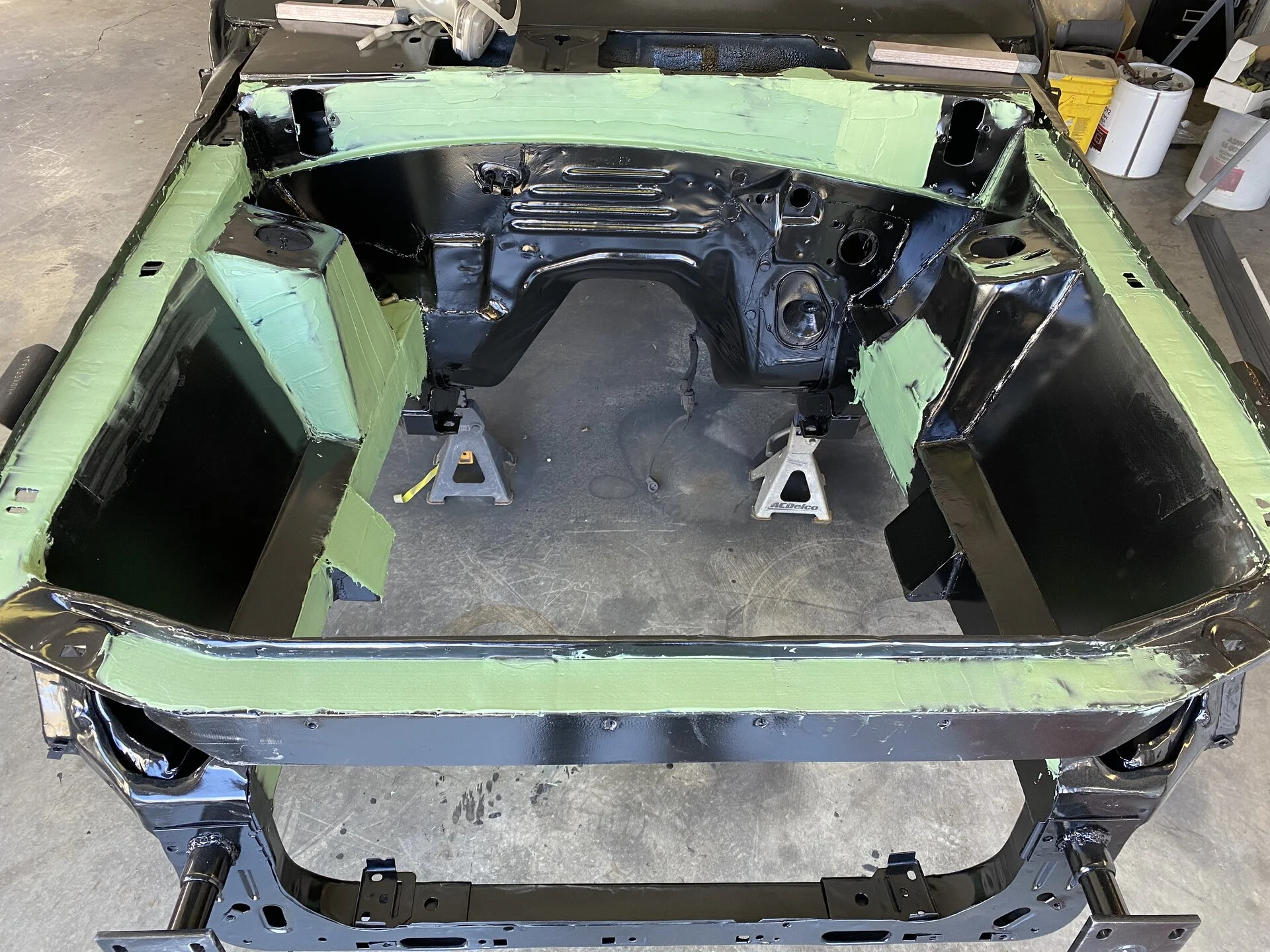

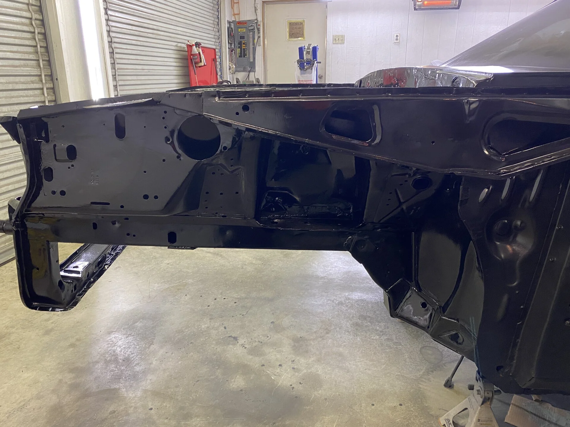

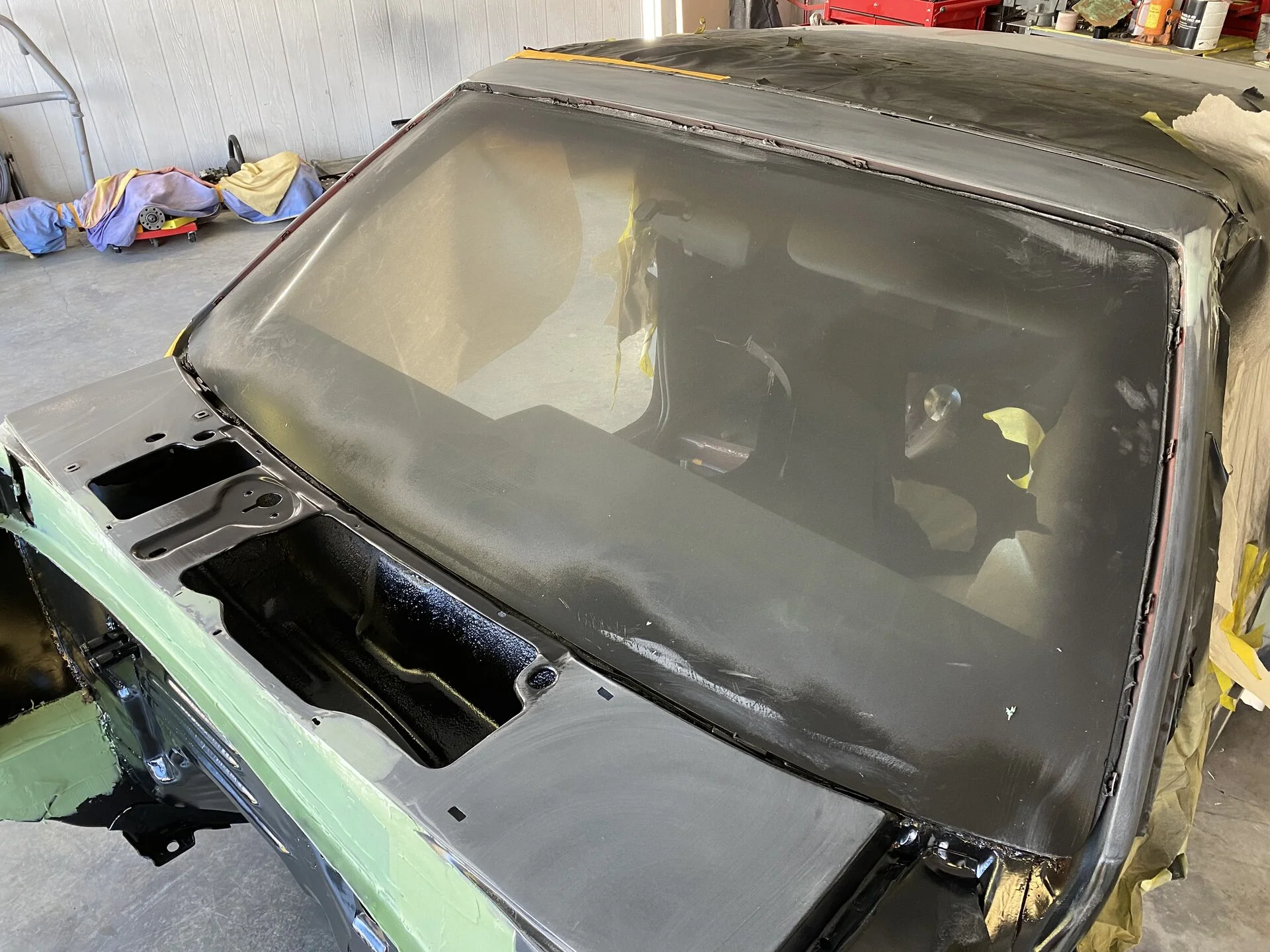

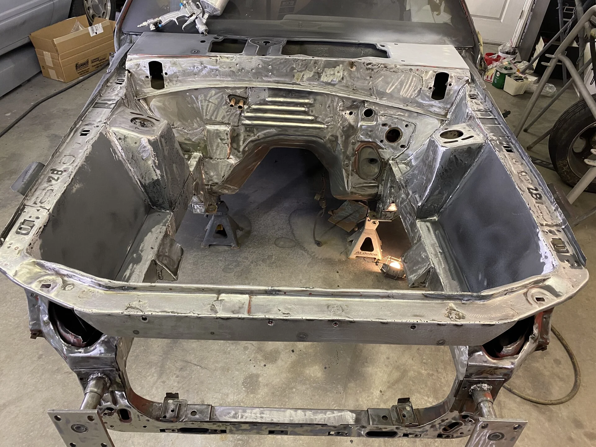

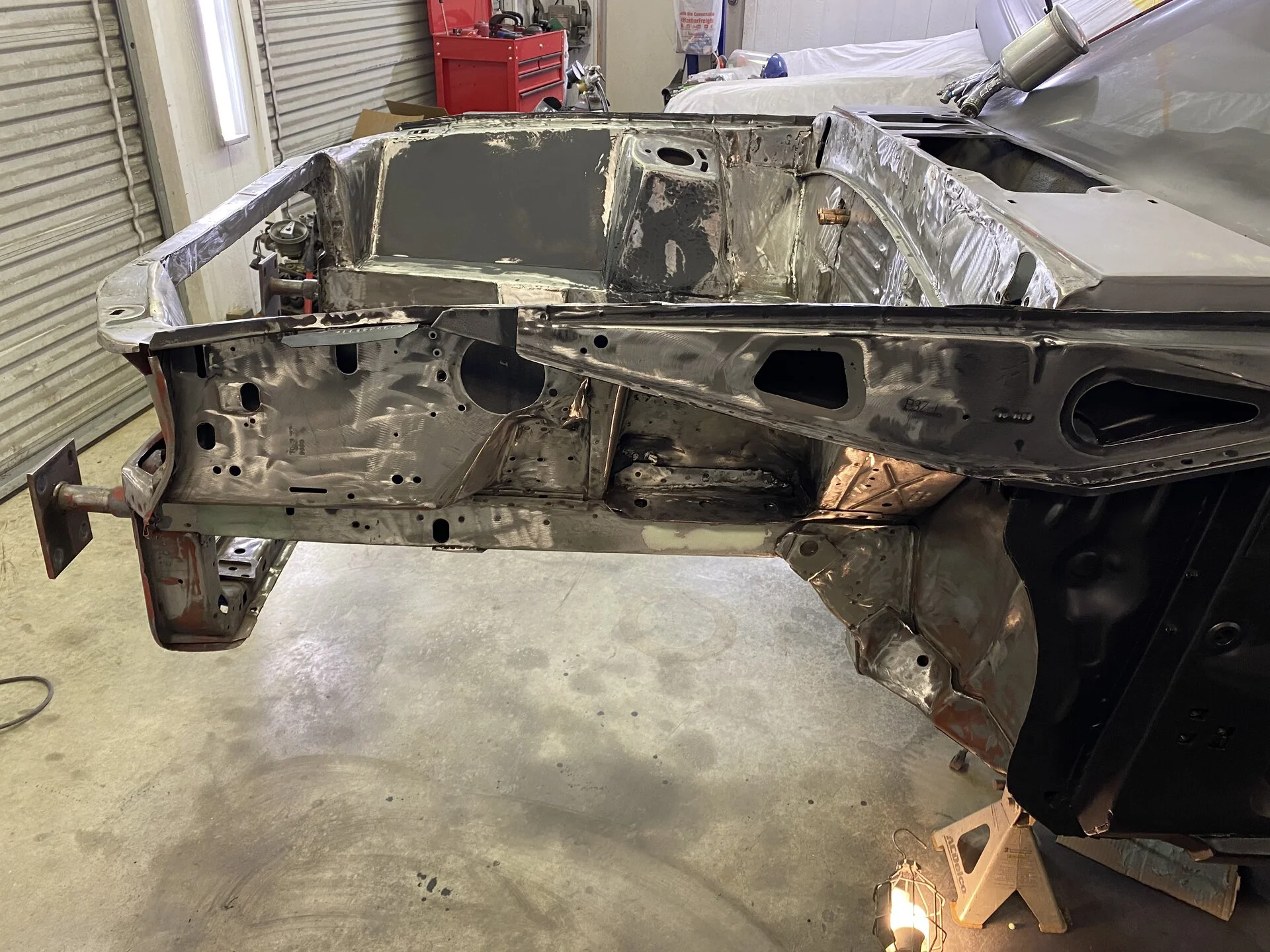

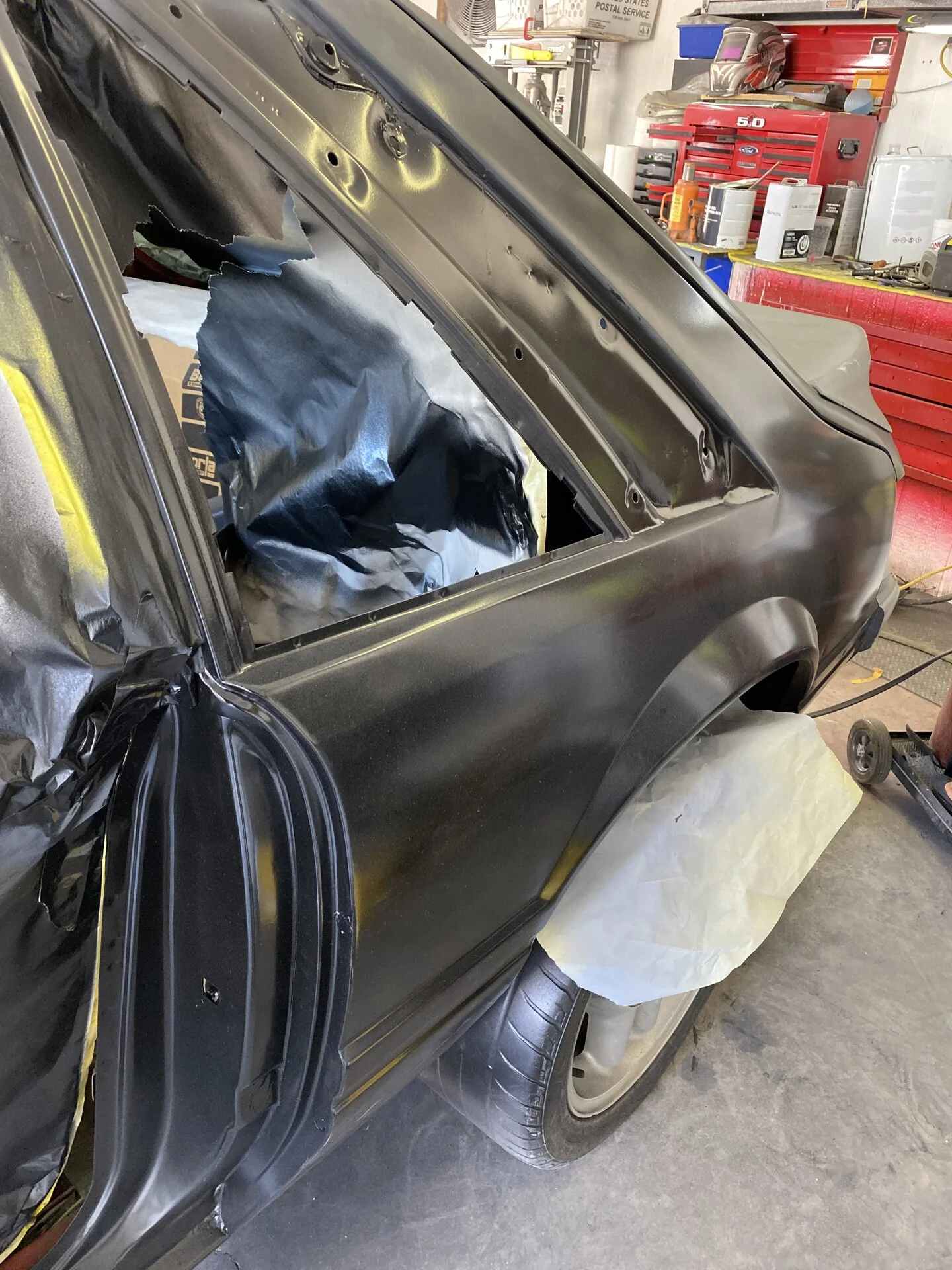

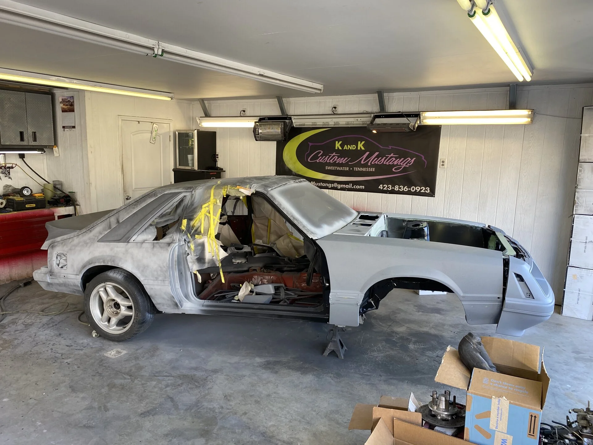

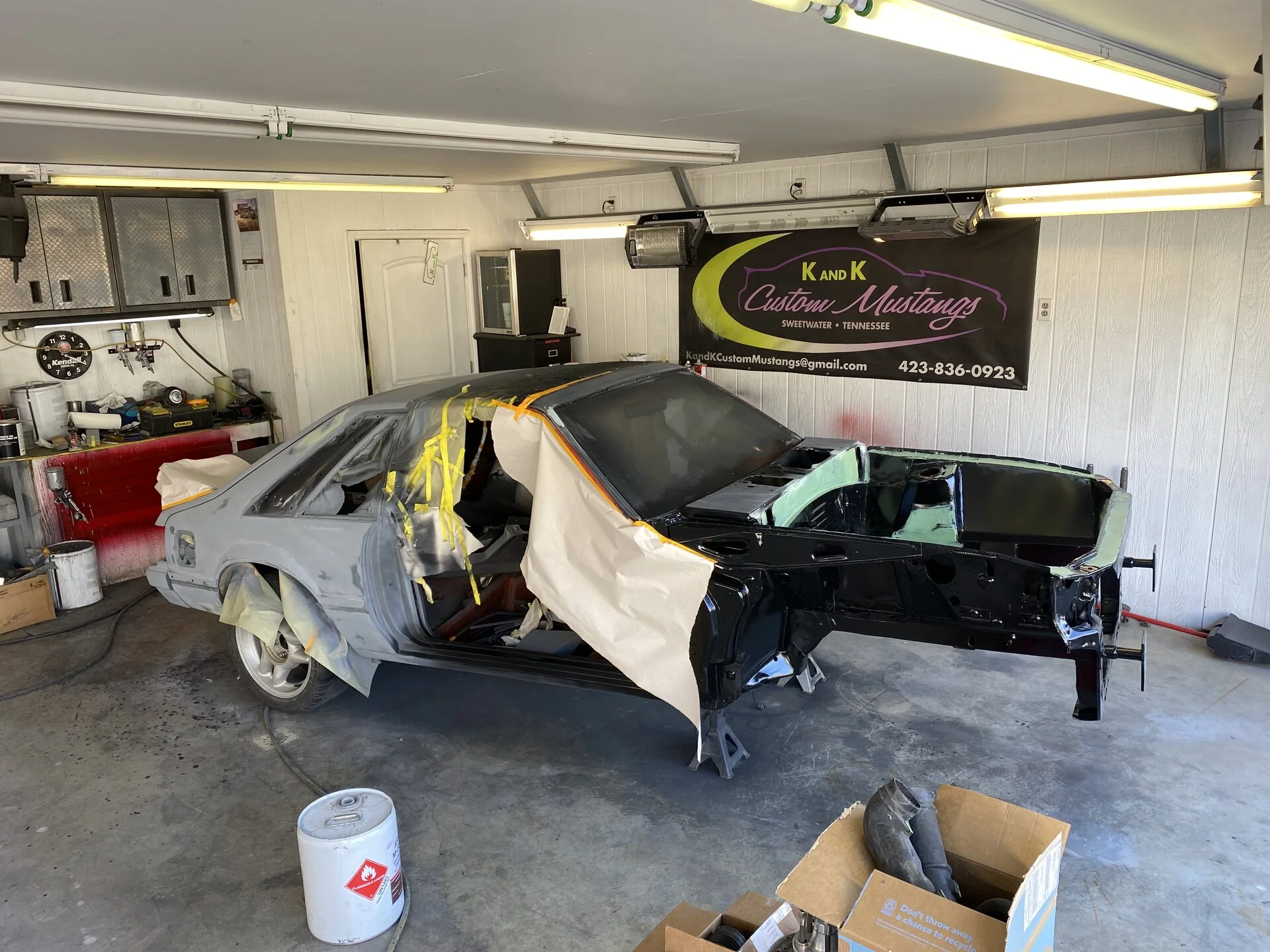

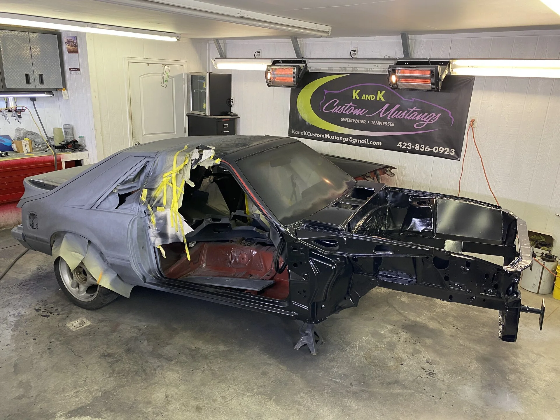

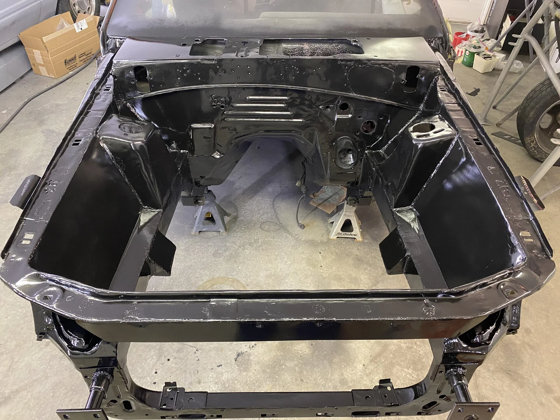

This is a huge step for me. Everything stripped is now in epoxy. Engine bay metal work officially done and sealed. Some overnight early morning spraying

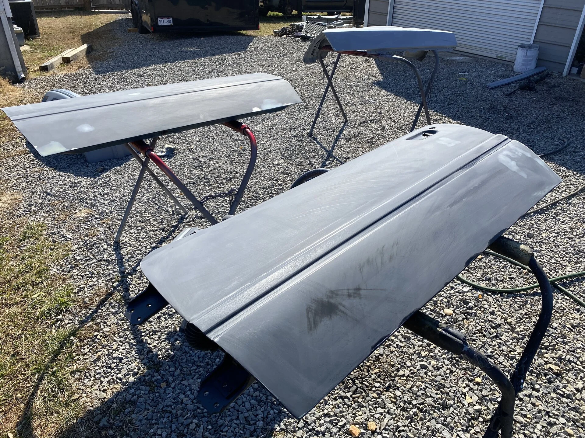

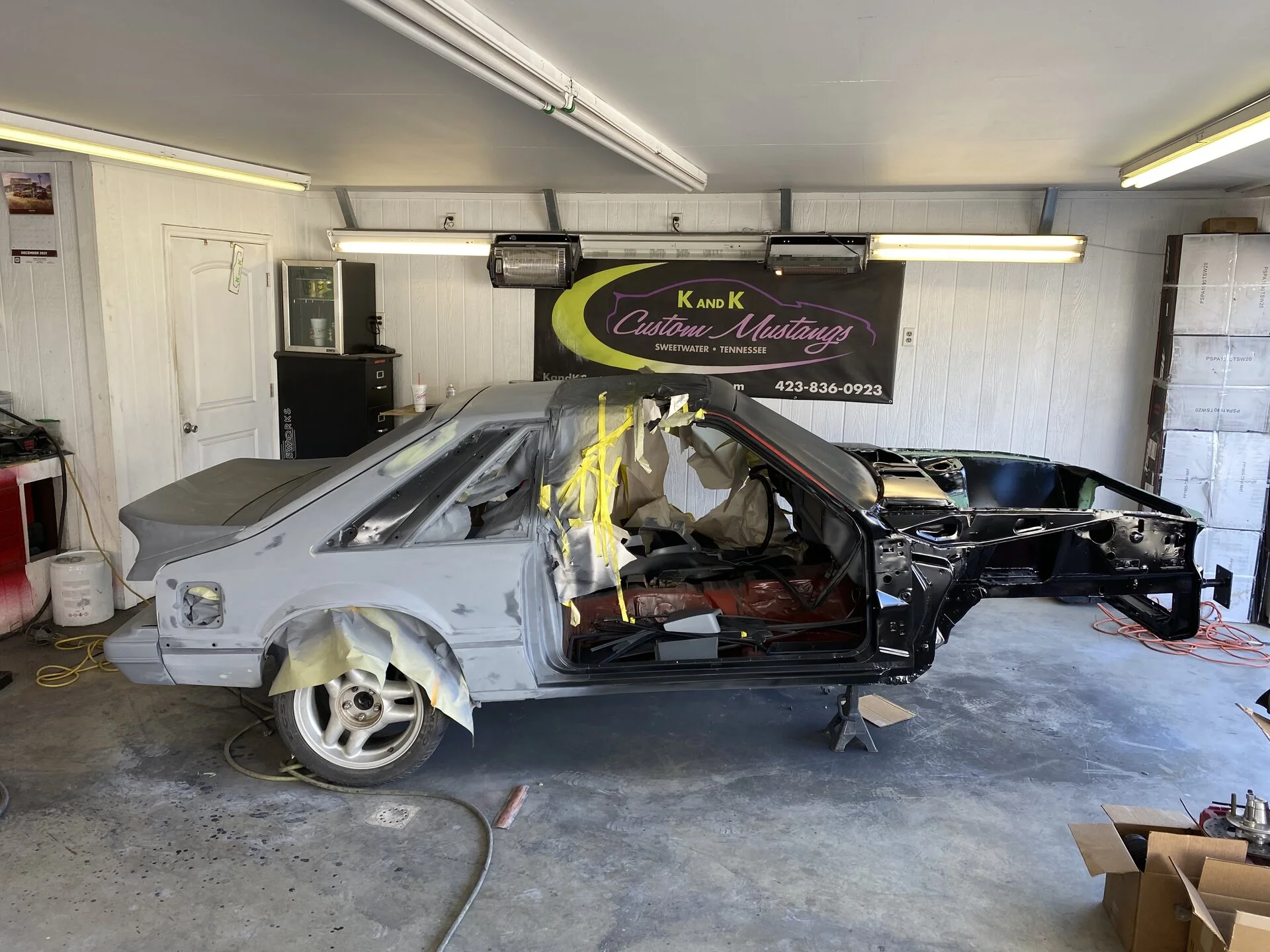

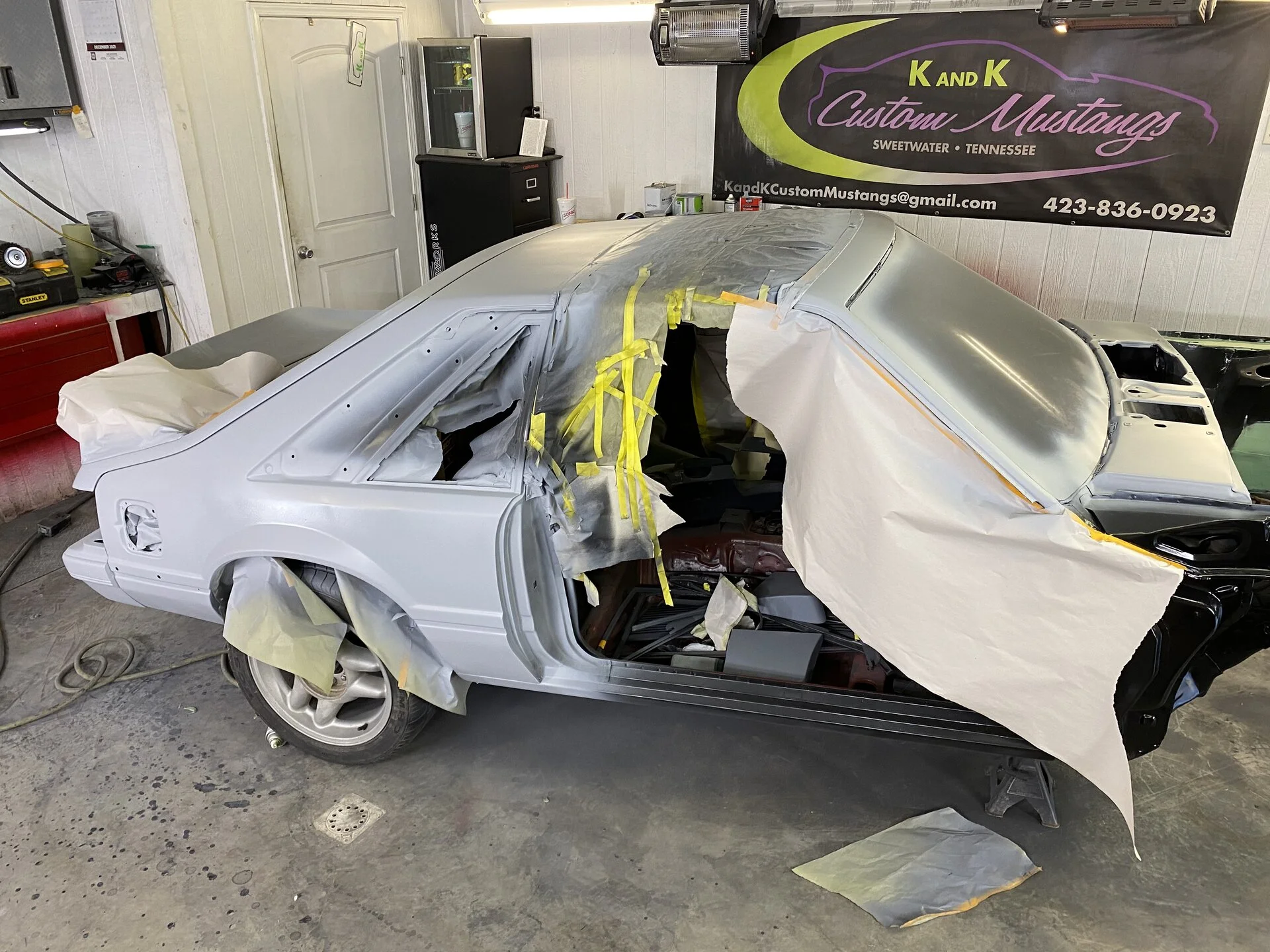

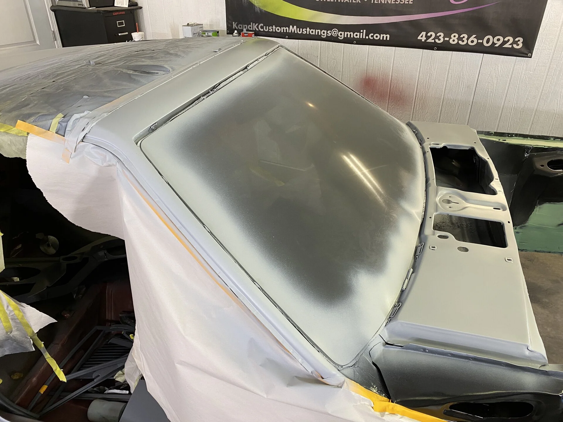

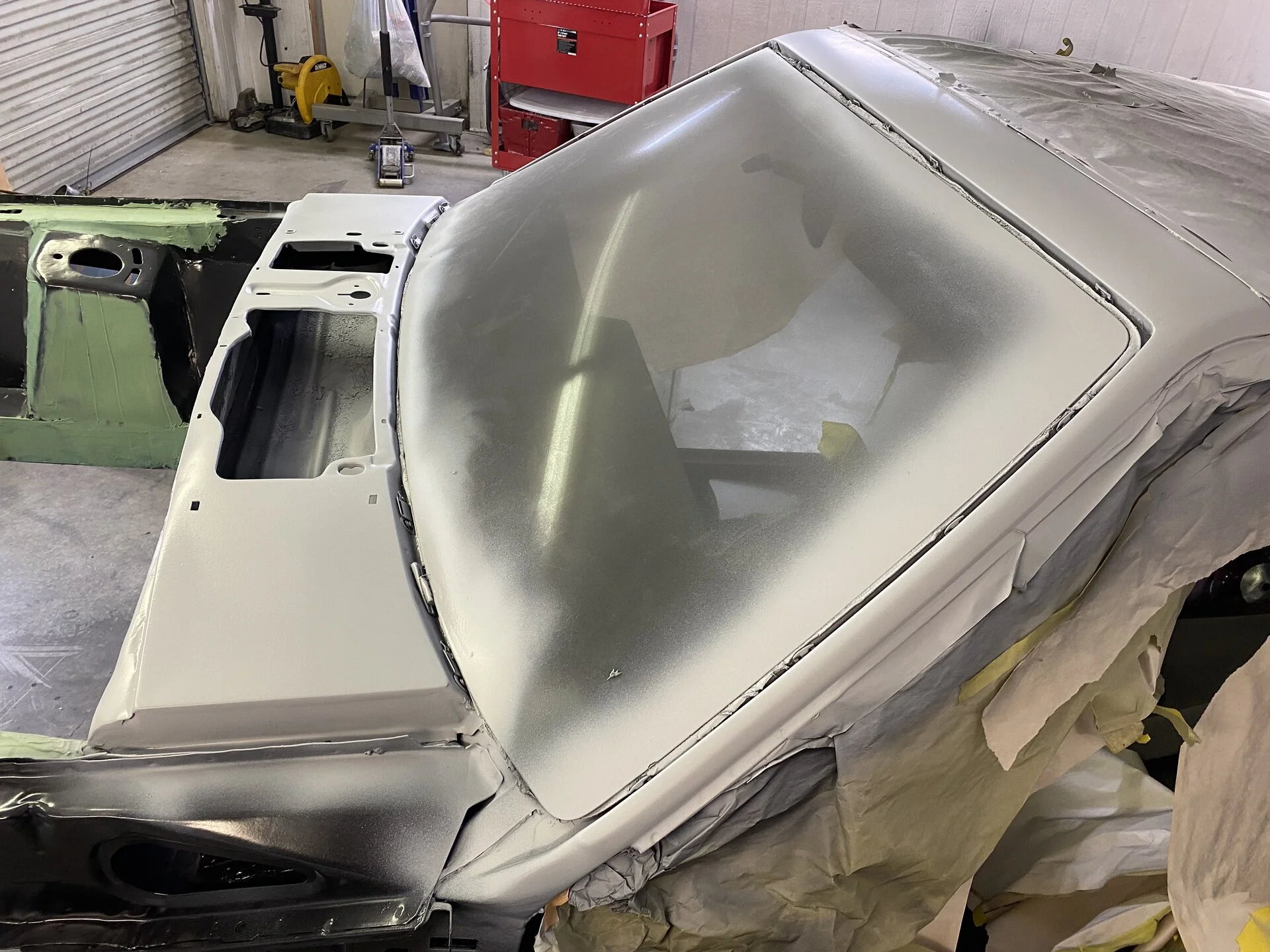

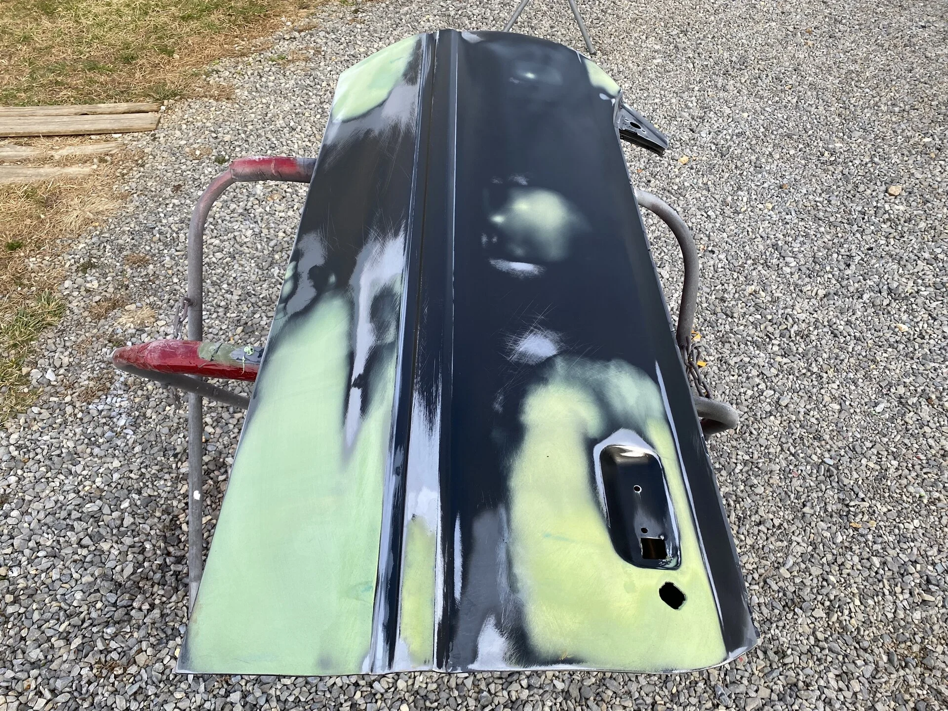

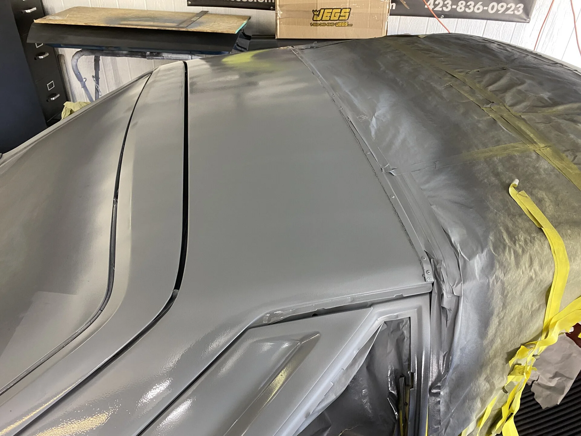

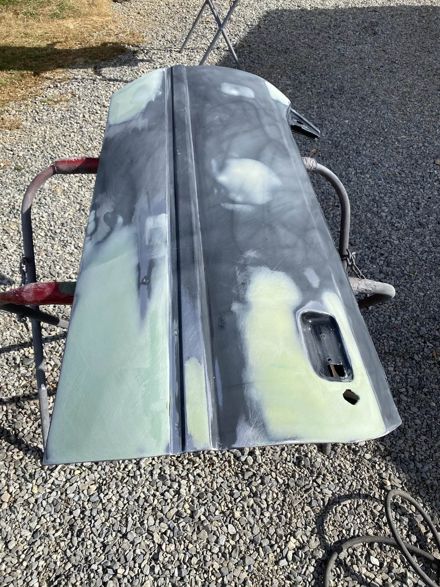

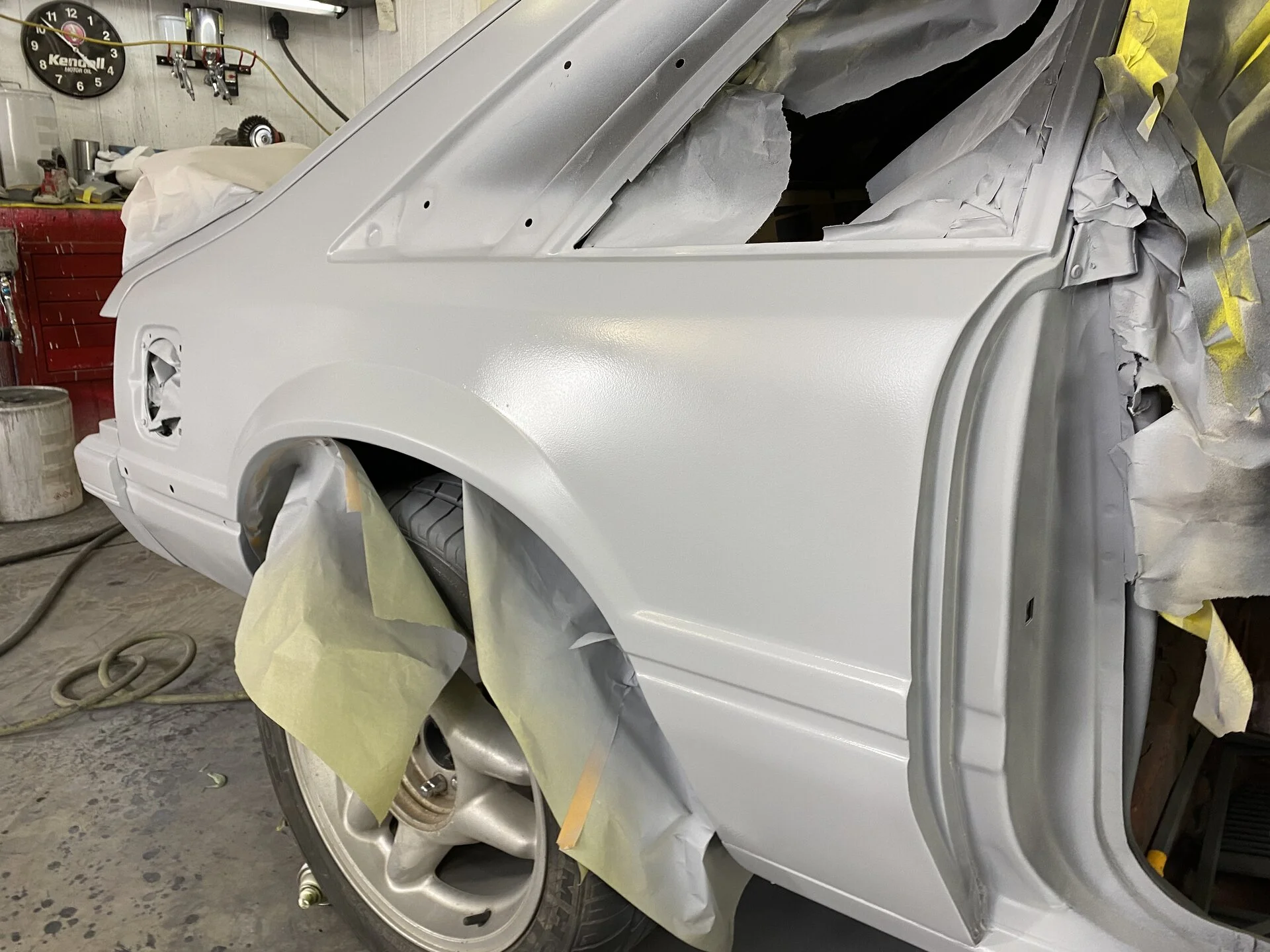

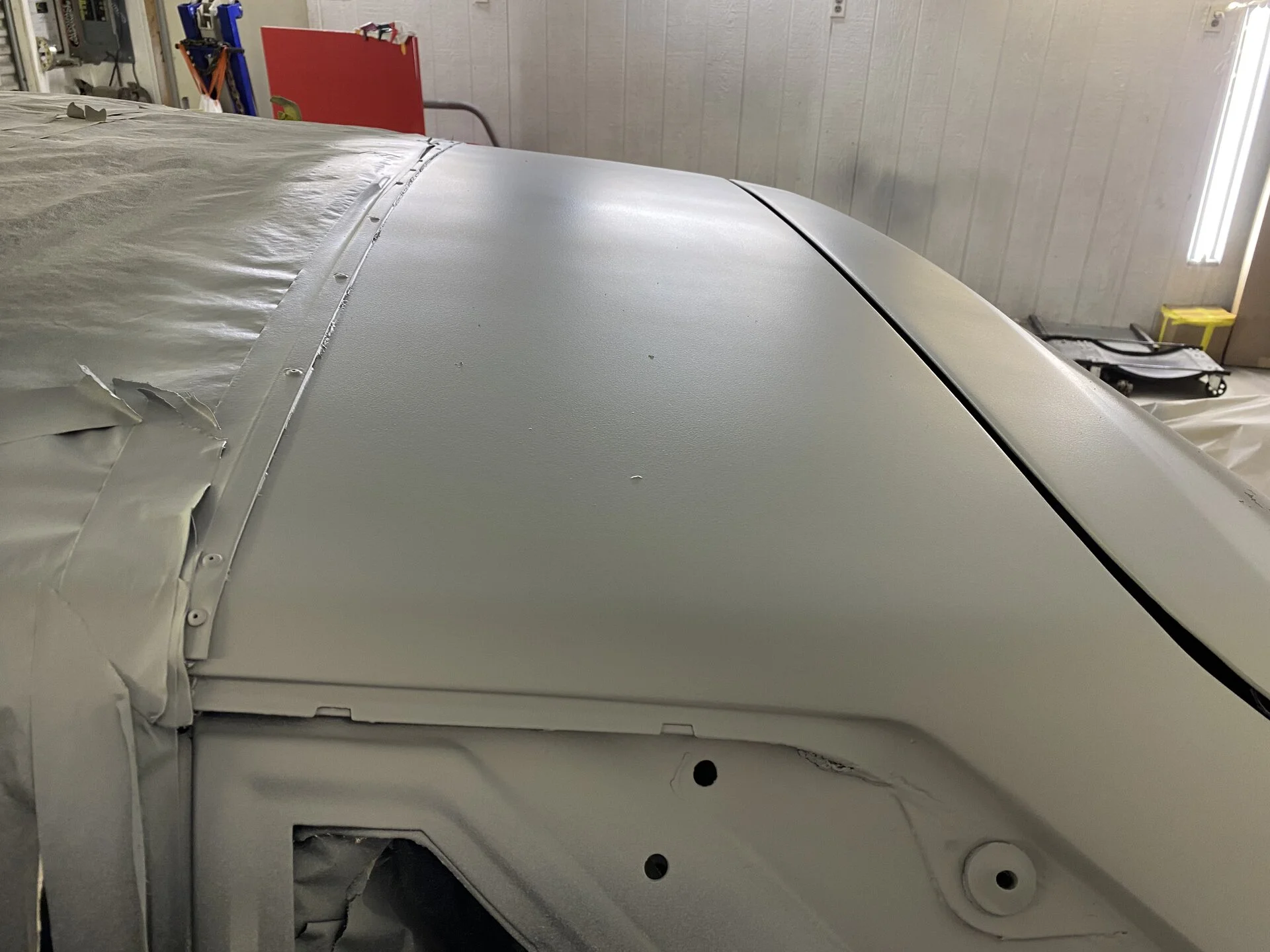

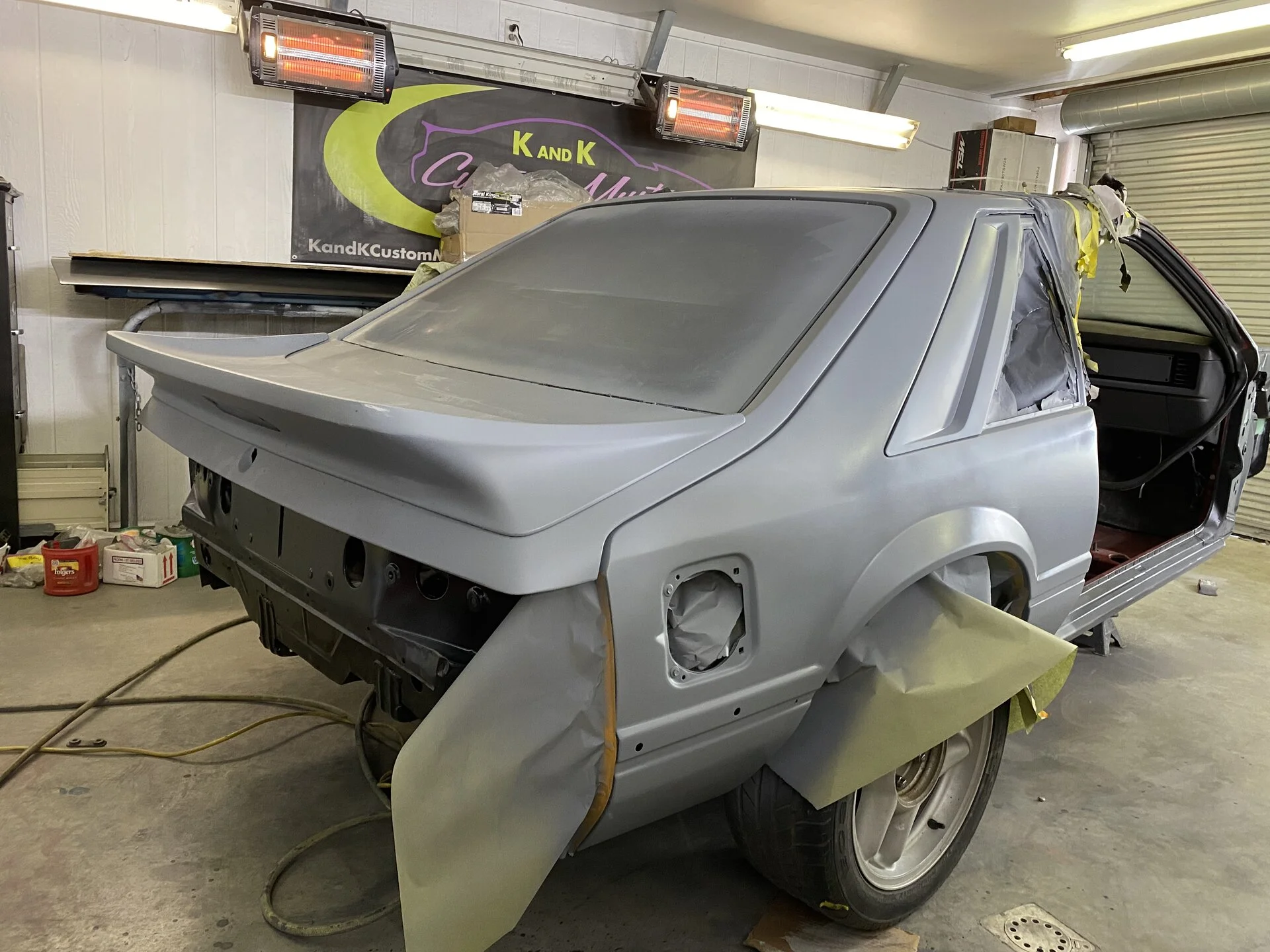

Well. I have several updates on the 85 because I went into OT to get everything in 2k

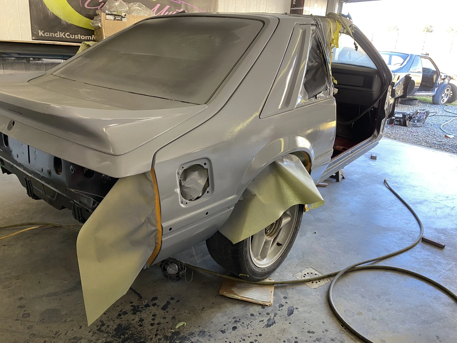

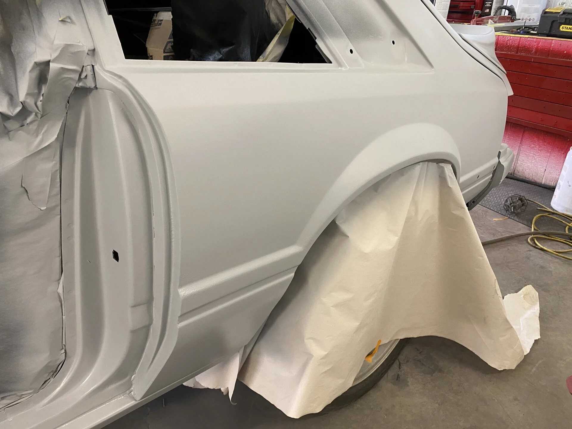

Primer. As mentioned above today was 3 months on this car. Sadly it will be going on the back burner after today because I have lots of waiting projects needing my attention. Anyway.

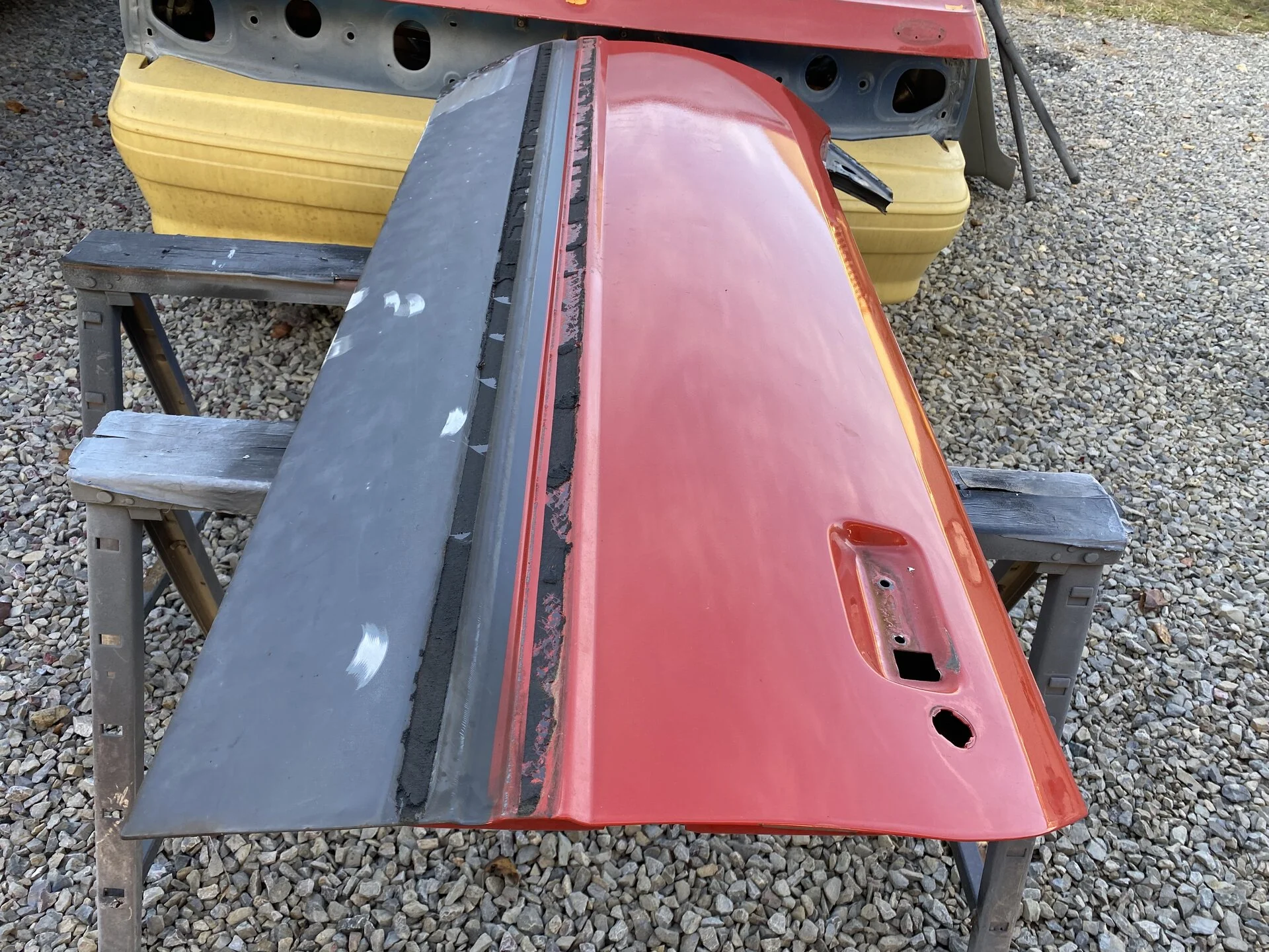

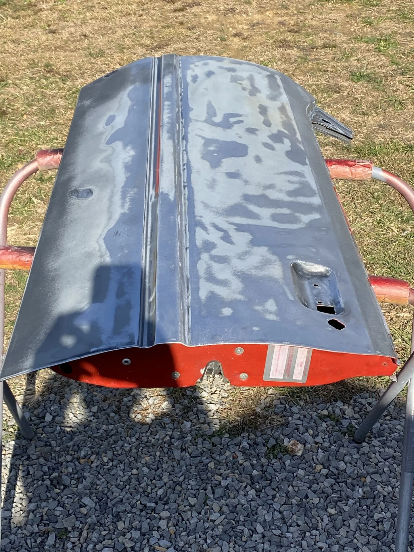

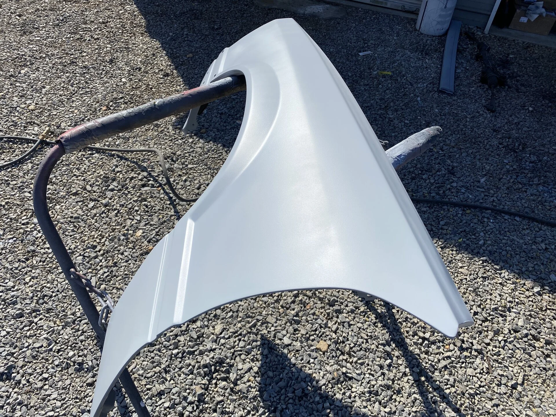

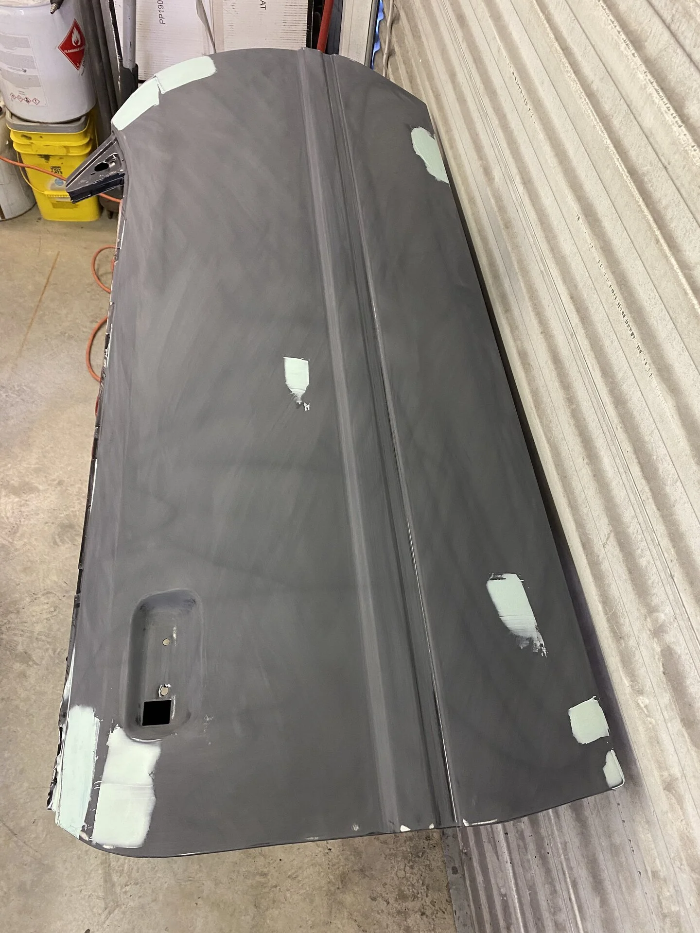

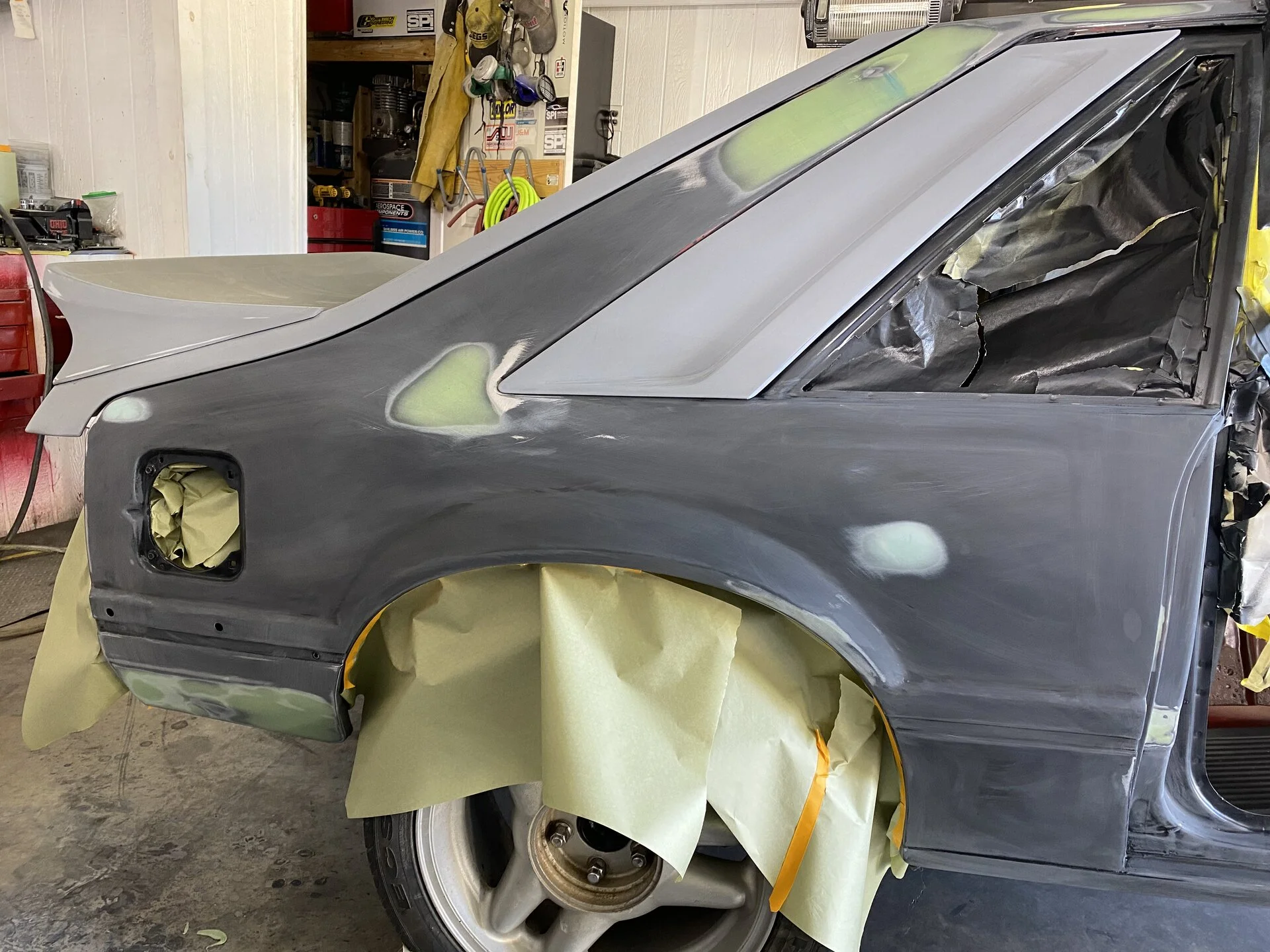

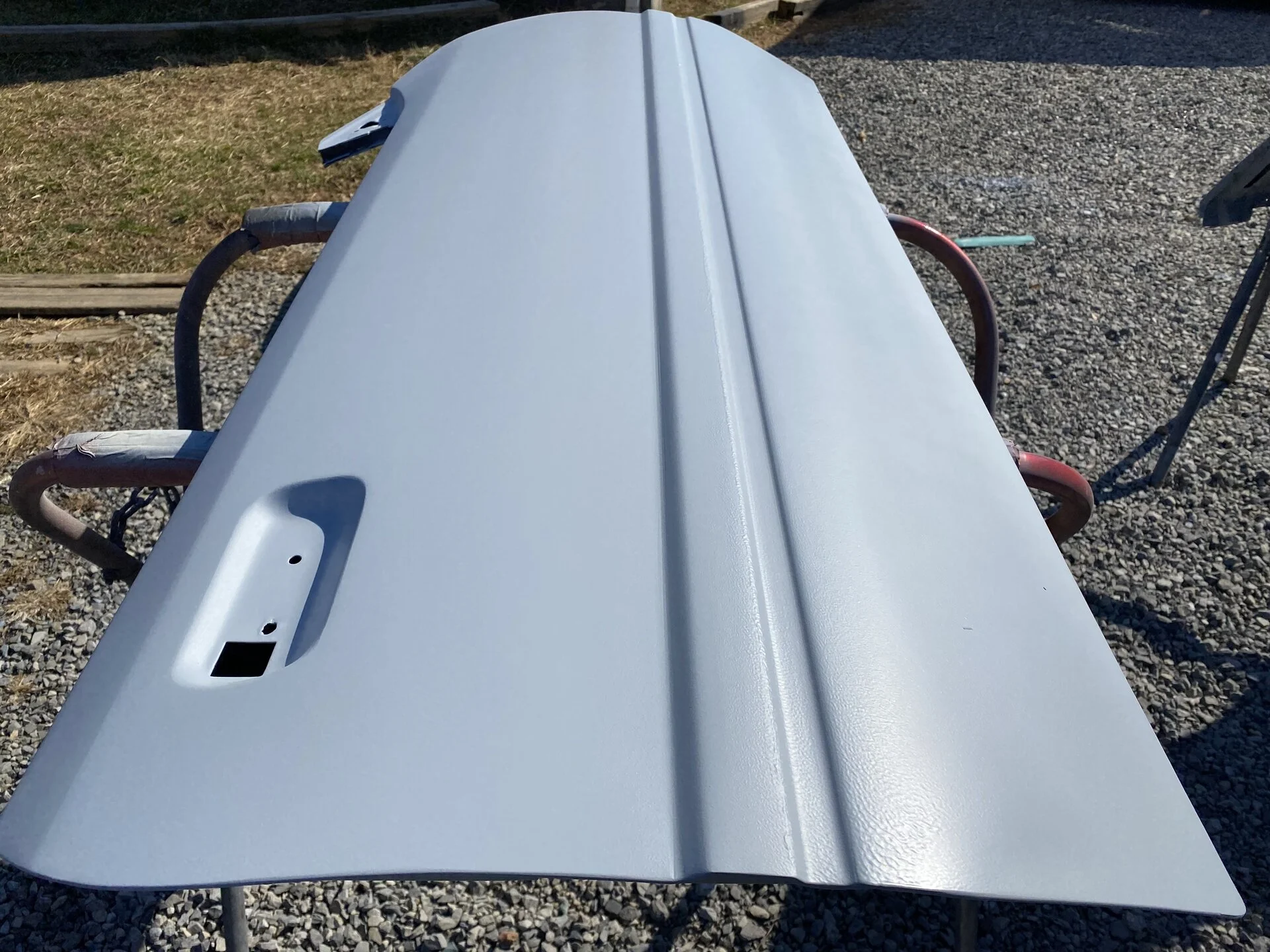

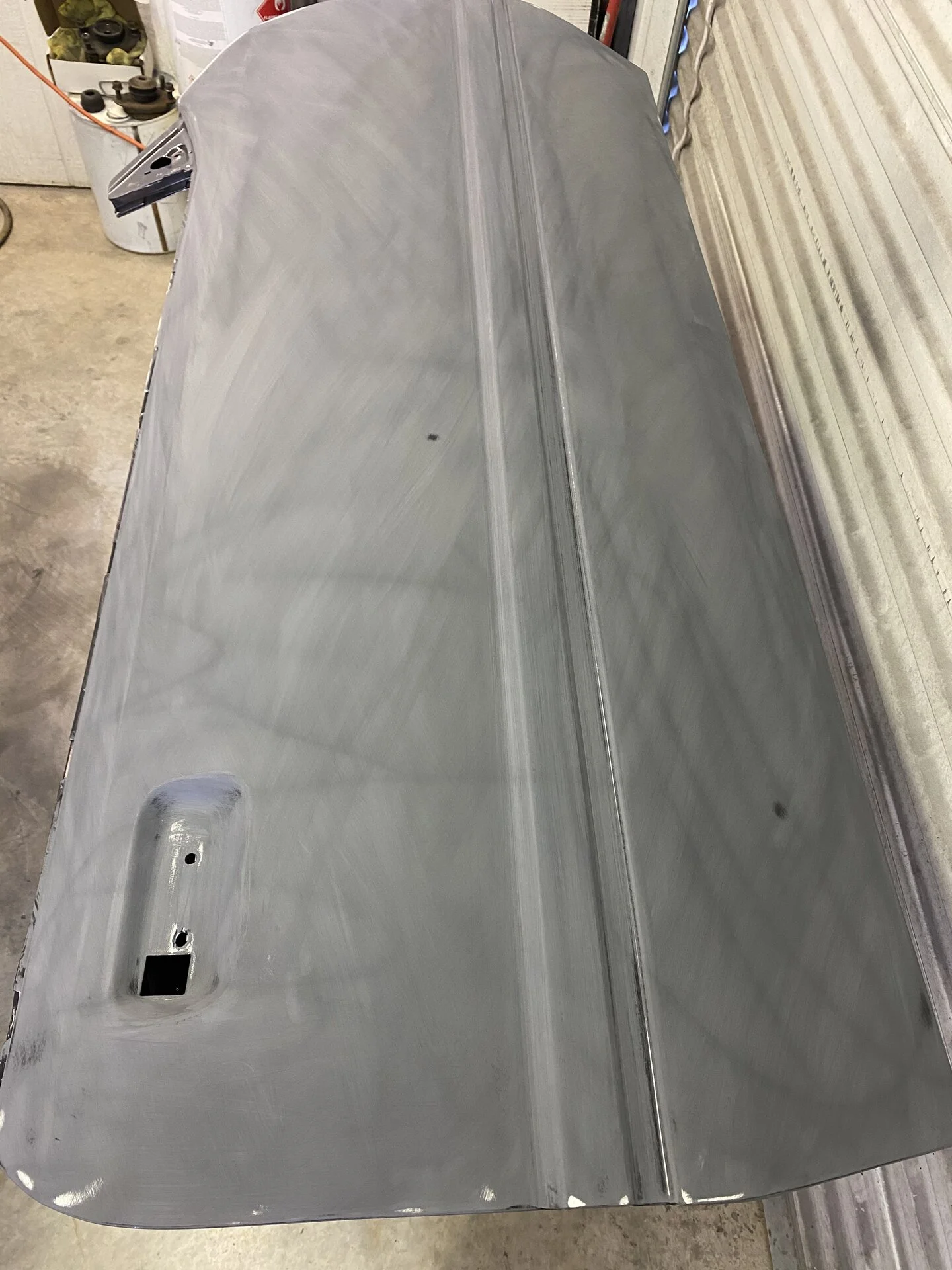

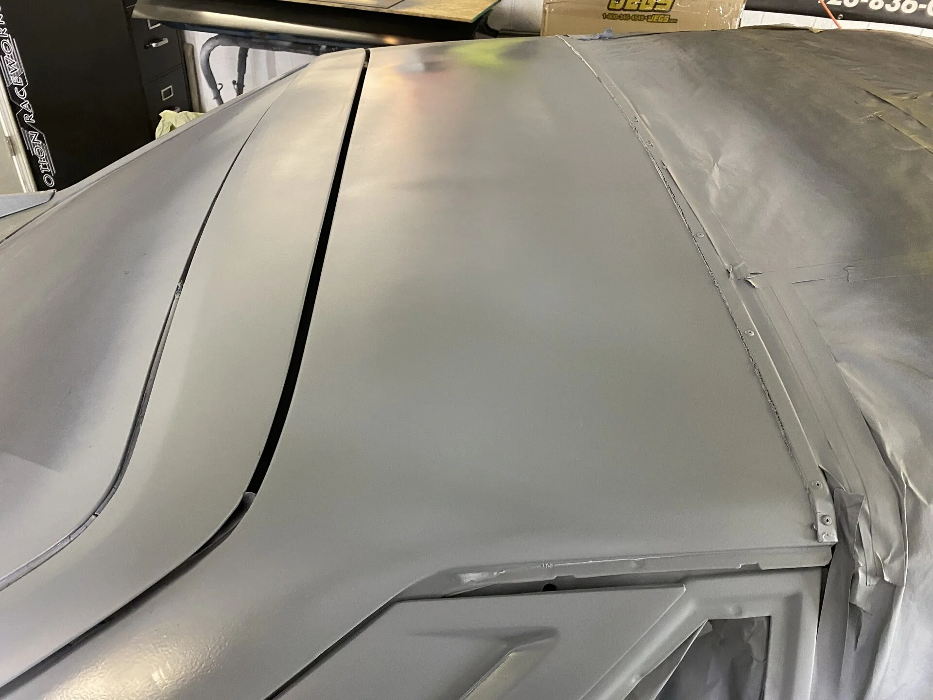

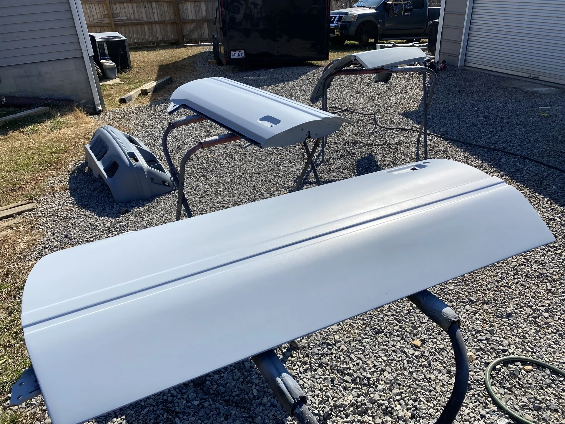

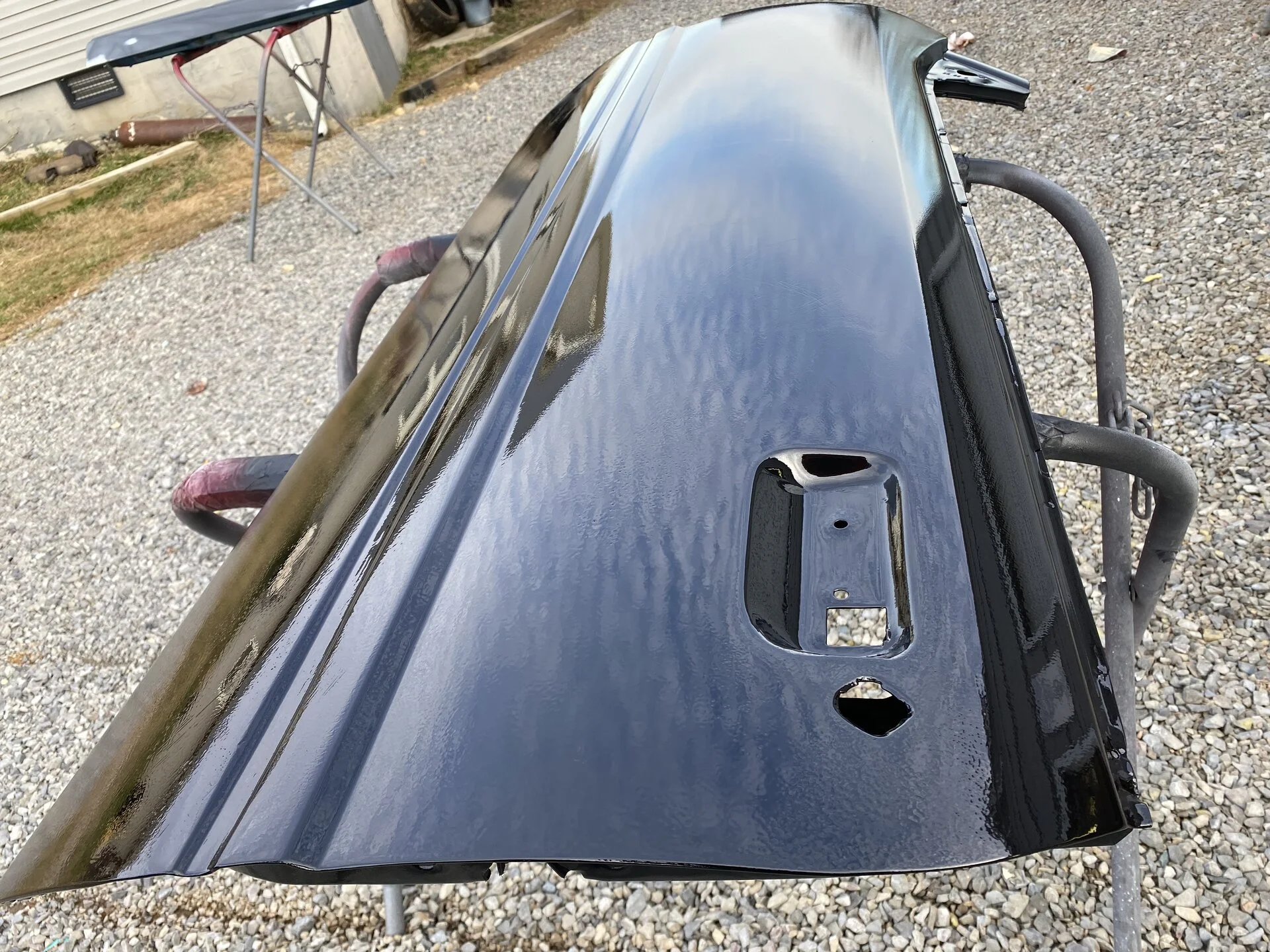

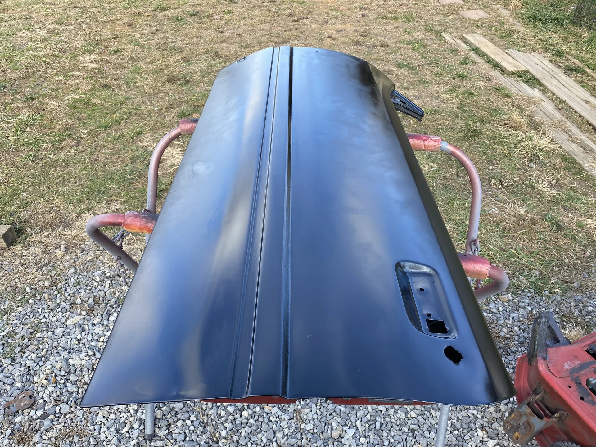

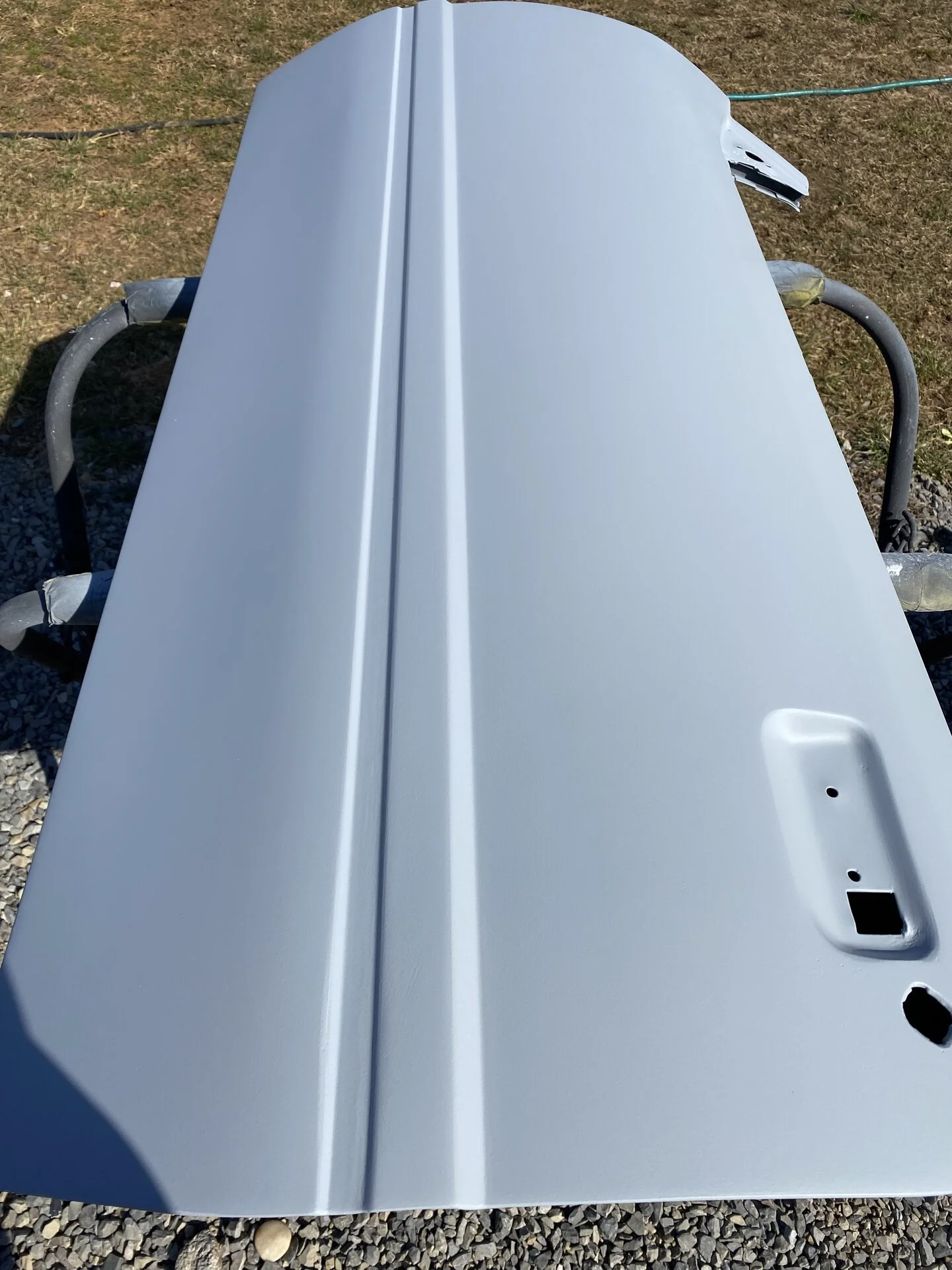

Doors both in 2 K primer. Also another round of blocking the driver fender and more primer
