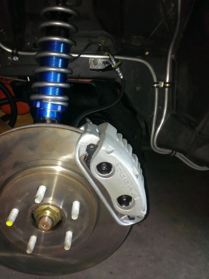

I'm still thinking 19"s in the rear with 18's in the front. Look back at that red GT I posted a picture of. It's real inspirational to me.Please. Please whatever you do do not put a 15" wheel on your car. Nothing says " dated" quite as well as a 15" wheel. If your plans ever include a Cobra front brake conversion, you can take your 15" wheels straight to eBay town and sell them for a loss, cause ain't no 13" rotor gonna fit under no stinkin weanie assed 15" wheel.

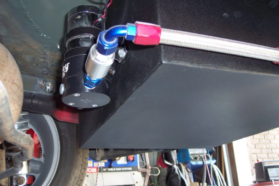

This was/is the fuel pump that I used on the red car. A Holley HP125. Rated for a carburetor would work with both gasoline, and alcohol.
Also rated for stock engines and capable of supporting up to 700 HP N/A. (least that's what Holley says)
https://www.holley.com/products/fue...s/carbureted_electric_fuel_pumps/parts/12-125
Holley has always had both the Blue, and Black El-Cheapo pumps. Unlike the HP pump pictured, they are noisy as hell and have been known to not last long enough to be considered reliable. But the Blue and Black pumps are cheap enough.

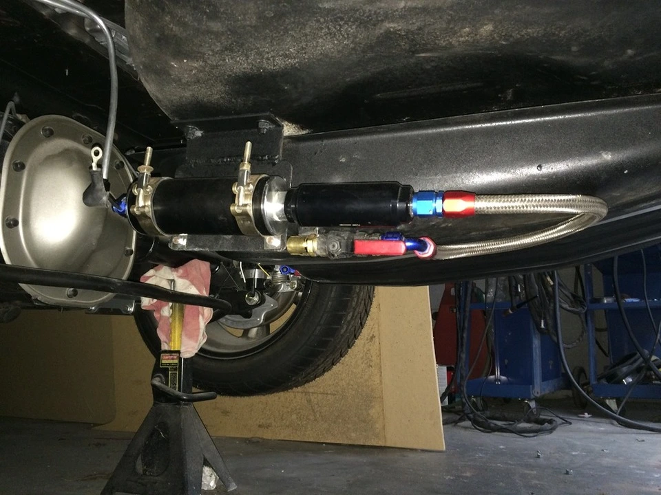

If you want to spend big money of a fuel system,..by all means go ahead. I figure with the pump at 230.00, a pre, and post filter costing another couple of hundred, and a feed line made out of aluminum with the appropriate tube nuts and sleeves another 50-60 bucks. So,...500.00 all in?
I've always used aluminum hard lines when plumbing a car. They are super easy to work with, and bending them only requires one of those spring "over-sleeve" bending kits and a single flare kit to build it.
