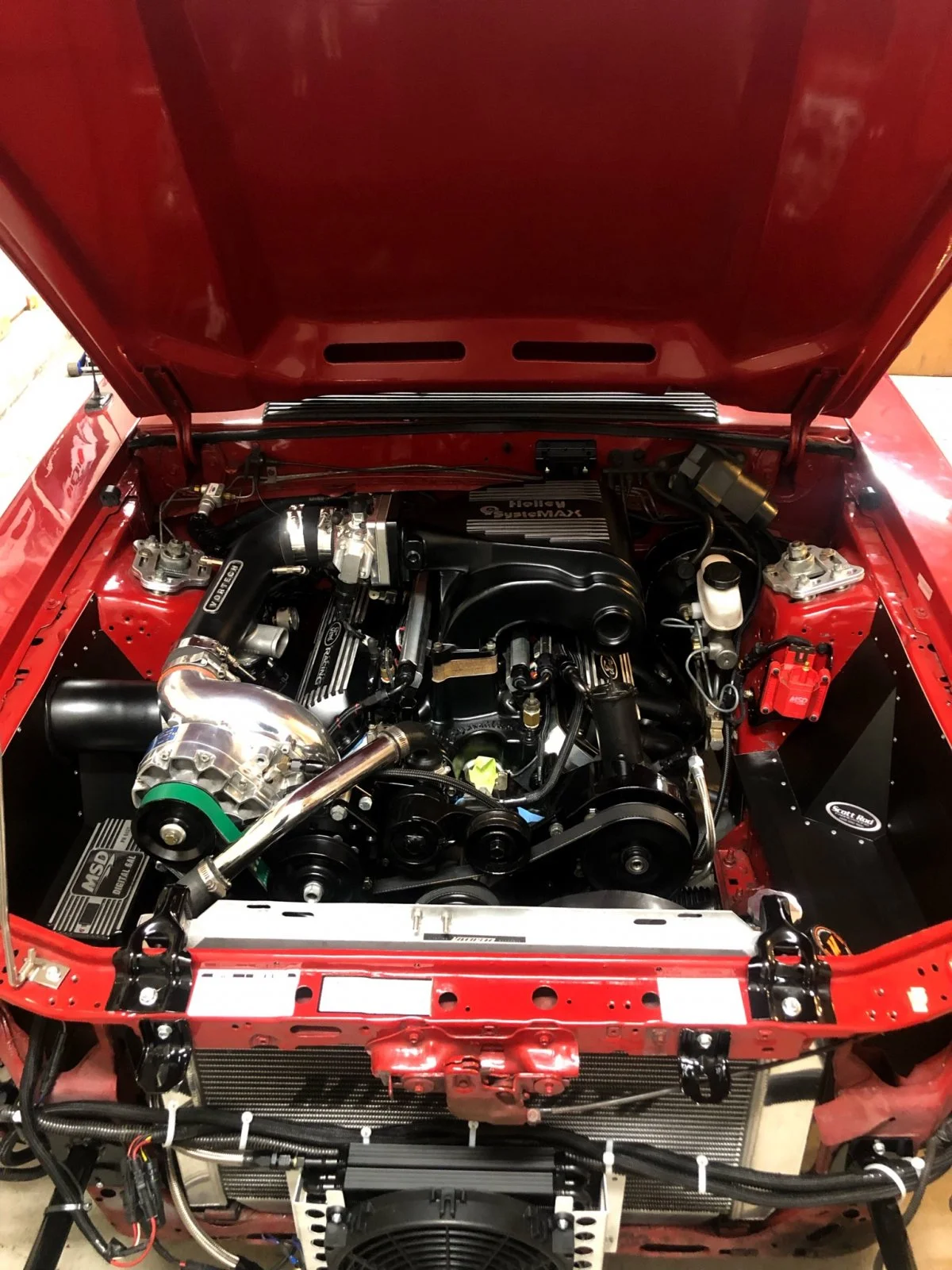

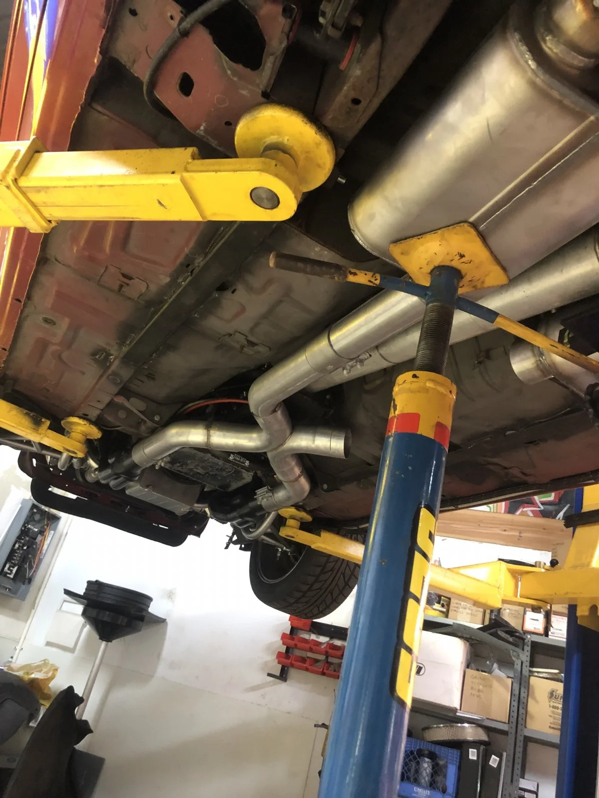

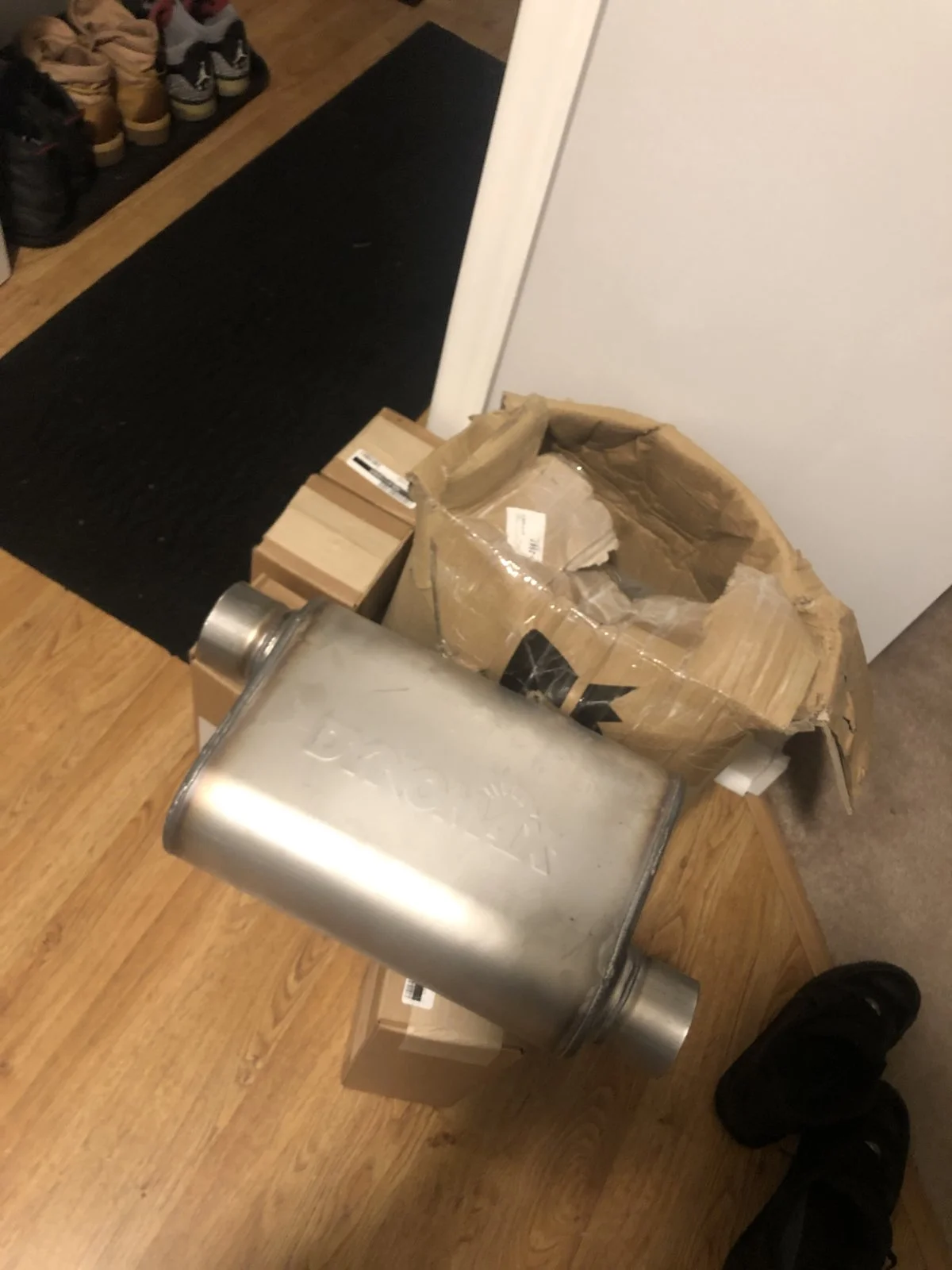

More stuff makes its way on to the engine . Put the big pulley on it . Low boost for when I fire it up and finally cruise it . Rad hose is on . Got most of the vac lines sorted . Discharge pipe . Knocked the old mufflers off tonicht becasue it’s going to my buddycfor the exhaust Thursday .
Getting closer

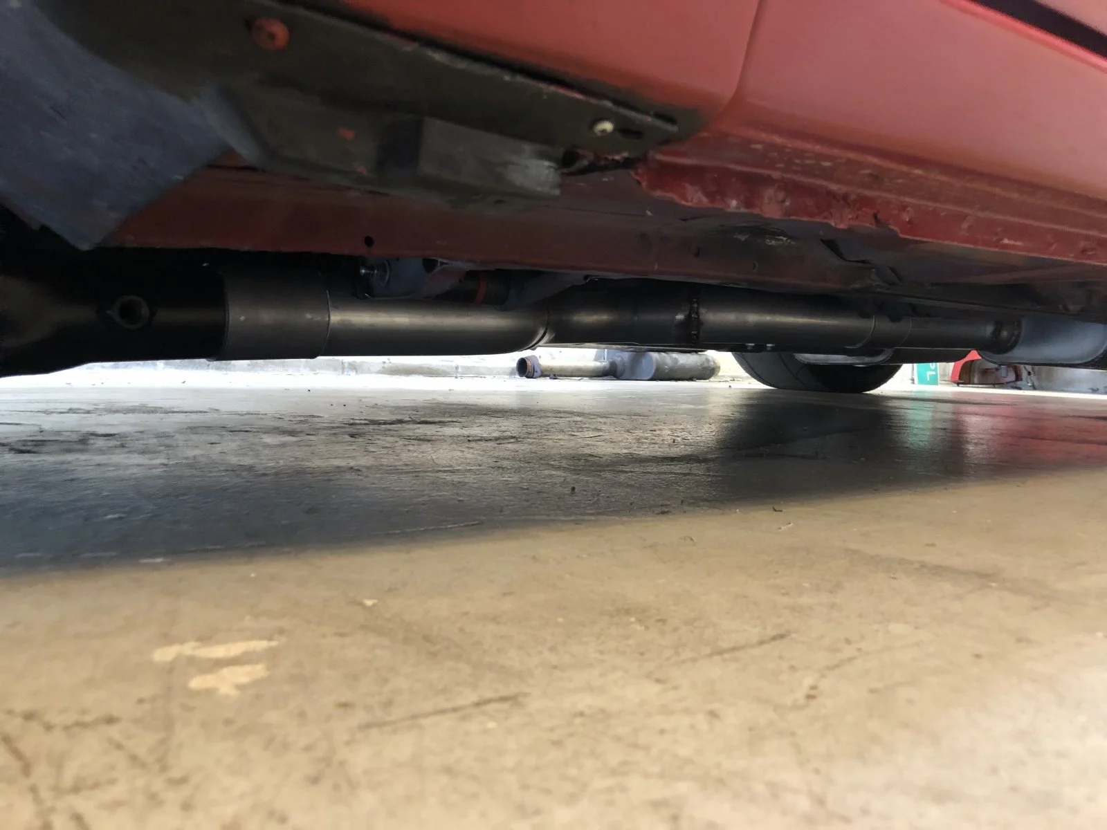

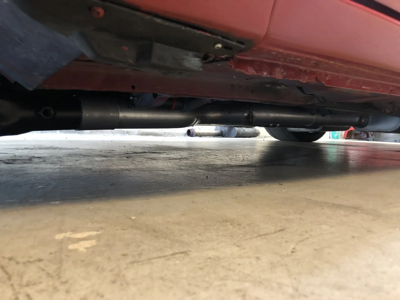

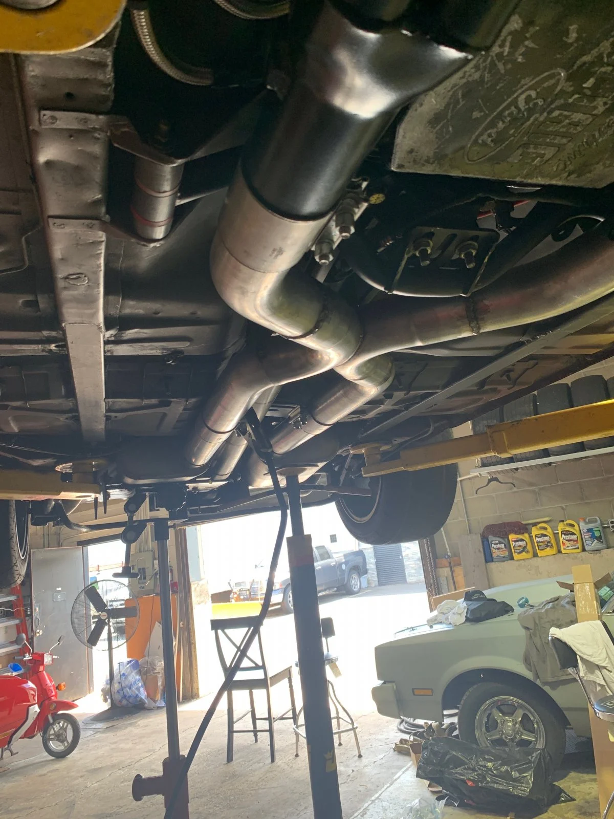

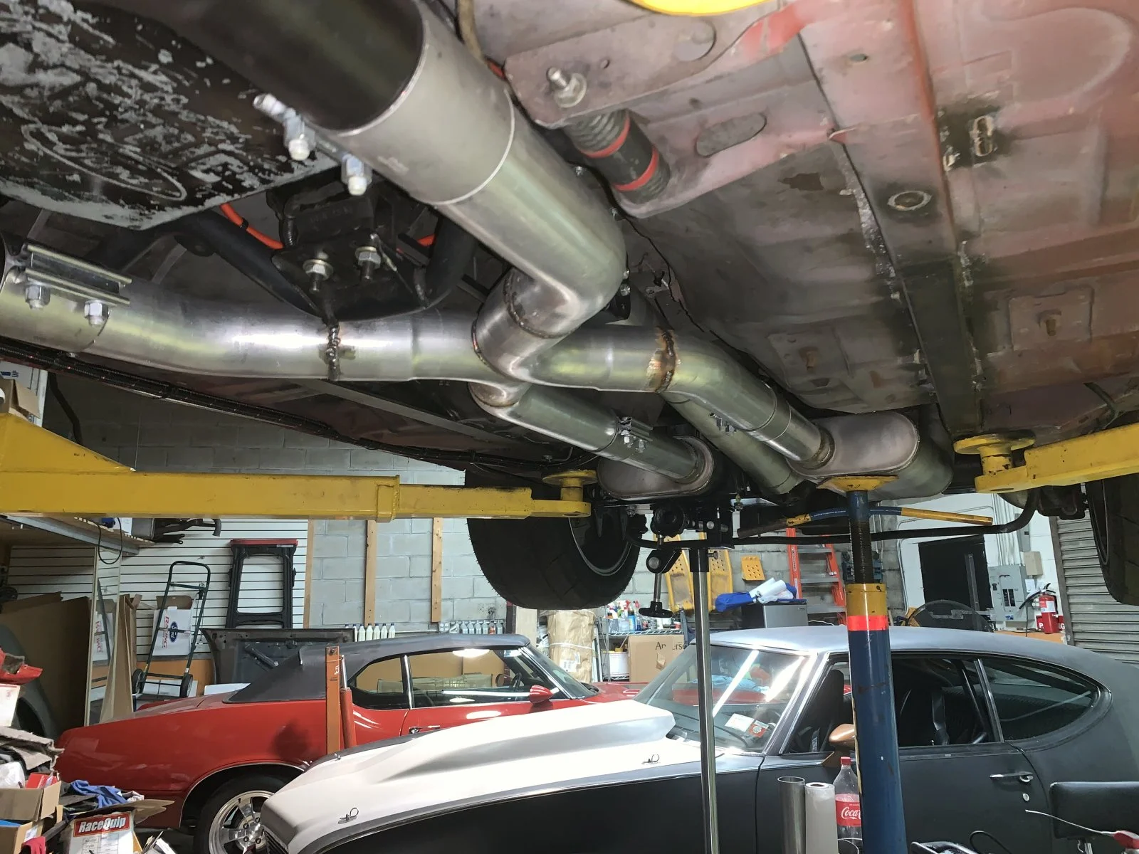

I'd like to do that to my header collectors, you just cut the flange off and use 3" pipe to slip over?
They didn’t have a flange , just the slip on like that . Used hooker clamps they are very nice .
Getting closer

02 sensors are in
Went through the Holley set the inputs and outputs . Tested the fans . Tested trans brake input .
Didn’t like the generic I/o settings so created a advanced one so that it will not trigger the fan relay unless the rpm is over 650 so on cranking it won’t draw power through the car .
Need more coolant and trans fluid . Waiting on the smaller oil filter to come today then I can prime the oil pump .
Just about ready
