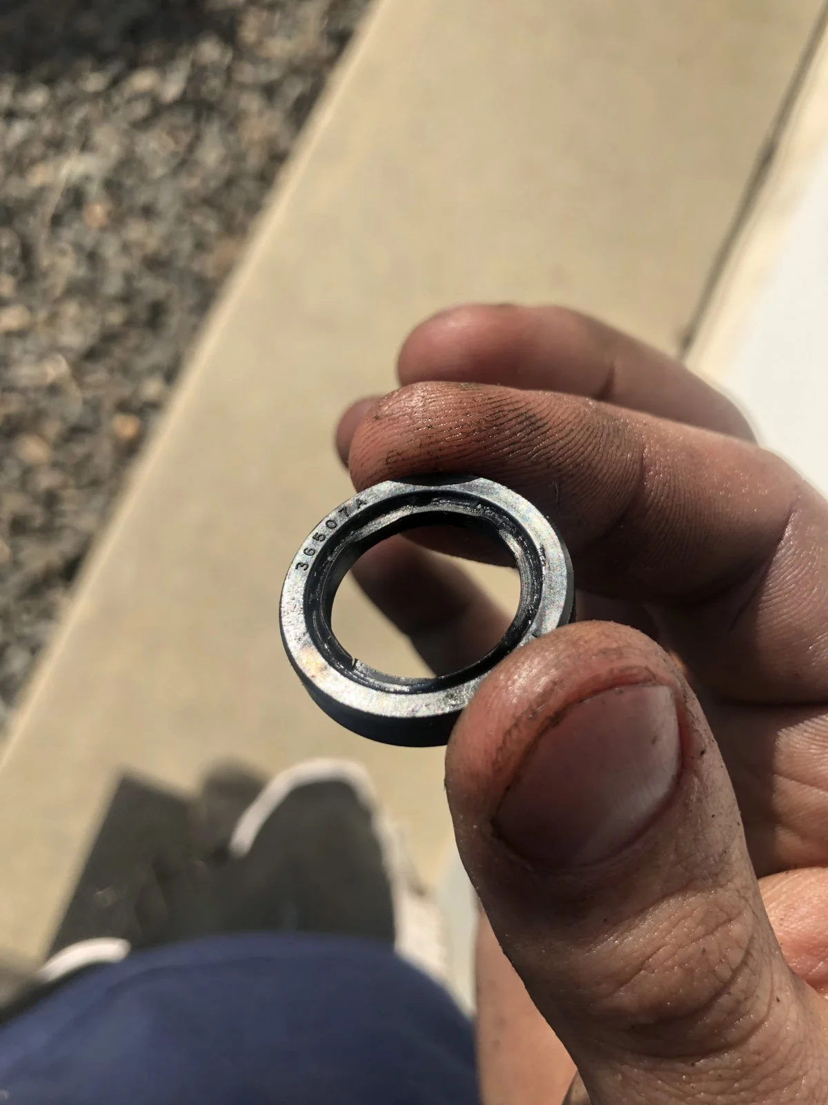

So I have a small leak I have to address out of the shifter level hole. Already got a new seal

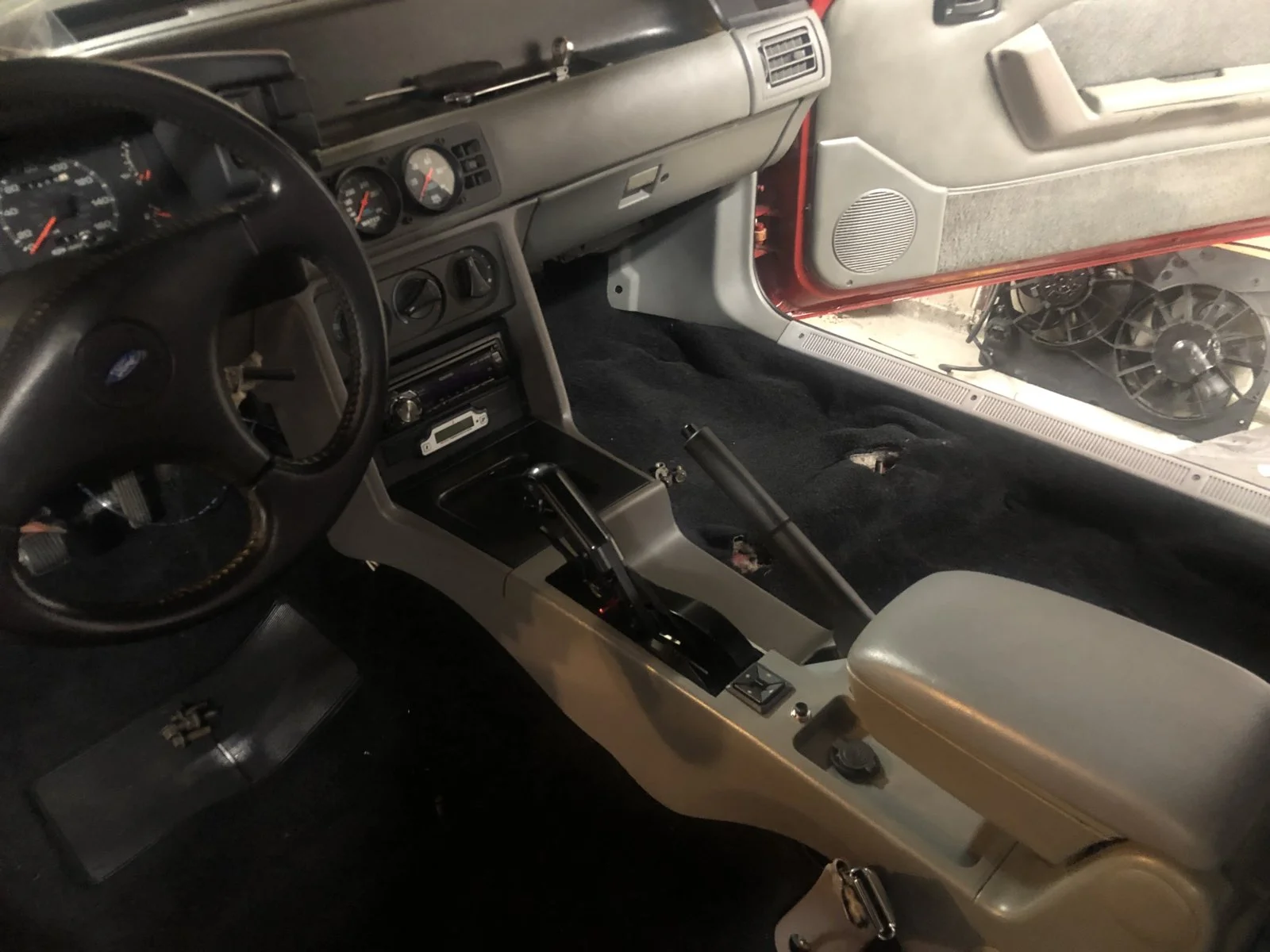

Freddy brown aod. Ultra bell , fwd manual , brake , over drive on momentary switch right behind mirror switch .What trans are you running?

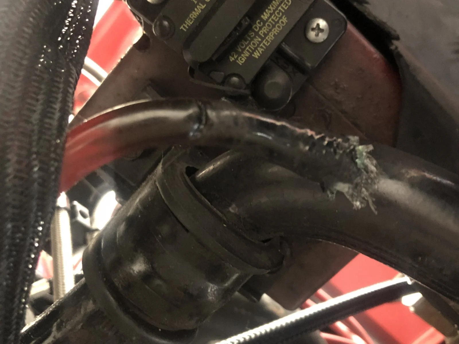

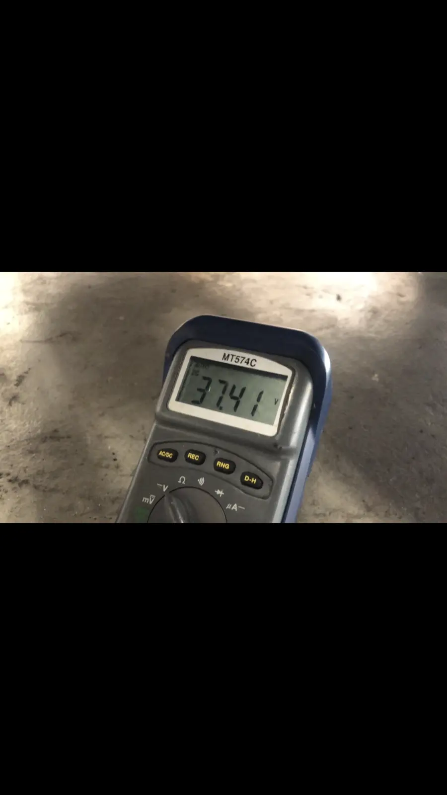

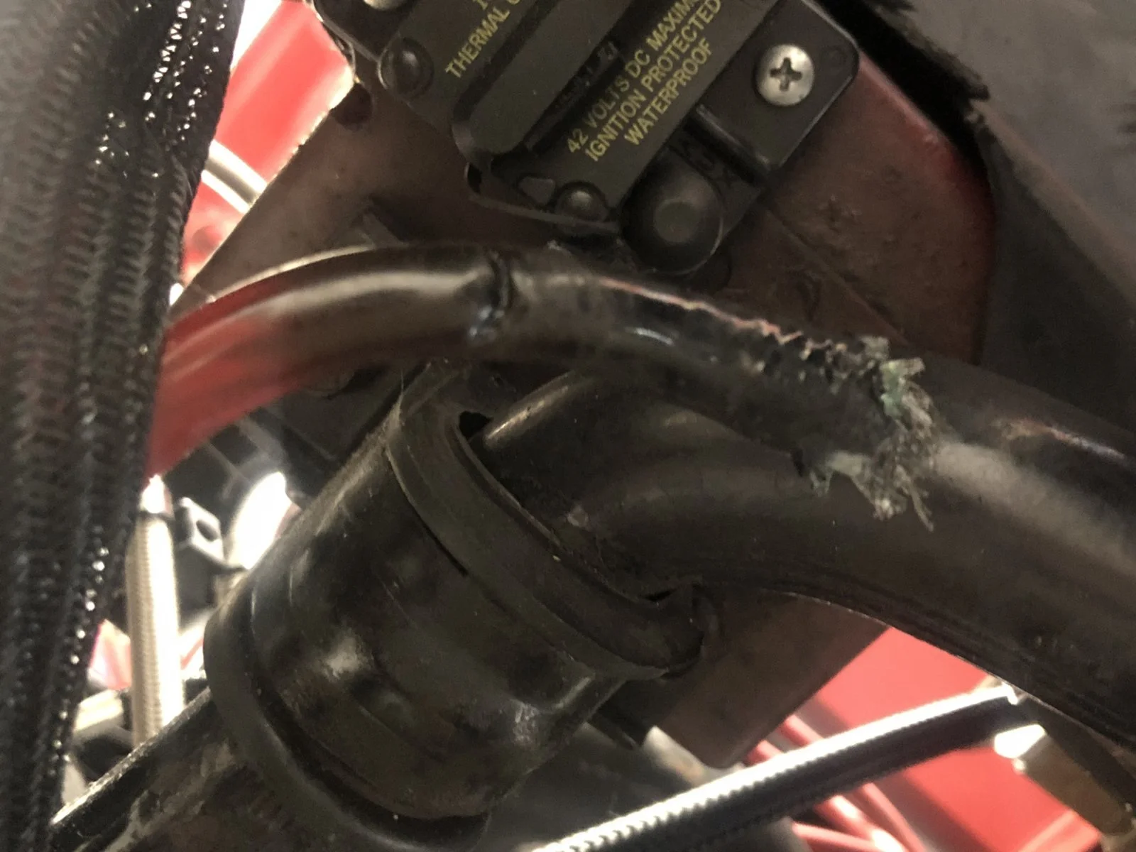

So yesterday i move the car out to pull a vert in im doing some side work on . I look at the dash as im pulling it in and realize it isnt charging. WTF. So i get my meter out and go to the back of the alt and the readings are all over the place. I go to my circuit breaker in line and what do I find ? the wire basically toast to a crisp again. Remember this happened once before but i was spinning the alt at like 32k rpm and didnt realize. This time it has the right pulleys. Both times it did this it had a cheap value craft replacement alt in it. So finally i went to autozone and i still had the warrenty . I got the guy to return mine and then i used that credit and added on top to get a brand new non reman unit. I installed it along with a new 2 awg piece of welding cable back to the breaker. All seems well so far.
Then i drained the trans ( a mess as usual) to fix the shifter lever seal leak. The lever had a burr i missed in it and i think thats what tore it up so i cleaned it up. New seal , fluid back in . Seems ok so far fingers crossed.
Yes that voltage is real at idle. Thank god it burned the wire or else i think id have no holley ecu as well as anything else in the car.

I think I'd like to try the manual VB before I yank the auto altogether. My concerns are downshifting - Say you're rolling at 60-70. Can you just bump the gas slightly and downshift in the 'no load' time after the throttle blip, or do you even have to do that - as in, just downshift and go. Are there any other things you should/shouldn't do?
That part has been a learning curve . I wouldn’t down shift at 60-70 unless from over drive to 3rd which is just off the button . If I down shift I’ll slow down to 30-40 to go down into second usually just coasting so to speak and then I’ll roll back in . It does make it still fun to drive it’s just very different vs a 5 speed . I’d do the Freddy brown valve body for sureI think I'd like to try the manual VB before I yank the auto altogether. My concerns are downshifting - Say you're rolling at 60-70. Can you just bump the gas slightly and downshift in the 'no load' time after the throttle blip, or do you even have to do that - as in, just downshift and go. Are there any other things you should/shouldn't do?
Yeah, that's how my OD is now. It's wired to my rear defrost button, hit it 2x and locks out OD. I guess there really isnt much reason to be downshifting passed that now that I think about it.That part has been a learning curve . I wouldn’t down shift at 60-70 unless from over drive to 3rd which is just off the button . If I down shift I’ll slow down to 30-40 to go down into second usually just coasting so to speak and then I’ll roll back in . It does make it still fun to drive it’s just very different vs a 5 speed . I’d do the Freddy brown valve body for sure
on ramps or if you want to go from a rollYeah, that's how my OD is now. It's wired to my rear defrost button, hit it 2x and locks out OD. I guess there really isnt much reason to be downshifting passed that now that I think about it.
This for sure, just learned that over the weekend the hard way. Takes for-freaking-ever to down shift from 4-2 (I'm electronic though so that might be part of it).on ramps or if you want to go from a roll

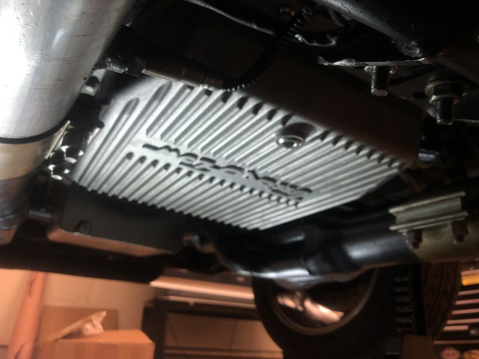

No more bent pan rail . No more leaks from the corners . Extra quart . Looks nice . I guess it was worth it LOL
