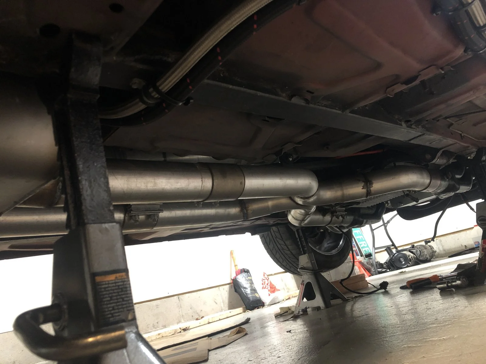

Mid pipe in

Mid pipe in

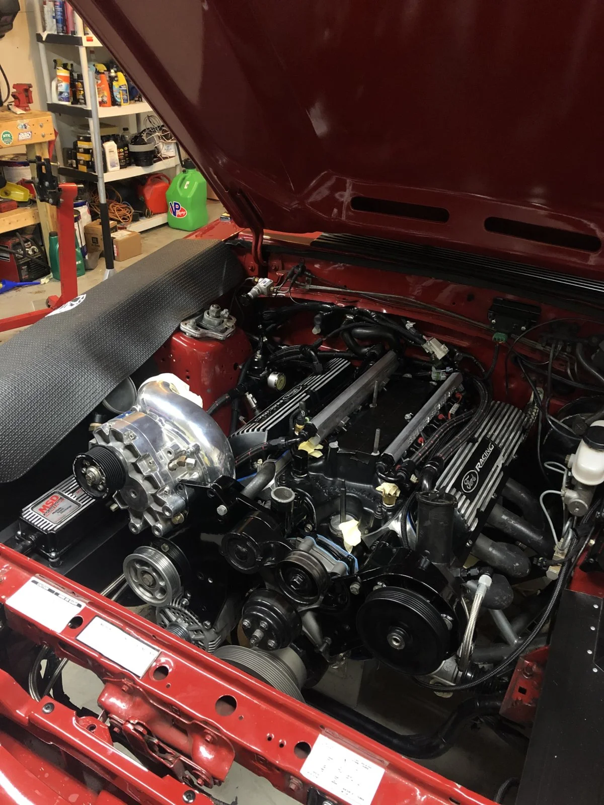

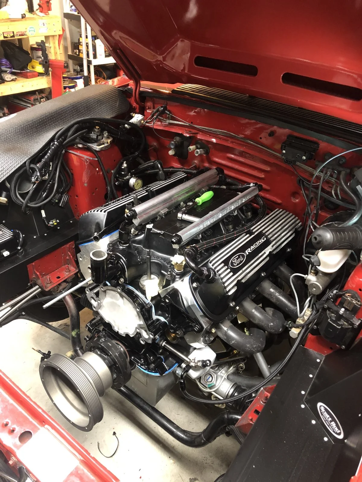

With that much extension hanging off the end of the crank, it’s a wonder that that sht don’t snap off

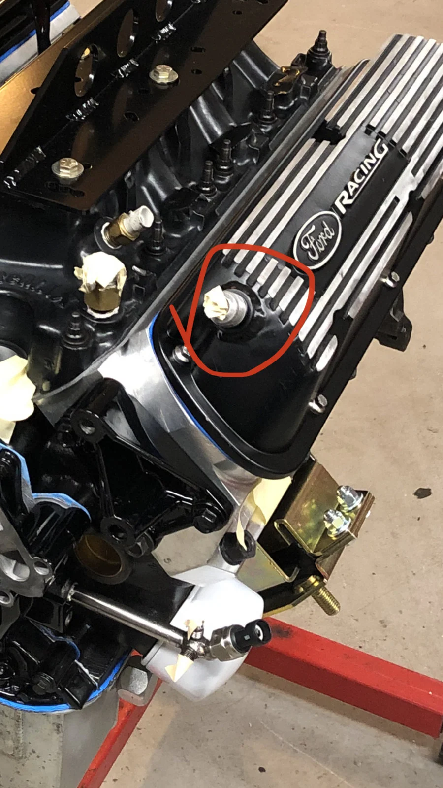

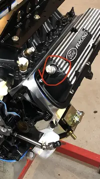

also found that the Glenn’s tank has a small micro pin hole fuel leakthat apparently seeps down from the feed and drips in the gas tank cover and out the small hole in the cover . I’ll have to address that down the road .
I have one carb style cover with a fitting welded in thebreather hole . One efi with a fitting on the front . Both go to a catch can in my bumper . No pcv . So this comes off and fills through there . Just like an oil fill hole
I was not questioning the way it is or why you did it, I understand why a forced induction system needs a different crank case evac set up.
I was remembering someone that was removing the pcv on a na engine, mostly because we have a sbc here at the shop that was rebuilt and installed without a pcv system and does not have a lot of miles on it. It leaks from every gasket. Honestly looks like it has a bagillion miles on it.
If it’s leaking from every gasket then the crank case pressure is not getting out of the engine and maybe they need a vac pump .
