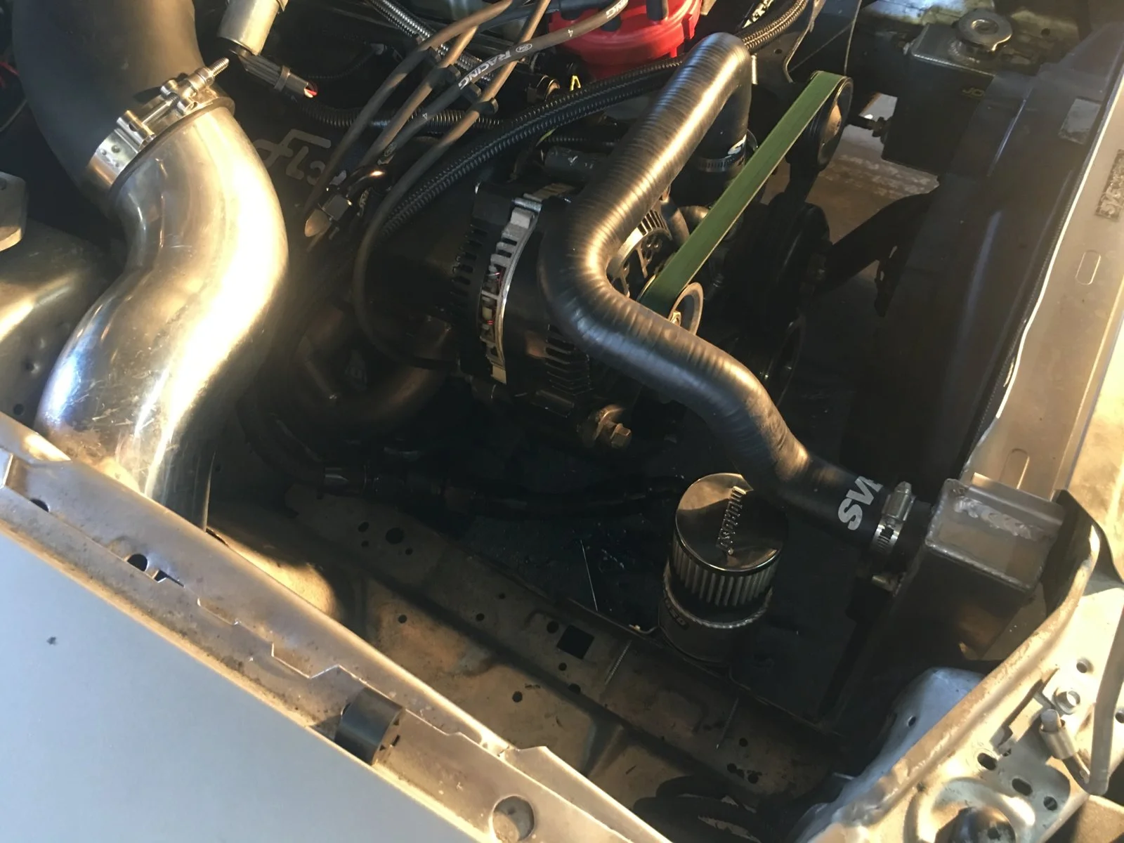

Got the breather tank done up at well. Ditching the pcv and oil separator for something that doesn’t take up room behind the intake. Made jet changes a pain in the ass lol.

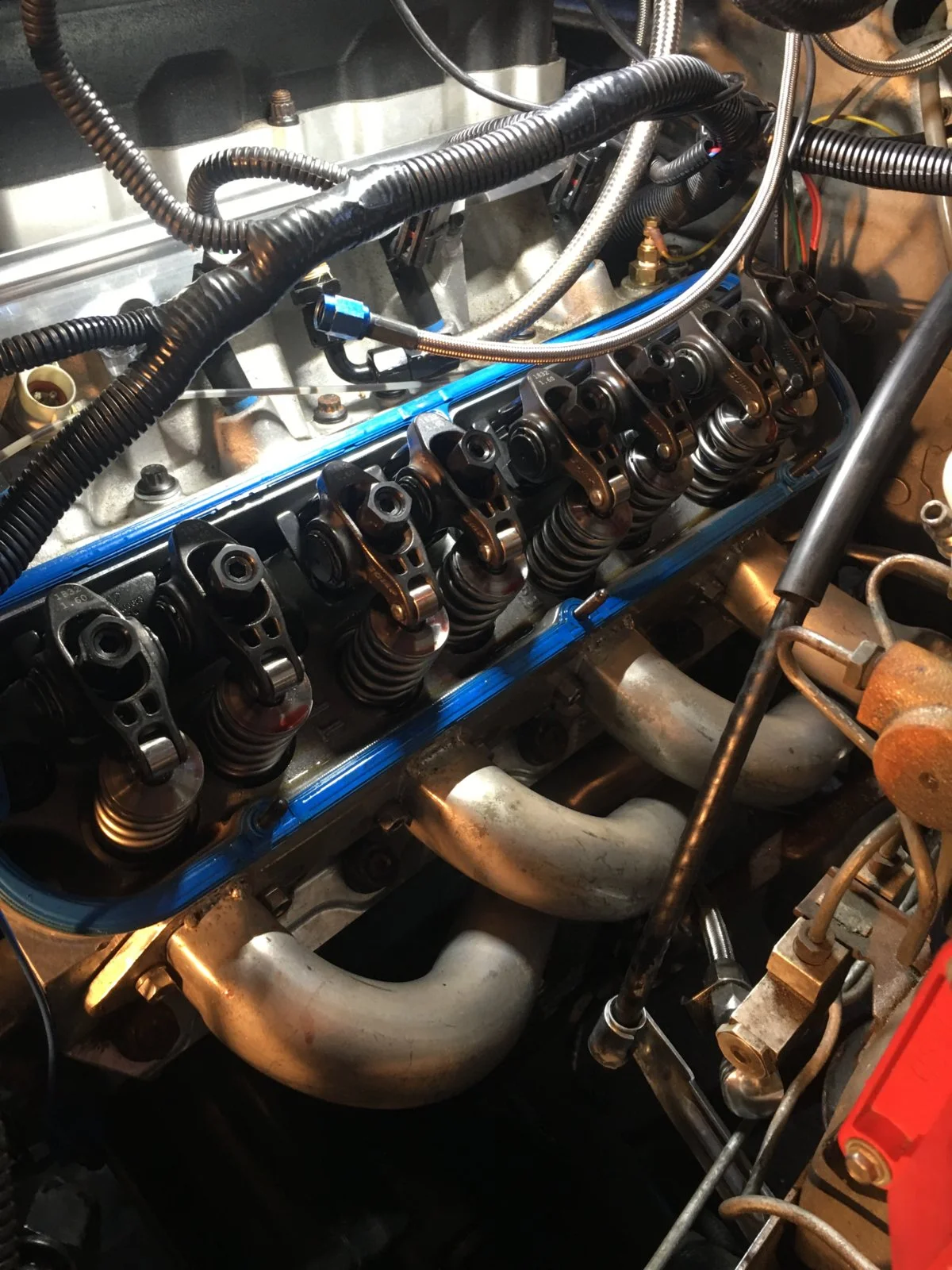

So I went out today and did some pulls and I got valve float above 5500 rpm. I guess the springs in the 11r heads don’t have all that great of a service life, as Ed told me today. I ordered up some 1207x from pac with titanium retainers. These should hold up better than the non 1200 series springs which come with the head ootb.
A little word of warning for anybody running these heads. They’re great, but any moderately aggressive cam will shorten the spring life by quite a bit. Mine only lasted less than 10,000 miles, although I’m sure the way I drove the car had a decent part to do with it.
New valve springs, titanium retainers, and chromoly rockers in the car. Was kind of a debacle getting the springs sent to me with all this covid-19 :poo:. Went with some 1207x from pac, seem very nice to far. Did a heat cycle so when the car cools I’ll take it out for some runs.
God I hate spring install with the head on lol.

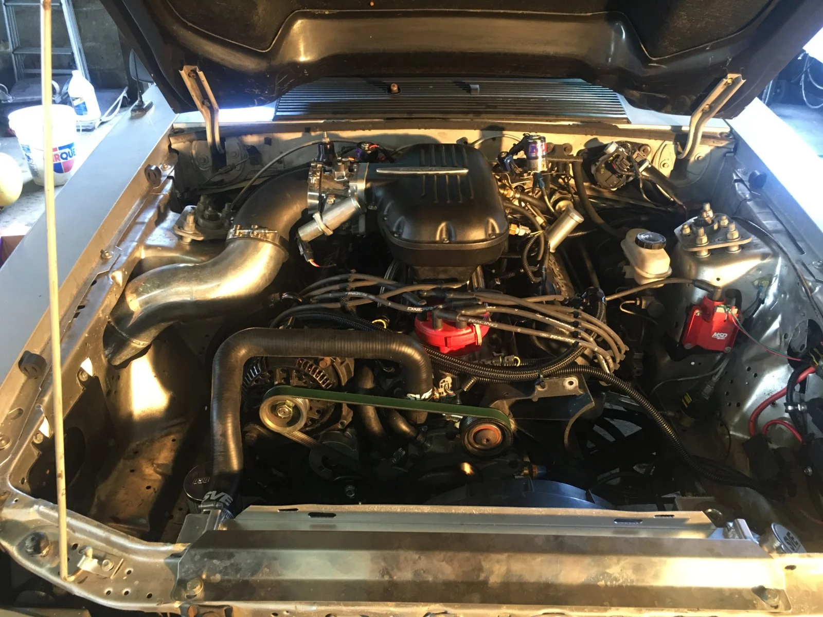

So I’ve made a few changes to the car over the past few months.

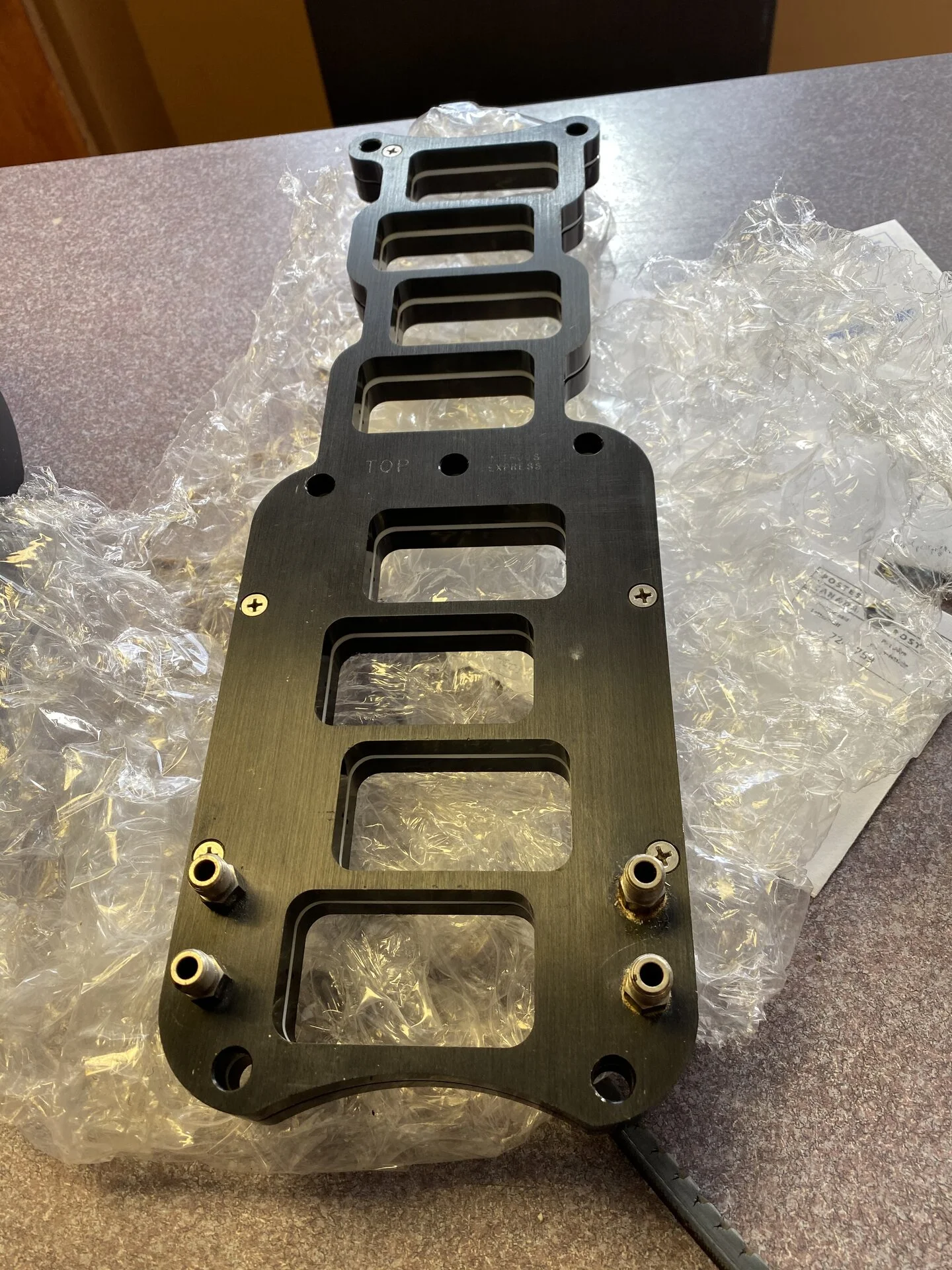

Changed out the nitrous plate to a perimeter style from. Spent a couple months semi-actively searching before I was actually able to find one for a tfs r. And of course I installed it and it hit the intake lol. Nothing some phenolic spacers couldn’t fix
Then, I had a distributor pip go out, luckily it was under warranty so I sent it back to Davis. In the meantime, I bought a new msd pro billet - to have as a spare, and it ran like dog :poo: right out the box. So I sent it back, and got a parts store one. Ran great for a day, then started messing up, dying once it got warm.
So I kind of found myself at a crossroads: stick with distributors, and pray I’d finally get a good one, or upgrade.
I chose the latter.

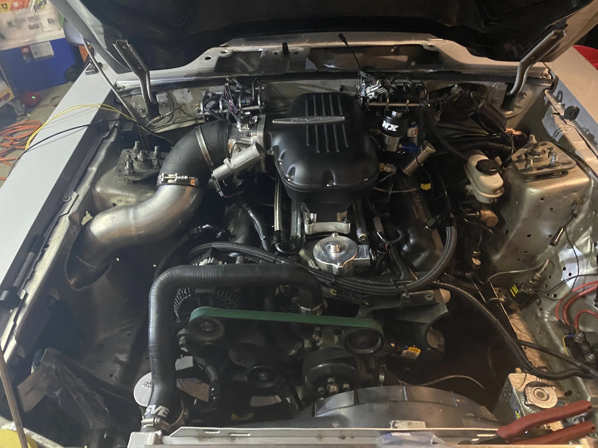

Went with the CAS from stinger. Got the whole thing wired and 95% loomed today. Took about 7 hrs in total. Wasn’t without some small hiccups, but all 8 coils now fire as they should.
So the car has been running well with the coil near plug setup.

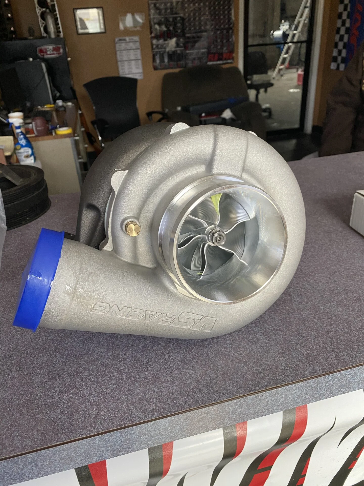

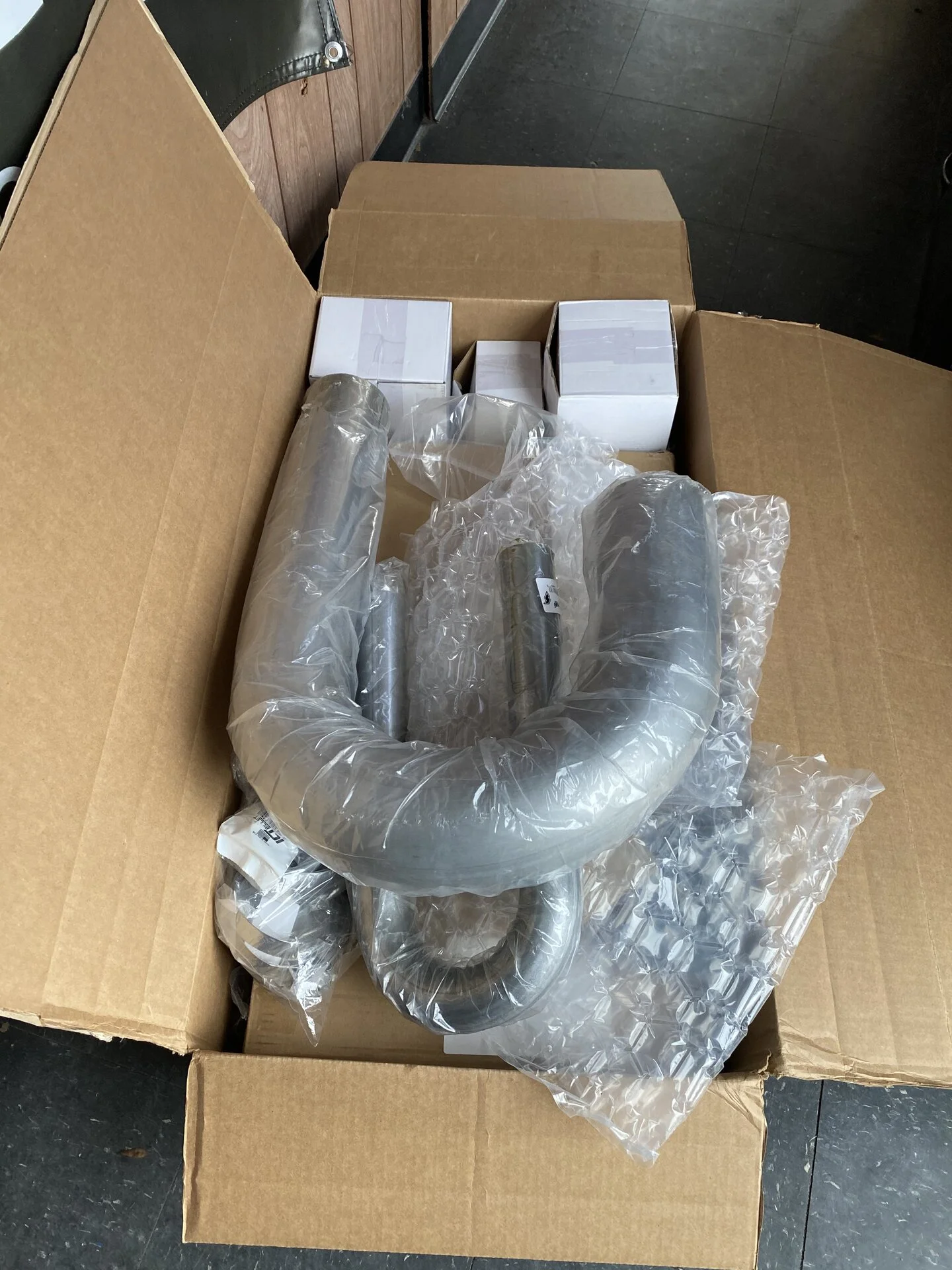

I’ll try and chronicle the struggle over the next few weeks as a friend and myself fab up the turbo kit. I’m starting with flowtech turbo headers, summit exhaust builder kit and some time. We’ll see how it comes out.
